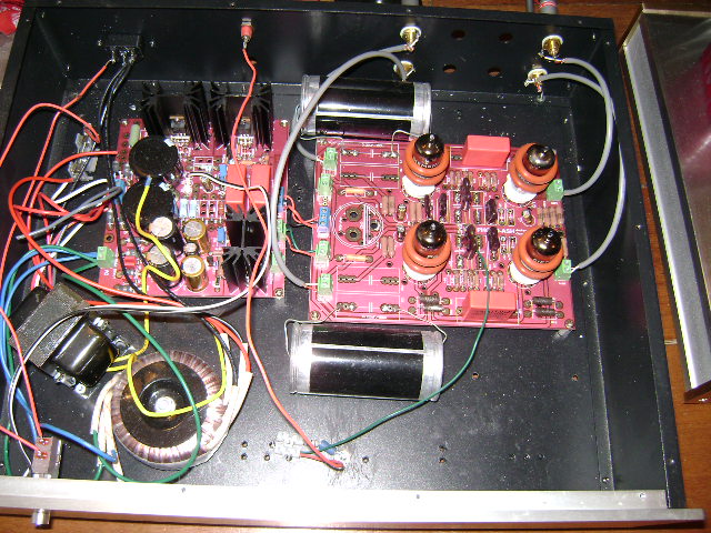

I don't post often here, but after much deliberation, I'm quite pleased with the completion of this D3A project !
I'm using the Broskie's Janus Regulator to power the phono stage for now. I began with Russian K75-10s bypassed with Teflon FT-1s. The bass sounded boomy. I had some AmpOhm Tinfoils PIOs for another project but I decided to try it out here. I'm must say, the caps sound good in this circuit. I finally upgraded one of the caps in the RIAA network to Russian Silver Micas.
I haven't had a chance to hook it to my turntable in my main system, but I've been testing using the iPhone thru the Hagerman's iRIAA. The phono stage sounds good across the frequency range, but I will only be able to do any sort of critical listening once I hook it to my vinyl rig.
B+ 193V with load
K75-10 PIOs in coupling stage
Playing Gotan Project from iPhone thru Hagerman's iRIAA
AmpOhm TinFoil PIOS
Russian Silver Mica in RIAA network
I have a Hammond box that I am going to enclose the Phono Stage and connect it to the Janus via an umbilical. I also have the Salas Regulator that I plan on building and tieing all this together in a single chassis but that will have to wait. For now, I'm a happy camper !😀

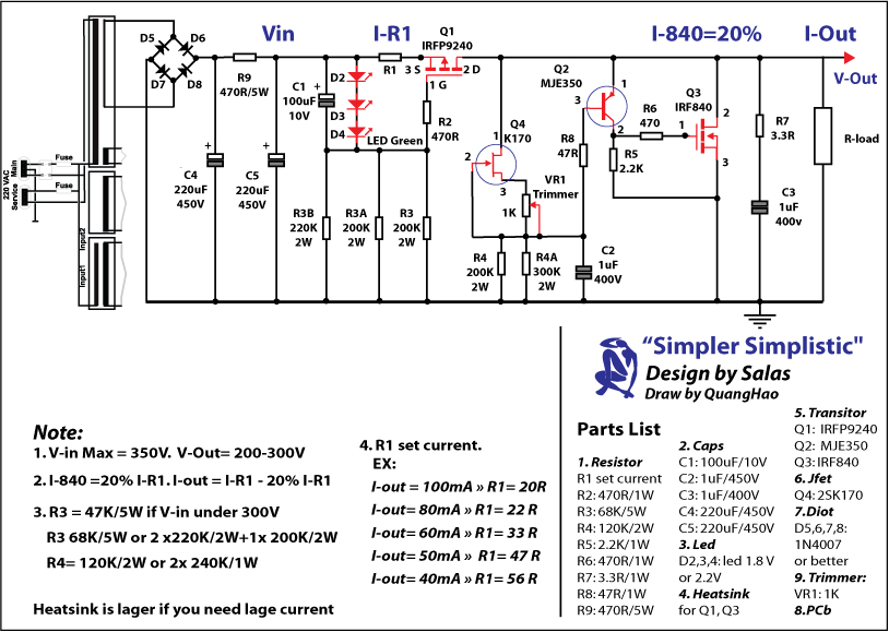

Small questions for PSU:
- Could following replacements IRF840 -> IRF830?
- How big should be 33Ohm resistor to have only 10-20mA just for testing of the shunt?
- Are leds red, green...?
- Where to find 56k 5w?

Hi ! Do you can see in circuit
Thank you for more precision,
btw, I do not see zeners in this schematics? Also what about IRF840, I have some IRF830 so I was wondering. I see I can use 47k 5W since we are under 300V? This is quite different, then what we have in your older post...

Hello guys,
I must be blind. I started to populate the regulator board and do not see R12 bleeder resistor nowhere. Where is it?

!it is near the cap 220uF!

Hello, I must admit I still do not see it. Can you circle it for me on the jpg of your layout please.

Yes it does have on board! but you weld it at the bottom capacitor 220uF 2 children, or no longer needed! it only to discharge the voltage!
