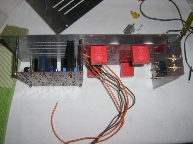

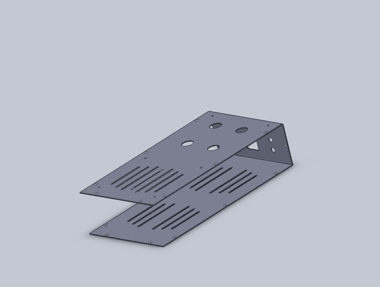

I have designed an enclosure for this preamp.
I will post more pictures of assembly when I get the metal back net week 🙂
This will house both pc boards and an alps slider potentiometer.
The open sides will be closed with wood.
  • tubepreamp.PDF
    tubepreamp.PDF

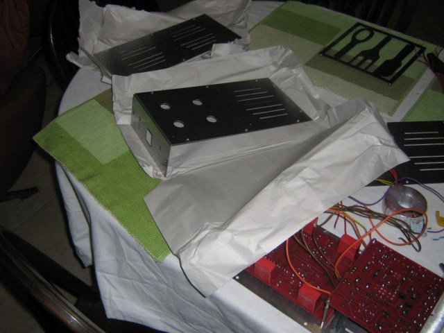

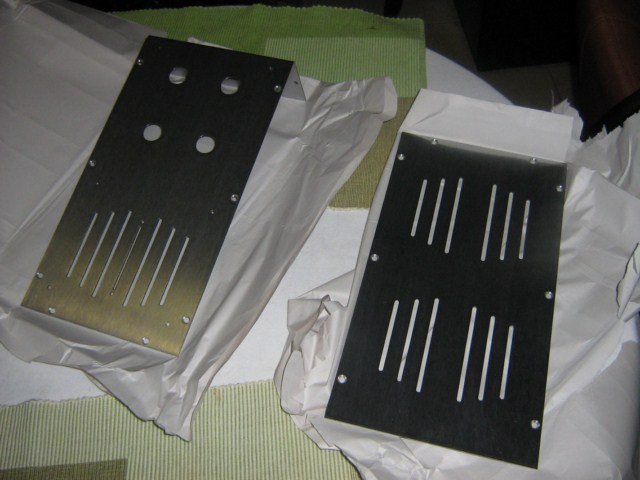

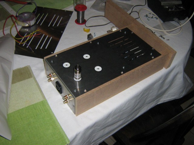

Thanks! ,here is the latest progress , Got the metalwork yesterday. All my previous projects I used natural anodized Alu , but for this one I tried brushed 430 Stainless steel:
