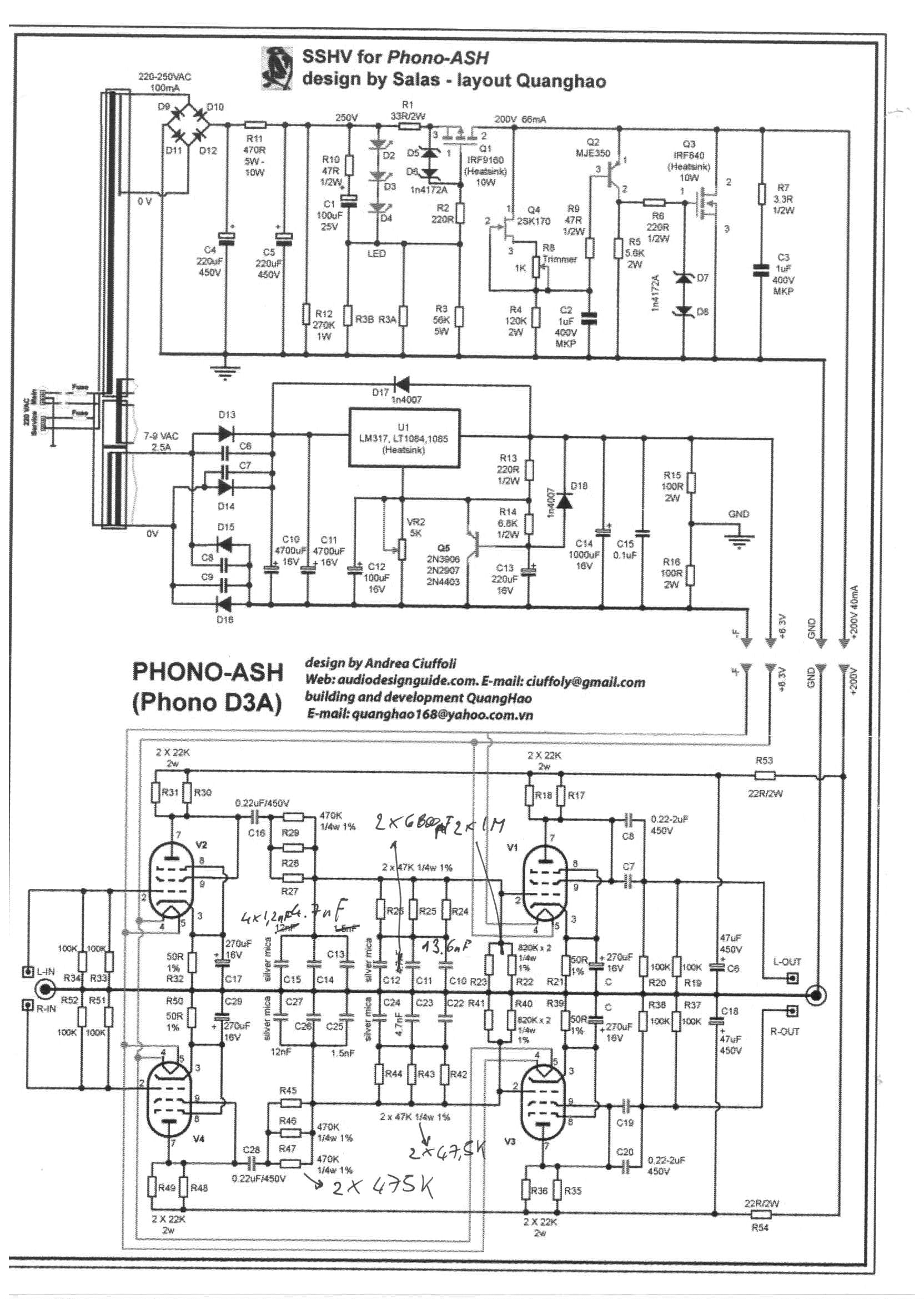

I read an article somewhere on the internet, with a phonoamp project with the D3a tube. Thought that the schematic was a little "messy", with three resistors on the schematic and only two of the mentioned on the drawing. Also found, probably, an old schematic of the same phonoamp, with fewer resistors and capacitors. Anybody outthere who built thisphonoamp?

Hi. Thanks for answering! I found two different schematics on the internett, the one found early in this thread, and another one by Ciuffoli, maybe an earlier curcuit?, see link!. I think the schematic of the one Quanghao is a little bit "messy"? Three resistors and on the drawing marked 2 x 47K? Just ordred D3a tubes and I will use p2p soldering, not pcb. My question is: Is the schematic from the link Ok? Much easier to use if you are p2p soldering?

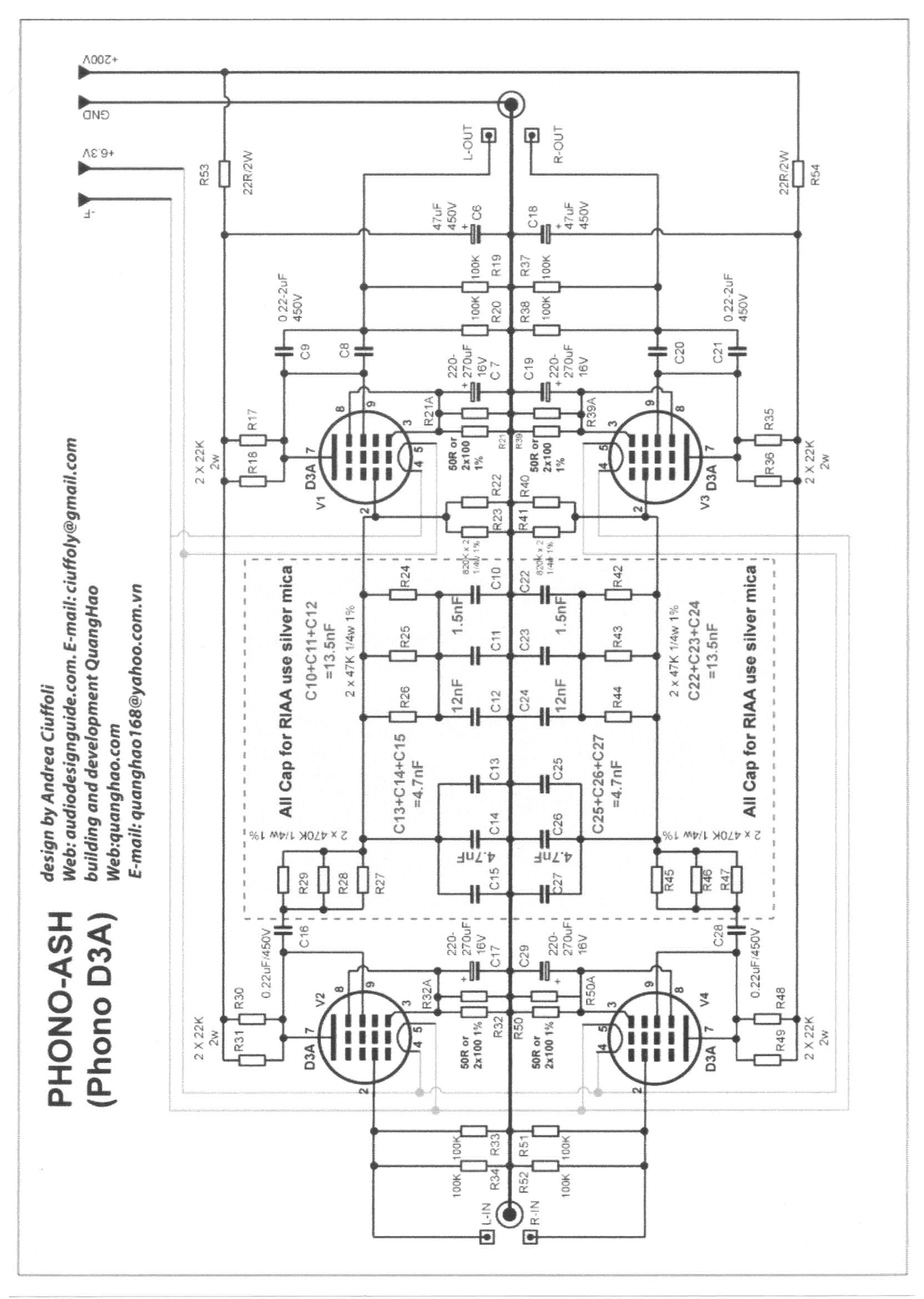

Hi Stenak,
The circuit on the webpage you posted uses different setup and lately changed to use smaller mica capacitors.
I have done mine according to the latest design (see attachments).

Stenak,
The use of resistors in parallel and in opposite orientation it's Ciuffoli's style. Probably he's got radio engineering background where two identical resistor are connected in parallel with opposite orientation to cancel residual inductance. In audio it's a little overkill but that's his style.
Don't worry if you see three resistor in parallel on the schematic. I think those reflect the positions available on the PCB to give flexibility with paralleling different values. Just follow the text. If you see 2 x 47K it means 1 x 23.5K 2 x 47K or 3 x 15.6K parallel and so on, regardless the number of resistors on the schematic.

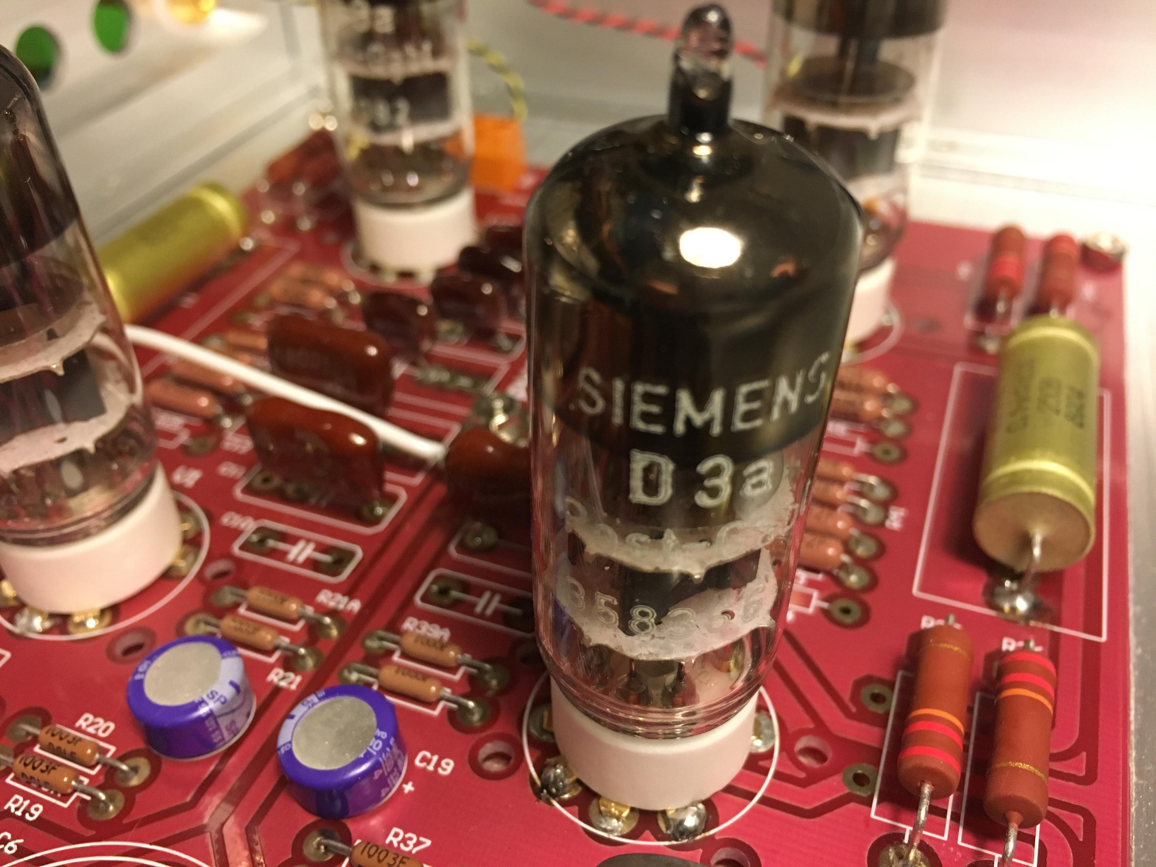

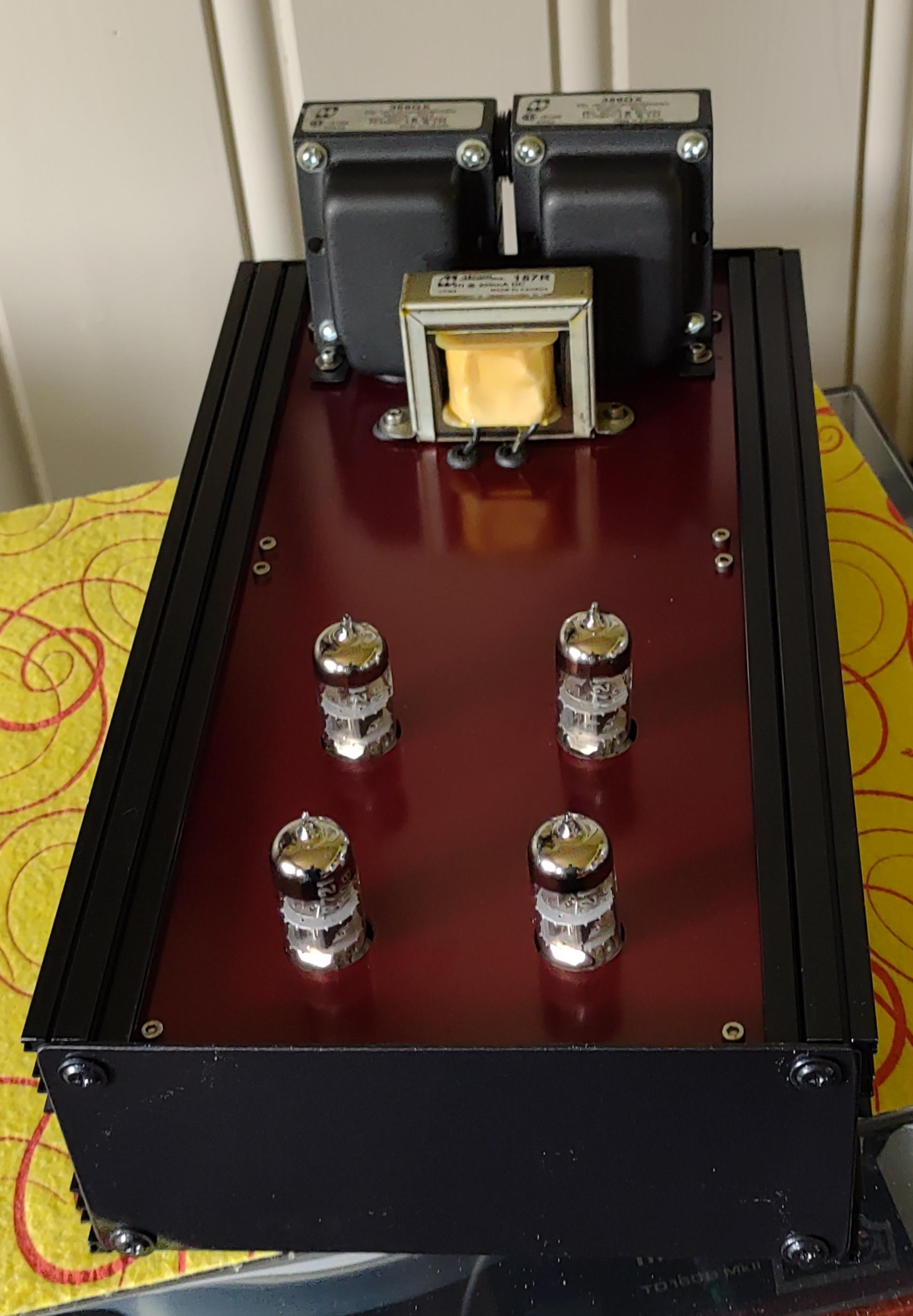

I made it for myself

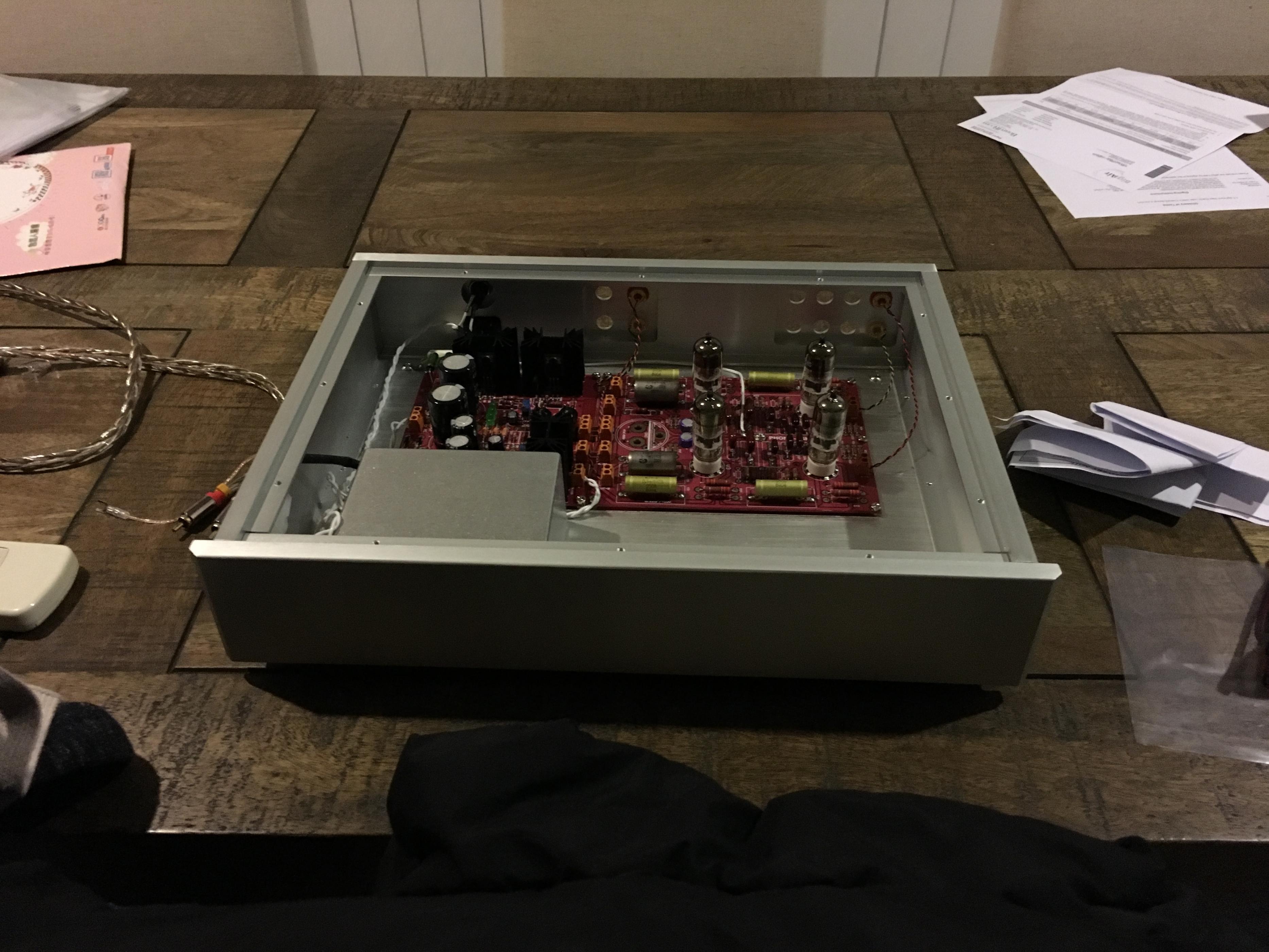

I got the boards from a friend many years ago. Now I decided to build the phono stage using L M Ericsson (Sweden) D3a tubes.

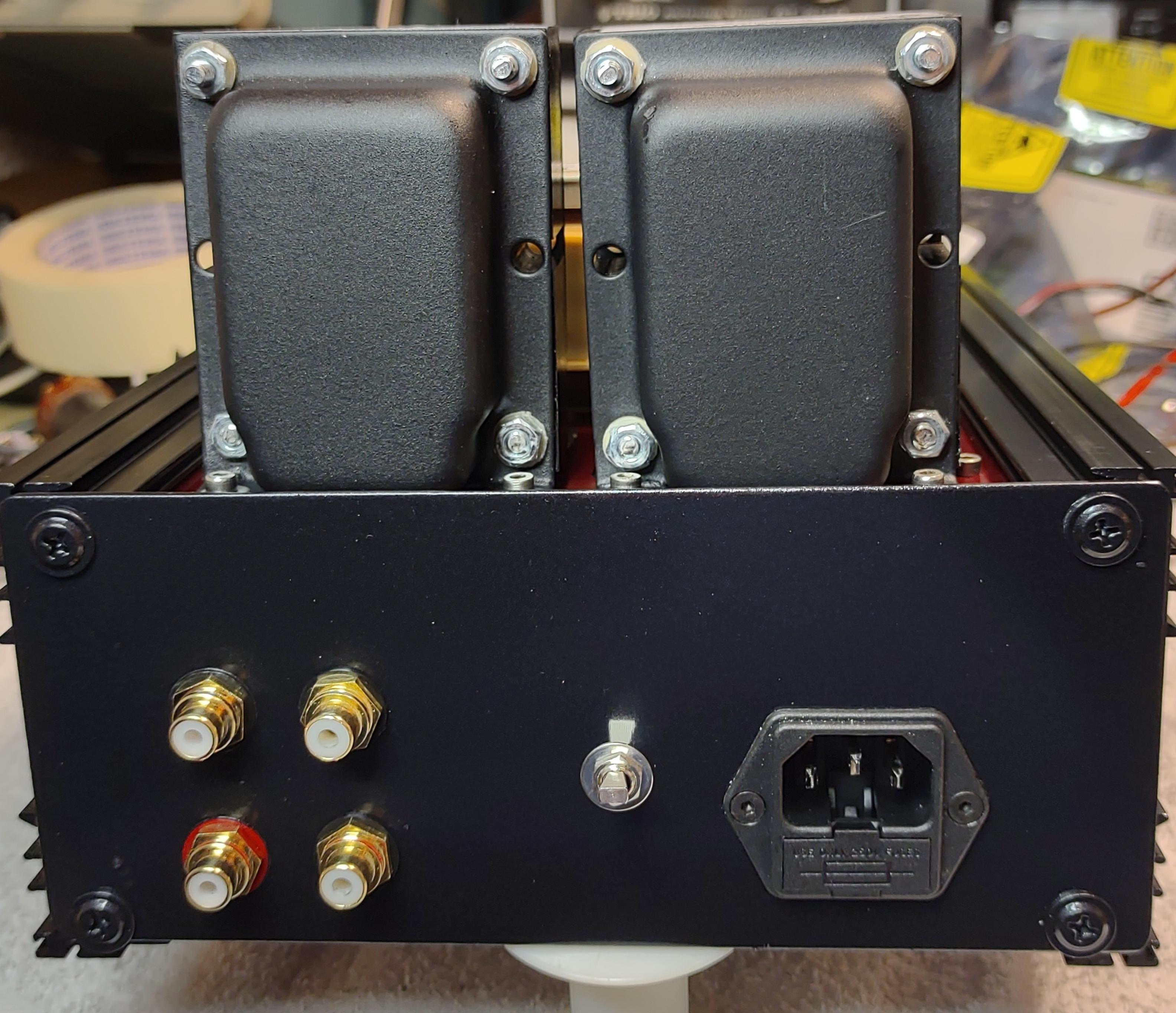

Two Hammond 369GX transformers are connected to give 12.6V for heating (two 6.3V in series) and two 230V windings in parallel to give enough current for high voltage.
12.6V is much too much for the LM317. An MJE3055 is helping and both are mounted on a large heat sink. Two heat sinks make the side panels of the RIAA.
Very low ripple and noise. Heatsink stabilize at around 45C.
The high voltage regulator was not so easy to get working. Much too often the shunt regulator FET shorted. Ended up with a 1uF across it. Has worked fine since it was added.
The RIAA correction shows me that there is too much bass lift. +20dB already at 100Hz. Too much attenuation at 20kHz. Totally it gives a sound on the dark side.

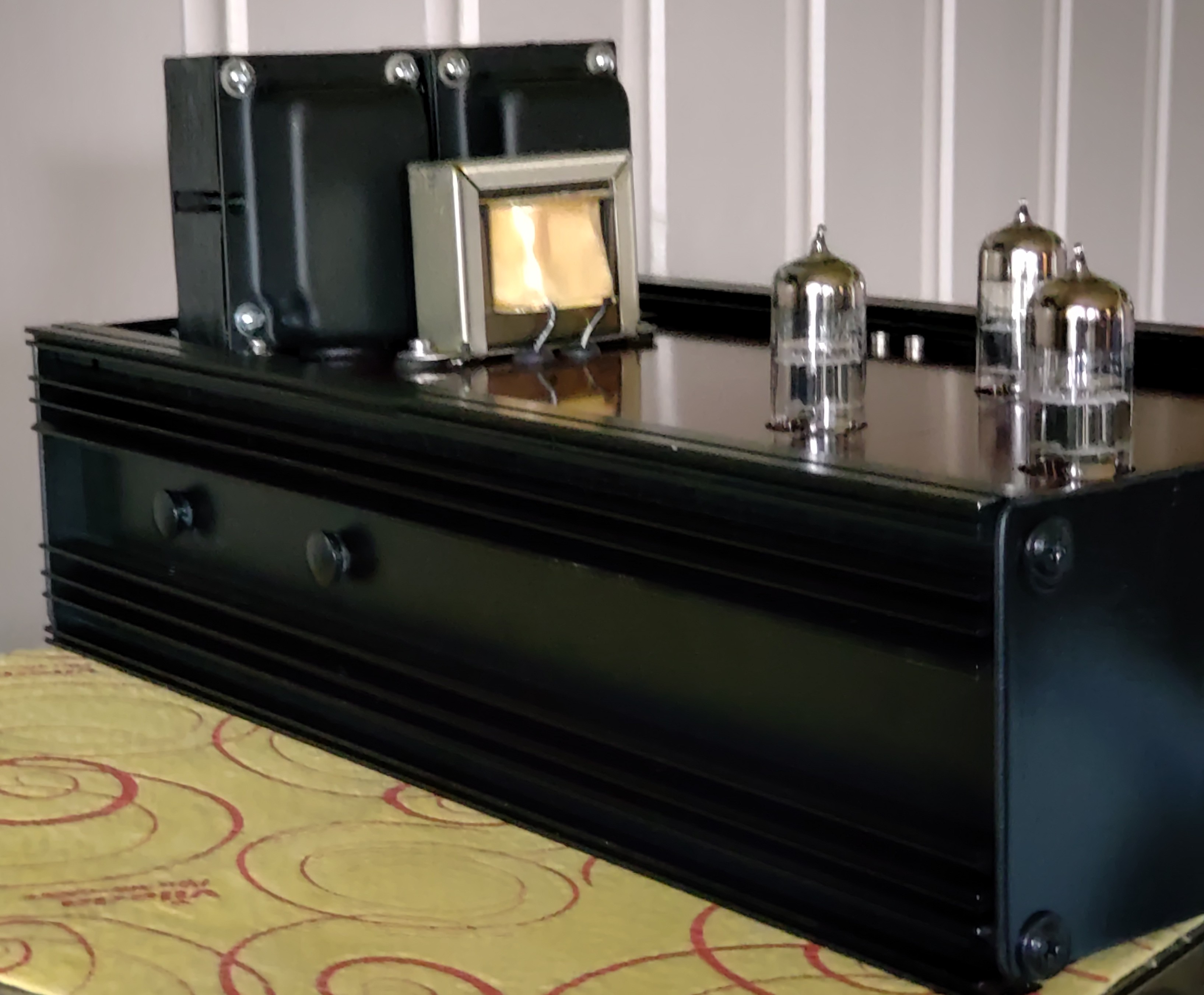

Pictures of my D3a phono
Side panels are heat sinks. The rest is aluminium sheet metal.

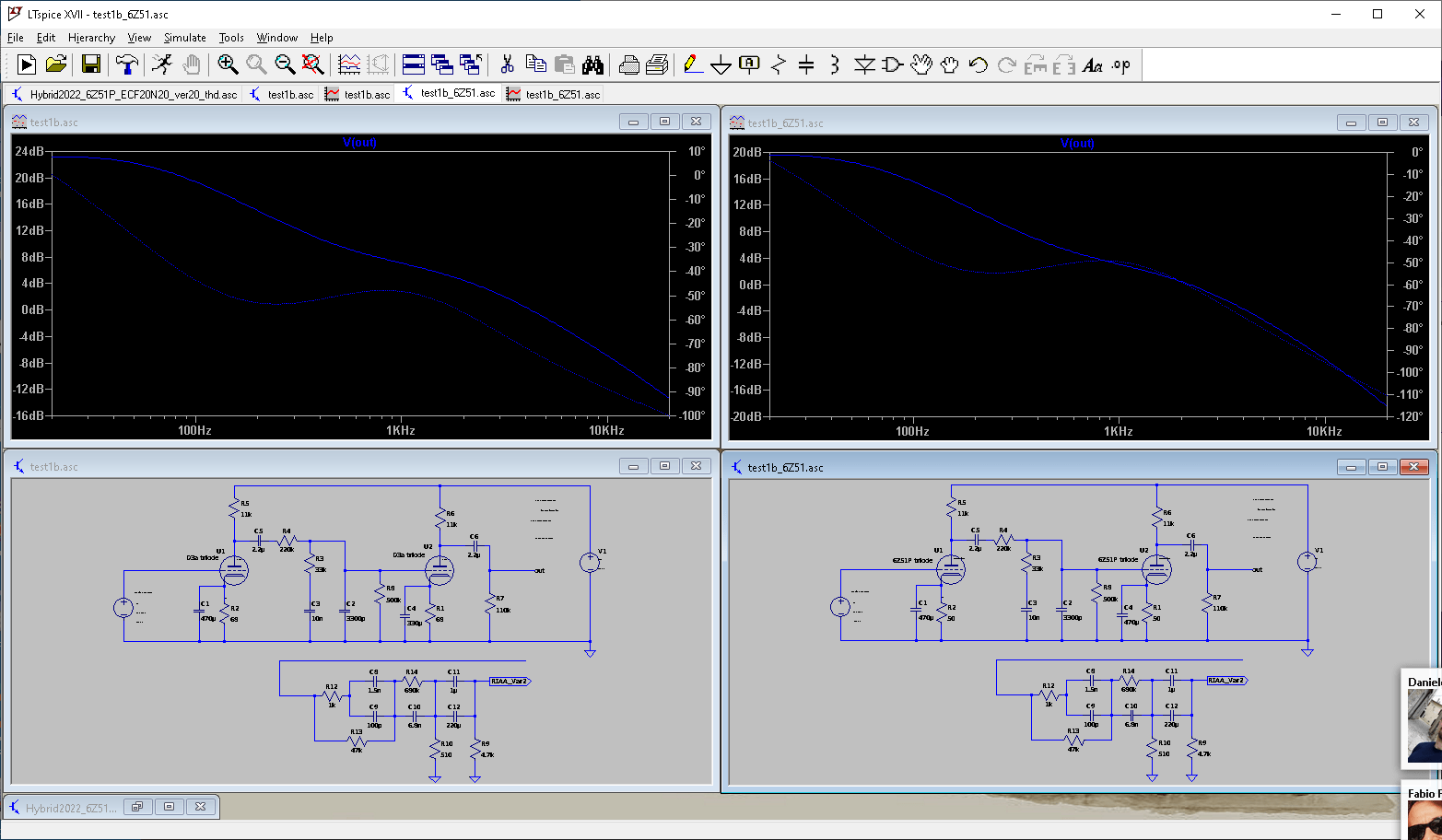

D3a is not easy to find and now are expensive
A good idea should be use 6Z9P - 6ZH9P or 6Z51 but some changes are necessary in RIAA network.
I can try to simulate it.

6z51 can I substitute with ef184?
on the other hand i have 2 D3a tubes can I use in the fist stage D3a and in the second stage 6Z51?
