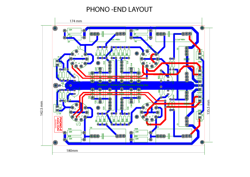

A question for our friend Andrea ( Audiodesign ).
Looking a the schematics of the original phonostage, something puzzles me.
In both the first and second tube the anode resistor is 11k and B+ is 200V. With a cathode resistor of 50R, a basic calculation, with the D3a curves at hand, tells us that the standing current for that configuration is around 12mA. Therefore, the voltage drop across the anode resistors is 0.012*11000= 132V
The tension at the anode is 200-132= 68V. and in the cathode we have 0.012*50= 0.6Volt
My question is : what’s the point of dropping 132V across the anode resistors when a phono stage needs very little room for voltage swinging. The output is usually 2 Vrms, at most. 20 or 30 V peak to peak would be enough.
For instance, with B+=100V and a plate resistor of 2k5 we’d have the same anode tension on the plate (70V aprox), the cathode (0.6V) and of course the same plate standing current - 12mA. We’d have 30 volt across the plate resistors, which is more than enough for our purpose and we’d spare a lot of wasted heat on these resistors. compared to the original configuration with B+=200V. Also, the components of the PSU: diodes, capacitors, mosfets (if any) will be less stressed, We can also use capacitors and transistors rated for less voltage.
Andrea, the only explantion that I can guess is that you had already that 165VAC R-core transformer and you use it for convenience ?.
If somebody wants to build the phono-stage from scratch, wouldn’t be better to use a 80 to 100VAC PSU Trafo instead of 165 VAC ?

The L and R grounds should be separated, at least up to the power supply connector.
Artur5,
Tubes sound better with high voltage and distortion is lower with high voltage.
You can work also with 20V on anode but the result is not the same.
Andrea, if you read well my post, I wasn't saying to put less voltage on the anode. I was saying to keep the same voltage and current, lowering the B+ tension and the value of the plate resistors in order to spare wasted heat in the mentioned resistors and stress less the PSU components.Artur5,

I have been using mine off an on for many years. I Also felt that the bass was a bit low from my turntable so recently I revisited the design and actually put it on a Function generator and an oscilloscope to measure the RIAA curve.
Sadly what i found was that at 50hz the amplfication was 4db down from what it should be according to the RIAA curve.
The simple truth is that the cathode resistor (50ohm) and a 270uF capacitor in parralel with it attenuates <100hz frequencies too much.
I experimented with different resistor sizes and larger capacitors (up to 1000uf) all of them pushing up bass responce. But in the end settles on using a Infrared led in place of the 50ohm and 270uF cap.
I like the idea of removing the Capacitor. The LED changes the cathode voltage up the 0.5V cathode voltage to 1.15V
BUT
There is SO much more bass! And using the function generator and oscilloscope i measure correct RIAA curve to within 1db.
With the 22K resistor and 210Vdc B+ I measured 105V accross resistor wchich calcualtes to just less than 10mA bias through valve.
I was very close to changing 22K resistor to 10mA current source but decided to rather use with 22K and LED for the time being.

Sorry @tangmonster, but biasing the D3a with 9.5mA is not the best choice IMHO. The original design is biased aprox. at 12mA, which will give less distorsion, although I'd preferred 14-15 mA for better sound.
Besides, it makes little sense that the RIAA error has much to do with the cathode resistor/capacitor. The tube is not in the RIAA network. The bass drop for a 50ohm/270ufarad combo on the cathode should be very small at 50 Hz -1dB maybe.
The design you mention uses the D3a in a very different configuration : grid 3 to anode instead of cathode, grid 2 to anode trough a 100R resistor vs. directly to anode and also uses higher bias current ( 11mA. )

Again i have to agree, The 270uf cap has 0% to do with the RIAA network, BUT it has VERY much an effect of Valve gain due to adding negative feedback at lower frequencies.
If you calculate the resistance of 50ohm and 270uF in parralel at various frequencies is:
1khz = 0.007ohm
100hz = 0.7ohm
50hz = 2.6ohm
20hz = 12.9ohm
2.6ohm and 12ohm is a large persentage of 50ohm and you can clearly see in the math how it will have an effect on bias/gain at these frequencies.
The higher resistance at lower frequencies WILL give feedback to the cathode voltage which WILL have an effect on gain.
