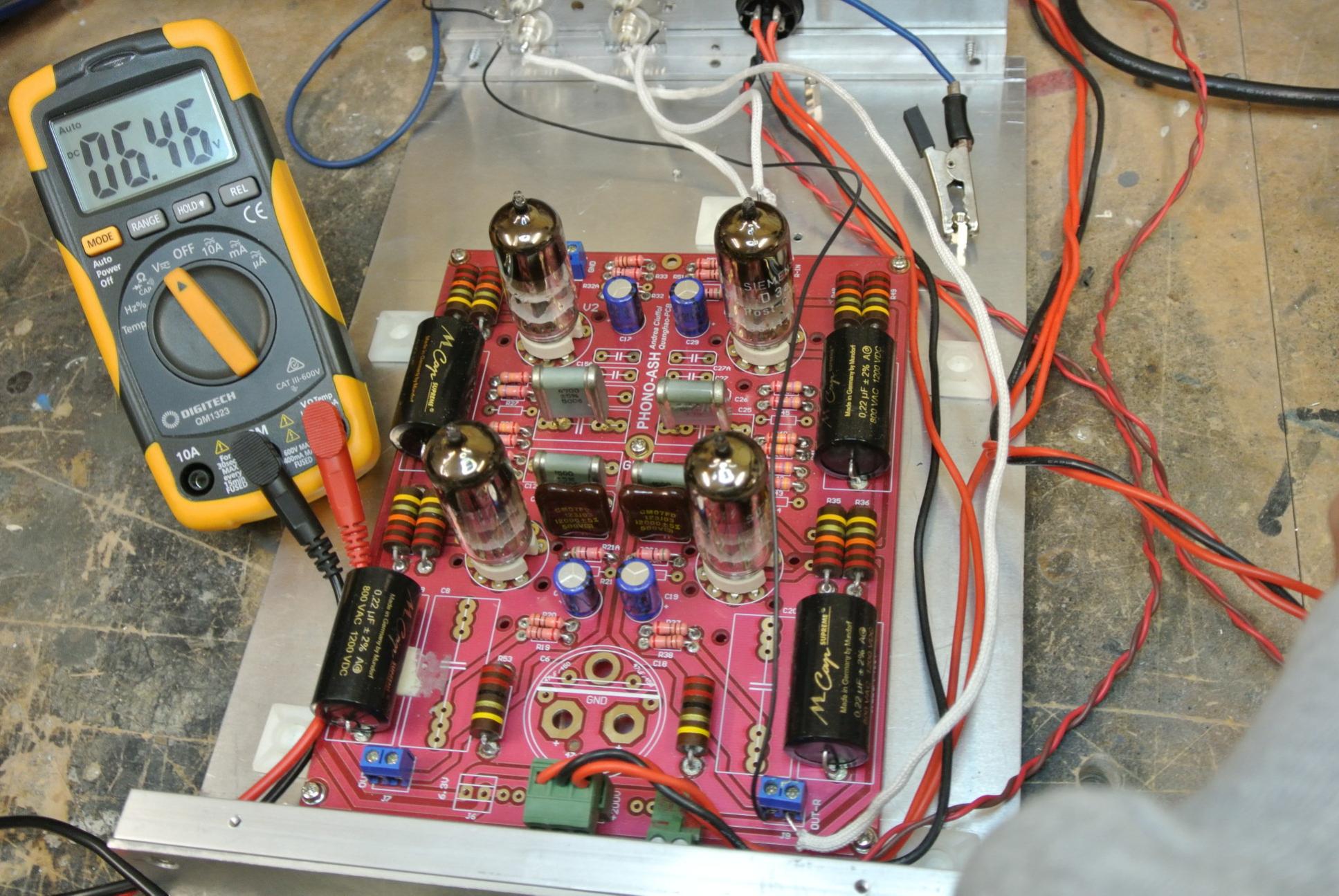

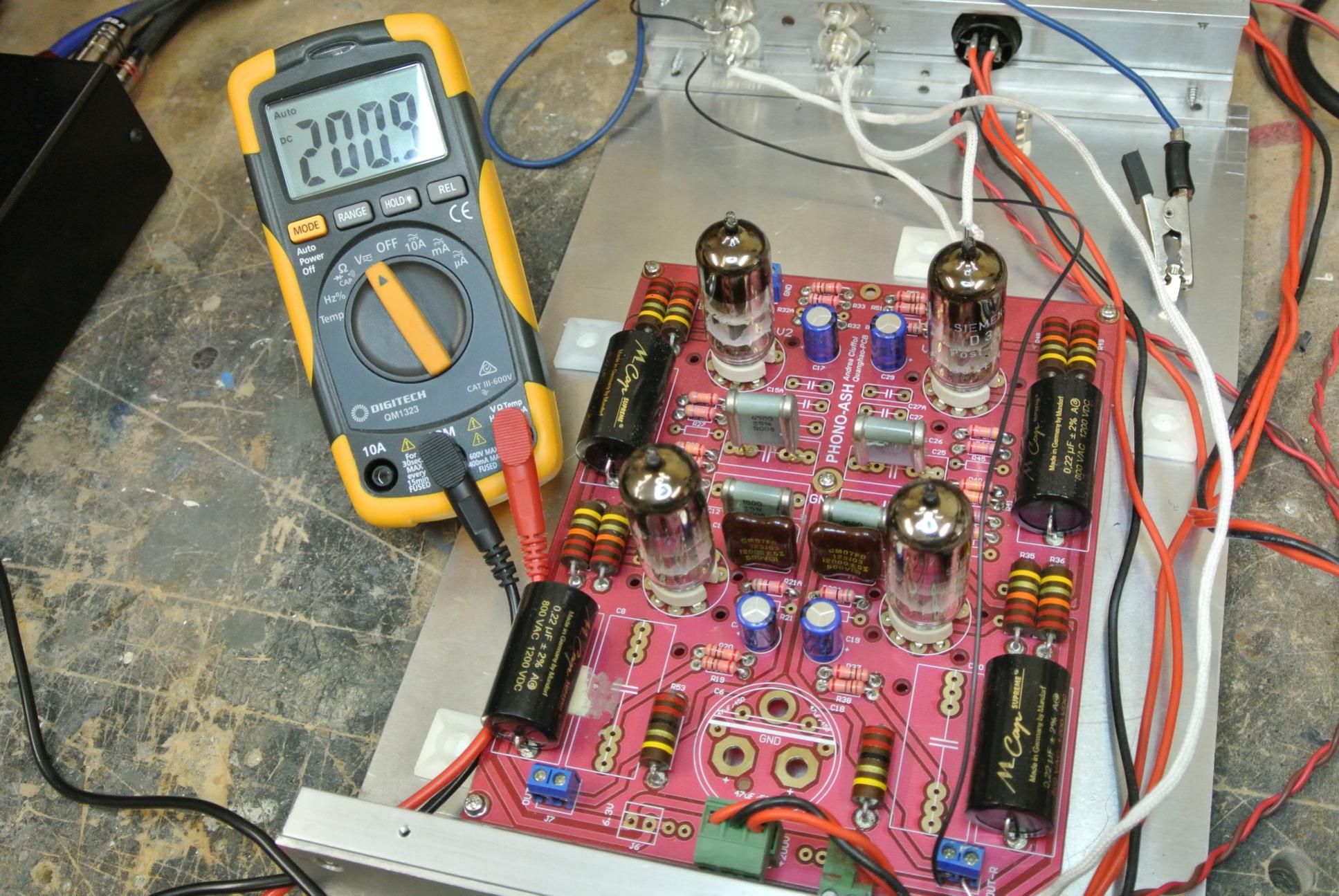

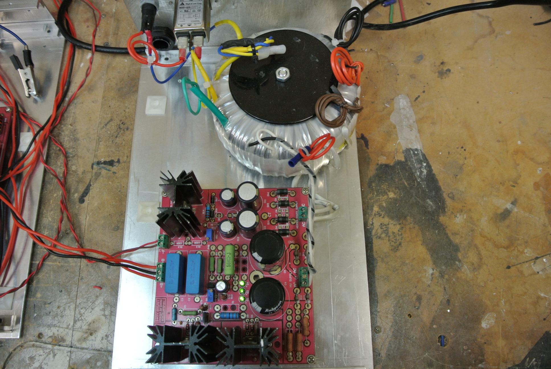

The main problem is that i have quite alot of hum and very little volume the power supply is putting in 6.5v and 203v. Yet when I measure output it is only 1 or 2mv my moving coil is rated at 5mv so with stepup 1to12 I should be seeing more than 2mv is this correct. I will check pin voltages tonoght and let you know.

Hi Ray,
Things have gone from bad to worse here... I now have no output at all, I was taking the MC stepup out of the circuit and placed it on the chassis forgetting it was still turned on and may have caused a short on the bottom of the step up transformer..I need to be a lot more diligent. The Mc transformer is still working fine. Schematics are at post#249.
I took valve pin voltages.
Pin V1 V2 V3 V4
1 .56V .58V .55V .66V
2 .16V 0V .20V 0V
3 .56V .58V .55V .57V
4 .10V .11v .10V .10V
5 6.3V 6.3V 6.3V 6.3V
6 2.5Mv 2.5Mv 2.5Mv 2.5Mv
7 72V 65V 74V 66V
8 .56V .58V .55V .57V
9 72V 65V 74V 66V
I have attached pics of my setup, and thankyou soo much for your help.
Regards Jerry

Hi Ray,
Things have gone from bad to worse here... I now have no output at all.
It's not likely that the audio circuit was damaged, especially in both channels.
I would say it's the power supply, but the supply output voltage is normal.
Are you measuring the supply voltage at the audio board, or on the supply board?
The tubes light up, right?
Hi Ray, V measurements are at the audio board and yes the valves do still light up. I have some new electrolytic caps and also new silva micas for the riaa stage coming from hifi collective but they will not arrive till next week. Could it be that the second stage coupling cap needs a different value as the circuit suggests 0.22uf to 2uf i have 0.22uf. I am thinking about getting an oscilloscope hopefully this will help once I grasp the basics I am thinking maybe trace the signal path to see where it is falling down. My father was an avid electronics hobbyist I wish I had taken a greater interest when he was alive....but when your a teenager other things occupy our minds.....lol
You have some simple, basic problem, Don't start replacing parts
until the problem is localized.
First, check the DC voltage wrt to ground at each end of R53 and R54.
I have gone over circuit and for the life of me cannot see anything obvious.
Also it is possible that several resistors are the wrong value from reading the color code wrong.
With all power removed, measure all of the resistors and see if they are correct.
It almost has to be something like that, if the power supply is working.

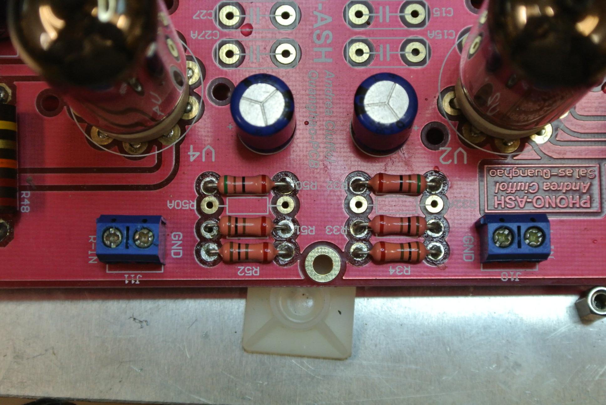

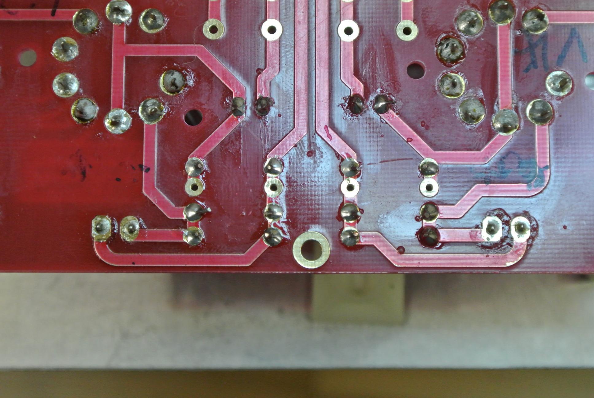

Hi Ray,
Great news I have got sound...lol... although it isn't very loud but I hope there may be something we can do to increase output..... it turns out that the input + and - labels are wrong on the board so I was basically shorting out the board to ground through the input rca. Is there anything I can do to increase the output.
