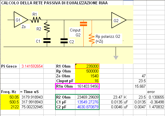

Which RIAA network are you using, new or old values ?
old values ?
first interstage cap. 0.1uF (6.7Hz at -3dB) or 0.22uF (3Hz at -3dB)
RIAA
2 x 470K 1/4w 1%
2 x 47K 1/4w 1%
0.0135uF = 0.012uF + 0.0015uF = 12nF + 1.5nF silver mica
0.0046uF => 0.0047uF = 4.7nF silver mica
Rg = 2 x 1Mohm 1/4w 1% like original Phono 4
output cap 0.47uF (3.4Hz at -3dB) or 1.0uF (1.6Hz at -3dB) on 100K load (stepper attenuator)
change output resistor after cap to 2 x 1M

"first interstage cap. 0.1uF (6.7Hz at -3dB) or 0.22uF (3Hz at -3dB) instead of 2.2uF original"
what resistance did you use to calculate that?
"output cap 0.47uF (3.4Hz at -3dB) or 1.0uF (1.6Hz at -3dB) on 100K load (stepper attenuator) instead of 2.2uF original"
what resistor did you use to calculate that? does the 2 x 100K resistors on out not form part of this equation?
Ft= 1 / ( 2 * pi * R * C) = 1 / (2 * 3.14 * R * C)
C = 0.22uF = 0.22E-6
R = 235K
FT = 1 / (2 * 3.14 * 235K * 0.22E-6) = 3Hz
C = 0.47uF
R = 100K (attenuator)
FT = 1 / (2 * 3.14 * 100K * 0.47E-6) = 3.4Hz
R = 235K
C = 0.47uF
