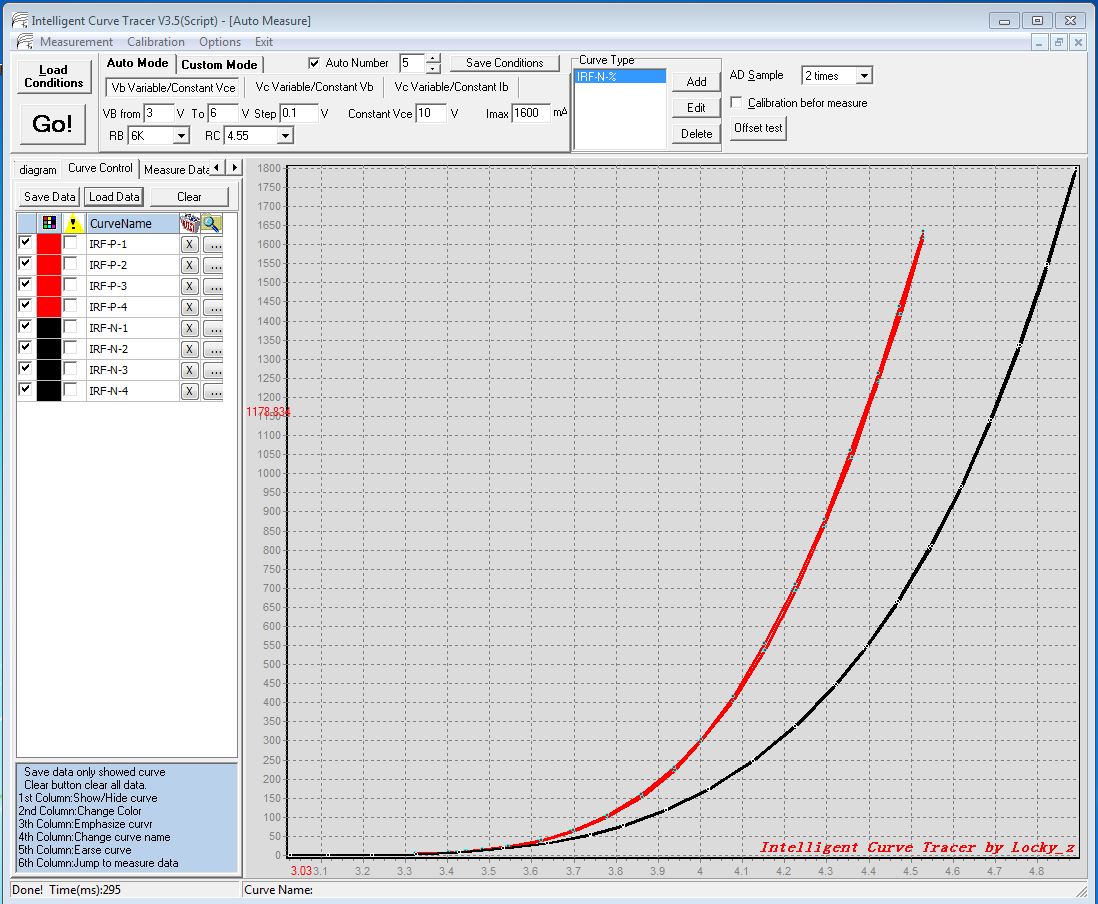

This used the Fairchild output devices and pot location assumes that P
channel Vgs is slightly higher than N. You can use other devices.
is this the right combination of N and P channel Nelson suggested…..?
