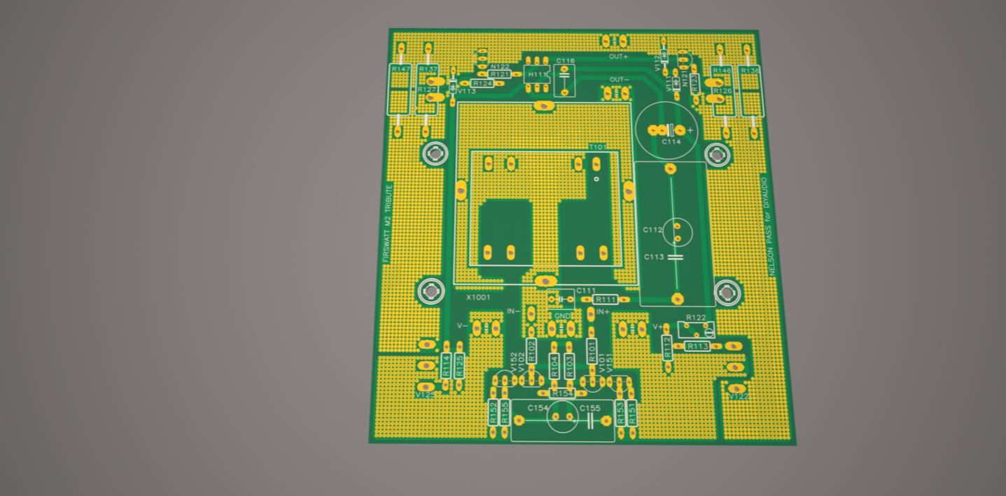

PSU (for one channel):
- 1x 300VA toroid transformer
- 4x STPSC1206D (SiC 600V@12A TO220)
- 1x 10000µ (MKP bypassed)
- 1x 159ZJ
- 1x 15000µ (MKP bypassed)
What do you think?

Zen Mod would say what's with the sissy capacitors.
you'll need 2 x 10000u and 2 x 15000u to create +/-22V power rails
I'd go with 4 x 15000u per channel bare minimum. Aaah just make it 8 x 15000u per channel
... and using CMC?

2603 or 2105 look good. I'm no expert on chokes, you could increase mH a bit more but then Ir comes down, best to keep a healthy safety margin.
Zen Mod could advise with more experience.
