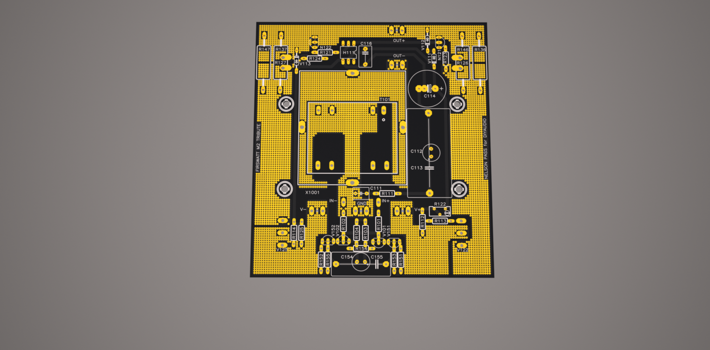

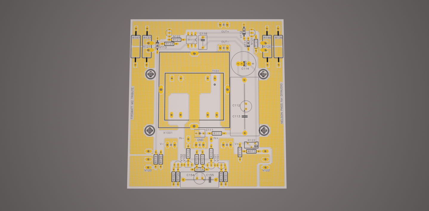

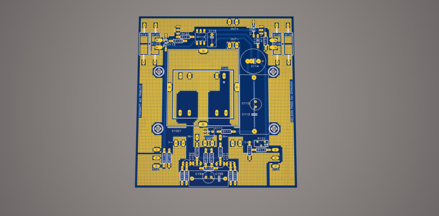

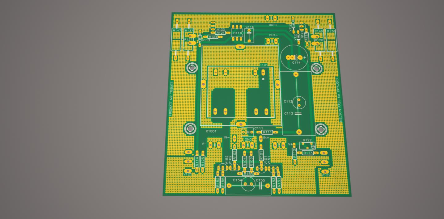

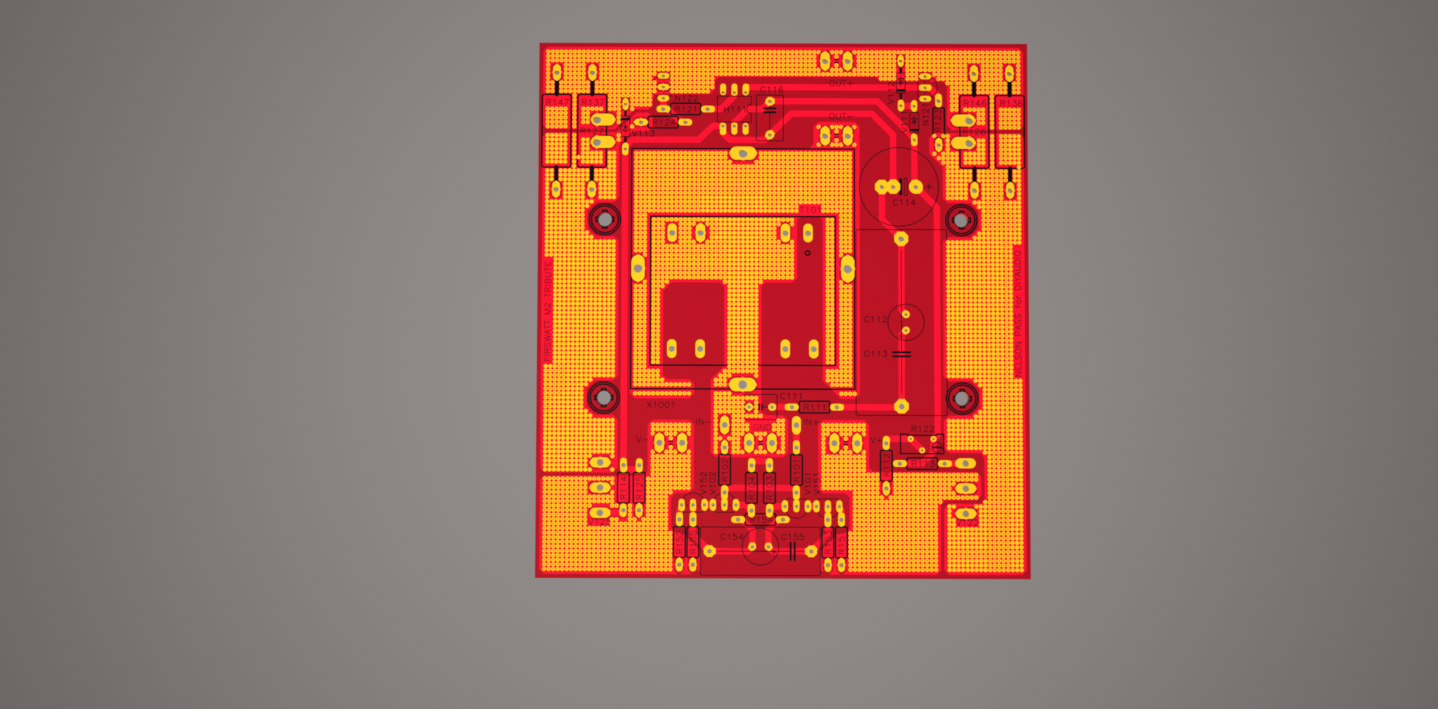

DRC/ERC done.
Someone to check pinning (spacing) of the transformer (I found TRIAD equivalent with different spacing for pin 1 and 2)?!
We have to agree about colours for silkscreen and soldermask.
Here the pair prices, all boards ENIG, 2x35µm, E-tested (without shipping):
- green/white --> 15€
- blue/white or black/white --> 17€
- red/black or white/black --> 19€
Not sure this is what you meant: I don't have eagle so I took the measurements off a 1:1 print-out. There, the pin spacings (within my accuracy) match the drawing on the Edcor web-site. Also the outer dimensions of the transformer and the TEKO housing seem OK.
