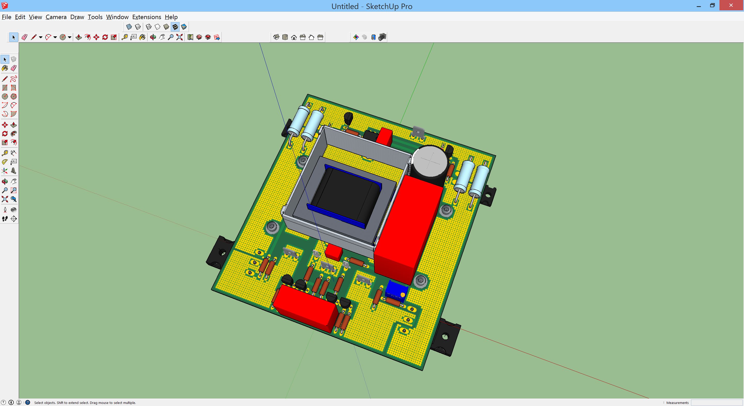

Would there be an advantage to replacing R3 and R4 with a 200 ohm P2 as in the most recent versions of the F5 to adjust offest to minimal distortion?
Ha haha ok I have it thanksIt gets to the right Class A current promptly enough. The performance of the
parts themselves are not solely a function of bias, and you do not reach the
final spot until the heat sinks have warmed up.
You can use a hair dryer to speed up the process if you like.
It would allow you to play with it. That's a real advantage.
