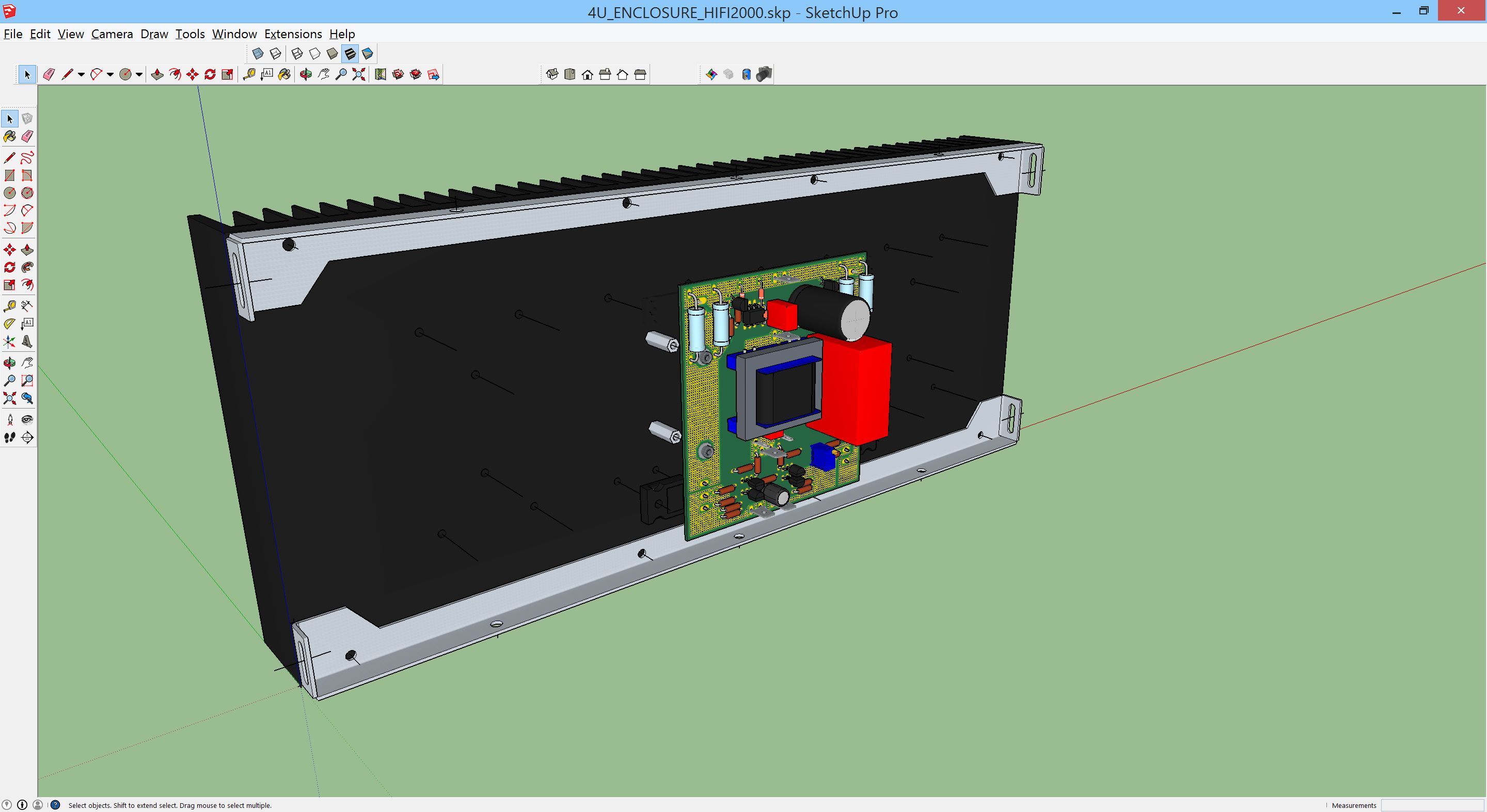

... first heatsink mounting...
will modify the PCB for transformer shielding...
Jean-Paul
