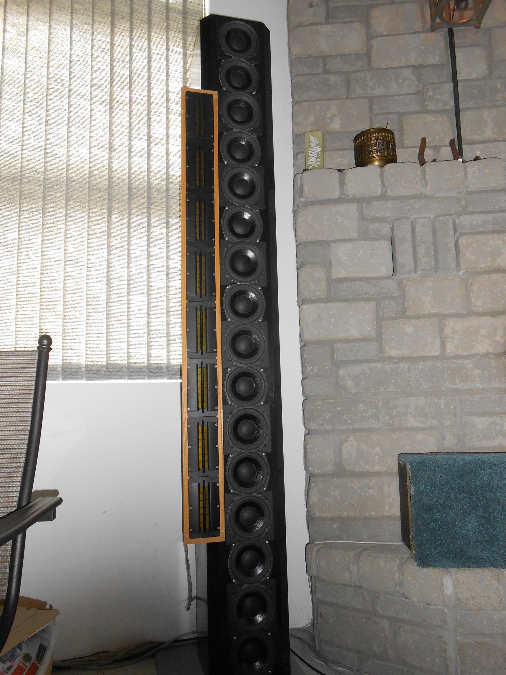

Here are my home-made line arrays, subs are not shown.

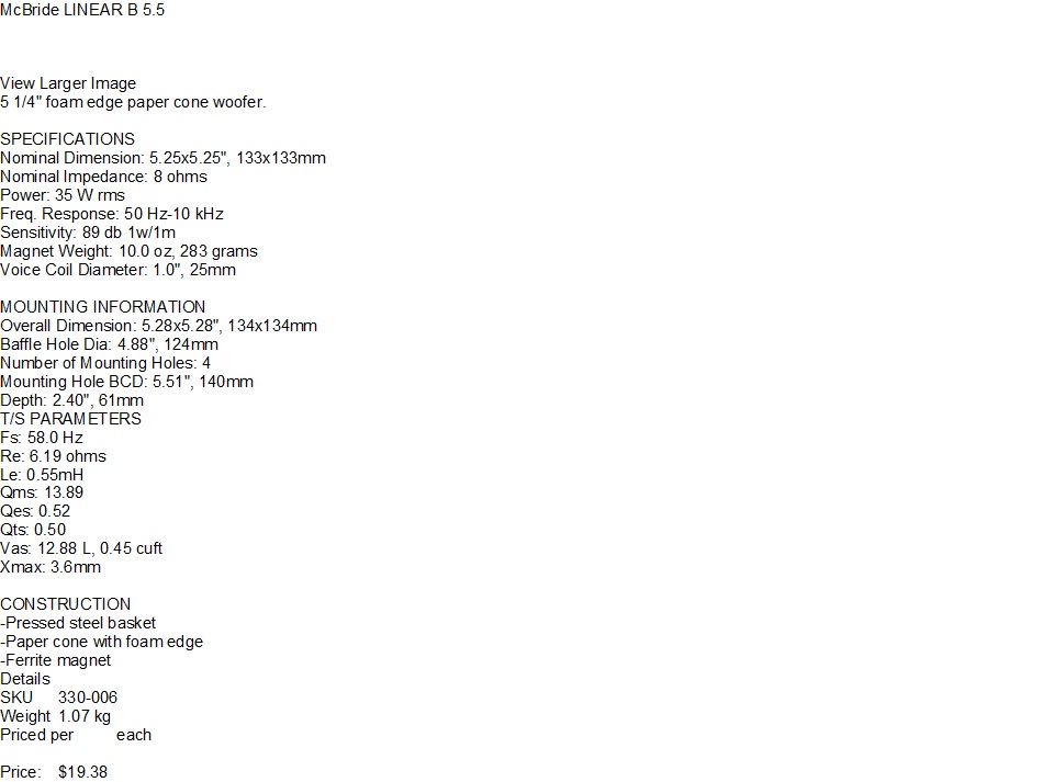

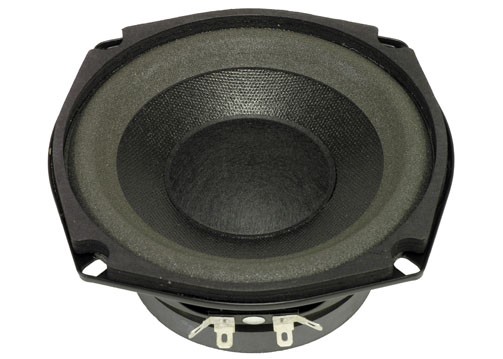

Hi fluid; Attached are the specs for my mid drivers. I figured an X max of 3.6 mm would have been sufficient. I believe the speakers are made in china, given a Canadian name by the distributor in Canada. Price was an issue with my design requiring 32 drivers for 2 channels.

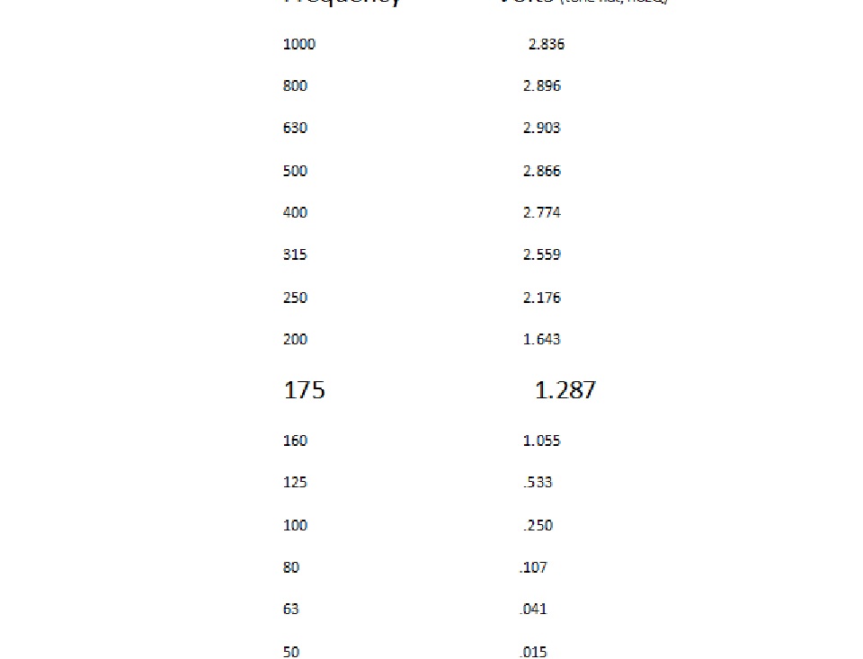

Here are the voltages measured at the power amp. Trying to keep things somewhat scientific, I used the 1/3 octave frequencies and 1 watt at 1 kHz.
Hope the numbers are legible.
Thanks again, Peter
There doesn't seem to be anything in the spec sheet that would cause a problem. Fs is low enough sensitivity is quite high and with 16 it should be OK. I suppose it depends on your playback level. If your levels are loud enough to force the drivers to xmax that is very loud.
