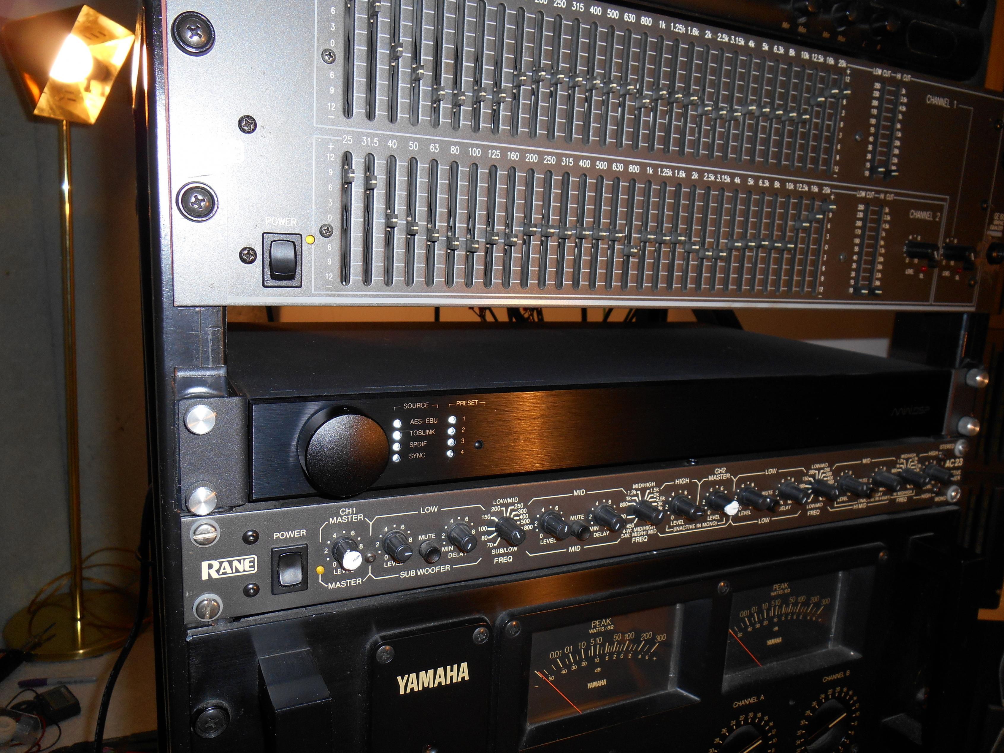

Hi Guys;
Thanks again for your guidance. Regarding the noise issue. When Even has time, I will persuade him to elaborate on the type of noise issue he is having.
Hi Fenalaar;
Thank you for your info regarding usb galvanic isolators. I was not aware of their existence and will keep this in mind if it becomes an issue. I have some experience with ground loop issues, in analogue systems, and have taken precautions in the form of (I believe the term is) ''star topology". All components have a 14 awg chassis grounding wire connected to a common central point. ( see attached photo, left side). I have even taken precaution to isolate all components from the rack by way of plastic shims behind rack ears, and plastic sleeves and washers on rack mounting screws. This was a bit of a trick with the 80 pound bass amplifier! (note nylon support feet at rear of lower amp) If the noise issue was hum, I would feel comfortable tackling this, as it would be 'an outside issue'---as Bill says.
Hi fluid;
You mentioned a 'zipper noise' which would not be an issue for me, if it was just during changes to filters. It may be a concern to drivers (and ears) at high levels, but I can't imagine such an advanced audio product being released with those flaws. I could be surprised...
From my analogue background, I know that no cable changes etc. are made without the power amps off or at least volume down, but I am amazed how well behaved the Creative sound card is, and it was very inexpensive. The usb input can be connected to the sound card, with amps up, without so much as a 'click'.
To the point;
Fluid, you suspect correctly that introducing another filter program on the laptop, is pushing me out of my 'comfort zone'. I have two arguments in my defense!:
1) Regardless of the quality of the additional program or process, would it not be better to extract the media from the laptop, as 'bit perfect' as possible, and keep the number of processes to a minimum?
2) (and I think I got you on this one!); If tone controls are done on the laptop as you say; 'tone control would be easier to use if it was part of the player software, no need for the realtime usb control of the minidsp'
Am I correct in thinking that this would not allow real time control of other inputs to the minidsp, (CD/DVD player, and an analogue input, in this case from a satellite TV receiver)?

Hi fluid;
The minidsp units are really not that advanced, they use fairly basic off the shelf components and put them together in a nice board at a very reasonable price. Many of the possible glitches come from how they are interfaced and used with computer equipment. If you have a good computer set up correctly it should all work fine, but it is very easy for something to be incorrectly set or configured in a computer based setup that minidsp has no control over.
Processing audio in real time is not that taxing for modern computers but a computer is not often set to be a realtime device many different processes are being multitasked, if one uses more resources at a given point others can suffer and this is sometimes where glitches happen. Worst case scenario is once the changes have been made everything will settle down again so if this is OK with you then don't worry about it.
My point is these sorts of things are very system dependant, it might happen to you or it might not and there is really no way of telling until you try it!

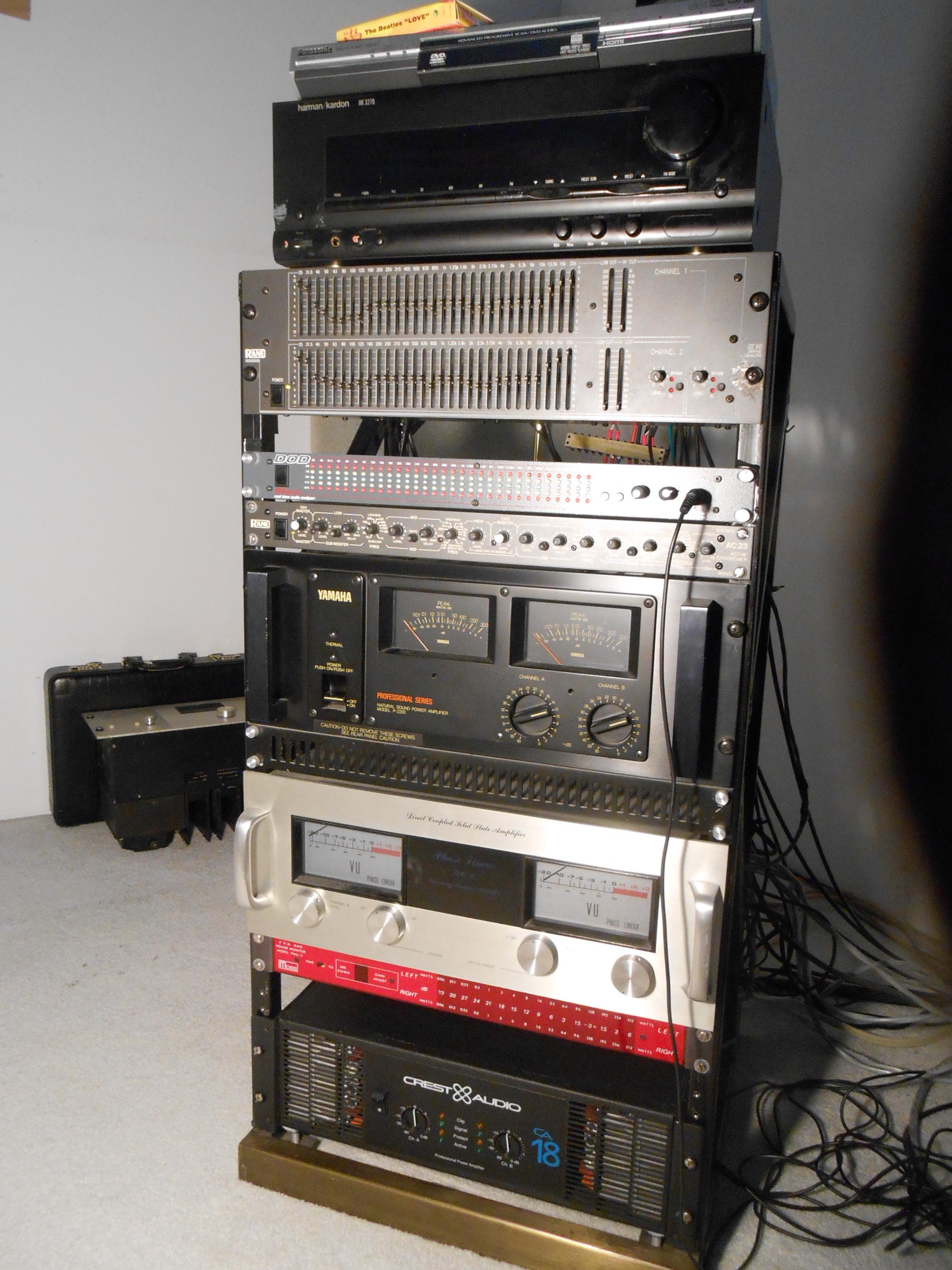

Hi Folks;
My minidsp 4x10 should be here this week, I have already purchased XLR plugs, balanced mic cord, and an optical (fibre) cable. As luck would have it, my favourite DVD player is going 'fins up'! I was hoping to eventually buy a dedicated laptop for the sound system--budget is starting to be an issue.
If I have no luck trouble shooting the DVD player, would a replacement have to be 'top of the line', considering video is extracted via HDMI and audio via digital optical?
Thought I would through out one more frivolous question, before the cheese gets binding..
thanks, Peter in Canada

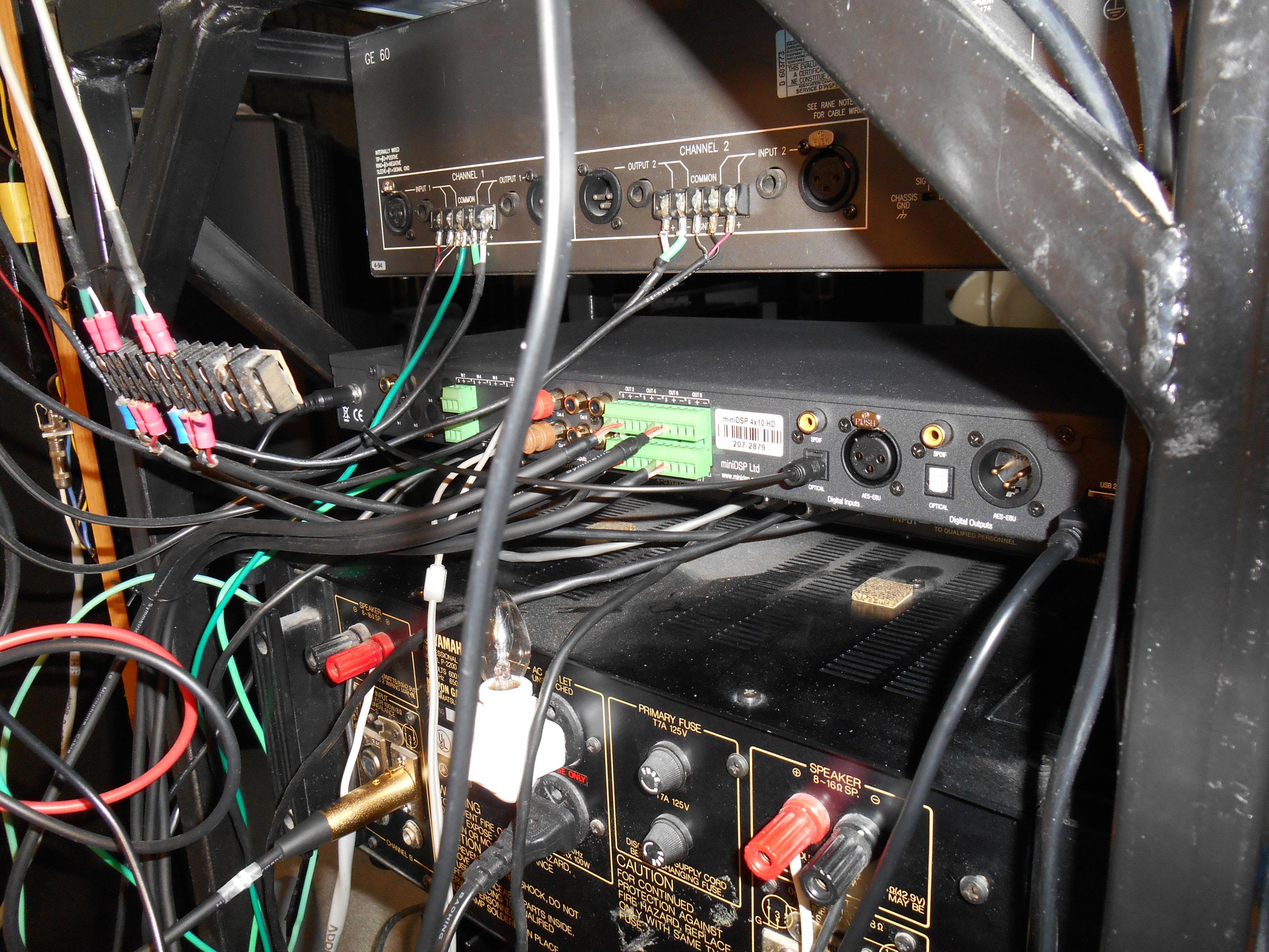

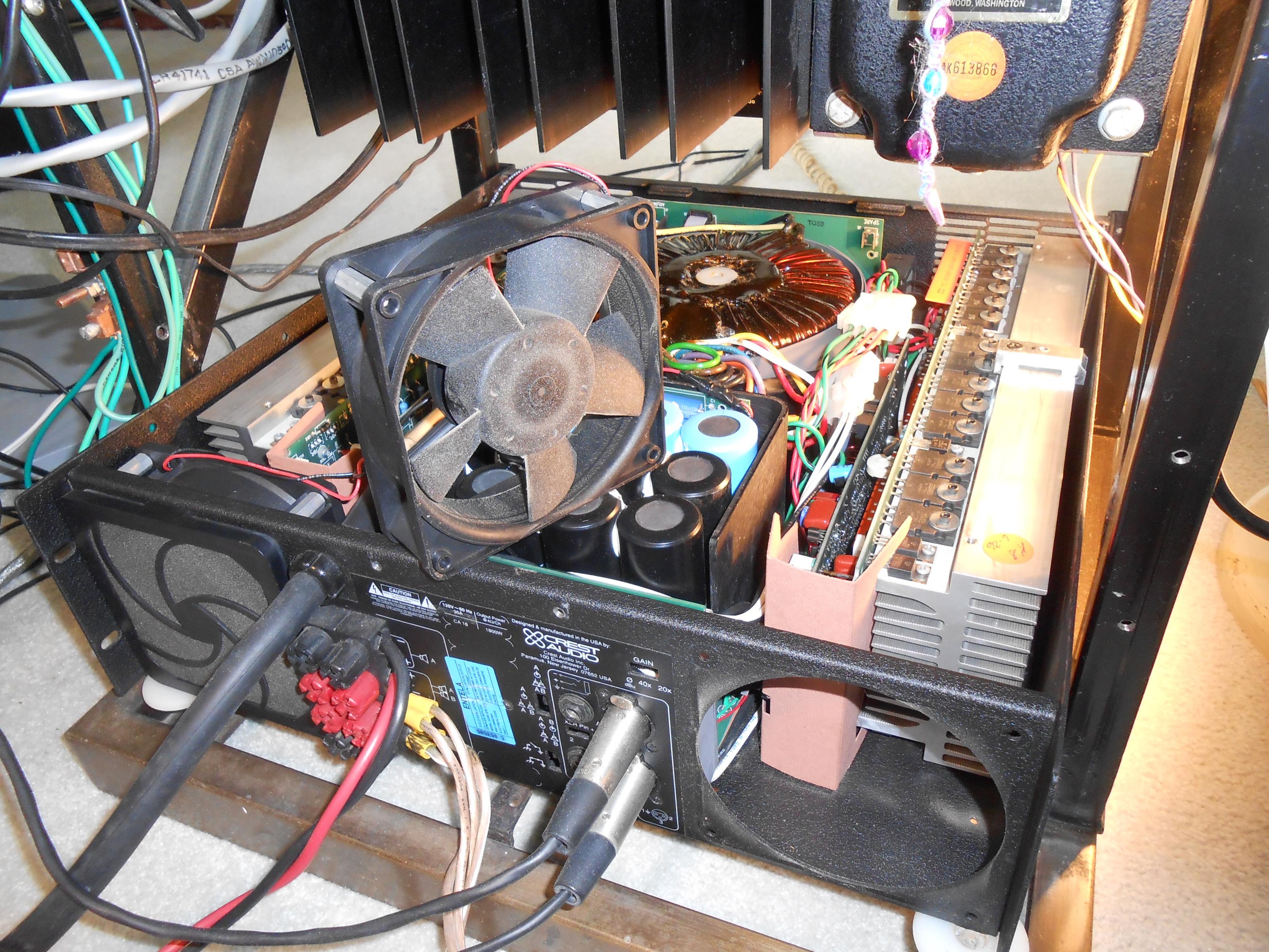

Hi Folks;
Christmas came early! It was a little anti-climactic, the minidsp lacks the shiny buttons and flashing lights to impress the innocent. I was pleased with the visual quality of the test mic, better than the plastic mic that came with my DOD RTA.
I am extremely pleased with this unit so far! I am making all new cables for this unit, so I can switch back and forth from the old analogue stuff, until I get the dsp fully set up. In the mean time, the rack is a mess of spaghetti.
I could resist having a peek inside. I guess it's like sausages, maybe some things you shouldn't see being made. Can't help thinking there's a good margin in the dsp business. I guess I have to remember that maybe they don't have the same economies of scale of many other audio components.
