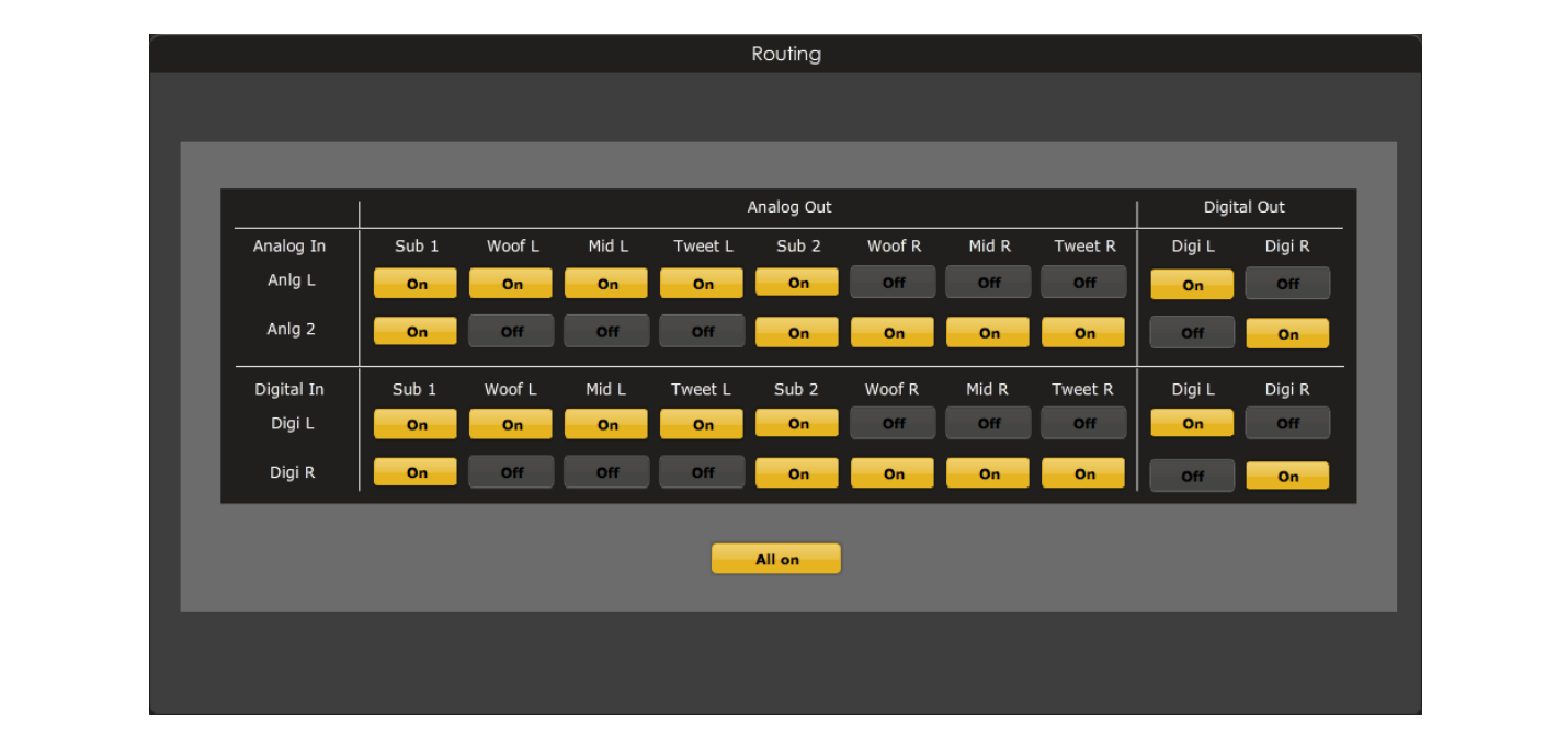

From looking at the manual it seems to me that both the analog and digital inputs are running at the same time, as there is more than one digital source you can select between these separately. It is the routing the signals that sets where they go.
In your setup you will need to route the analog and digital channels the same. But do not have the analog and digital sources running at the same time otherwise they will be mixed together. So to choose analog you just need to switch sources manually by turning one on and the other off or making sure there is no signal going to it.

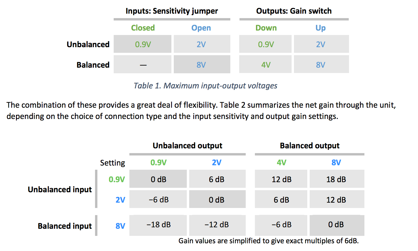

First off it is not dangerous to have an amp connected wide open. This is really how it is meant to be done. It can be useful to have an analog input attenuator if the voltage sensitivities of the amps are very different so they can be matched rather than having to do that with a digital control. This is the reason that identical amps or amps with the same voltage sensitivity are preferred with an active setup.(B) I have a concern regarding an amplifier used for driving my mid range line arrays. It is a Phase Linear 700B updated with WhiteOaks PCB. The volume pots where bypassed, one of several reasons was that the pots were not detented. The only repeatable accurate position for system balancing was wide open. This has not been a noise issue with my old Rane AC-23 crossover. I have been warned about loss of S/N and dynamic range when using excessive digital attenuation, but I see that the minidsp has a selectable output level (2 or 8 V).
Is it dangerous to have an amp connected to the dsp with wide open gain?
The gain settings in the minidsp are a little awkward and the best setting will depend on how you have them connected.
I would have the input jumper set open so it will allow you 2V input unbalanced and 4V input balanced.
The output switch will depend on how much voltage you need to avoid having to use lots of attenuation. This is where it it tricky. 0.9V is quite low for an unbalanced output unless you have a very sensitive speaker system. On movies 0.9V may not be enough as they have a very large dynamic range.
4V balanced will be enough and maybe too much, 8V I think will definitely be too much. So the choice depends on whether you go balanced or unbalanced. I would probably choose 2V unbalanced as the best setting but, this is one of those things you will have to suck and see. Try with a low voltage first and see if you can get it loud enough, if not up the voltage. Ideally you want no digital attenuation when you have it as loud as you ever want it to go.

In other words; Would switching between my 3 proposed sources ( analogue stereo, optical, and digital Coaxial (SPDIF)) be more than a straight forward single knob function?
I have a 4X10HD. The only single knob source switching you can do are the three different digital inputs, the analog input is ALWAYS on. If both analog and digital signals are present at the same time, they just play together at the same time. I have not noticed any odd distortions or behaviors, but admittedly I have not used the DSP in this manner for longer than the time it takes to turn off one of the sources.
Another minor issue, which I think I have taken a stab at before; Can I make on the fly, real time bass and treble adjustments. I have my laptop connected to the system and positioned by my listening area now anyway, Thanks
Yes, you can make real time adjustments.
Sent from my iPhone using Tapatalk
The trick with the analog versus the digital inputs, is to make two identical configs. In one of the configs, the analog inputs are muted, and in the other, the digital inputs are muted. You change between the configs to change source.I have a 4X10HD. The only single knob source switching you can do are the three different digital inputs, the analog input is ALWAYS on. If both analog and digital signals are present at the same time, they just play together at the same time. I have not noticed any odd distortions or behaviors, but admittedly I have not used the DSP in this manner for longer than the time it takes to turn off one of the

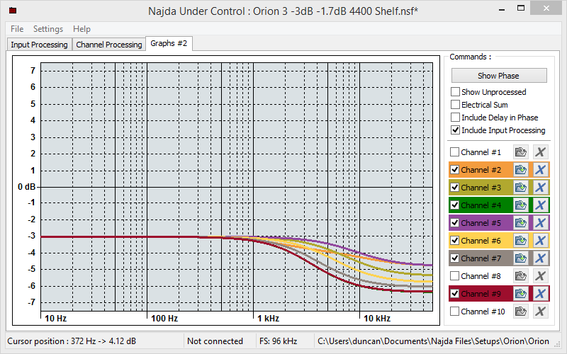

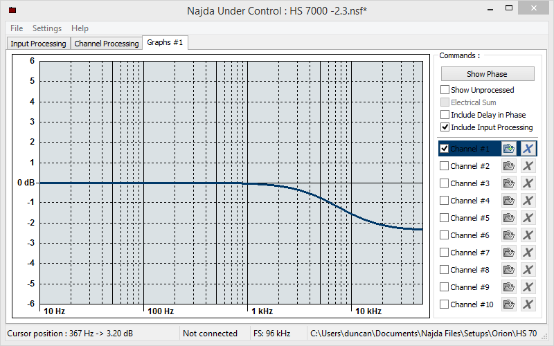

Another thing you might want to think on is this. I have found that be using a down sloping response a la B+K, Harman etc that there seems to be less of a variation between tracks and everything sounds just a bit better. I don't know if you have that already but if you don't give it a try, you may need to fiddle with the tone controls a lot less.
For now I have settled on a High shelf filter at 7K with -2.3dB gain Q6 (although Q varies between programs) This is what it looks like
and this is all the variations I have tried.
There are many different ways to set a house curve but this was the easiest for me as a simple shelving EQ is easy to implement.
