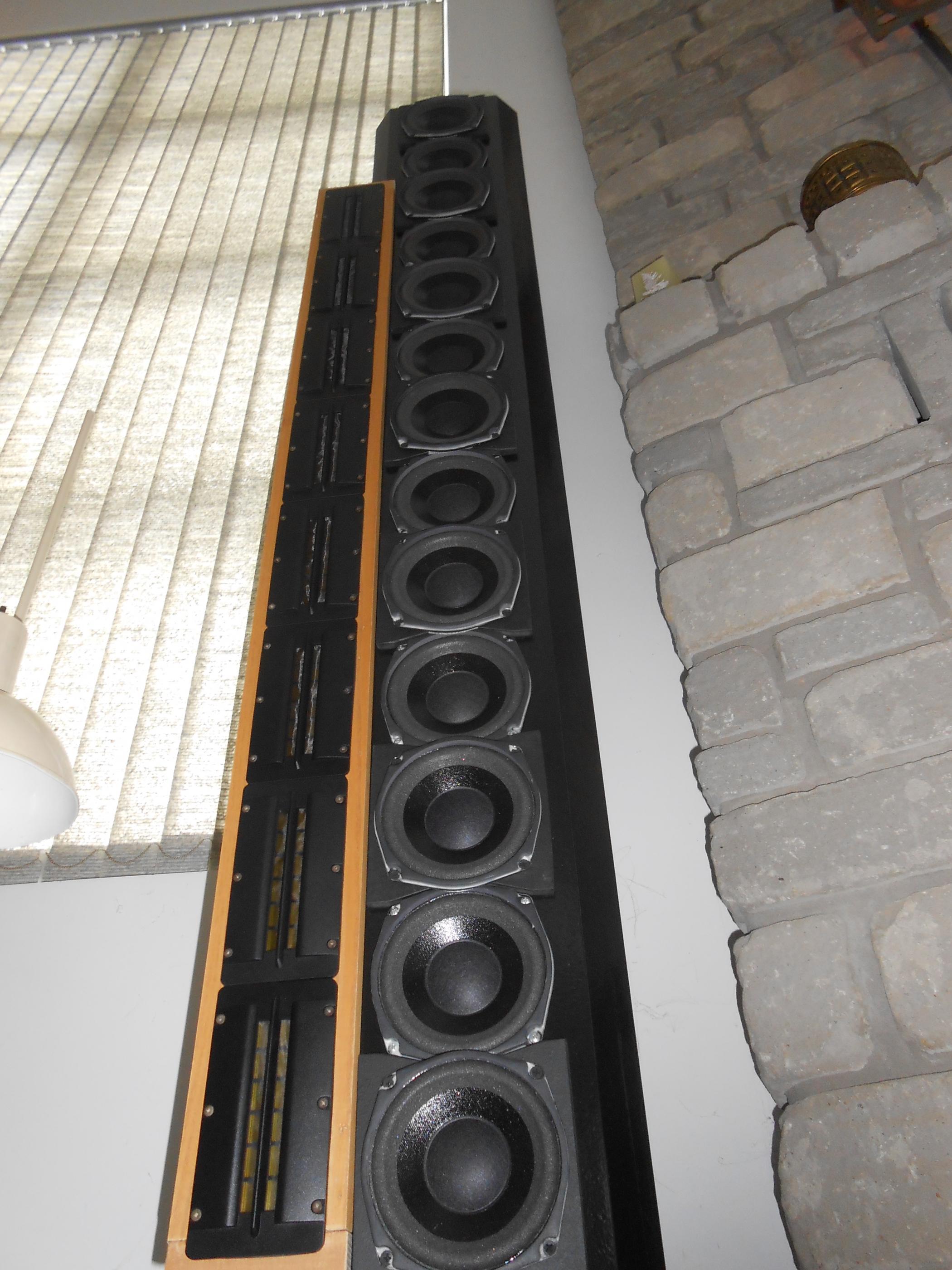

I too wanted a house to enjoy loud music. I built my own mini 'IMAX' theatre living room. There are 7 non parallel walls, approx 32' x 24' overall, with 17 foot ceiling. I seem to have a problem with moderation.

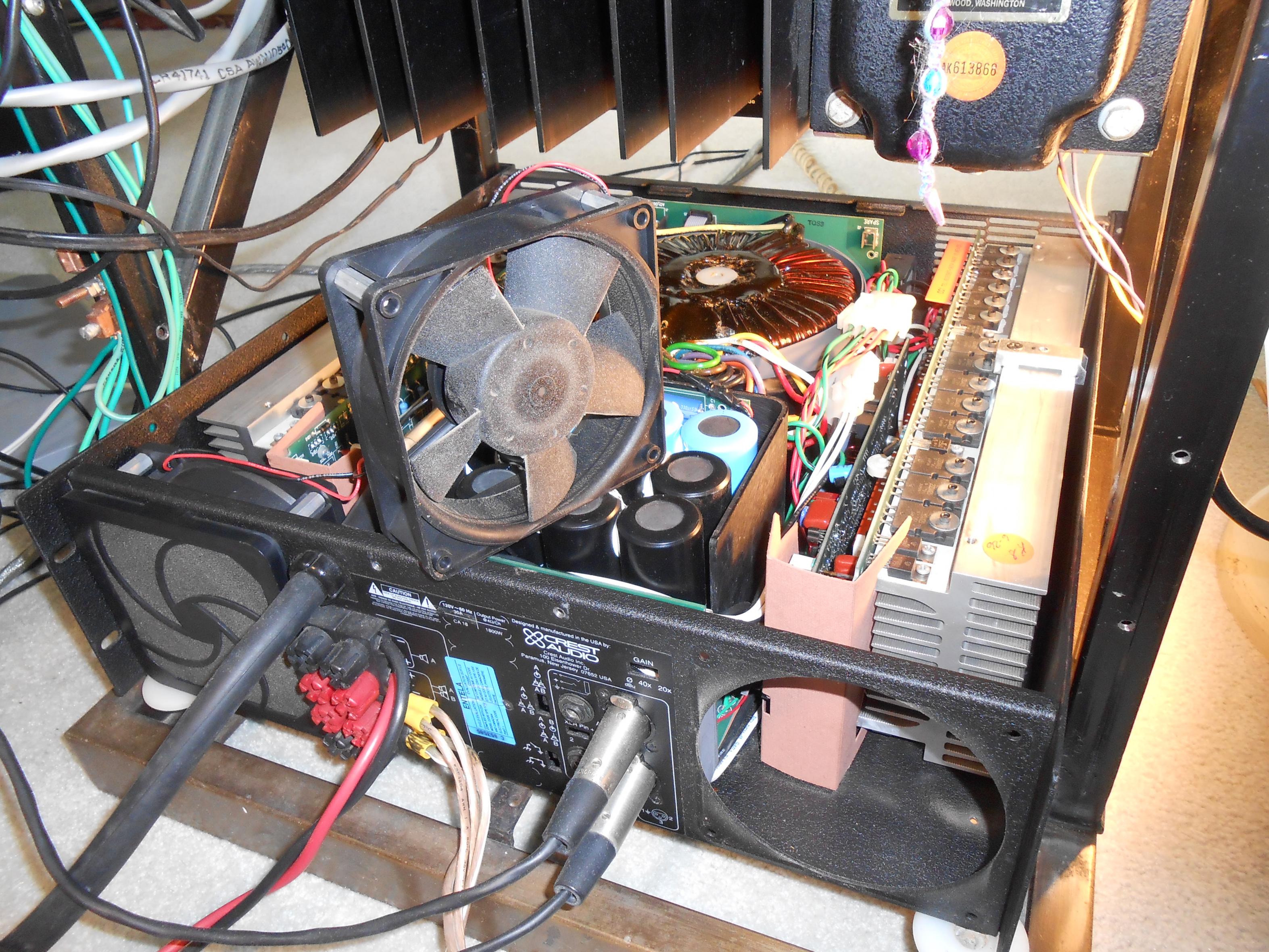

This is a particular concern with my mid range power amp. I rebuilt the Phase Linear 700B with new PS caps, output transistors and a White Oaks loaded PCB. In the interest of noise reduction and simplification, I eliminated the input pots. They had no detentes, so the only way to insure the system remained balanced would have been to run them wide open anyway. This mod also eliminated considerable lengths of internal low level signal routing in a possibly noisy environment. The amp is sufficiently quiet to run wide open in this manner. Obviously, it (and all the amps) are last on, first off.

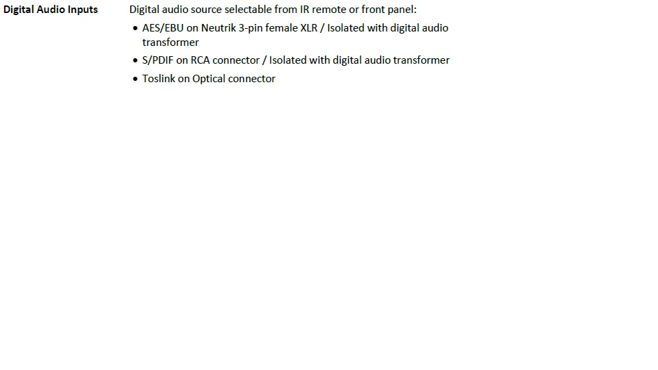

You can use Najda to get a stereo digital input using spdif or usb.
Than there are a couole of options
1.use on board dacs
2. Use i2s out and conmect your own i2s dacs
So this gives you flexible options.
On the other hand if you dont want to use dedicated dacs, there is a solution built by Trabquility-bass
It has on board ess dac simialr to Najda amd cam provide you with multi channel analog output l. But wont allow you to have multiple i2s outs at this stage

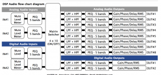

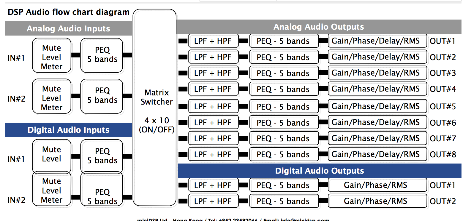

As to gain structure in the dsp; as mentioned, my requirements were as Pre amp (bass, treble, balance, input switching), EQ, and Crossover, with master gain ideally after the crossover IMHO. Do these individual software 'plug ins' each require level adjustment, and could all these level adjusting processes be a source of noise, in them selves?
This is the structure of the minidsp.
Volume control is done at the start, but as it is done digitally it really doesn't matter in this situation.
The Najda is similar it has input processing, per channel processing and analogue volume control at the end of the chain.

As shown in your screen shot above, the minidsp 4x10 has 2 analogue inputs and 2 digital. The rear panel has 3 types of digital input. Could I utilize both the S/PDIF (RCA) and Toslink (Optical) by leaving both connected and simply switching off one unit or the other (CD player or Laptop via sound card w/optical out, as source)?
Second issue; You mentioned " Volume control is done at the start, but as it is done digitally it really doesn't matter in this situation. The Najda is similar it has input processing, per channel processing and analogue volume control at the end of the chain." Just to clarify, does the minidsp use digitally controlled analogue volume controls in the boxes marked "Gain/Phase/Delay/RMS"?
Pete you are nowhere near testing my patience don't worry 😉
Those inputs really represent Left and Right. Any of the three digital inputs or analogue can be selected as the source and yes you would leave them connected all the time no requirement to switch them off if you don't want to.
The miniDSP does not use any form of analogue volume control it is all digital. The volume control which is at the start will set the overall input level to the DSP from the source, the gain is a per channel setting which can be used in the crossover sections to adjust the relative volume of the drivers to adjust for sensitivity differences or differences in amp sensitivity if they are not all the same.Second issue; You mentioned " Volume control is done at the start, but as it is done digitally it really doesn't matter in this situation. The Najda is similar it has input processing, per channel processing and analogue volume control at the end of the chain." Just to clarify, does the minidsp use digitally controlled analogue volume controls in the boxes marked "Gain/Phase/Delay/RMS"?
As mentioned above the analogue inputs are better used with actual analogue sources such as a turn table, reel to reel etc. If the source that you are using is digital keep it that way into the DSP.
It is always better to avoid AD and DA conversions wherever possible but also a single extra conversion at the end does not do a significant amount of damage. The real difficulty comes from being able to set the input levels correctly to avoid clipping while still keeping the signal level high. I have listened to a few tests or the gearslutz forum where studio tracks have been output directly from the DAW and processed through an AD and DA converter and it was really difficult to tell them apart, there were differences but to actually choose which one was which consistently not something I could do. And these were fairly basic converters, not Mytek or anything fancy.
