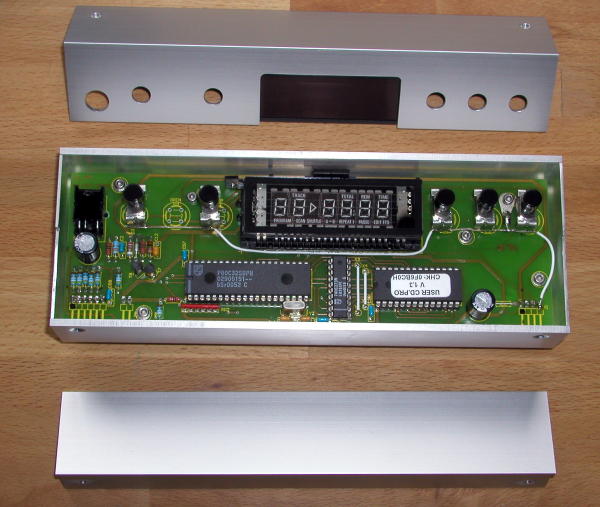

non oversampling
Sorry, maybe my information just posted is out of date? Do Homeoptics supply the same display module as is specified on Daisy-Laser site? http://www.daisy-laser.com/display_tn1.htm
If so then the user can control the mode and sampling rate by the use of jumpers on the display pcb as per the following:
http://www.daisy-laser.com/downloads/products/CD/modules/anslmk39901.pdf
I find this of interest in a number of ways for experimenting with easy selection of different modes I2S, EAIJ and different sample rates 1 times (non), 2 times and 4 times oversampling.
Anybody know about this?
John
John

Re: Non Oversampling
I've built the display board but didn't see any jumpers to set sampling rates. Maybe it's done in a software?
jkeny said:
- a second way of achieving the same objective (and possibly better permanent solution) was to buy the display module from Homeoptics which If I remember correctly has various jumper settings which allow the user to set modes and sampling rates ( am I correct here?). Only problem for me was Daisy (Nico) does not sell display module seperately, he will include extra display modules with CD Pro purchases and this may well be an avenue worth looking into if there is any interest.
I am launching this out there to see if it floats

About displays...
The display-unit for the "PRO" ( http://www.daisy-laser.nl/homeoptics/ ) is not the same as this: http://www.daisy-laser.com/display_tn1.htm.
And you will not be able to buy it as a private...
(or anything on the http://www.daisy-laser.nl site...)
exept the "kit" on these pages: http://www.daisy-laser.nl/homeoptics/
Arne K
