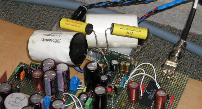

I compared yesterday BG N 4.7V as coupling caps with Hovlands (4U) Siemens MKV (6.8u) and Wondercaps (10u). I think that BG sounded the best and that's what I left in the DAC for now.
It wasn't very accurate test yet, just short impressions of listening to ea. cap, but I think that BG were most detailed and provided the tonal balance I preferred. The other caps seemed to be somewhat slower or laid back or smeared at highs or simply not right.😉
I was using Vishays S102 for 1K resistors and this may have influence here as well, for capacitor prefference. But considering the size and price of those BG caps, they must be regarded as great value in coupling applications.

Because I didn't do detailed comparisons, and I didn't compare cap vs no cap setup, I cannot say that those BG are neutral or the best solution, but from what I've heard so far they are pretty good sounding and definitely worth consideration. They work really well at the output of my DAC and in the gainclones. Some people complain that they are too hi-fi sounding, but I can't complain. Again, for the size and price, nothing beats them, I guess😉
I guess I was too fast raving about BG. When compared to really good film caps they still lack refinment and detail and easyness of presentation. Here, I'm using 3u MIT RTX caps paralleled with 0.022 silver foil caps and they are much better than BG (but the BG are not broken in, MITs are). But look at the size and price (10x more?).
Siemens MKV seemed to sound a bit lean and Hovlands too aggressive in highs and not smooth enough. When comparing BG to the pictured combination, they have nice highs at first listen, but then, when analysing more, they lack in detail, the midrange isn't natural sounding and bass is kind of bloated, also the overall sound is kinda slower.
But I will still be using BG, where size and price is an issue. They supposedly improve much after breaking in, so my comments might not be accurate.😉

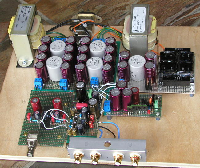

And here's my all out attempt at the SOTA of TDA1543 DAC. I'm using 3 transformers (receiver, dac and clock with logic). The filtering employs chokes and series resistors and is separate for digital and analog section of CS8412. No 3 pin regulators, TL431 for receiver (dig and analog sep), and Elso's regulator for DAC. The reclocking circuit is also based on schematic from Elso and is using 100Mhz crystal and all 3 signals reclocked.
PS is 5V and I'm using Vishay S102 1k resistors for I/V conversion. This DAC sounds way better than my previous one, simple implementation of TDA1543. The reclocking brought much improvement, adding more depth and resolution. I still have to remove DAC chip from a socket and mount it directly, and add more bypass caps, but I'm very pleased with that DAC.
I like very much working with plywood as a base now, and the days of aluminum might be coming to an end😉
PS. When using Elso's reclocking circuit, don't forget to connect ground and Vcc. I forgot yesterday and wasted half day figuring out what was wrong 😉
