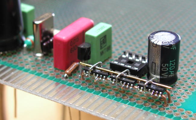

Here's my reclocker circuit. The 3 dual flip-flops were available only as SMD parts so I had to figure out how to make it nicely with p2p. They are mounted on 2 rails out of copper wire, which are also actual voltage rails. The jumpers on top and piece of wire is clock connection. After doing it this way, I'm actually glad they didn't have through the hole components. It takes much less space and looks great😉

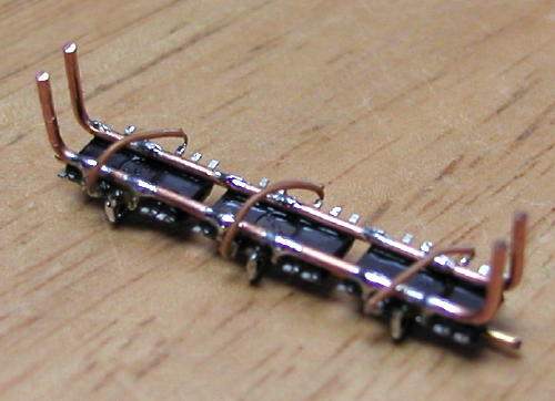

Peter, do you think that the flip flops used in the reclocker have much effect on the sound quality? They make many different types of them. Also, you could get a single octal D flip flop to fill the place.
Brian
Brian
Elso commented that VHC is better than other types and I could only get SMD of that type locally. But, I really like the small size.
Re: They only had SMD parts 😉
Hi Peter,
Be sure to add some local supply decoupling caps to the MC74VHC74's unless your name is Ricardo/NE5534 rules!
Peter Daniel said:Here's my reclocker circuit. The 3 dual flip-flops were available only as SMD parts so I had to figure out how to make it nicely with p2p. They are mounted on 2 rails out of copper wire, which are also actual voltage rails. The jumpers on top and piece of wire is clock connection. After doing it this way, I'm actually glad they didn't have through the hole components. It takes much less space and looks great😉

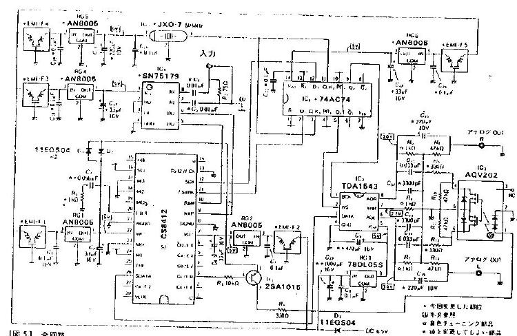

I guess JP is already tired with sending all those e-mails and schematics, so here is the 3rd Kusunoki DAC. That's the best copy i have😉
I think there is a copyright on it from MJ magazine that forbids to publish it. Not sure about it but it is better to be careful with such matters.

Is this schematic the same as this DAC:

jean-paul said:I think there is a copyright on it from MJ magazine that forbids to publish it. Not sure about it but it is better to be careful with such matters.
You are sure right I am tired of mailing !
I couldn't see the copyright note anywhere on the drawing. It may be because of poor copy quality or because it is in Japanese😉 I've seen the first schematic on the net and it was also reprint from MJ magazine and nobody complained about copyrights, so... lets's enjoy it while we can, somebody else might decide to remove it from here.

It is not the same. The only part I took from 3rd schematic is DAC setup (and this also not exactly). I like passive filtering of a first one and simple regulators for receiver and DAC.
When using batteries, you don't need passive filtering, just regulator from 6.5V down to 5V.
