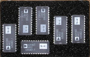

I don't remember, I took it off the board. There is still one chip I want to try: AD1865K. I know that Audio Note is using them and I got at least 6 of them😉
AD1865N-K

AD1865N-K
Hi Peter,
As I have the schematics of the Audionote DAC 1.1. & 1.2 where he AD1865N is mentioned. This week I had a look into the Audionote CD-2 at another dealer in town. It had the AD186N-J. I offered the man some AD1865N-K . He was highly interested when I told this was a meaningfull upgrade. AD1865N-J and AD1865N-K picture looks very much the same except the letter J or K. I could not determine if the Audionote DAC5 uses the K or J-version. The link you provided shows the N-version for the 1.1 and 3.1 DAC. Model 4.1 and 5 seem to have a "selected" version of the AD1865. Very probably this is the K-version you have a handfull of. Thanks for the link, very informative!🙂

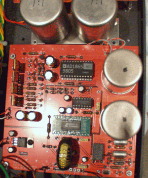

Hi Peter,
I got this picture in my mailbox, which I believe is of a DAC5.
On higher resolution, for this forum it is resized/resampled, it shows clearly that it is a AD1865N.
Apparently Peter Qvortrup didn't find is necessary to use a higher grade version. I think he is wrong.😉
Anyway owners of Audionote DACs can upgrade there unit simply by replacing the DAC.😎
