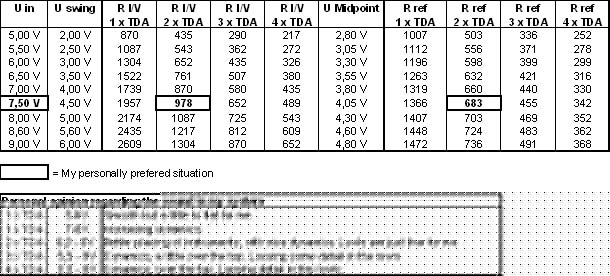

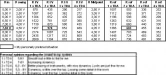

Tested my TDA 1543 DAC, I hope I did it the right way!
I did some testing on my TDA1543 DAC based on the input I received last week.
I have tested the following:
1) 1 to 4 parallel TDA 1543, Uin 5 to 8 V
2) Tested several resistor types as I/V converter
First I calculated the different Rref and RI/V resistor levels for all situations between 1 to 4 parallel TDA1543 and Rref for every Uin between 5 and 8 VDC (in steps of 0.5V). I was intending to post a copy of the excel sheet, since this is not possible I hereby post a sumary of my results.
Connected equipment:
-CDPRO2, I2S directly into the DAC, interlink is 60 cm UTP CAT5
-SDS Labs DIY headphone amplifier
-Sennheiser HD580 with DIY cable
The DAC is build with the TNT Convertus as reference, no reclocking used yet.
MY personal results on parallel chips:
1 x TDA 1543 @ 5V, Smooth sound but in my opinion a little flat.
1 x TDA 1543 @ 8V, increased dynamics compaired to the lower voltages which was to be expected.
2 x TDA 1543 @ 7V compaired to single chip increased dynamics, better placing of instruments. Minor difference between 5 and 8 VDC Uin.
3 x TDA 1543 @ 7V, very dynamical sound, a little tiring sound. loosing some detail in the bass. No real difference between 5 and 8 VDC Uin.
4 x TDA 1543 @ 7V, dynamics sound is over the top, quit tiring sound, loosing a lot of detail in the lows. No real difference between 5 and 8V.
My personal favorite out of all tested combinations is as follows:
2 x TDA 1543
Uin= 7.5V
Rref= 680 Ohm
RI/V= 1k Ohm
This set-up is in my opinion the best combination: dynamical but not overdue with very good detail and no distortion as far as I could hear.
In my opinion the DAC does very well on "no nonsence music" like Paolo Conto, Tracy Chapman Lee Shankey Group etc. When the music becomes more "smoother" like This Mortal Coil I am not yet sure. I think I can discribe the sound of this DAC best as very direct, there seems to be nothing in between the music and the listener.
Different types of RI/V:
I have tested the following types with the following results(personal opinion):
Standard metalfilm: Missing detail in low and middle , high was good
Kiwake: Missing detail in low, middle and high quit mellow
Ricken: low, middle and high detailed and nicely balanced
VTC Tantalum: Low and high oke, middle missing
In my opinion the Ricken is compaired to the other types I've tested the best one.
So far my results.
