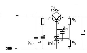

ok... so maybe a LM431 and MPSA18?
Does anyone have a circuit that includes a LM431 and a series pass transistor? I have a bunch of MPSA18's....
Can I use 6v batteries in this appliation? Or should I still go with the 12v?
Thanks!
Thanks!

Re: ok... so maybe a LM431 and MPSA18?
Koinichiwa,
How about the one from the Datasheet (may be the TL431 Datasheet)? Or the attached one?
Well, if make at least 3mA flow at 5.5V Battery Voltage R1 must become around 366R (how about 360R). The cathode of the LM431 will be at 4.4V, around 0.6V below the output Voltage of 5V, hence the voltage across the resistor is 1.1V).
In this case (R1 = 360R) the current flow through the LM431 at 7.2V (battery fully charged) will be 7.8mA, both are values of current well safe.
Of course you loose all the advantages of a (local) shunt regulator by doing so and you may very well simply use a good quality 3-Pin fixed 5V low dropout regulator instead...
Sayonara

attached one?
I am missing something?
I don't see an attached schematic with series regulator info.....
Yeah I may just use the LM431 datasheet info....
How does PSRR and stuff like that change with the series pass transistor?
Re: attached one?
Koinichiwa,
Gomen.
I forgot to attach.
Sayonara

So does R1 stay the same then for any input voltage? 12v or 6v to regulate down to 5v?
Thanks!!!
So what are good starting values for C2 and the output capacitor?
100uf?
Thanks!!!
