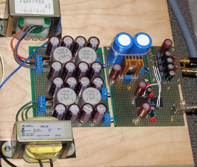

I don't really have schematic as such. Most of the info can be found in that thread: http://www.diyaudio.com/forums/showthread.php?s=&threadid=13666
I based passive filtering and receiver setup/PS from the first Kusunoki Dac. The DAC itself is very similar to what Fedde shows in his site, except for 5V supply and 1K I/V resistors. PS for DAC is from here: http://www.tnt-audio.com/clinica/convertus1_e.html
It's still work in progress and I'll be trying reclocking soon.

your dac
Hi Peter,
Well, which sound do you prefer between this and your top-end broadhurst dac?
What do you think are the advantages and disadvantages of both?
For my dac I'll us 2 parallel chips, but using the 12s output.
I'll sandwich the pcb between the chips, and connect the relevant legs of both chips thru the pcb holes, allowing me to heatsink each chip if required, rather than piggybacking.
The legs of 12s input will be joind on both chips as well as the audio outputs, but power supply legs will not. I'll use sepertae supplies for each chip. Mounting in this way minimise extra wiring etc.

I didn't compared those DACs yet, but I would say that both provide satisfying musical experience and comparing time, work and parts involvement, TDA1543 is a clear winner.
Your idea about putting both DACs in parallel in that setup is very nice, but before you settle on a certain config, I recommend to install a socket firs and try both single and parallel, as well as different voltage settings. I started building 4 DACs in parallel, but completed this one first and in comparing to parallel config. it seems like a single one provides less restrsined sound, with more air and ambience.
When you consider that the only addition to CD-Pro to get great sound is one chip, 5 resistors and two caps, plus DACs PS, it is truly amazing😉
I also didn't find the need for a heat sink on a DAC.

Here's another DAC. This one is almost exact copy of a first Kusunoki DAC. It has much more gain than a single chip. PS is 8V and it employs 4 x TDA1543. Too early for any conclusions, but first impression is like that: more robust sound, and although I used again Vishays S102, there is no softening in midrange. Highs are not laid back, the sound is more aggressive, maybe the highest resolution is missing, but overall not bad, definitely better than 2 chips in parallel with 7V or so. I wonder how many people built the original Kusunoki DAC to the exact detail?😉
Hi Peter,
Your Dac is looking really good, your biography says "Full time DIY", well looking at your production rate this must be the case. I was intending to build the Dac based on the 2xTDA 1541A but I switched to the TDA 1543. This set-up is much cheaper to start with when I compair the needed components to those that are needed to build the dubbel 1541A with tube output.
Some questions:
- What kind of output capacitors are you using?
- I can find the vishays resitor the easy way, do you have an idea what I "soundwise" can expect from a standard metalfilm resistor. Will it be better to use a (low induction) wire resistor?
- Did you, or will you, check audio quallity based on the plane I2S output on your CDPRO?
I would appreciate your information.
Peter

I'm using 4.7 BG N for output. That's what I had on hand and those caps are not bad at all for coupling, considering size and price.
I also had Vishays around, so that's why I used them here. In this, 4 in parallel DACs, they sound good, but in the previous one, using only one DAC, they were too mellow and I replaced them with Rikens. The resistors are very important, as they tailor the tonal balance of the DAC.
5V supply sounds indeed more sweet, more airy, and more seductive.😉
As soon as I decide on cofiguration, I will try the DAC with CD PRO using I2S.
