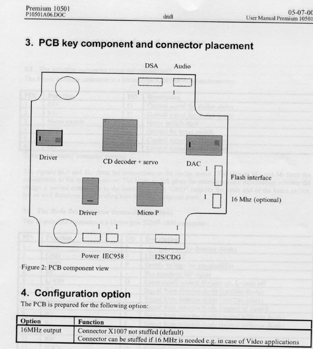

urgent CDpro2 question: is it possible (and if yes, how?) to disconnect the connection between internal clock and drive on the onboard PCB of the CDpro2 module and is it possible then to synchronize the CD drive to an external clock signal, e.g. coming from the master clock oscillator sitting right beneath the DAC?
Here is the info from Product Specification notes concerning VAU1254/11. SAA7324 decoder is on transport's PCB.
There is also optional output (16Mhz), but the socket is not soldered to the board. That's more or less the info I got, but I can't answer your question for sure, Bernhard. Digital is something I'm still learning. But I would be also interested if this can be done.😉

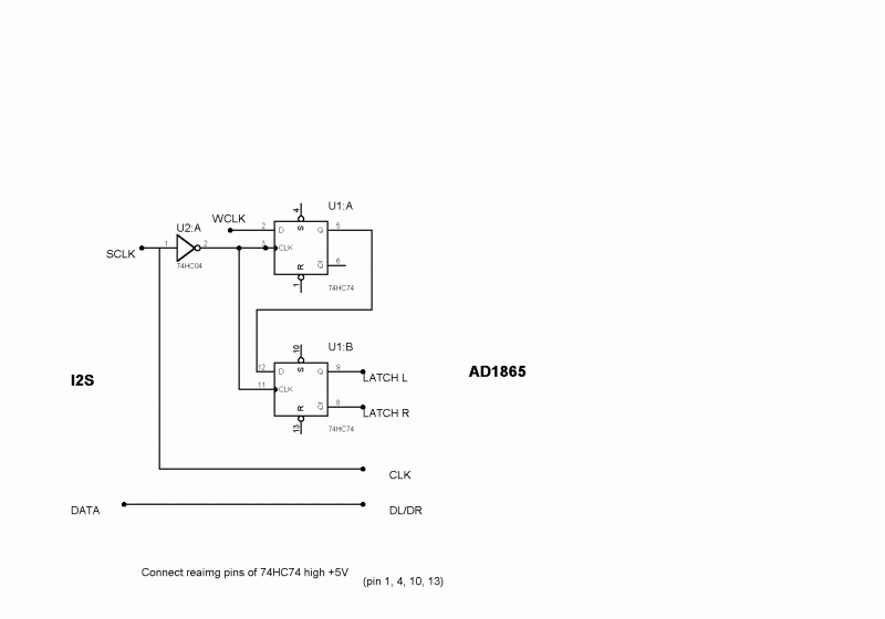

Hi Peter, Moderator, back to the topic:
I made a little schematic and sent it to a friend. I did not get a reply yet. I don't know it is working-<I>I know nothing you know- </i>🙂, but you can try it.😉
Please read for "reaiming" remaining, I must have been drunk again:drunk: :drunk: :drunk:
It is a simplification from the AD schematic for two separate DAC's:xeye:
