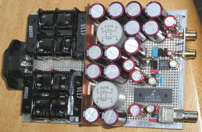

So here we go, finally my first non-oversampling DAC. This one is a compact version, so everything is on one board, including 2 transformers. I used one for receiver chip, the other for a single TDA1543.
I based my circuit mostly on a first Kusunoki DAC, I still like the beauty of passive filtering and simplicity. I used those 2.4mH common mode chokes, by ROE, I bought years ago and mosly Elna caps, with few Cerafines.
Regulation for CS8412 is done by two TL431 diodes, one for digital section, one for analog section. Regulation for DAC is done by a single Mosfet, with a trimpot for votage adjustment and 4,700 at the gate. Overall I think I used about 30,000u at the DAC PS. I also used SMD caps for bypassing directly at the IC pins (famous triplets).
Everything is done p2p and it took me one day to figure the layout and do connections. I placed DAC in a socket, so I can experiment with paralleling. Currently supply is 5V. I like working with p2p, because it provides more flexibility when working with limited space.
As to the sound, it is pretty good. My first impression is that I can't really find nothing wrong, the bass is more detailed and probably more punchy than SF Transdac. One word that describes the sound best is probably "seductive". I didn't use any filtering in a DAC, but I didn't observe any ringing, harshness or whatever. Maybe because I used Vishays S102 as 1K conversion resistors. From my experience, Vishays sound very mellow.

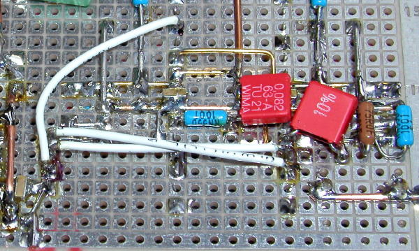

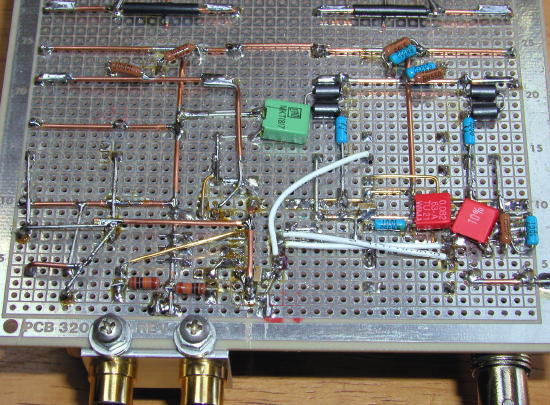

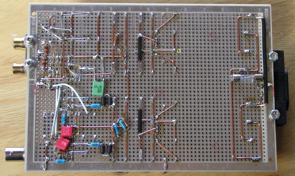

It's 18 ga. bare copper wire. I bought a roll of PVC insulated wire and as use it, I remove insulation. It doesn't oxidize that way 😉
I'm also getting more skilled at p2p as I practice, and while before I would disregard that sort of technique, now I approach it as a form of an art😉
Here's a nice detail, notice stacked SM caps between power pins and ground, underneath receiver chip. The golden wires are cut offs from Rikens.

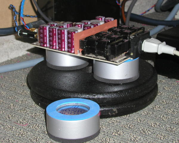

I tried yesterday with mounting that board on a sort of platform, but found out that it sounds the best when not mounted to anything, just two big feet. Which confirm my previous findings about importance of vibrations control.
