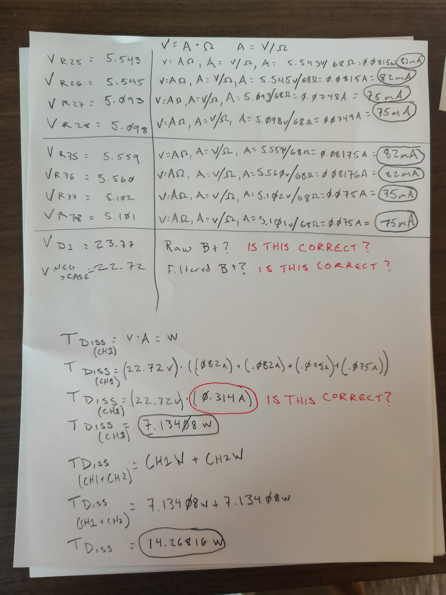

I calculate tube dissipation by calculating the current through the cathode bias resistor.
Volts = Amps * Ohms
therefore
Amps = Volts / Ohms
Once I know the current through the tube, I can multiply it by the voltage across the tube's cathode to plate.
Watts = Volts * Amps

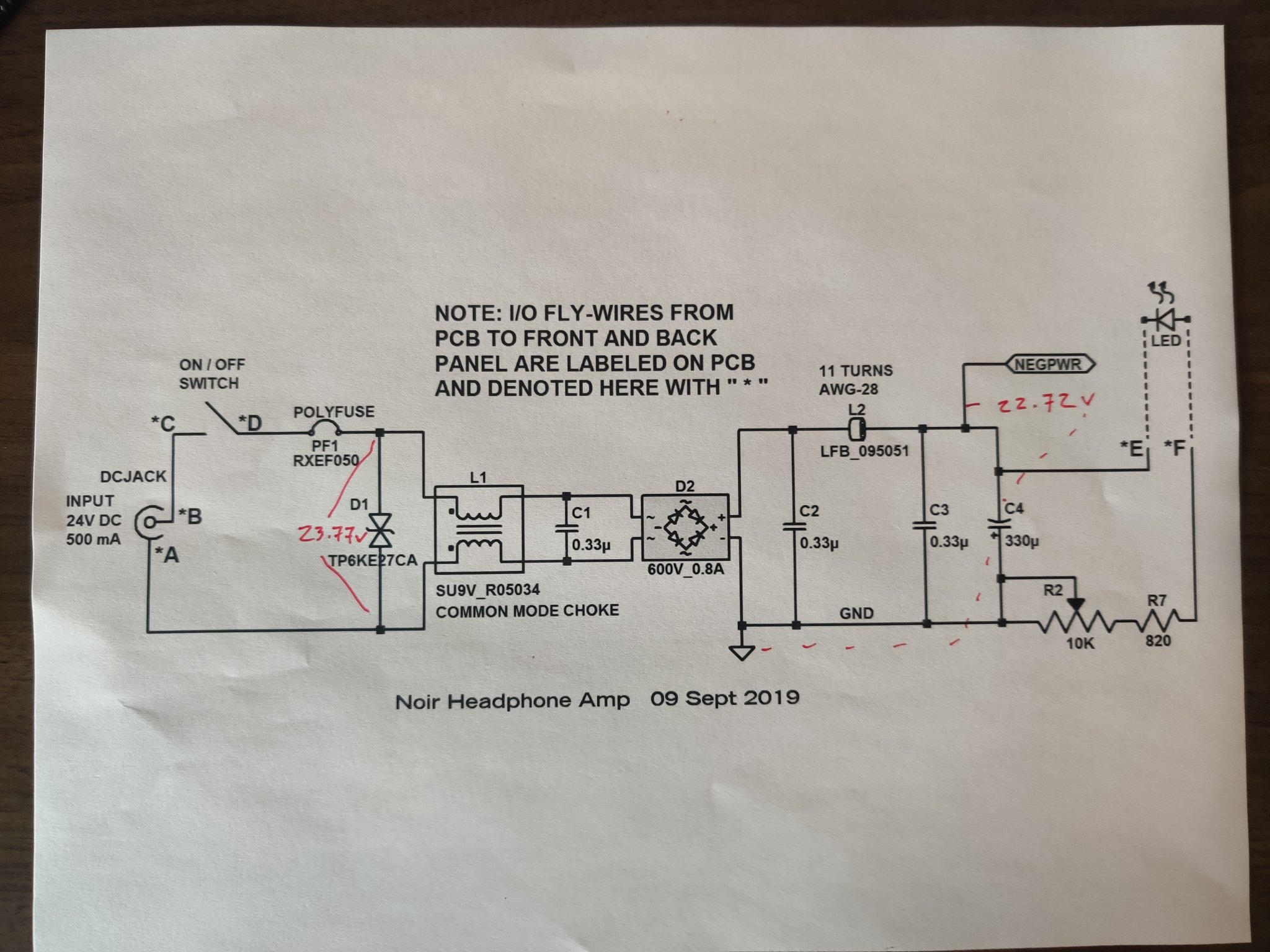

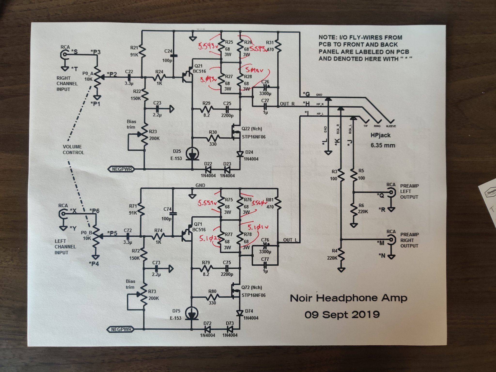

I've taken some measurements and done some calculations, but I don't know if I am going down the right path. I think each of my output FETs has 314mA going through it for a total dissapation of 7.13408 watts.
Can someone help guide me through the math? I've attached pictures of my measurements and calculations. All of my calculations are based off speculation on what I know about single ended vacuum tube circuits.

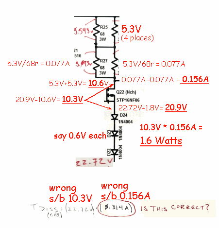

This is not an electric bill. You do not need 4-place numbers. And they distract you.
I do not understand your spreadsheet, and I doubt you do.
Somehow you have got double the current (did you treat series resistors as parallel?).
And you seem to be looking for supply voltage, when you really want tube/transistor voltage. Even in a transformer-coupled tube amp these are not the same. In a resistance-coupled amp the resistor often takes half the available voltage.

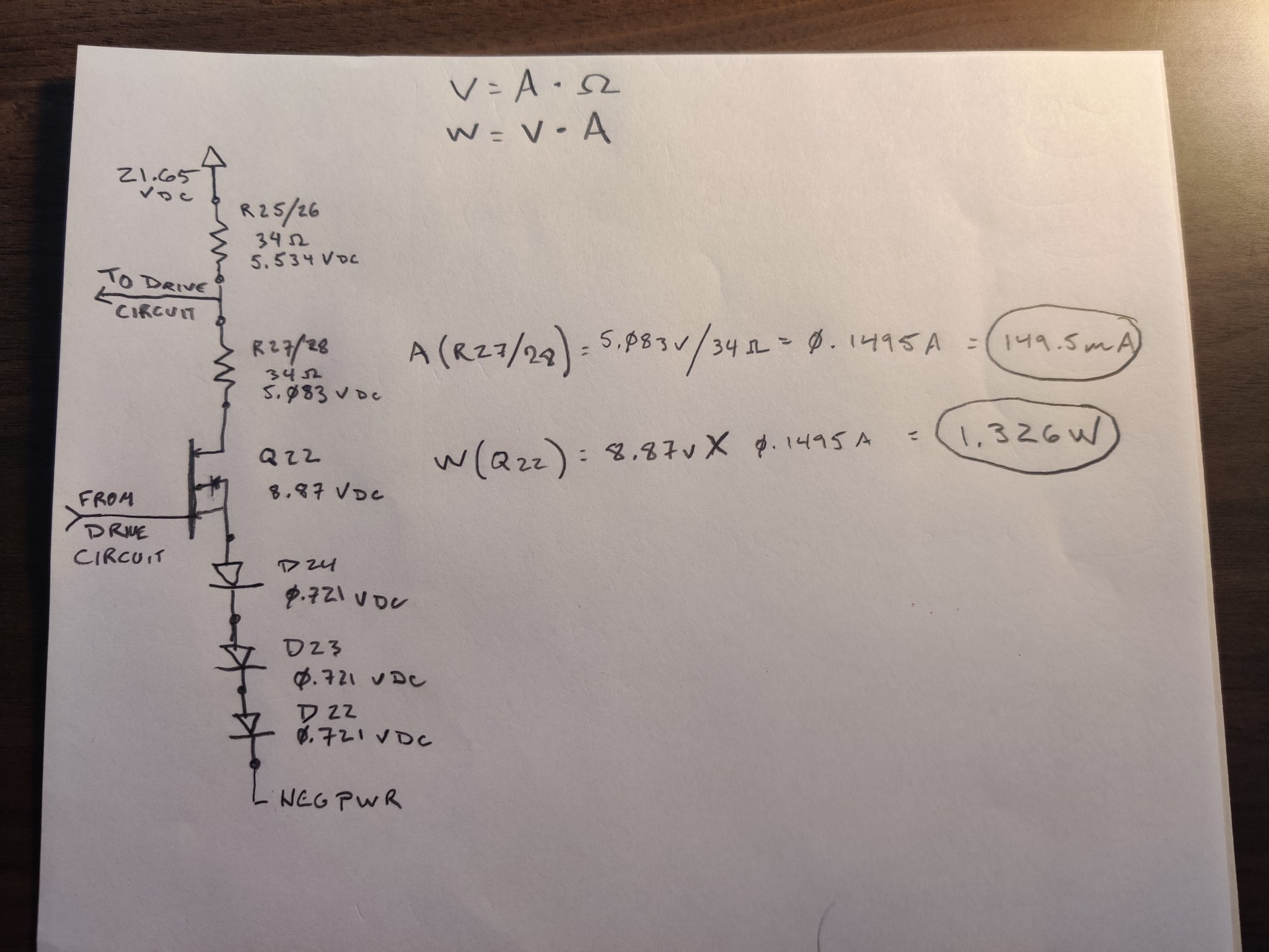

PRR,
Thanks, like I said, it's been over a decade since I was in school for this stuff.
The four resistor combination threw me for a loop. I was adding up the current from each resistor. I see now that I really only needed to calculate the current through the R27/28 parallel pair.
Also, forgot about the total voltage drop over each part of the series chain.
I think I've got it right now. Mind being so gracious and checking again?

And yet you clearly have 10% differences in "identical" resistors. Electronics is almost never an arc-second job. Resistors are sold with 10% tolerances because we can make that work, MUCH cheaper than 0.001% parts.Try measuring 15 arc seconds of rotation from 30 meters away. I never truncate or round; at the end of the day, data storage is cheap
And in desk-checking, "data storage" is a sliver of brain or the back of a matchbook. Long numbers are, for me, mind-numbing.
Precision:
You don't need an "exact" number for dissipation. Up to 1 Watt, no sink, over 10 Watts, big sink. In between you go by size and price.
One place precision may need thinking: the ratio R25+R26/R27+R28 is also part of the audio gain. The voltages you are reporting suggest that R25+R26 is 10% bigger than R27+R28, which may be a gain of 1.9 rather than 2.0. We can usually separate "precision" and "power" with negative feedback. Here Mark used power parts AS the NFB network, a very efficient and thrifty use of parts. (Avoids the NFB network loading the amp.) However you seem to have got unlucky with tolerances.

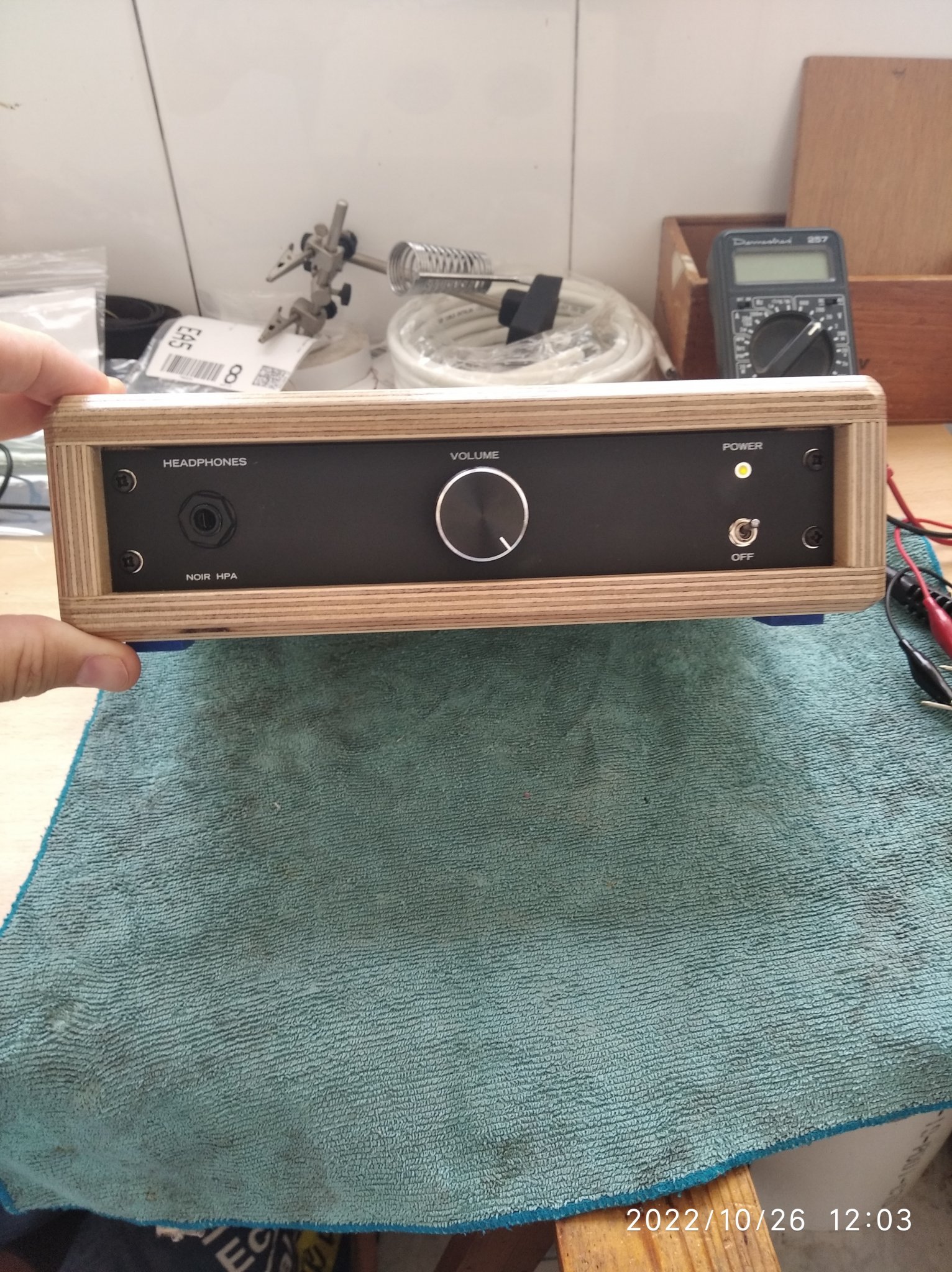

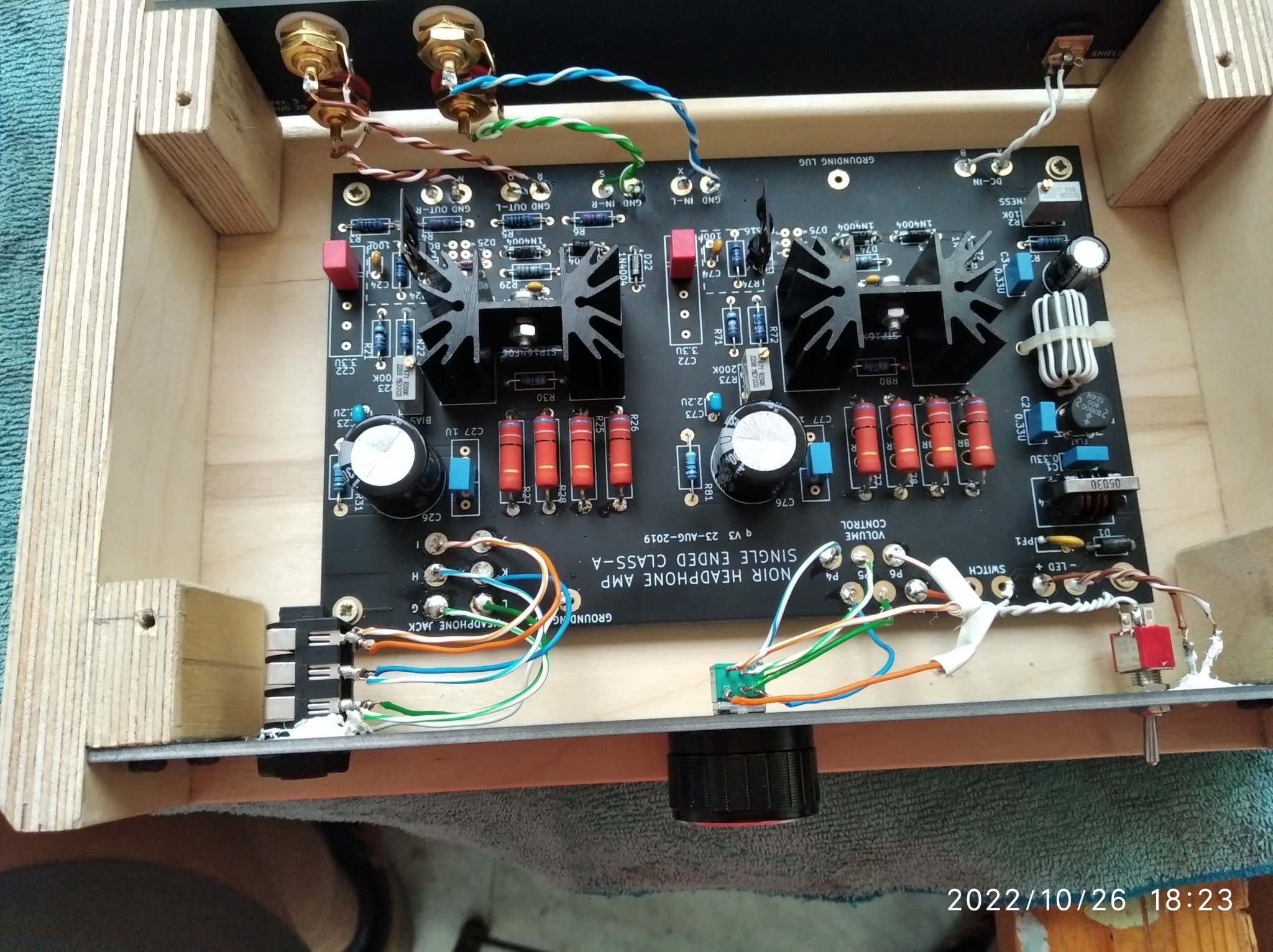

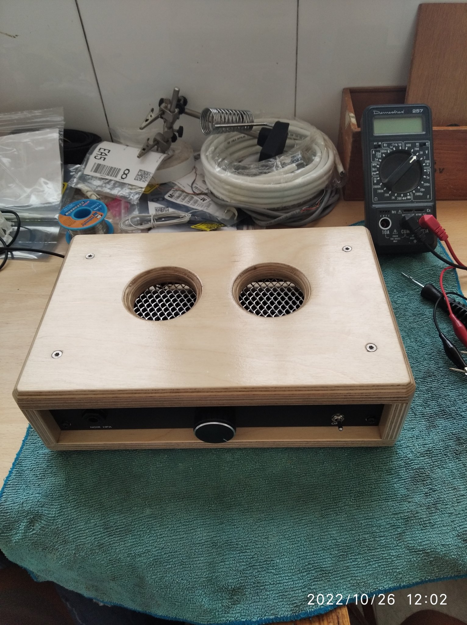

Another Noir is working. Thank you Mark for this great design.
I made a wood enclosure, has been very easy thanks to the front and back panel that comes together with pcb. No metal drilling or cutting, nothing, just usual woodworking.
The BOM is very helpful too. I used it complete except the potentiometer, the Alps one is too expensive and change it.
I'll tell my mistakes, maybe help others:
1. I plugged the heatsink in small transistors before soldering. And soldered one wrong. Of course, this channel didn't bias correctly. Luckily I could desolder and fix it. It's very easy to do the same mistake because the heatsink covers the flat in the body. Beware!.
2. I connected wrongly the headphone socket wires. Better follow exacty the nice pictures in the Build Guide.
Once my mistakes are fixed, it bias and plays nicely.
