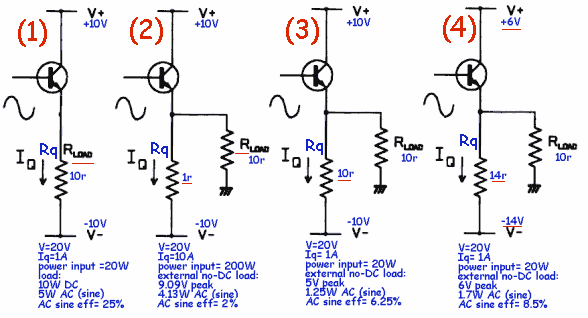

single end klasse-A, so the rendement is only 12,5%.
Off-topic: this is resistor loaded single-ended and the efficiency can't be much over 8%.
A detailed analysis by "kvant" gives ~~8.58..%.
The 12.5% figure is cited many places, even (at least two) writers who should know better (or can rough it out as I did above).

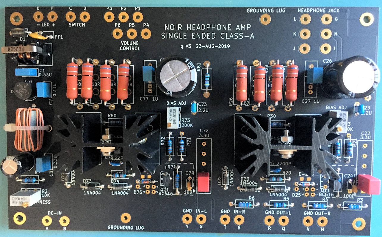

Between witch points you measure those 14V?So, I tried to put together the Noir, using the PCB from Scotsky.
Unfortunately, it did't work.
Had one part mislabeled (apart from a couple of other faults that Scotsky warned me about).
In particular, the E153 current regulating diode was marked the other way around and didn't notice until power up...
When i did, BC516 Darlington transistors started overheating almost immediately.
And when checking voltages, bias voltage was zero and remained zero even when turning the pot clockwise.
Also, a weird symptom was a pretty serious drop in supply voltage.
Instead of measuring -24VDC right at the NEGPWR spot, I was getting something like -14VDC instead.
Even after reversing the E153 current regulating diode to match the schematic correctly, little changed.
I suspect because of the CRD being mislabeled i've fried the Darlingtons and possibly the E-153 too.
Hope the Mosfets are OK though.

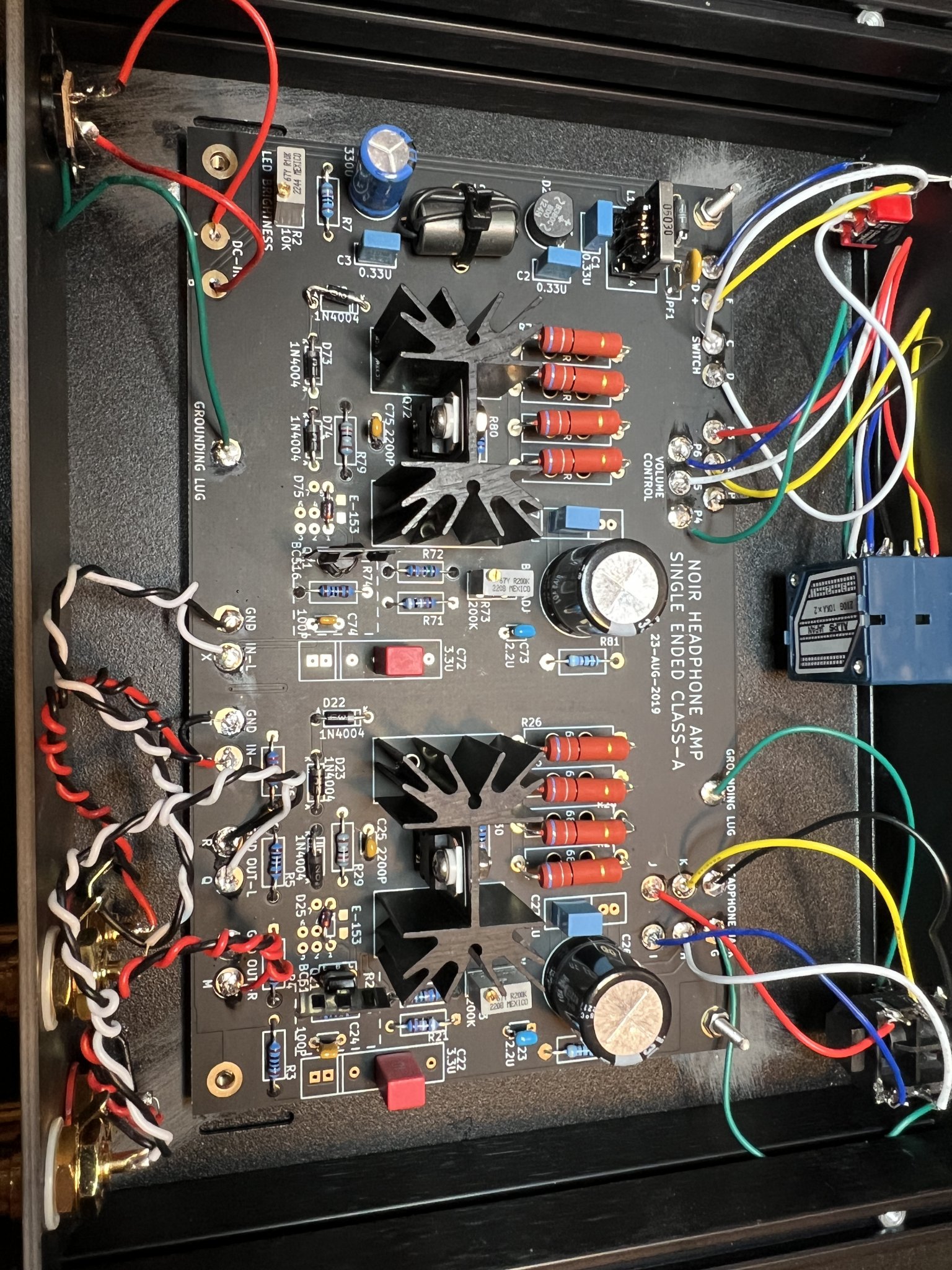

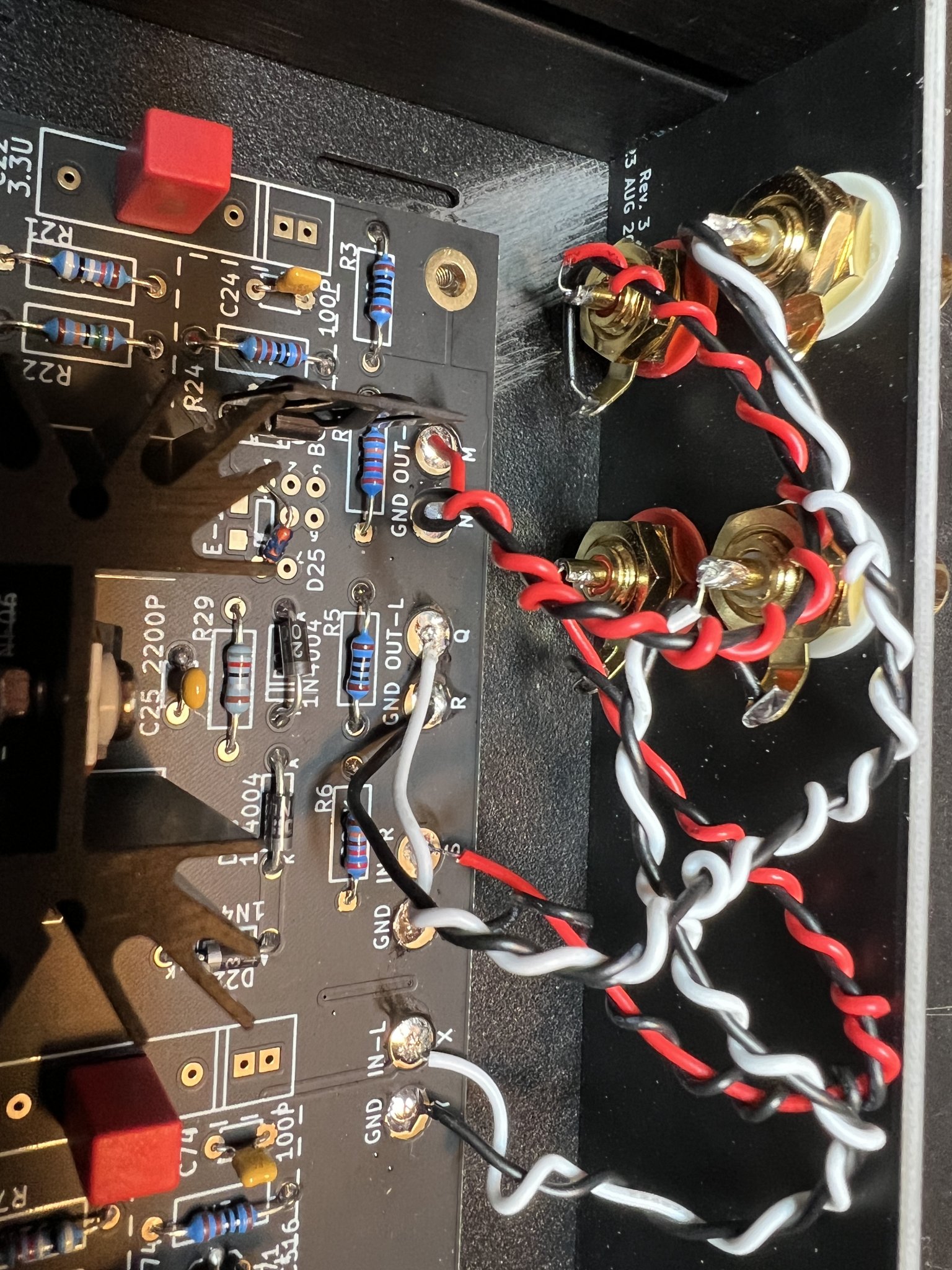

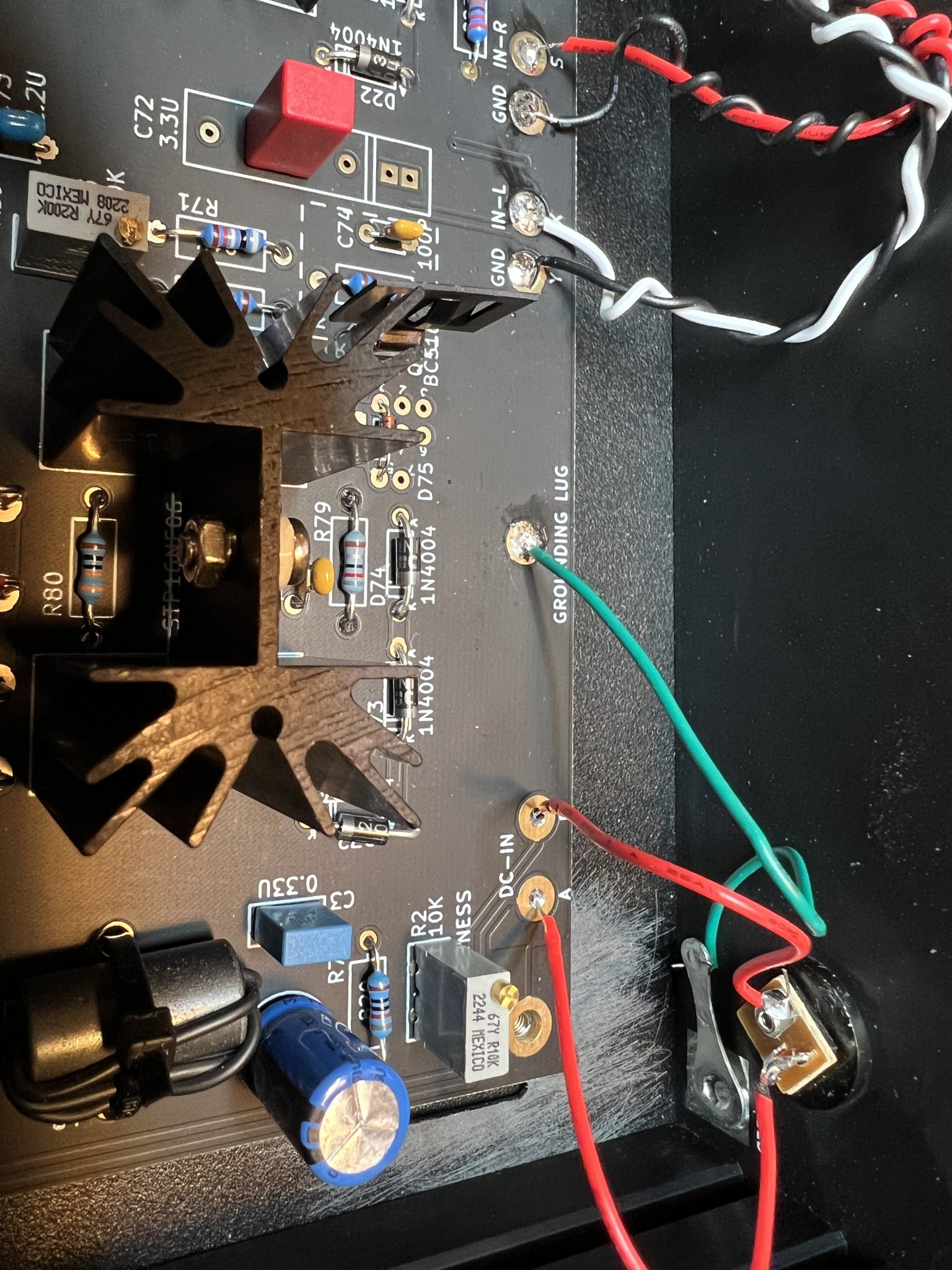

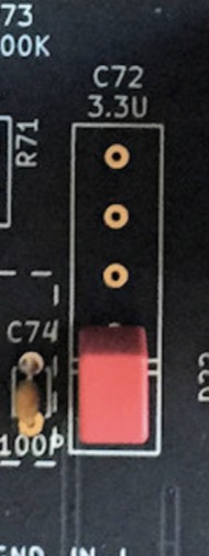

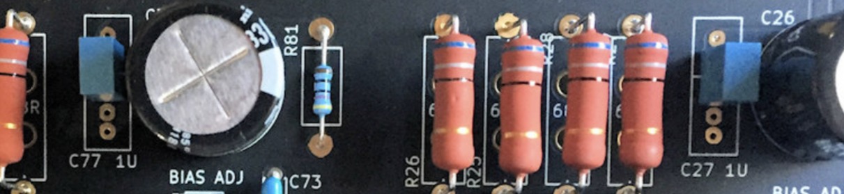

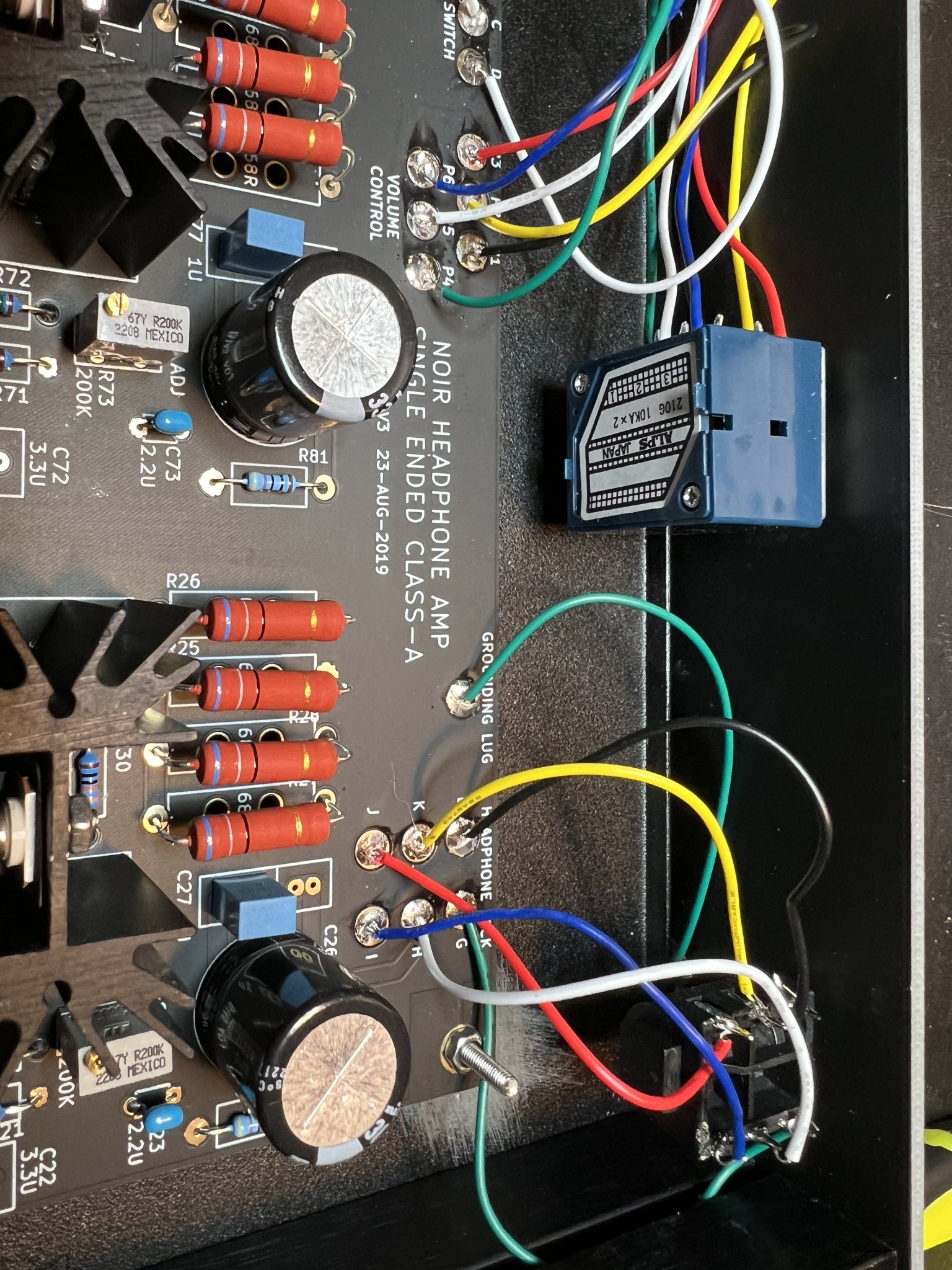

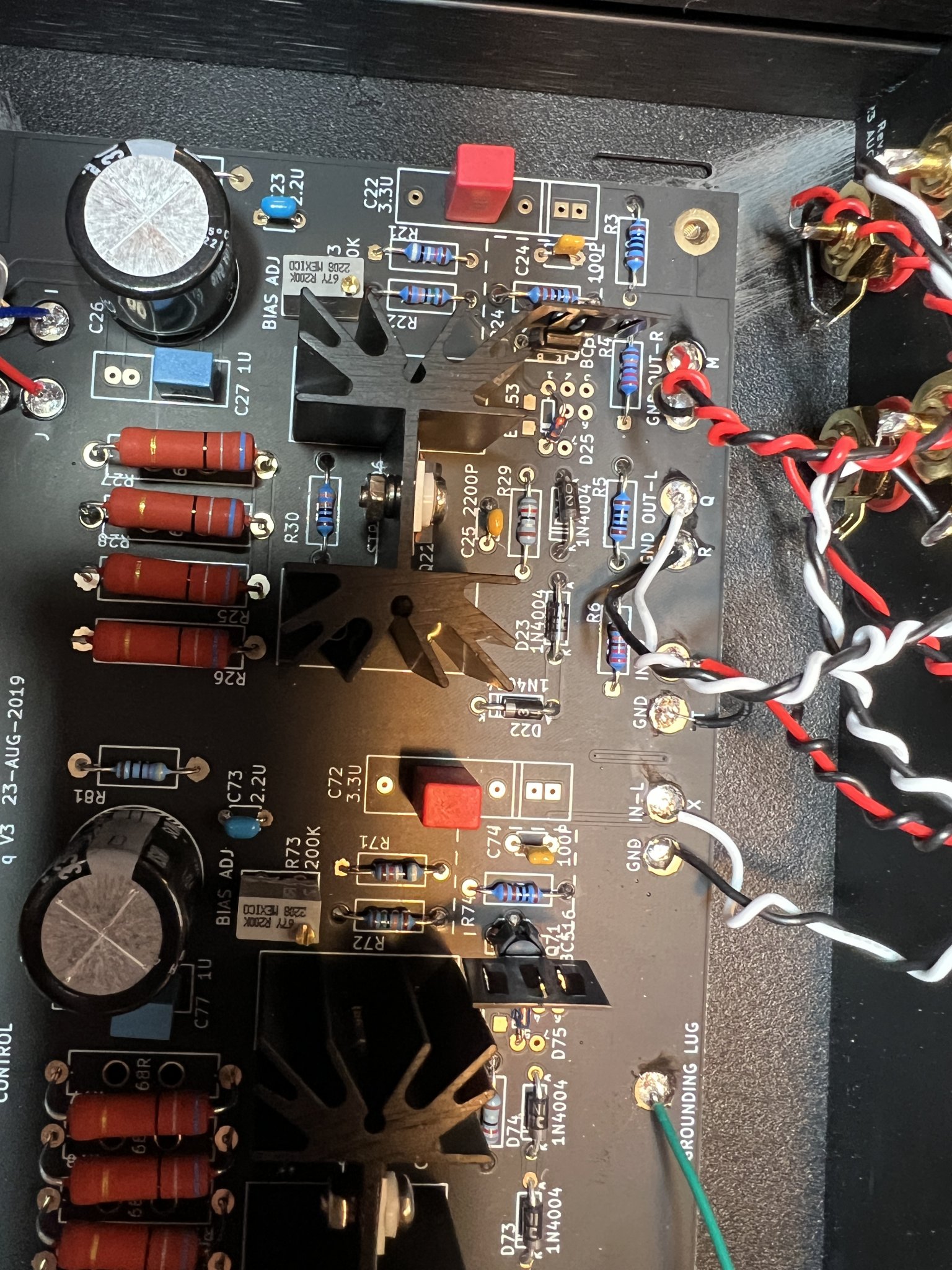

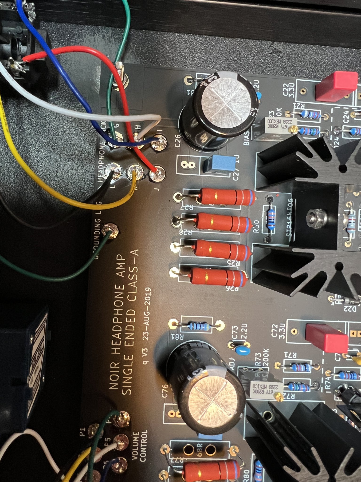

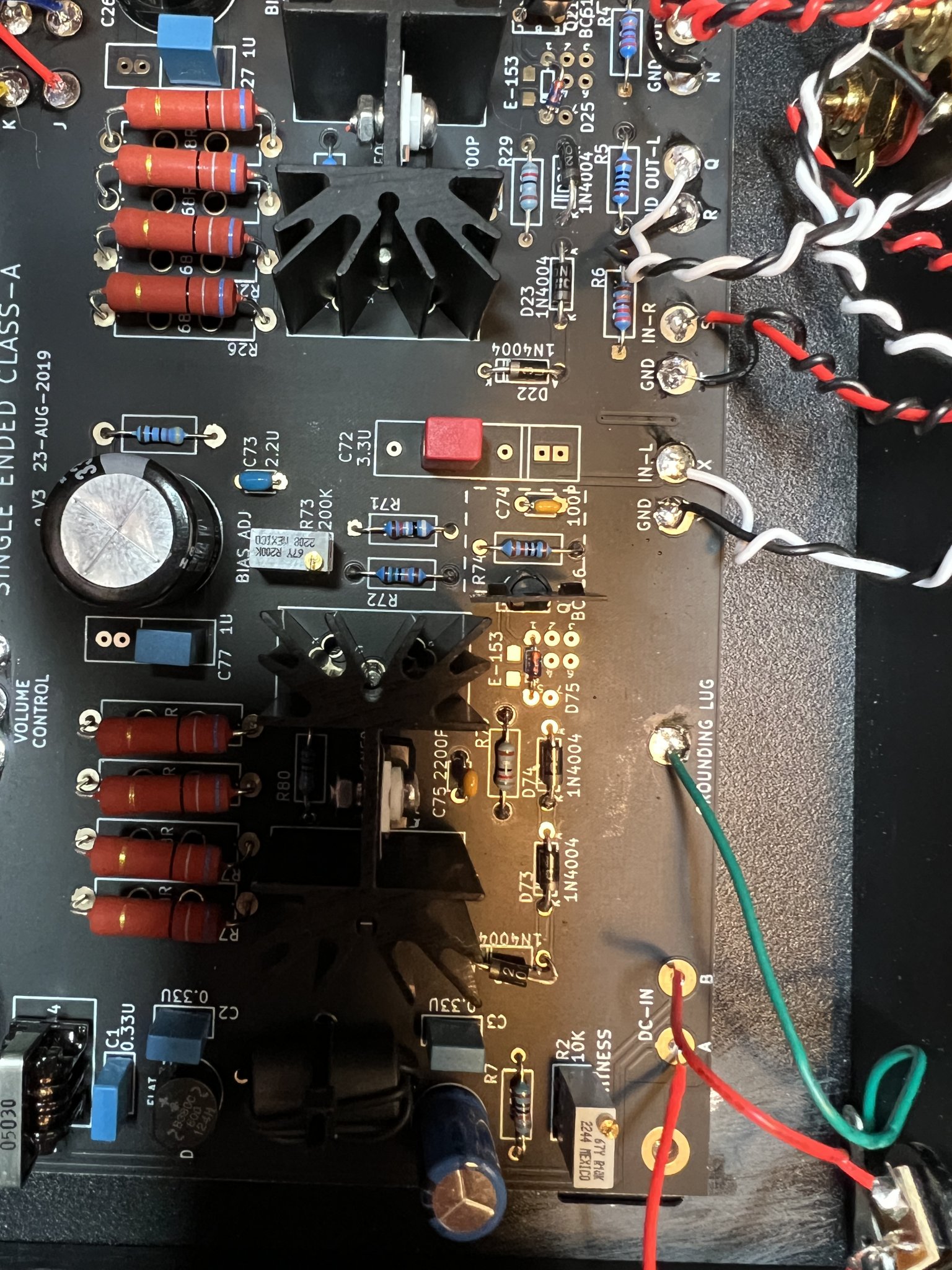

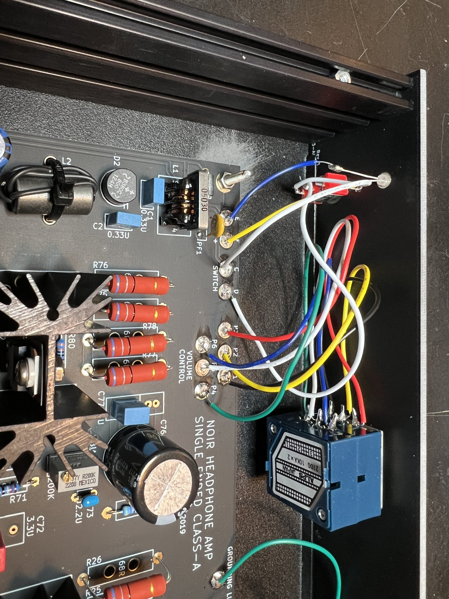

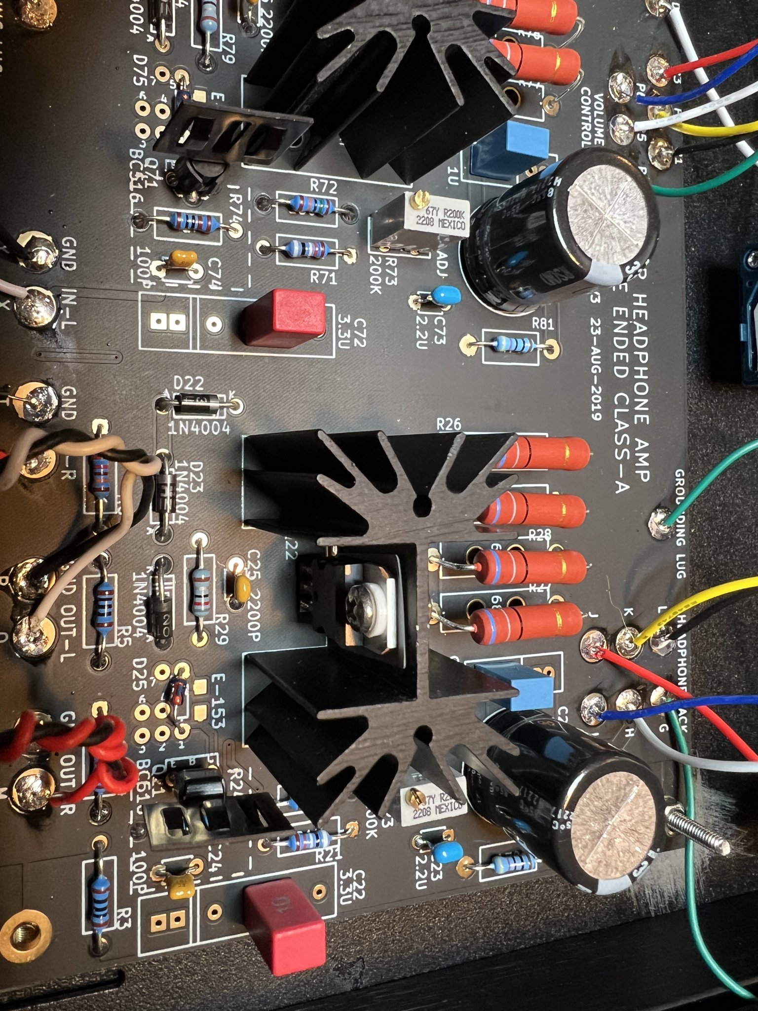

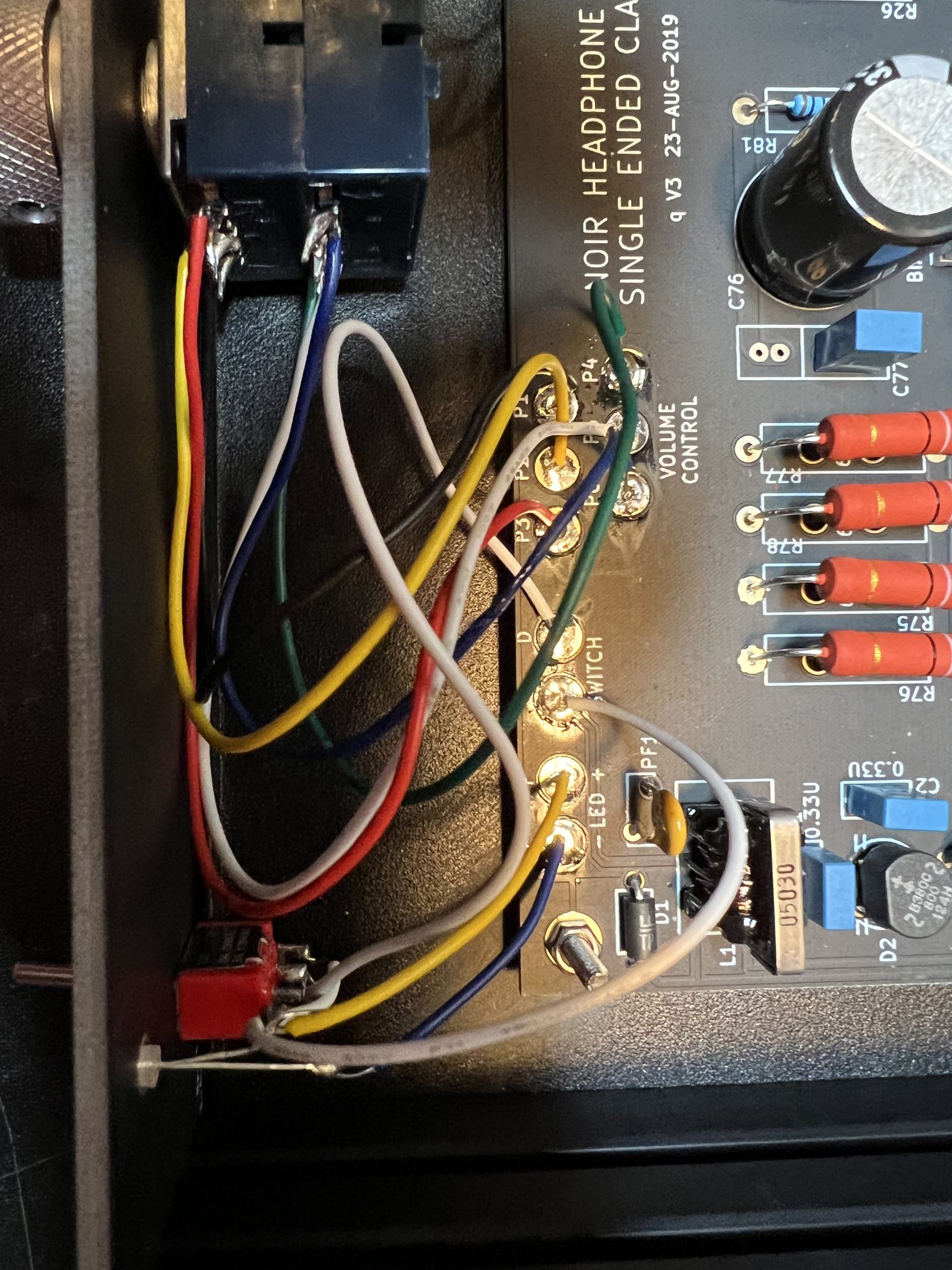

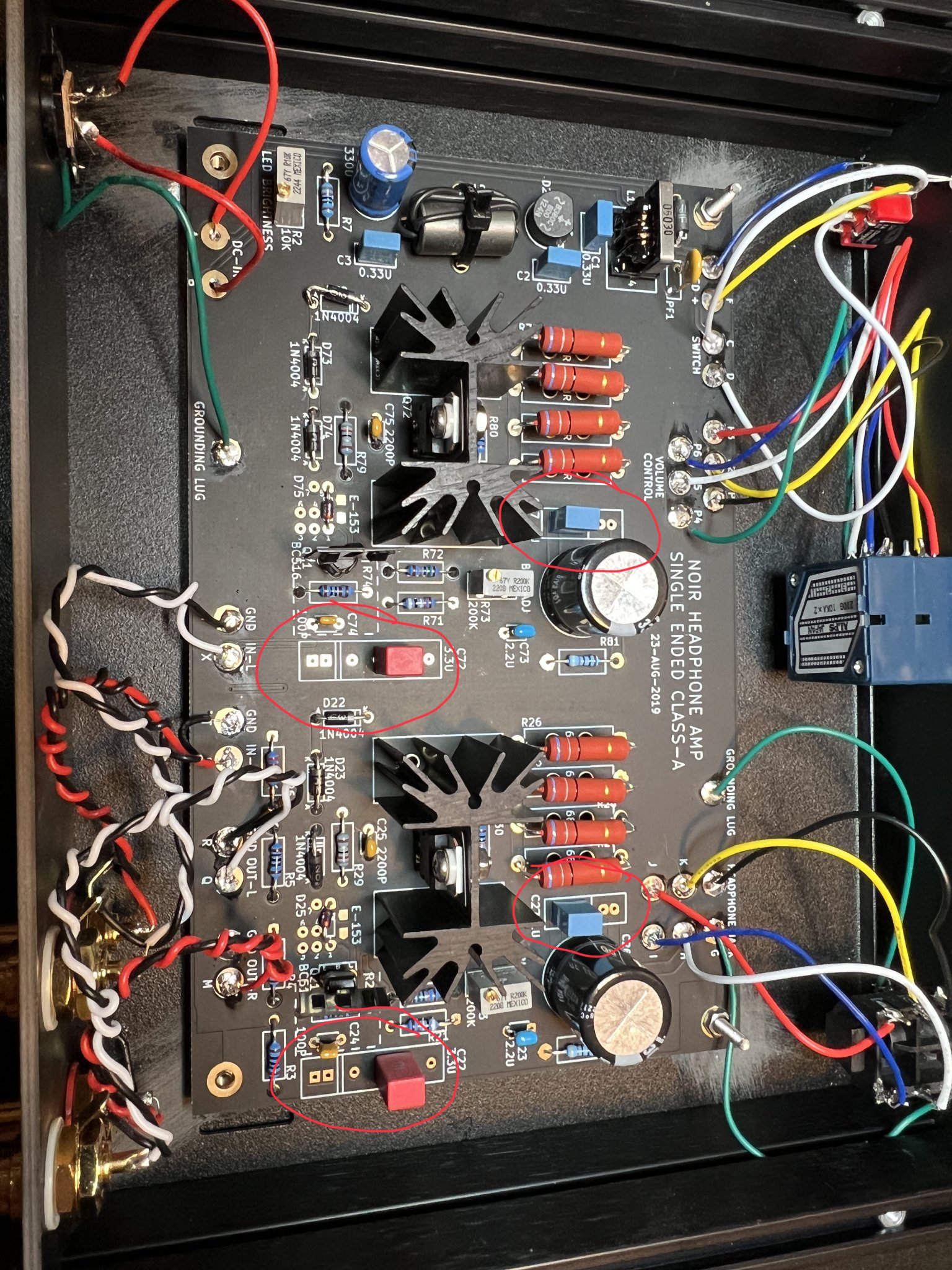

Getting back late on my low/no volume issue. Attached are some pictures of the build.Post a series of well-lit, in-focus photos so we can see detail and the forum hive mind will start to work on it.

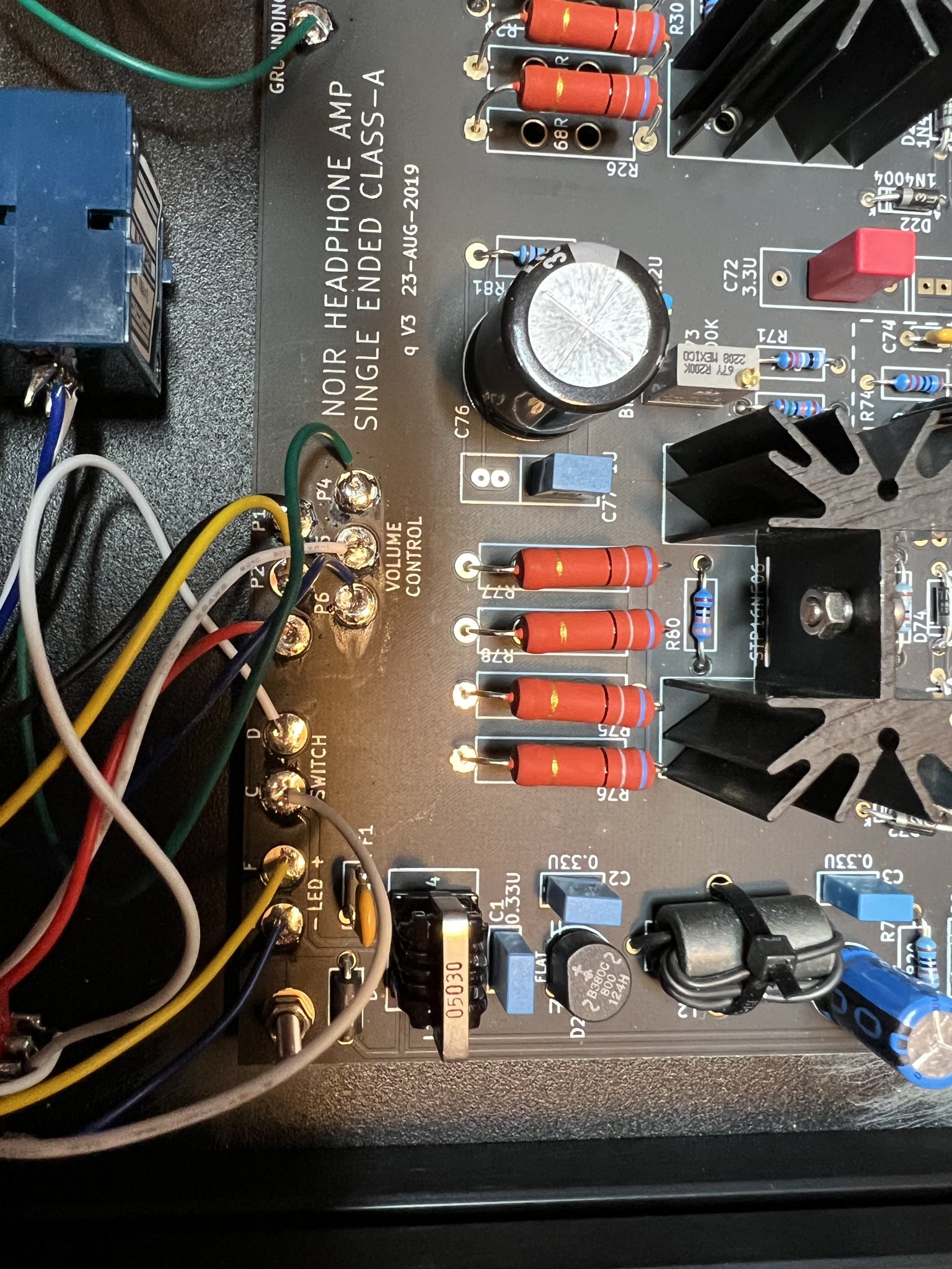

Hi
For JMO check your condensators. C77 looks weird maybe not across the rigth holes so not link the circuit.
Others condensators seem similar, c22 for isntance.
Check the pics of the word document explaining the build
(below for the doc)
(below for the doc)
I think you could checkout C22 an C72.
In the example picture from the diyaudiostore, they're mounted different.

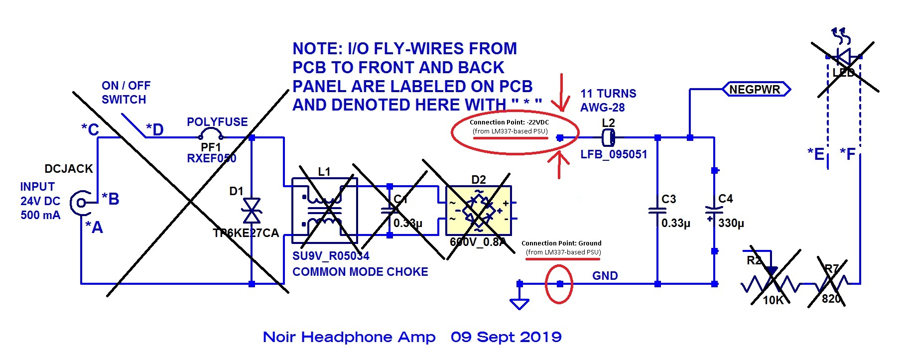

When I look at the schematic, I think that is wel possible.
Maybe you could try a current limited powersupply by next try?
There is a polyfuse in the cirquit, but it's not enough to protect it against this problem.

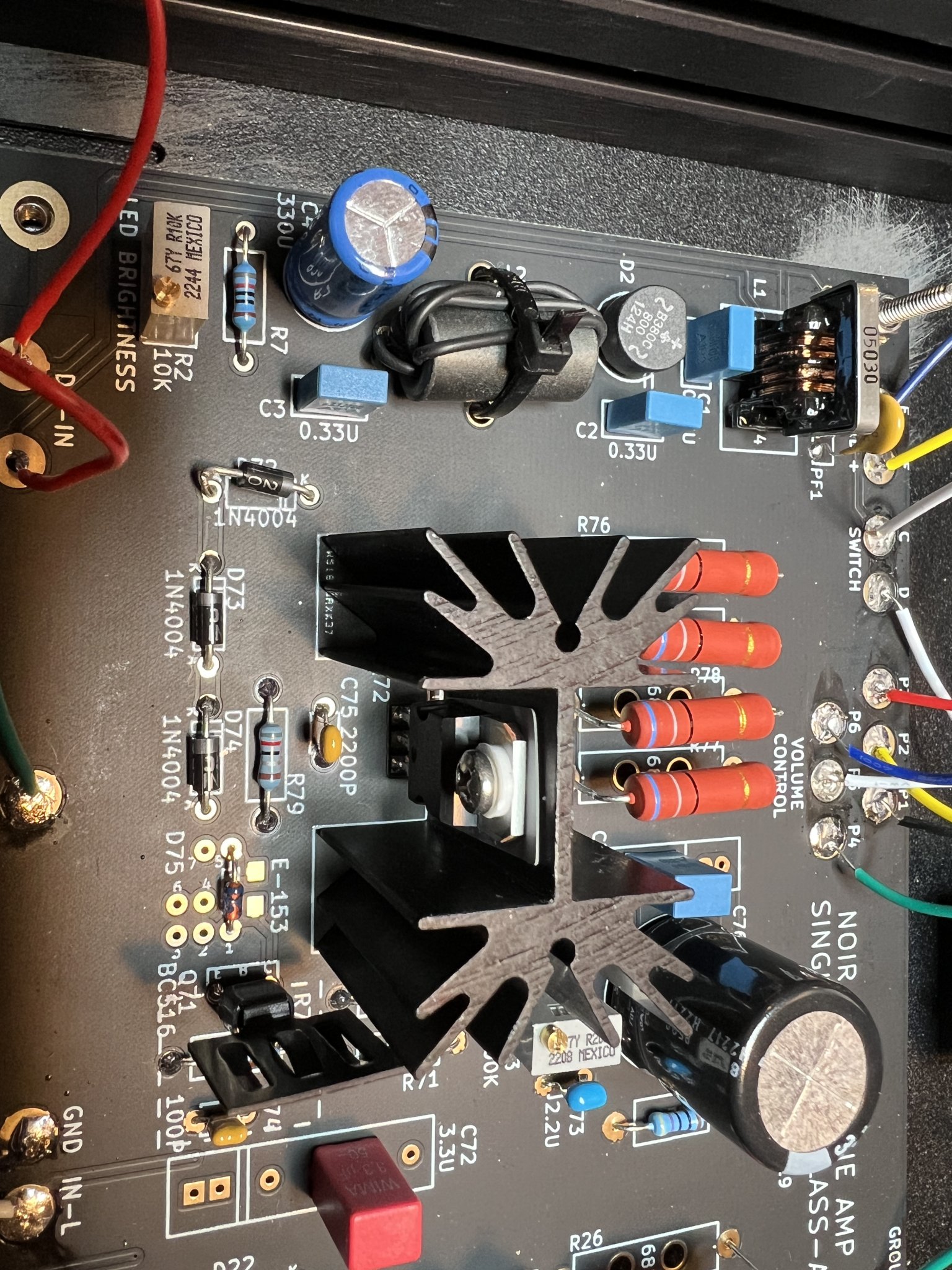

Folks, it seems this kit doesn't want to cooperate.
The reordered parts arrived (E-153 diodes, Darlingtons and the MOSFETs).
I placed the E-153 diode the correct way around but when I tried to fire it up, a wierd thing happened (again).
Using a typical LM337-based PSU to provide negative power (-22VDC), I got a drop of 10VDC across the Connection Points.
In the following picture, you can see the where exactly is connection point on the 'revised' schematic:
The X-marked parts to the left and to the right are left unpopulated.
Is it normal to measure a drop of around 10VDC (I measured -12VDC) right across the Connetion Points?
Thanks in advance!
PS:
The PCB has been thoroughly checked point by point and agrees with the original schematics.

Please post photos if your actual project. The schematic notes are helpful, but we need to see the real thing to help troubleshoot.
Because you used my PCB, I can send you high-res and more detailed pictures of mine if it helps?
(But I thought they were allready sharp enough.)
It works like a charm.
I only left out the L1, because I made a mistake with the powersupply and blew it, so, I shorted it.
