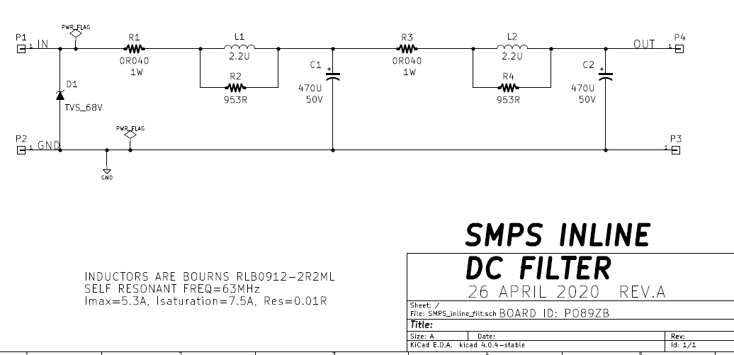

If you intend to use the SMPS DC filter from the store, in a Noir application,
beware that the store board assumes negative ground but Noir assumes positive ground. Study both of the schematics and verify or refute this claim yourself. Then apply your ingenuity and cleverness to figure out a way to make these two dangerously incompatible things, suddenly become compatible.
A snippet from post #1 of this thread:
Thus Noir uses a positive-ground, negative-supply arrangement, with the supply rail "NEGPWR" at about -22 volts. Just like germanium transistor radios in the late 1950s.

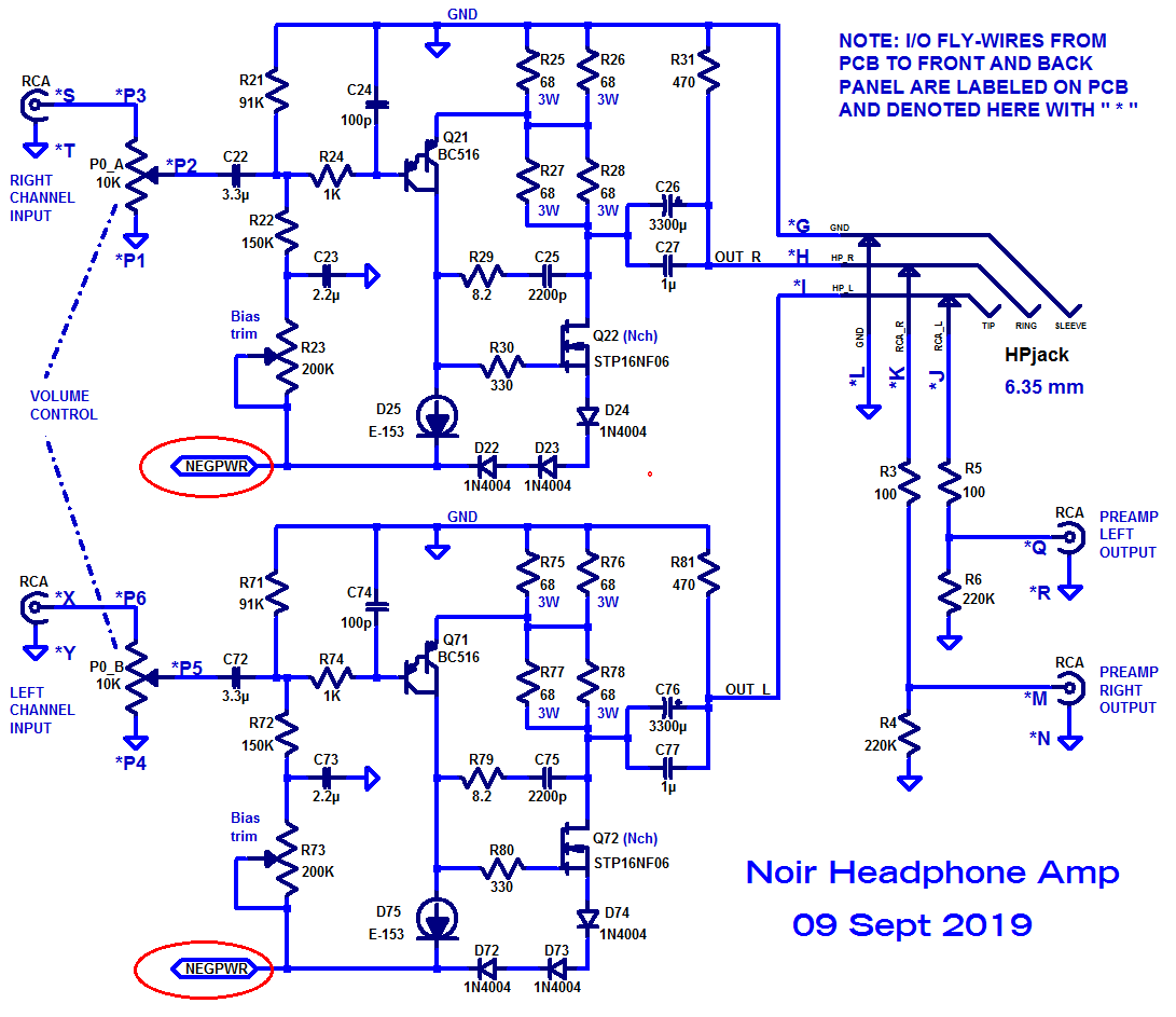

I am in the process of building Mark's Noir headamp (sourcing parts and waiting for PCB).
I am thinking of powering it with a linear PSU. Something simple, like a regulator followed by filtering or even an unregulated power supply with enough RC filtering stages to remove ripple and noise. Will be referencing V+ to ground since it needs negative power.
I like simplicity of unregulated power supplies but i would like to hear your thoughts.
Also, are R24 (1K) and R30 (330R) values critical? I have some spare 300R 5% and several 1K 10% that might be not exact values.
Thanks!

Remember that Noir requires a power supply that gives negative 24 volts, with positive ground. It needs a DC power supply with either (A) no connection to protective earth {like 98% of all SMPS wall warts in the US}, or else (B) a connection from protective earth to POSITIVE DC OUTPUT.
If you erroneously attempt to connect Noir to a DC power supply having a connection from protective earth to NEGATIVE DC OUTPUT, you'll almost certainly damage both Noir and the signal source which provides its input. So don't do that.
If you don't understand the above then you shouldn't attempt the experiment, it is too dangerous for you.

So, I tried to put together the Noir, using the PCB from Scotsky.
Unfortunately, it did't work.
Had one part mislabeled (apart from a couple of other faults that Scotsky warned me about).
In particular, the E153 current regulating diode was marked the other way around and didn't notice until power up...
When i did, BC516 Darlington transistors started overheating almost immediately.
And when checking voltages, bias voltage was zero and remained zero even when turning the pot clockwise.
Also, a weird symptom was a pretty serious drop in supply voltage.
Instead of measuring -24VDC right at the NEGPWR spot, I was getting something like -14VDC instead.
Even after reversing the E153 current regulating diode to match the schematic correctly, little changed.
I suspect because of the CRD being mislabeled i've fried the Darlingtons and possibly the E-153 too.
Hope the Mosfets are OK though.
Anyway, would you please let me know what you think folks?
Should i try it once again with fresh BC516 and E-154?
Or get a couple of STP16NF06 just to be sure?
Firstly, do some checks regarding bias voltage across R27/R77.
It should read around 5.10VDC.
Check also the supply voltage, right at the NEGPWR spot.
It should read around -22VDC.
Then check if your source feeding the Noir is capable of supplying a healthy voltage swing.
If i'm not mistaken, it should have a nominal line level of at least 250mV RMS.
Also, I believe that Noir is a a medium-low gain amplifier.
It should be better suited for headphones that are specified medium-low impedance with medium-high sensitivity.
So, do check whether your headphones are high impedance and/or low sensitivity.

By the way, i reorder the Darlingtons and E-153 diodes that were probably damaged as explained at my previous post (#388) and also reordered the Mosfets, just in case.
I've traced the PCB by Scotsky point by point, have identified the defected points and made sure the rest of it follows the actual schematic.
Hope i haven't missed anything and will go smoothly this time.
I really want to build this amp since i really like the results from my other discreet, solid-state amp (Tortello's ZEN-like).
Tortello's amp is a single-stage design while Mark's is two-stage of course.
But both follow a minimalist, Class A Mosfet approach, which makes it interesting to me.
Thanks for the reply. I’m a total novice at this, so I’ll have to figure out how to check the bias voltage.
I am getting the proper supply voltage.
I’m using a Bifrost DAC. Can’t find the spec you’re referring.
I’m using 20 ohm Audeze, so it seems like those should be easy-enough to drive.
What's your specific headphone model?
If it's a planar magnetic with a relatively low-sensitivity, things can get pretty hard for any given headphone amp.
Bitfrost has a maximum line level of 2.0V RMS, in single ended output mode.
It should be enough.
I have the Audeze LCD-X.
I tried testing the bias voltage but not sure if I’m doing it right - I’m touching a probe to the blue stripe side of the resistor and the other to the grounding lug connection. I get reading at R27 of 4.47 VDC, and at r77 4.14 VDC
