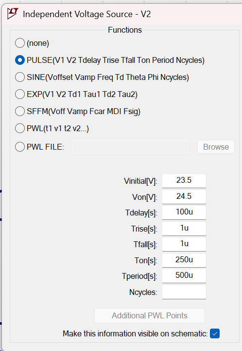

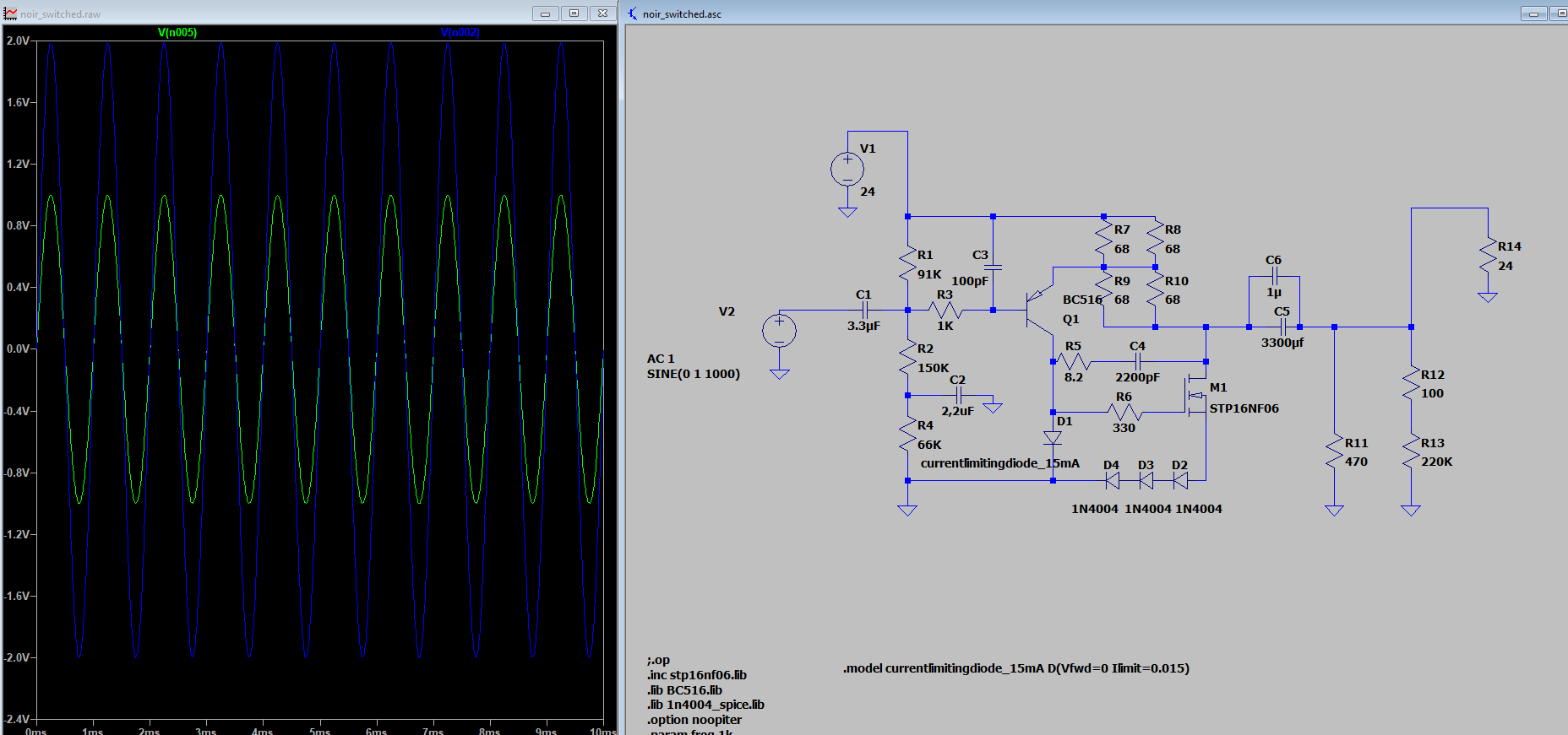

@florian911 , suppose for a moment that the SMPS noise filter in Noir is less than perfect. Suppose that some nonzero amount of noise is present, riding atop the 24VDC supply. Look at the schematic of #504. Look at C3. Look at R7 & R8. Ask yourself what happens if the hypothetical +24V supply is noisy.
In your LTSPICE .TRANsient simulation, set the input "V1" to zero millivolts of input signal, and set the supply "V2" to be a 1 volt peak-to-peak square wave at 2 kHz, riding atop 24 volts of DC. Now you have an amplifier whose signal input is zero; is its signal output also zero?

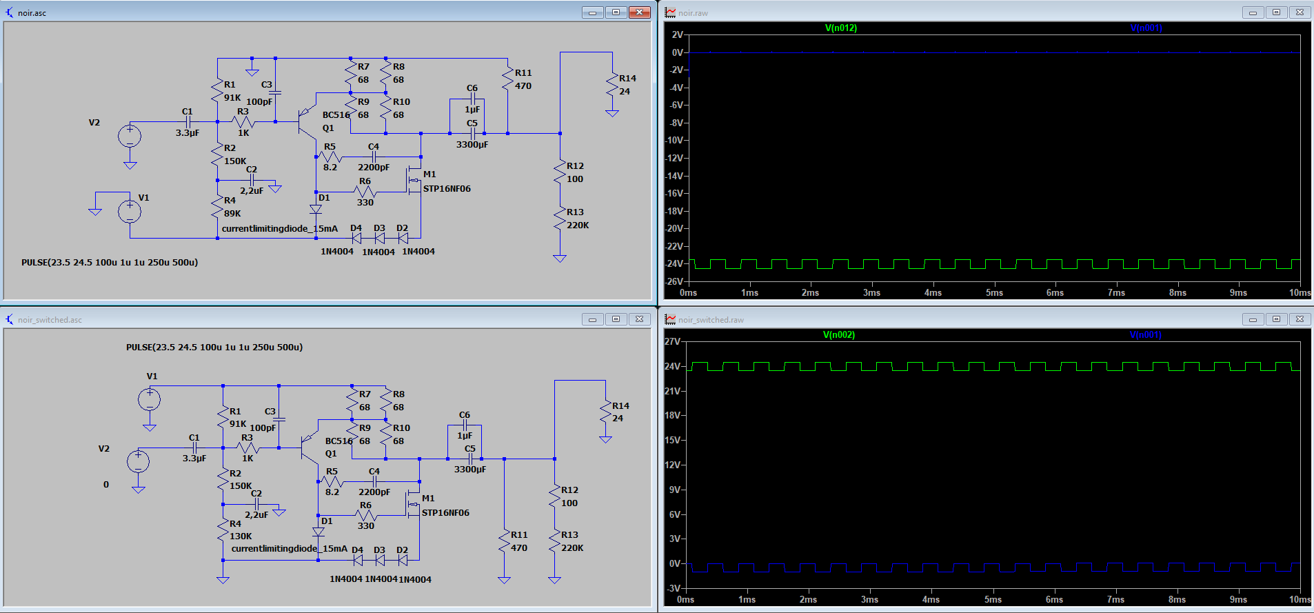

Thanks, so this is probably what you mean, right? V(n001) is the voltage over R14 (load).
(original version on top)
Sure, I just let it out for simplicity. Lets hope that I don't have a 1V (p-p) ripple 😉 (I had to useda substitute PSU by Meanwell, the one in the Mouser BOM is not available in the EU), but at the moment I don't have an oscilloscope here to measure (has anyone experiences with the Picoscope 2204A? Probably buying that).suppose for a moment that the SMPS noise filter in Noir is less than perfect
If my understanding of above simulation is correct, the version with NEGPWR is more tolerant to noise on the supply, nevertheless I would like to filter it out as good as possible. Do you have a suggestion in which direction the CLC-filter at the power supply section should be optimized? Like a start value of inductance? Or could an additional LDO be beneficial?

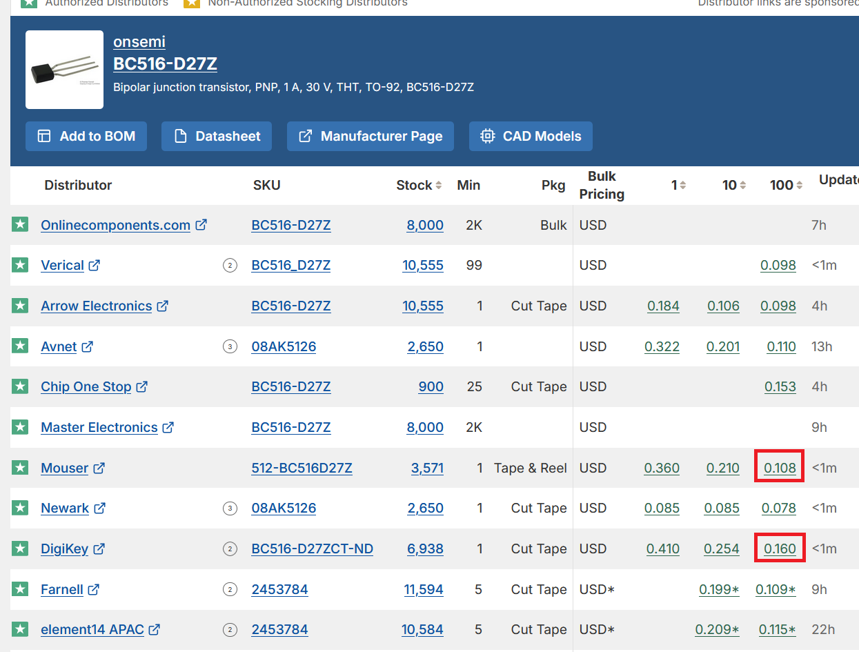

There are currently 10,000 BC516-D27Z available between just Digikey and Mouser. No doubt many others out there also.
I wouldn't get too excited about fancy caps - Audio grade is unnecessary for power supply smoothing duty.
I tend to favour the EEU series with the longer life and low ESR, but usually the final decision is based upon price versus datasheet attributes such as temp rating / life. Sometimes other recognisably quality brands and product ranges have specials that fits the bill just fine.
At the moment its still 100% Noir (except not available wallwart) 😉I'm just brainstorming some ideas.Good luck with your no-longer-a-Noir design!!
These two are the best available sources for private persons and 10k transistors is not really that much, isn't it? But of course I am not sure where this type is still used. It would only be sad if I build it now with BC516 and in a few month if I would build another one for a friend I would have to think about a redesign (e.g. ZTX705 is not pin compatible).There are currently 10,000 BC516-D27Z available between just Digikey and Mouser.
Sure, I would only change C5 in above schematic but only if it's really worth it.I wouldn't get too excited about fancy caps - Audio grade is unnecessary for power supply smoothing duty.
A lot of diyAudio members routinely buy 100-piece lots of TO-92 transistors, especially PNPs and PJFETs and PMOSFETs. It seems that semiconductor manufacturers are phasing out thru-hole P types right now, and may or may not phase out the complementary thru-hole N types at some future date. Spend twenty dollars for peace of mind, while you still can. Call it cheap insurance.

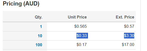

You could buy 10 now to be on the safe side - that would only cost $2.20USD. 100 would be a little above $10USD.
Cheap insurance rather than trying an untested alternative that may or may not have the desired outcome in terms of design performance.
Thanks, I will do that.

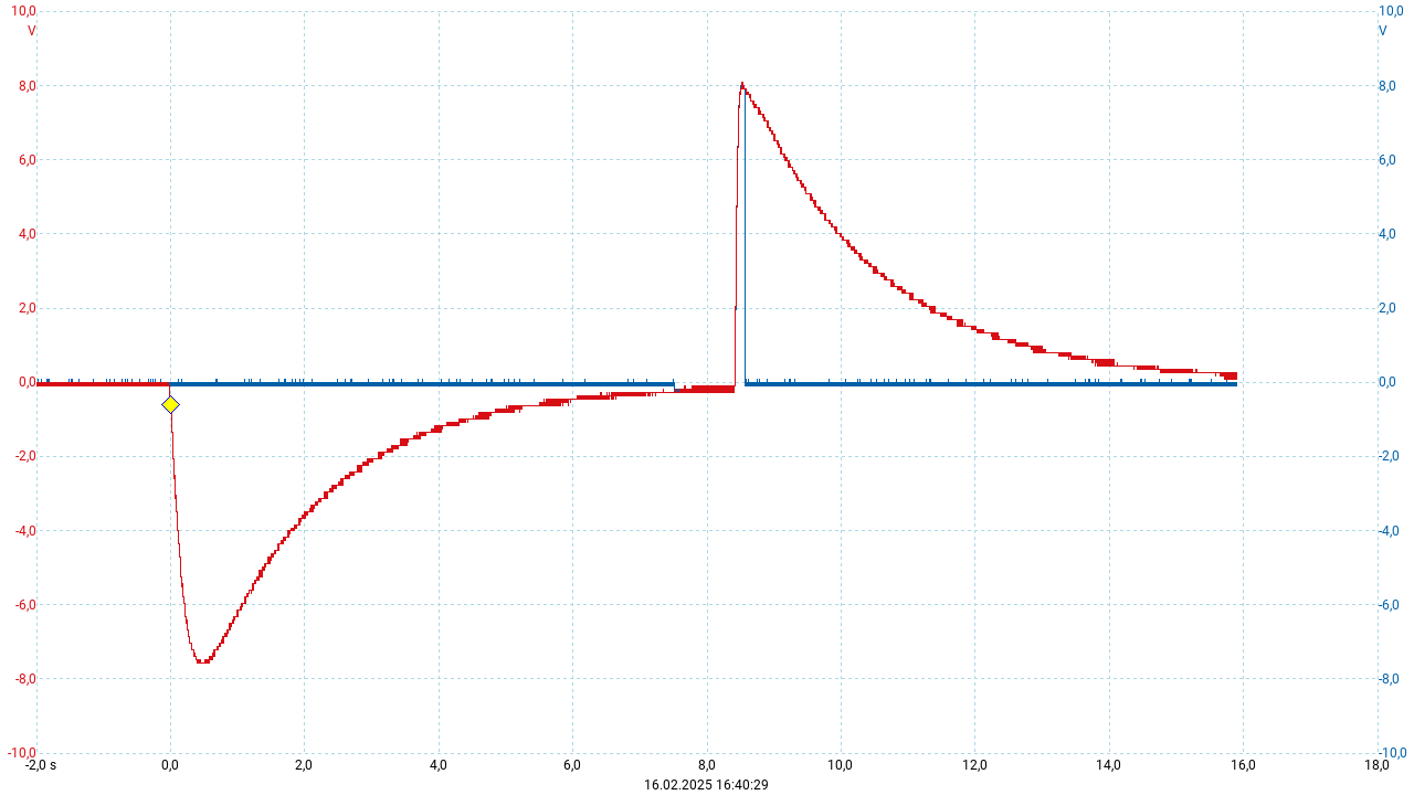

@Mark Johnson Ok, I left out the DC protection part and connected the relay circuit to the same 24V (isolated) PSU as the Noir, that shouldn't lead to problems.
@Julian RO Why is that? Seems to work at least for startup at the moment, switching off is not fast enough (yet), there is still a peak of around 100ms:
Red: Output of the amp (switching on and off)
Blue: Output to headphone/after relay
