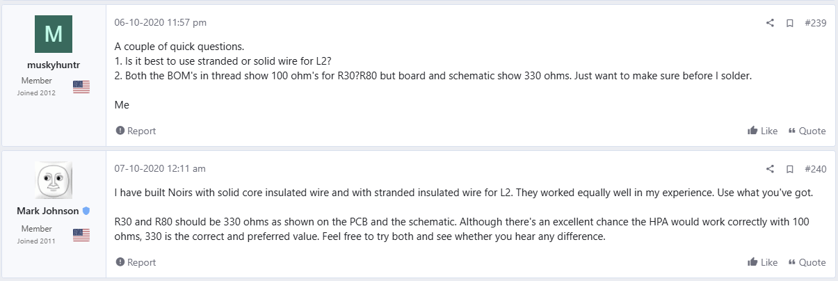

Got my kit from diyAudio store and parts from Mouser. A couple of questions....
1. What is the value of Resistor R30 and R80? The PCB silk screen says 300 and the mouser 603-MFR-25FBF52-100R measures at 100 Ohms 1/4 watt, 1% Yageo metal film resistor.

I think the BoM maybe hasn't been updated:

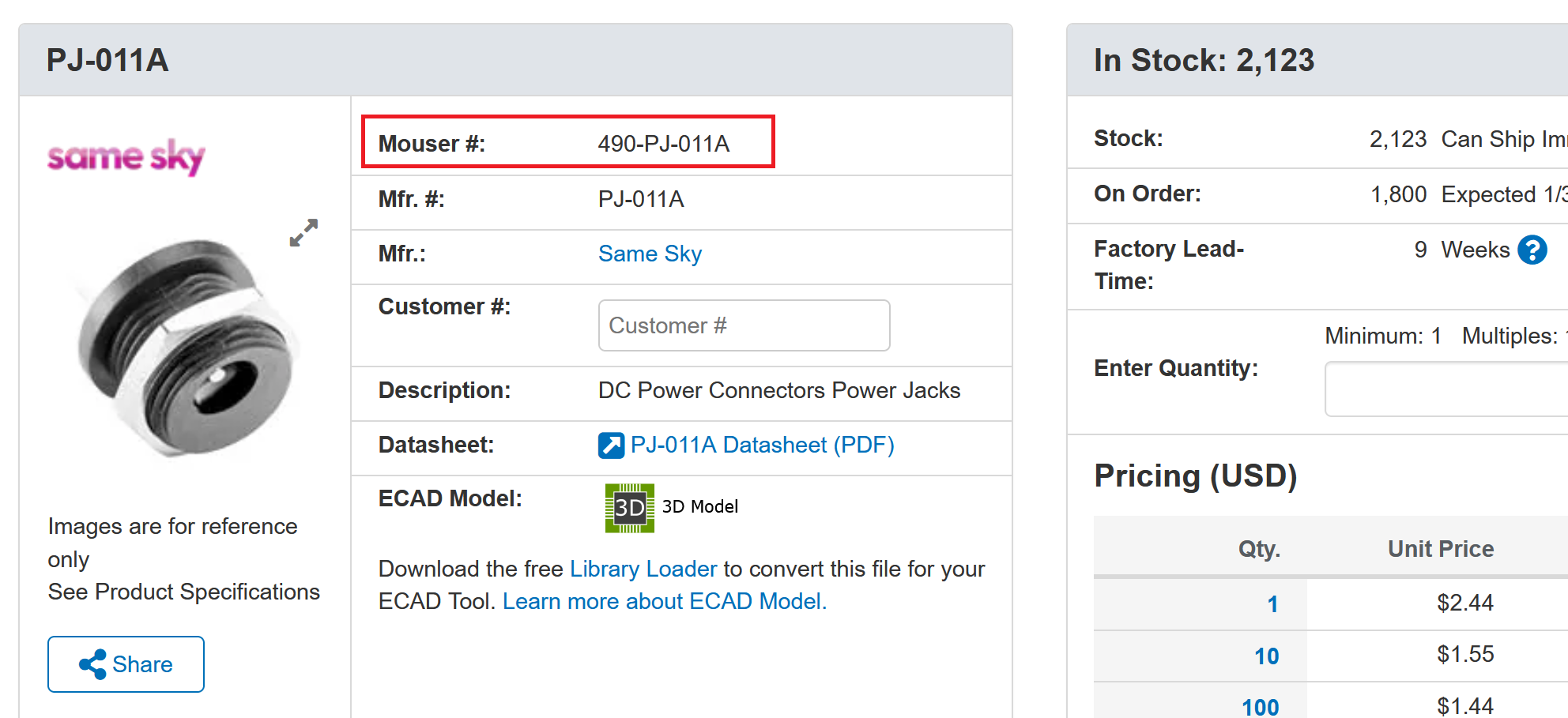

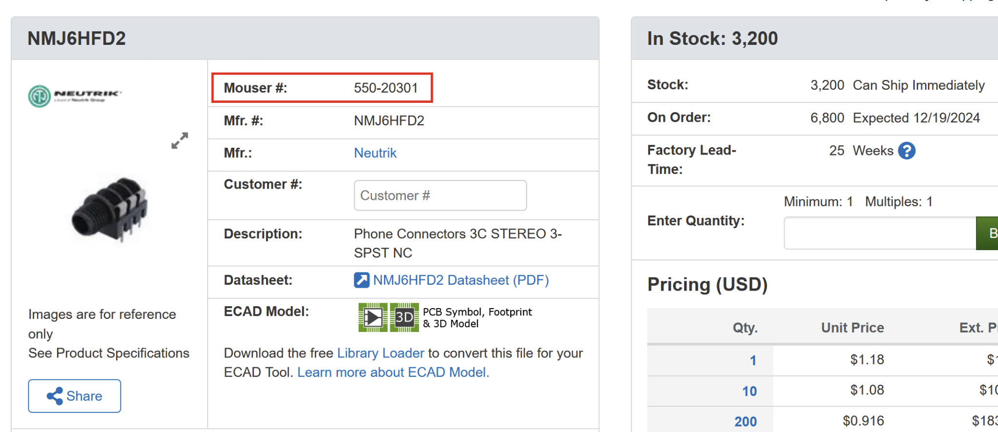

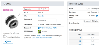

I can't seem to bring up the Mouser BOM. Can someone post the part numbers for the dc jack and H/P jack please.

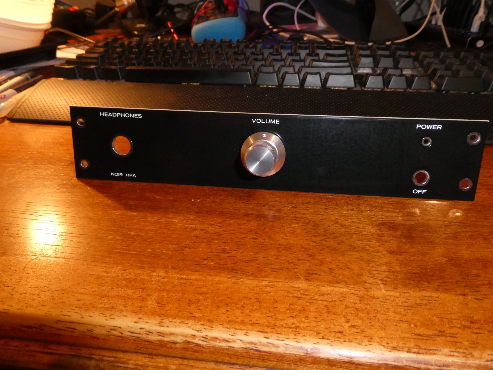

Hi everyone!

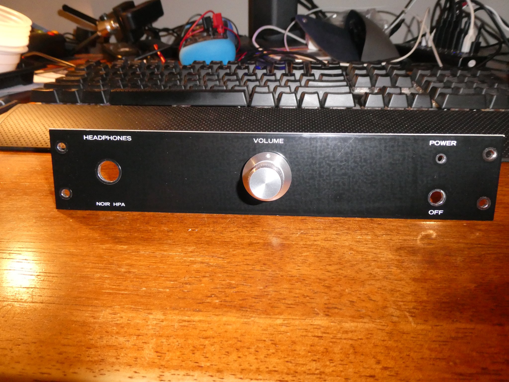

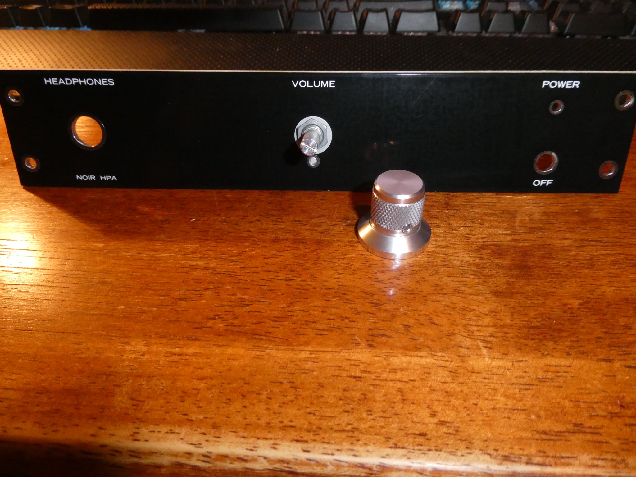

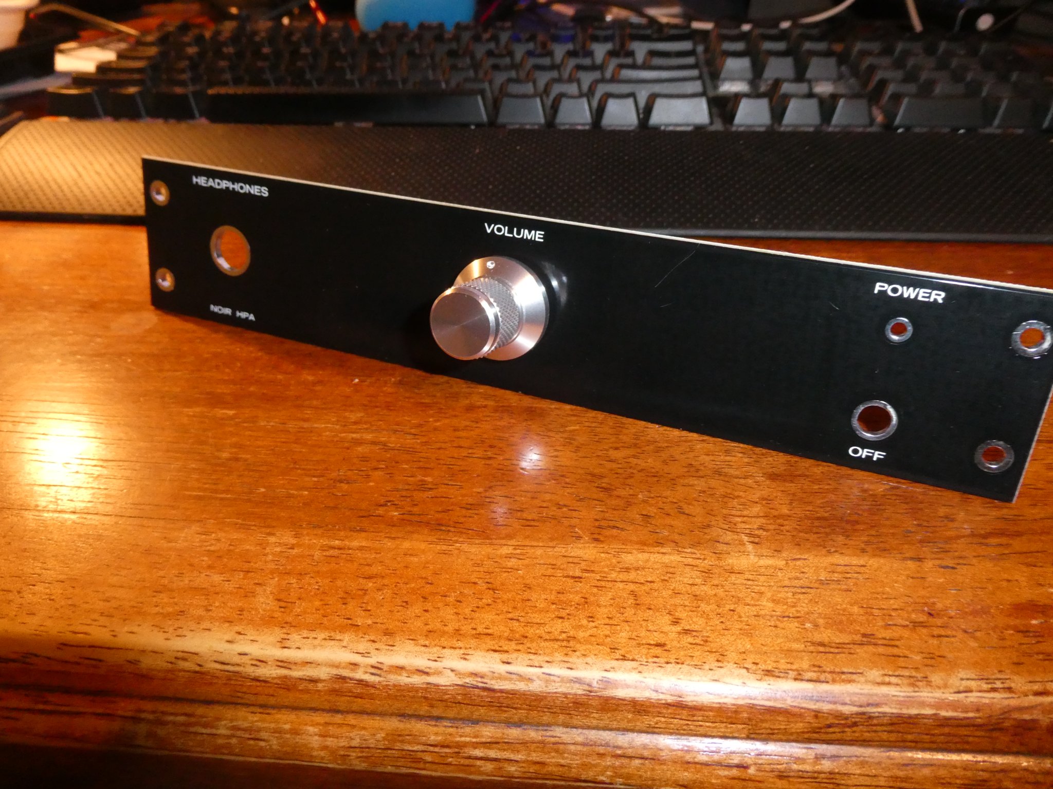

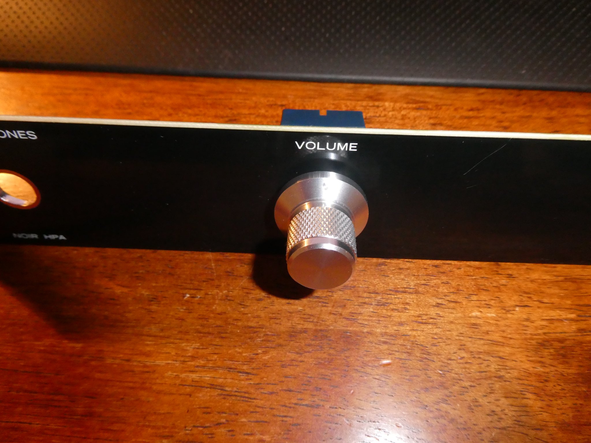

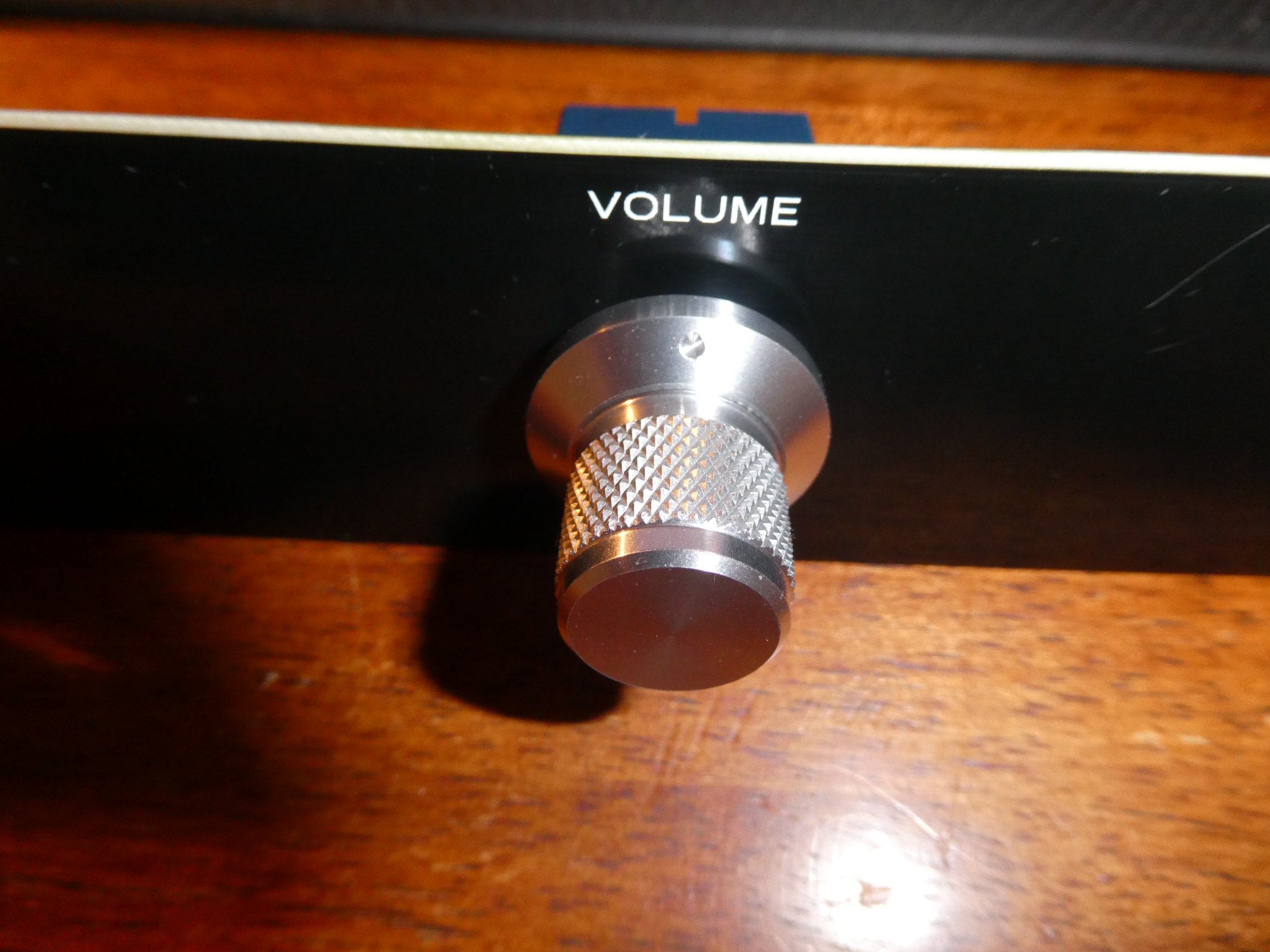

I did find a different solid aluminium knurled volume knob for the Alps potentiometer that looks like a knob from an expensive lab instrument. It has a dimple in the skirt so you can see where it's at. It fits perfectly on the shaft diameter-wise, except that you have to shorten it possibly 5-8 mm to sit closer to the front panel. See page 32 of the build instructions. So, take out your Dremel and shorten that shaft. I think it fits very well with the black front panel. I like it!
If you want one too, I bought it from Amazon: uxcell 25mm CNC Aluminium Alloy Potentiometer Control Knob Cap 6mm Hole.
They sell them in different sizes, and uxcell calls them "universal top hat knobs".
Walter

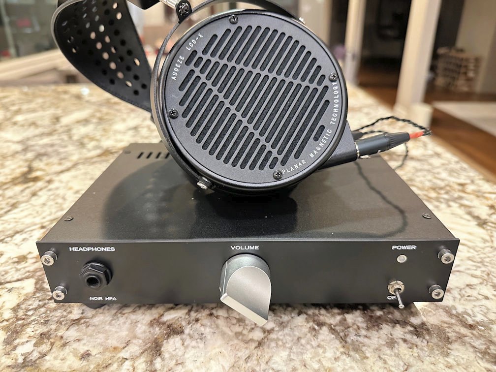

Curious has anyone run this amplifier with planar magnetic headphones? I have a pair of audeze lcd-x that i need a new amp for
My last amp was the schiit lyr 3. At 32 ohm it was something crazy like 6 watts. These headphones need 1-2 in my experience. Kinda power hungry
