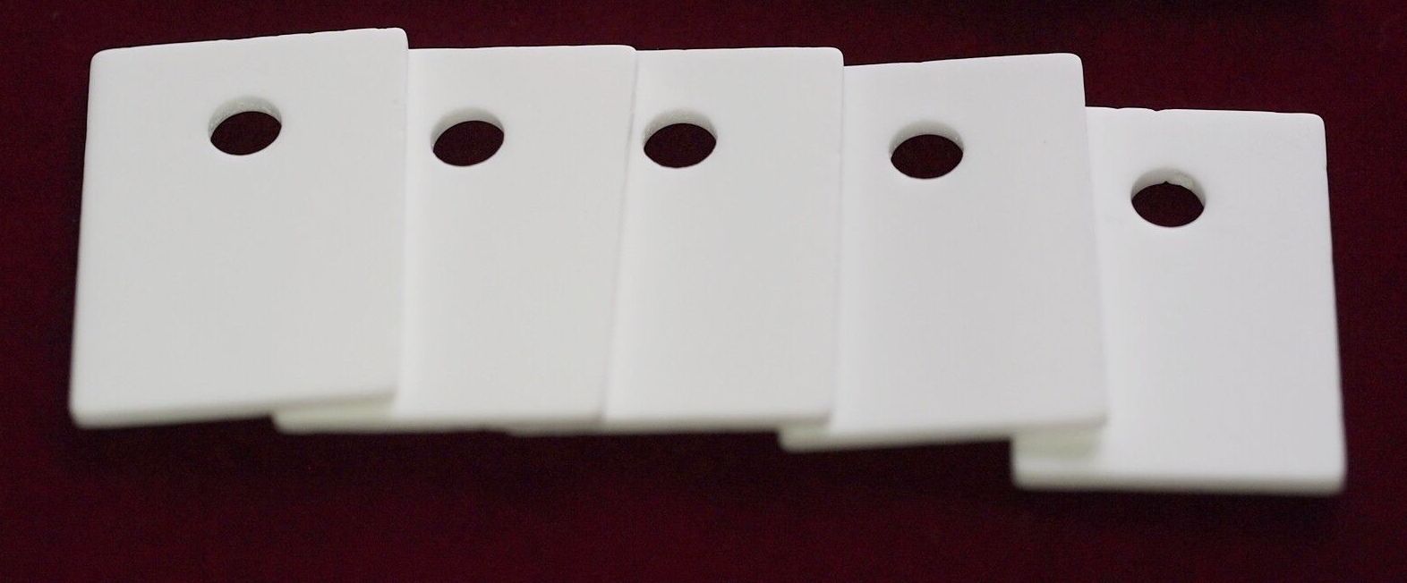

You can use any Sil-Pad insulator or mica in TO-220 size or you can buy Keratherm Red insulator from diyAudio store .
Bear in mind that the insulators from diyAudio store have to be cut to TO-220 dimensions because they are bigger though .
I used these ceramic insulators that i had available but i would use mica or sil-pad as well .. Keratherm Red is supposed to be one of the best solutions and i have used them in TO-247 mosfets of class A amplifier but they are expensive and i keep them for more demanding projects .
