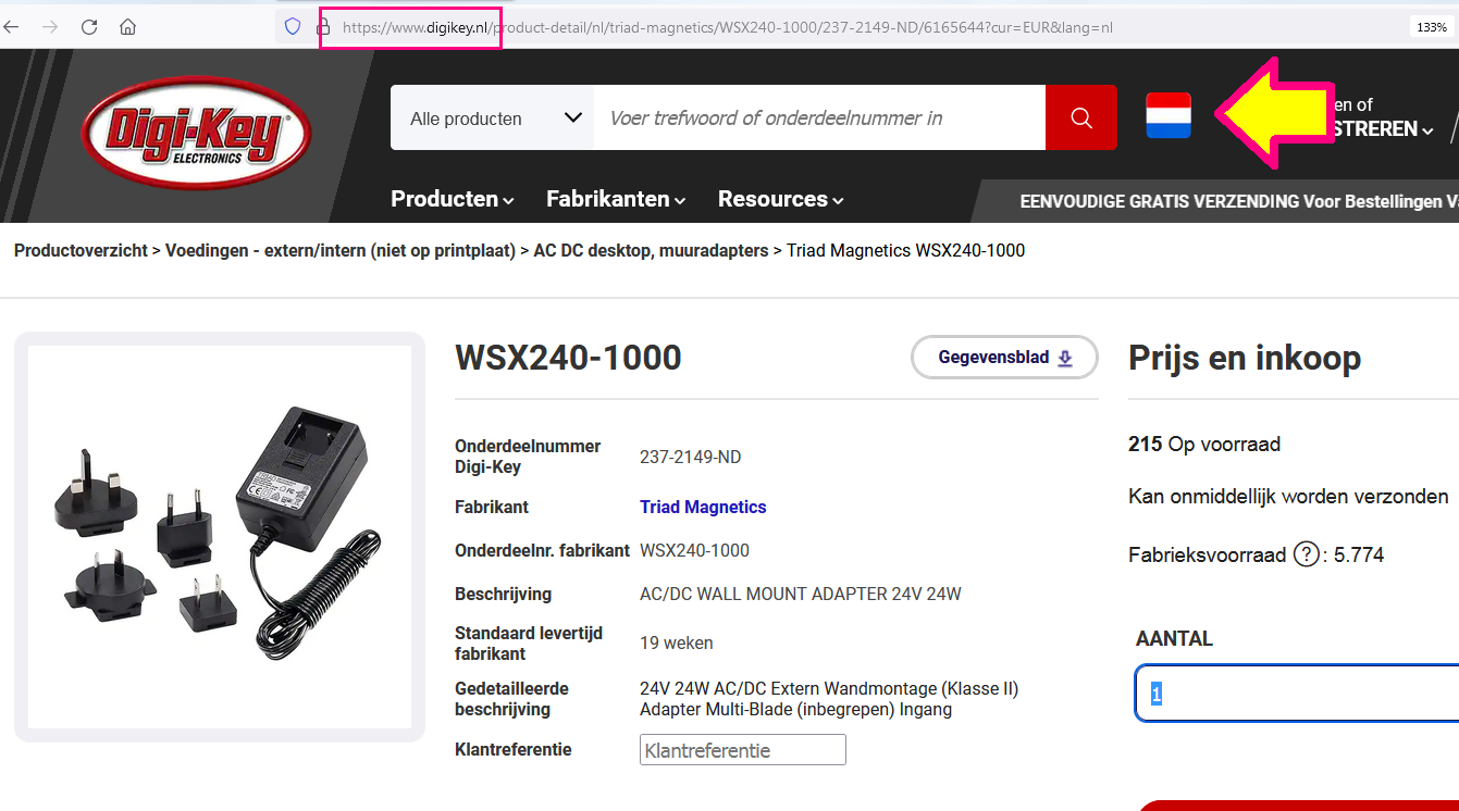

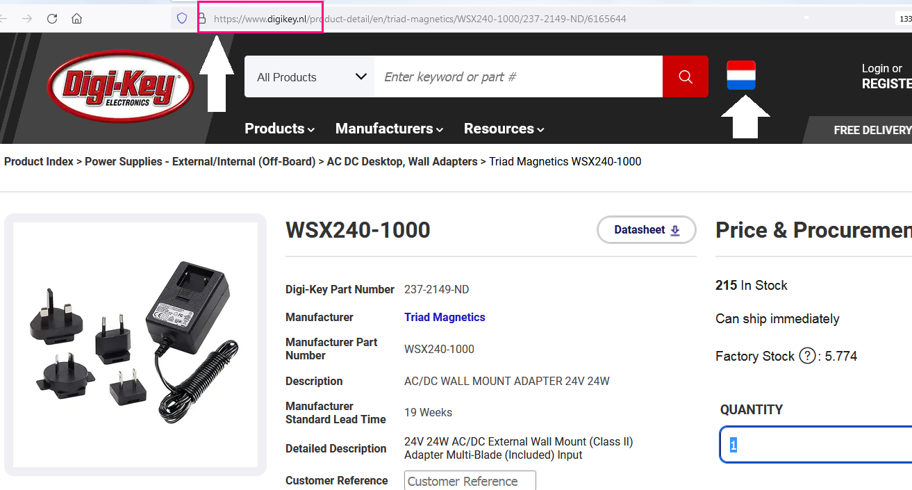

About the power supply, are there any special requirements, or can I take any 24 volt, > 750 ma wall wart?
I noticed the one in the BOM is out of stock for quite some time now, and I think I may have some lying around somewhere (1.5 and 4 amps).

Because this is a high qality hi fi project I would suggest you pay a little more for you PSU you could also add the diyaudiostore SMPS filter.
Supplies with 24 volt DC output and rated greater than 500ma should be fine.
The wallwart type is safest for a novice, just make sure it has your contries mains connector plug.
You could try Digikey, Mouser, or even RS components.
Have fun.
Mouser's website is offline at the moment, but I was able to find a suitable 24V DC wall wart at Netherlands DigiKey: (link). Images below. Maybe a more thorough search would turn up another one, rated for 500 mA {this one is 1000 mA -- okay but unnecessarily overpowered}

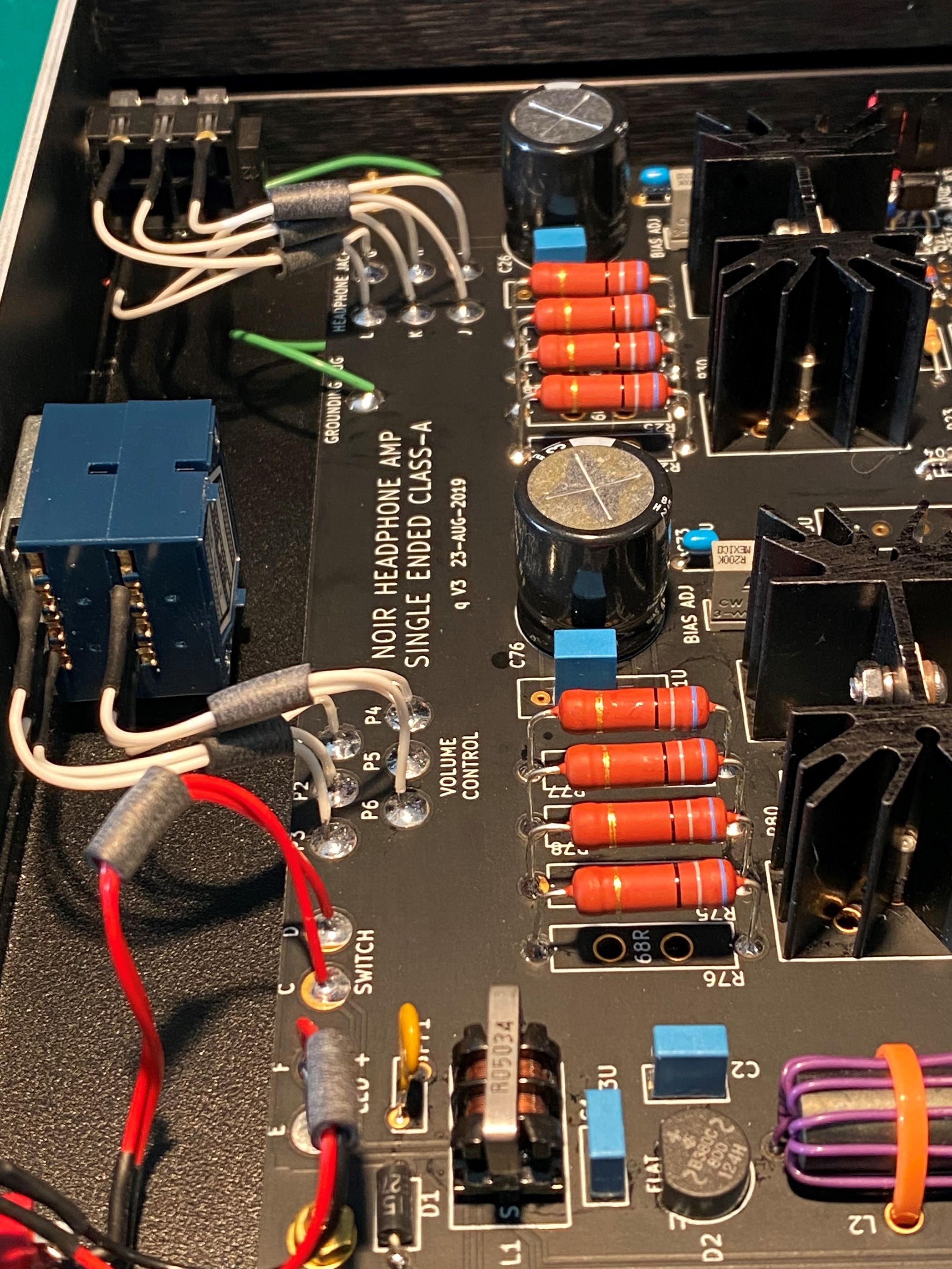

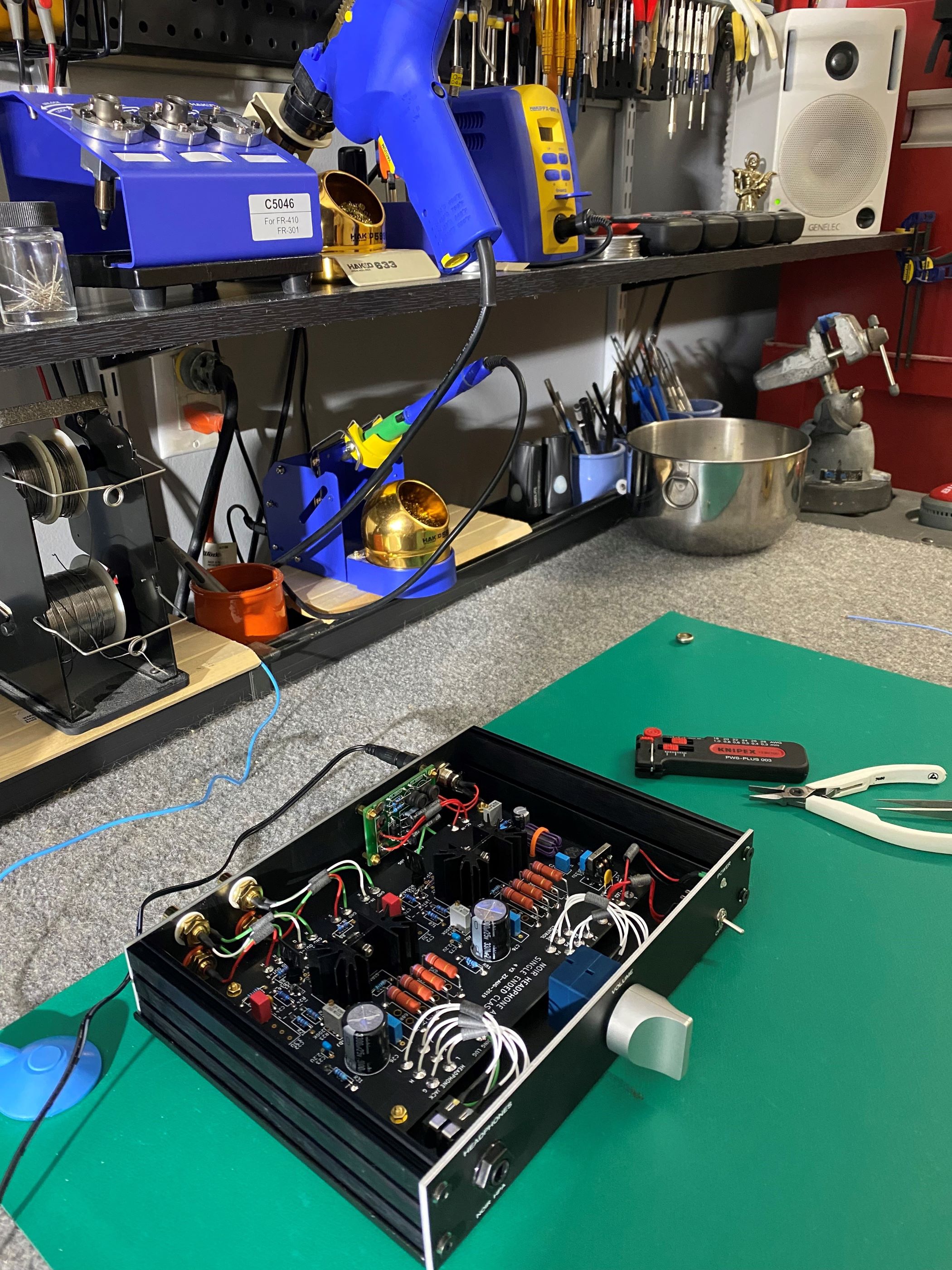

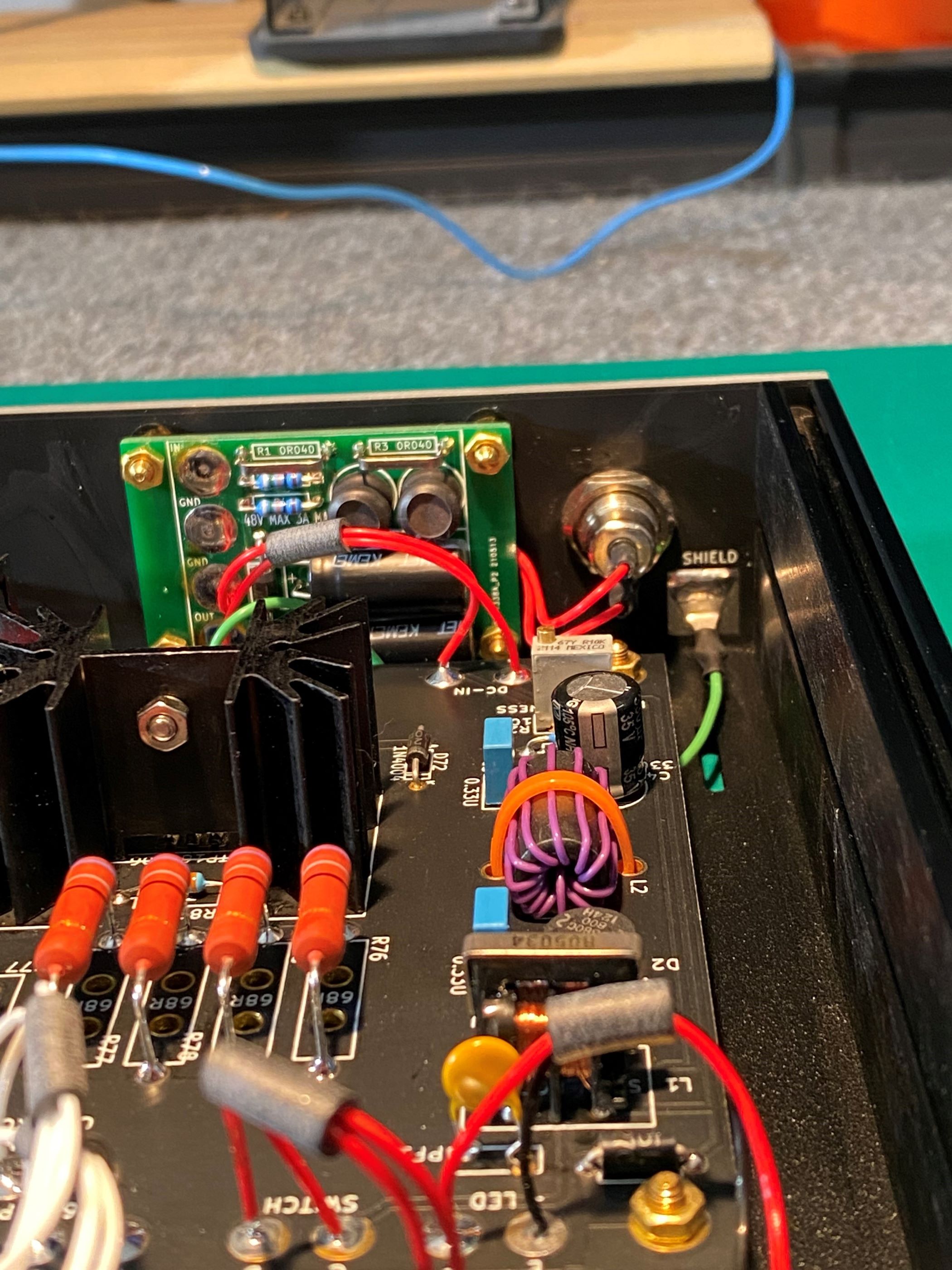

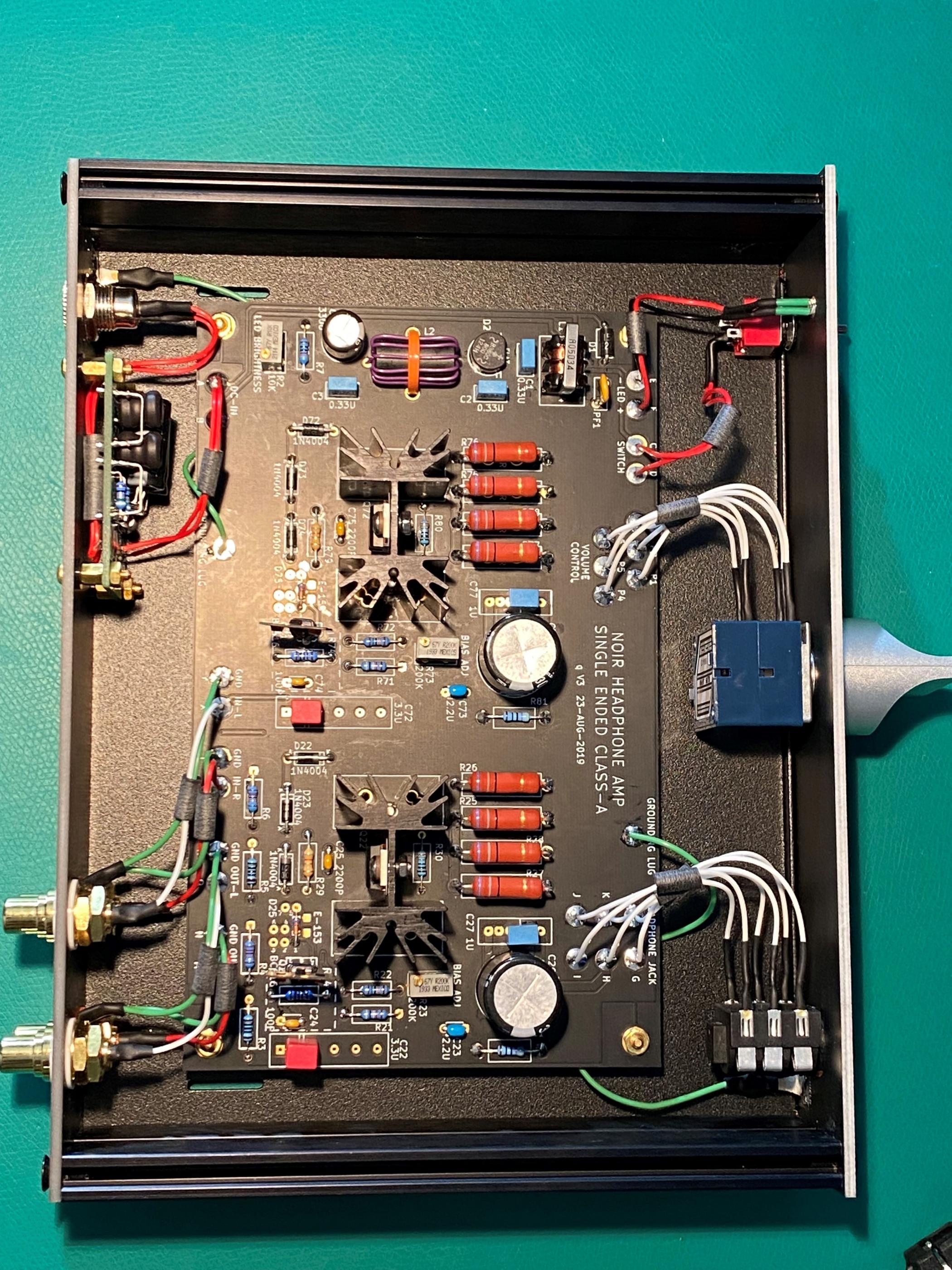

Completed my Noir HPA
This was another great project form DIY Audio Store,
I like the black PCB, makes all the component pop. Cleaning black PCB seam a bit harder as you see any residue that is left behind. I still have a few final touches, I tried (3) different products but ended up with Isopropyl Alcohol and paper towel to get it clean. Lay paper towel strip on the PCB and use a brush or Q-Tip with Alcohol and rub it on top of the paper towel, it will pull the flux residue into the paper when the alcohol vaporizes. Almost bought a ultra sonic cleaner but didn't in the end, maybe future purchase.
The Build went smooth, the full kit was not in stock, so I sourced the parts between Mouser, Digi-Key, Parts Connexion & Parts Express. It a bit of a treasure hunt find all the parts you need for a project these days, but adapt and overcome.
Startup went well; followed the build guide, and dialed back all (3) pots. after applying power the Bias started at 2.5V and raised to 5.10V. Small tweak after warm up and all was stable. No His or Hum, played some of my go to tunes on my powered speakers to do a quick test if audio works, the Noir sound great but need to spend some more time with it and try my headphones over the weekend.
Next Project will be the Aleph J Dual Mono, cant wait. I have received all the parts, but still have to order the enclosure. Planning to start mid December during my 2 weeks vacation. (if I can wait that long🙂)
I have to start thinking about speaker selection, I'm building a power amp but don't have a pair of passive speakers (No Bueno, as we say in Miami)
I hope that everybody has a great weekend,
Greetings form Sunny Miami,
Max
