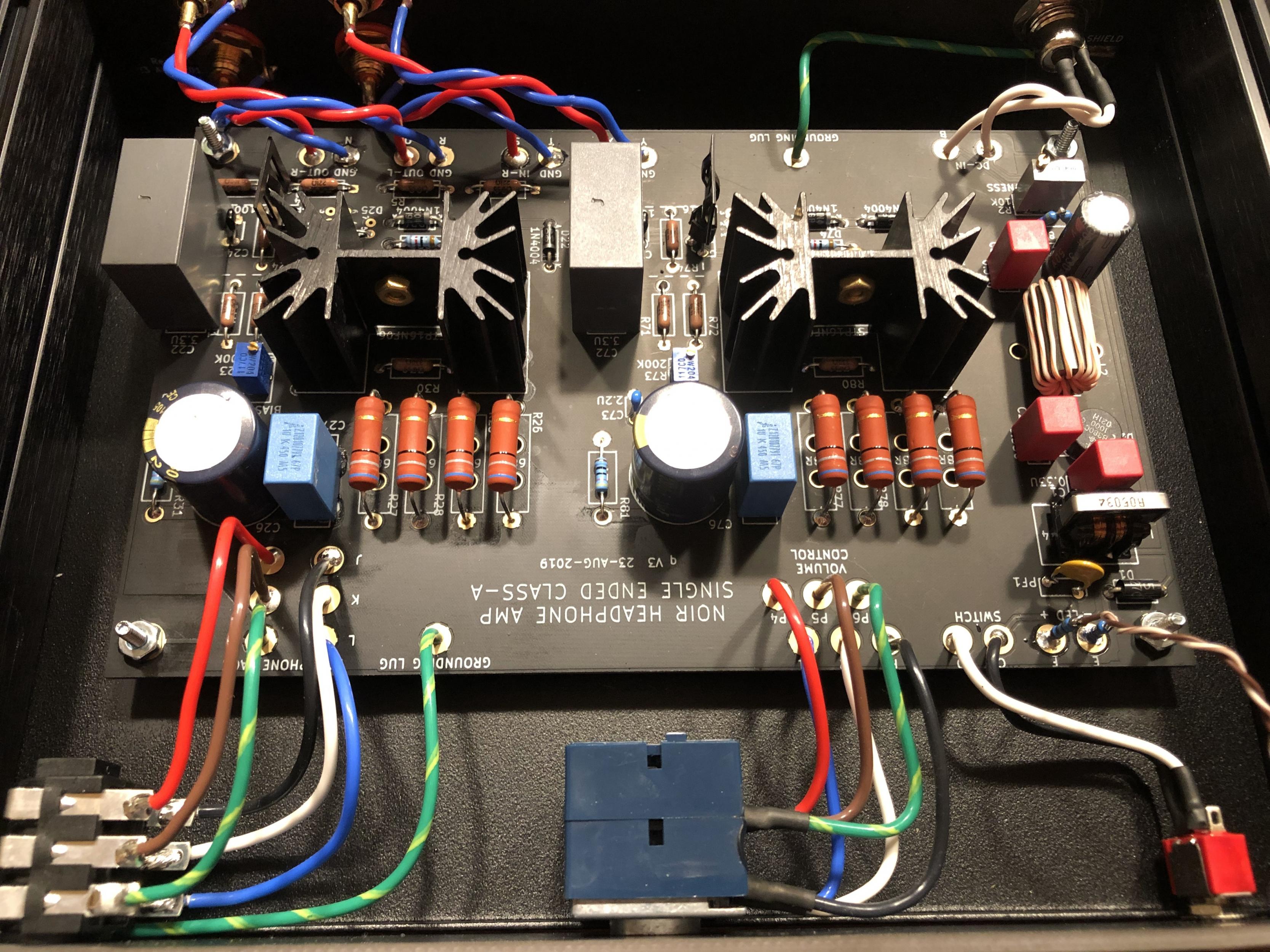

Very nice build, Fred! Looks like you drilled your own front panel to accommodate the locking headphone jack, but left the stock rear panel in place. And the preamp output RCA jacks are mounted in position, even though you don't have flywires connecting them to the circuit board. Very pretty.
yes indeed - I did need another back panel and drill it with only 1 pair RCA as I'm not using the two of them. Very happy with sound Mark! Great design!

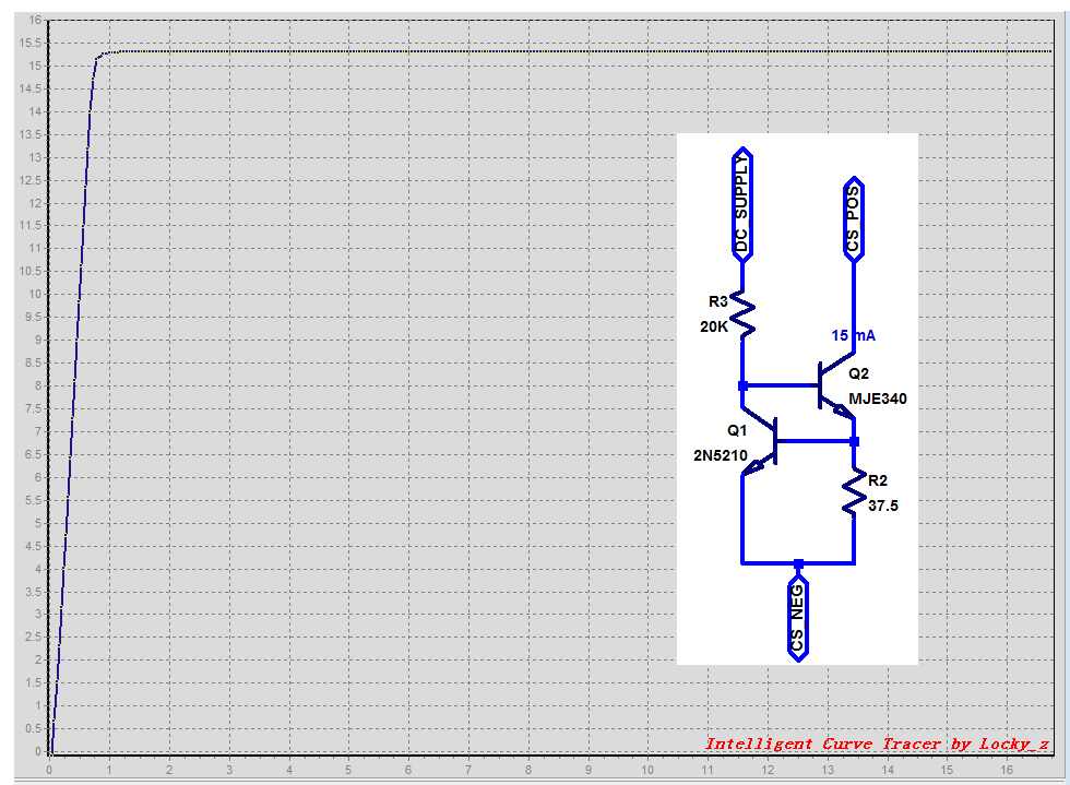

I got a Private Message containing the inquiry quoted below. Because I believe the Forum is a much better vehicle for communication with the entire diyAudio membership, I've copied the question here. Anyone and everyone, please accept my invitation to share your insight, thoughts, studied opinions, and casual remarks.
click on the image to see it full size and undistorted:
Dear [diyAudio membership],
I found this image on the Forum and am thinking about putting it into a modified Noir hedphone amp circuit. My "quick question" is:
Does the CS pos and CS neg equate to the positive and negative sides of the E153 in the Noir circuit? And does the DC supply = Gnd?
I'll take a look at PSRR enhancement caps and see if I can figure it out. It's been a while since I did actual electronics stuff 😱

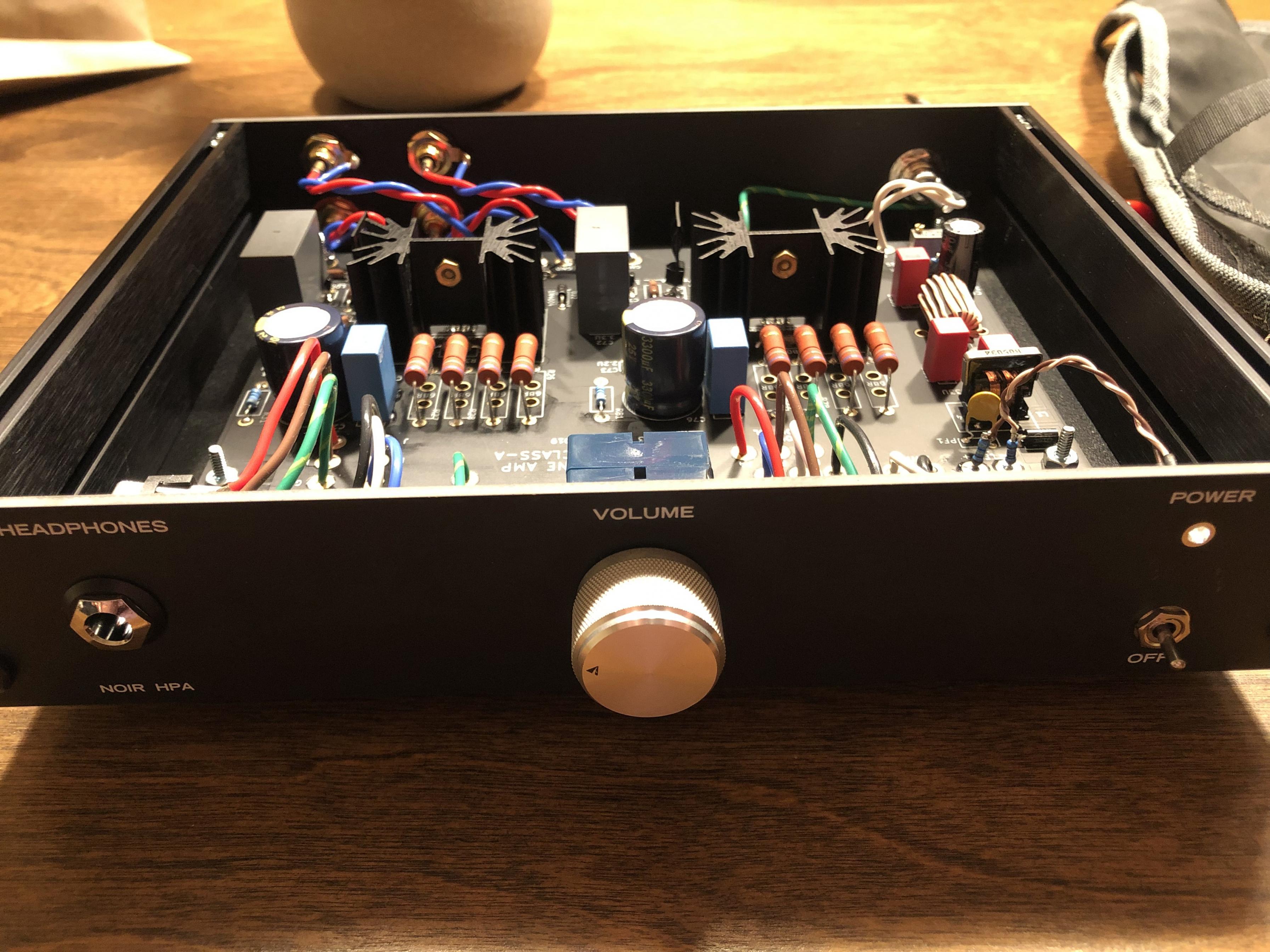

Though I'd share a couple pics of another recently completed Noir. Had fun picking out parts for this, though I think I paid for shipping from four different vendors. Parts are scarce right now. Sounds amazing with my K702s.
Lovely build, csdawson, congratulations! Beautiful job cleaning up flux residue and gunk from the PCB, it's pristine.
You must have a very high brightness LED to need extra series resistors installed in both flywire holes E and F.
Haha, yeah. I didn't look closely enough at the intensity number and it was a factor of 100 higher than the speced LED. I like my LEDs quite dim, so I just kept adding resistors. I think I ended up with nearly 200k in there.
