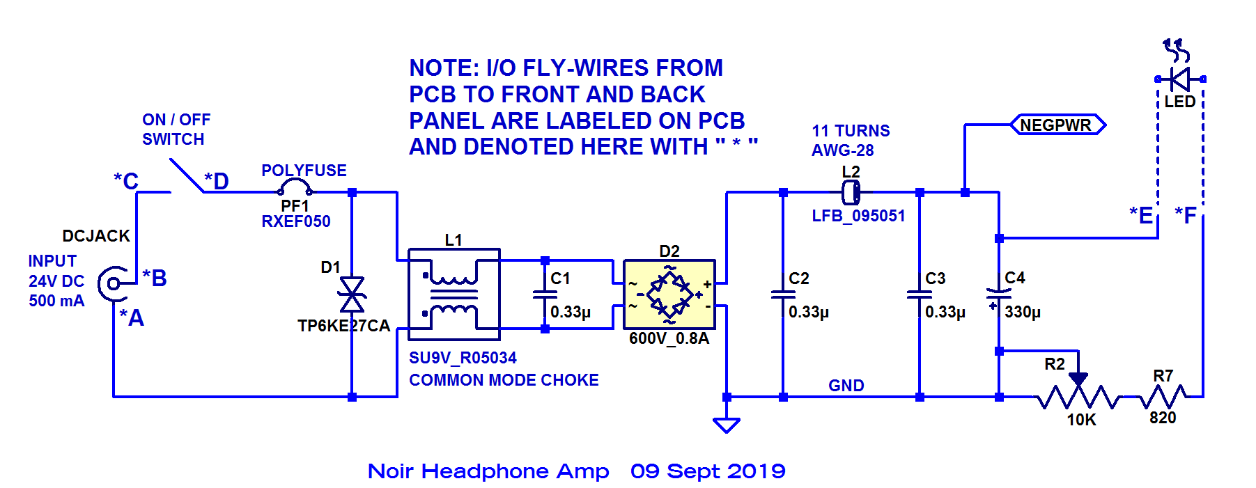

I had time to come back to the "problem" of the glowing LED described in the post #275
I measured some voltages and found out that when the power supply is connected, Noir is switched off, and other-audio-gear with the grounded output is connected to the Noir input, I have 2.35 VDC accross the LED, and that makes it glow faintly. The glow does not start immediatelly - it takes some 8-10 sec to start glowing, as some capacitor charges up and then gives the voltage accoss the LED.
I also measured the AC from the negative rail of the power supply and the ground and got ~1.5V.
Yes, this can be solved (or rather hidden) by putting 200R resistor in paralled with the LED - with the resistor in place the LED does not glow. I tried this.
But the most worrying thing is that Noir does not work at all with the other SMPS (Mean Well 24V, 5A - the one that was supplied by the diyAudio store with the ACA) when connected to the other equipment that is grounded. This SMPS starts blinking as if some protection kicks in and pulsates in 2 sec cycles. Therefore I find it not being ok to just stick the resistor and forget it, as it shows that (at least mine) Noir is not usable in some conditions.
I like the sound of Noir very much, so I would like it to be "foolproof". My knowledge is not good enough to understand what is causing the problem and how it could be eliminated for sure rather than just hidden.
Would be glad to try something else if somebody gives some ideas to try.
-Alvydas

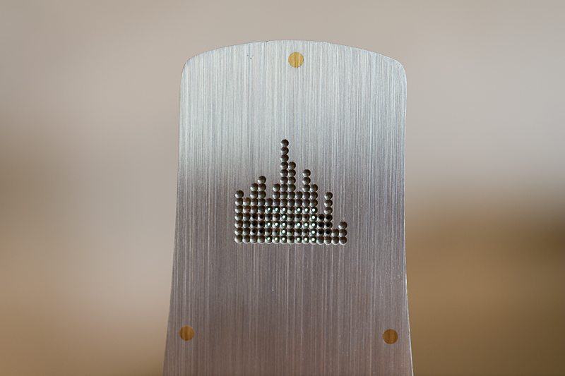

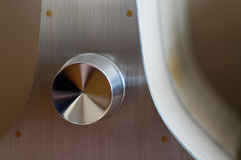

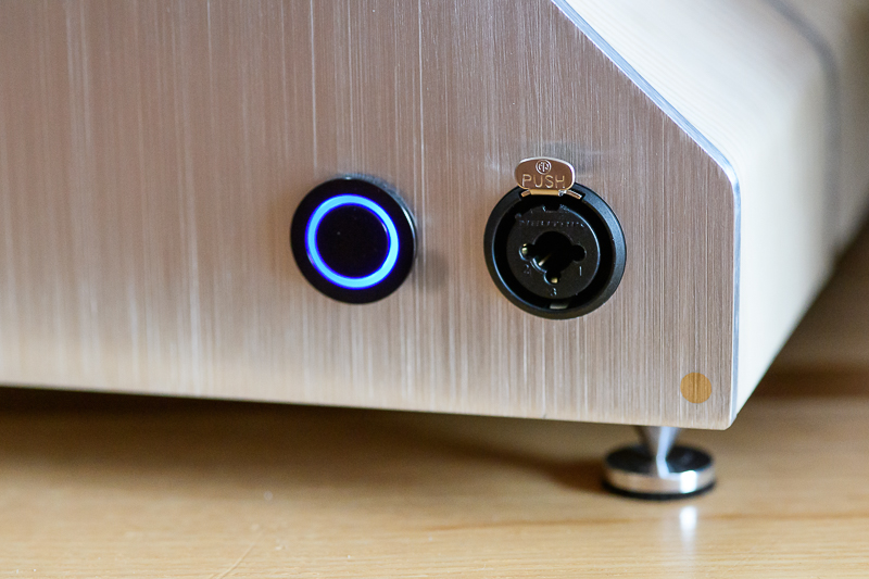

As promised, I come back with some photos of the project, it was long, and complicated and it's not over.
The general design is not mine, you can find it at "LIEDSON", I still modified the curves, the angles and the size, added aluminum between the sections.
It is controlled by an ARDUINO, which allows me to manage the inputs / outputs with an impulse on the volume button, as well as the management of ON / OFF with the push button at the bottom.
I use a 64-step "KHOZMO" relay attenuator, the supplied remote control has a 5th ON / OFF button, I got its code to control the ON / OFF from the arduino using an IR LED .
I inserted a passive Pre-amp output for my F6, the power supply is composed of an R-CORE transformer and 64 capacitors for a total of 10 000uf.
When I said that it was not finished, it is because I faced difficulties with the wood (fir) which is too fragile, and difficult to machine.
I started on this wood because I wanted to keep the grain along the entire length of the block.
So I am going to redo another block this time in American Walnut, a noble wood, easy to work, I will work it this time on glued edges of 40 to 50mm and the result will be even more beautiful.
Regarding listening, I was able to test it with 3 different power supplies, SMPS and classic with 20,000 and 10,000uf, the classic is beautiful, soft and pleasant.
The 10,000uf version is the one I prefer, it adds a hint of bass, while the 20 000uf version becomes fatigaunte on long listening, more the multiplication of the capacitors, allows to obtain more precise bass, very pleasant.
The negative point, I still have a buzz of present, very light, I only hear it on the ELEGIA, on the ELEAR it disappears, probably due to its low impedance (more sensitive).
In addition I pick up a series of frequencies spaced 40 sec apart, so I am considering a faraday cage, what do you think?

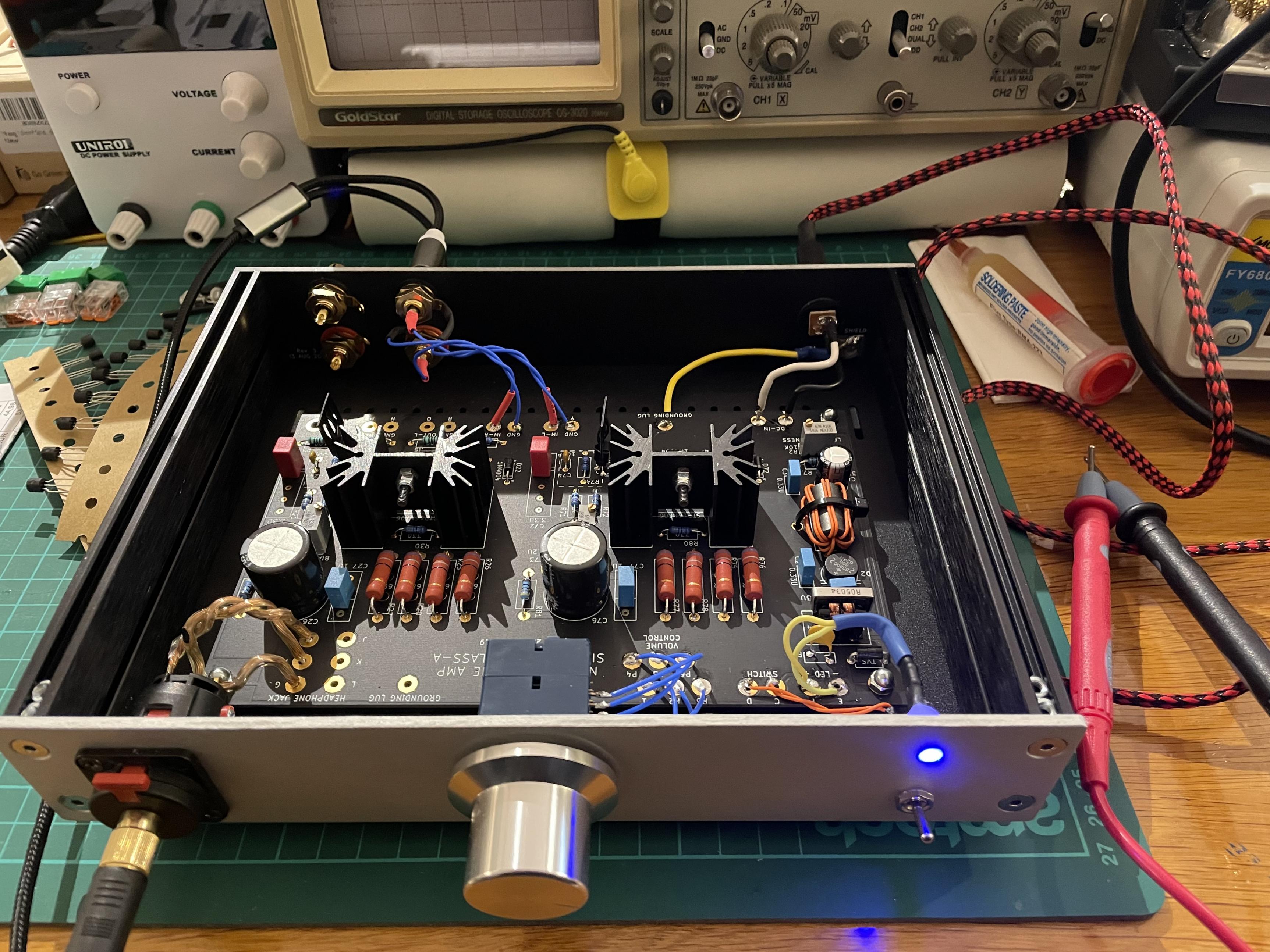

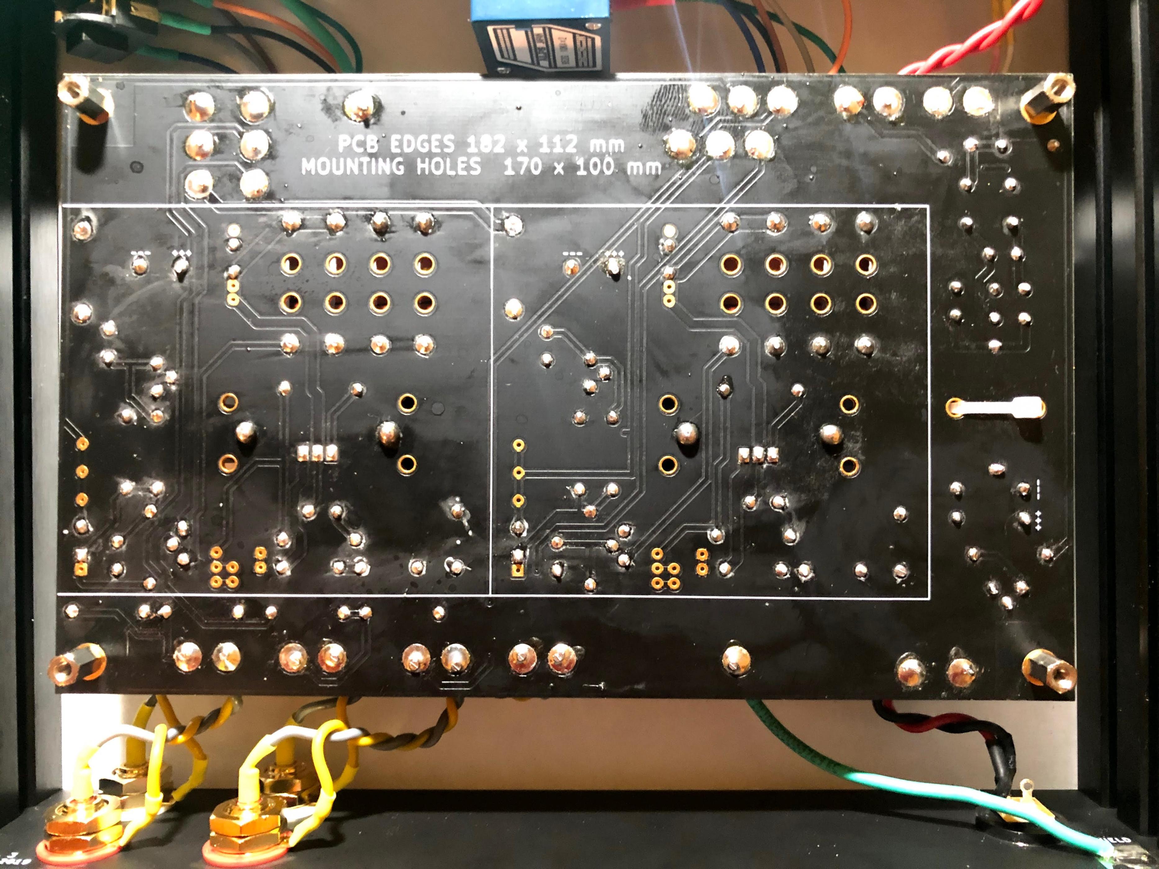

Hi guys,

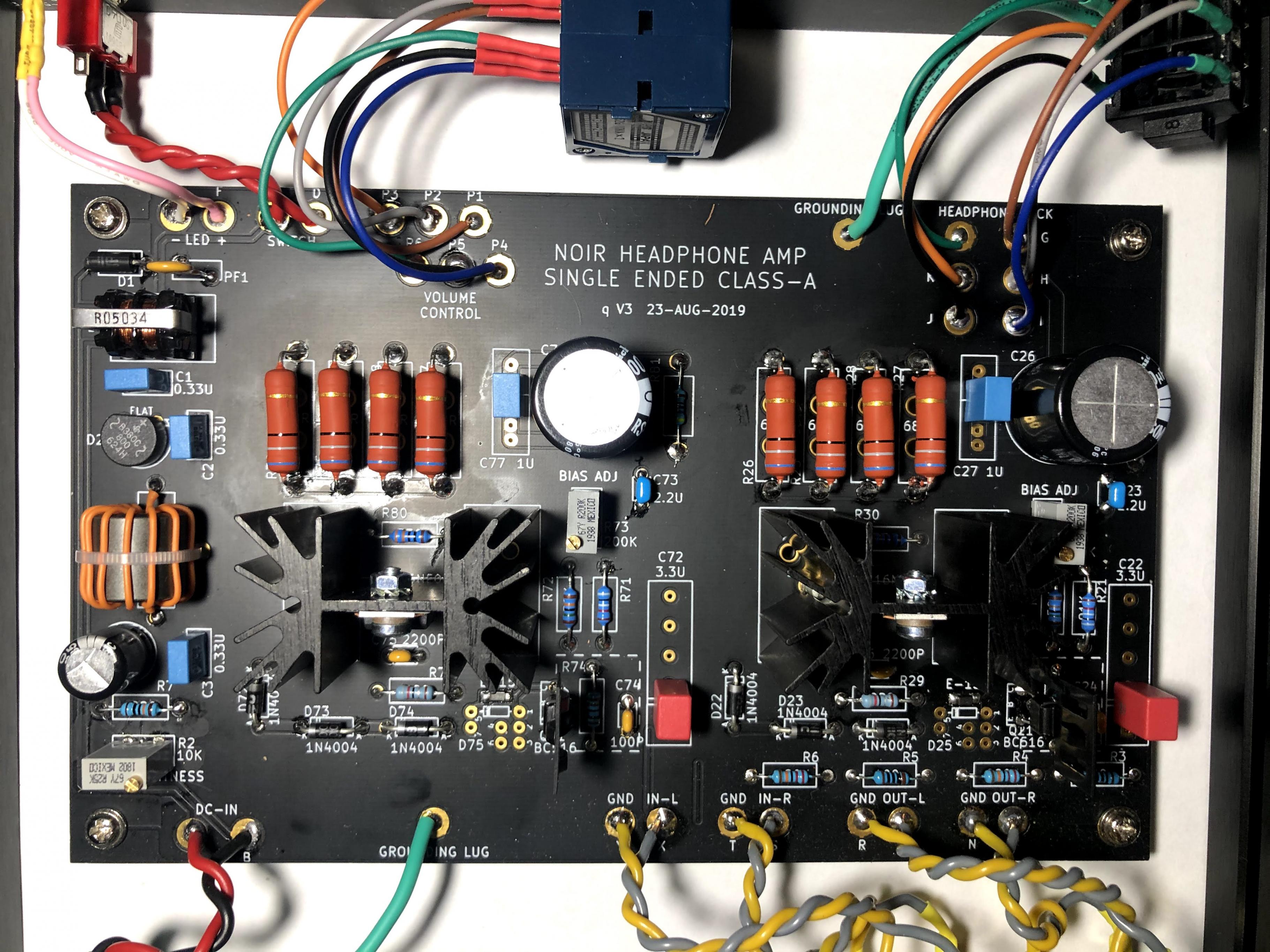

First time building an amp and I've gone with the Noir - hoping I might be able to get some assistance here. I've built speaker crossovers/headphone cables before but that's about the extent of my soldering experience.

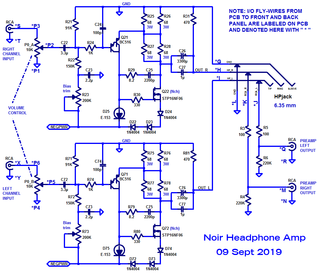

I've followed the guide to the letter but now that I've gotten to the power up and bios phase I can see with the multimeter that nothing is running through the left channel (no voltage and no heat either on R77). I've double checked the soldering on the components leading to the resistors via the schematic and it all looks alright, I've even redone C72 as a precaution but still nothing.
Any recommendations on what I can do to test this or what might be happening here?
Joined 2011
The good news is, you've got a working right channel. You can compare the measured voltages of right versus left channels, and get an idea of where your build starts to go wrong.
The schematics are attached below. I suggest you print them out, and write the DVM measured node voltages directly upon the schematics. Do it for both the right (working) channel and the left (not working) channel. You'll measure voltages between {node} and {GND} , and don't be surprised when all of your measurements are negative numbers. Noir's single ended power supply is a negative voltage after all.
Upload your annotated schematic, with node voltages, here to the Forum. Then members can offer their opinions and diagnoses of what might be happening.
_
You can check some Voltage (vs ground).
If it’s the first time you do it - put your voltmetre on a ground and then measure at some points.
Nothing difficult - just avoid creating a short…
R24 or R74 at -6.6V
R29 or R79 at -16v
You might have an issue on Q21 or Q71…
If you measure -22V on R29 or R79 that’s probably this

@andynor, I had a strange experience with different wall warts with Noir when connected to other equipment that had grounded case.
A MeanWell SMPS of 24V, 1.67A worked fine.
But another MeanWell SMPS (the one supplied by diyAudio store for ACA, 24V, 5A) did not. When powered on, this MeanWell PSU started to pulsate in cycles of about 1-2 sec, and same happened to Noir power. So some protection circuit on the PSU was kicking in. This stoped if I disconnected the RCA inputs from Noir.
The difference between these PSUs was that the fine working one did have the residual voltage of half he wall output (~110V in Europe) on its outer power plug contact, and the one that did not work did not have this residual voltage on the plug.
Go figure. I did not find the real reasons of all this.

The actual one that works for me is this:
GST40A24-P1J.
But it should not be about the actual models. I did not hear other people complaning about any PSUs not working with Noir. That's why I was confused finding that the one supplied with ACA did not work and that this problem was only when the Noir was connected to other equipment with the grounded chassis. I don't know if that has anything to do with Noir using the negative power or something. I do not know enough myself to explain this, and, unfortunatelly, I did not get any explanaition on this forum.

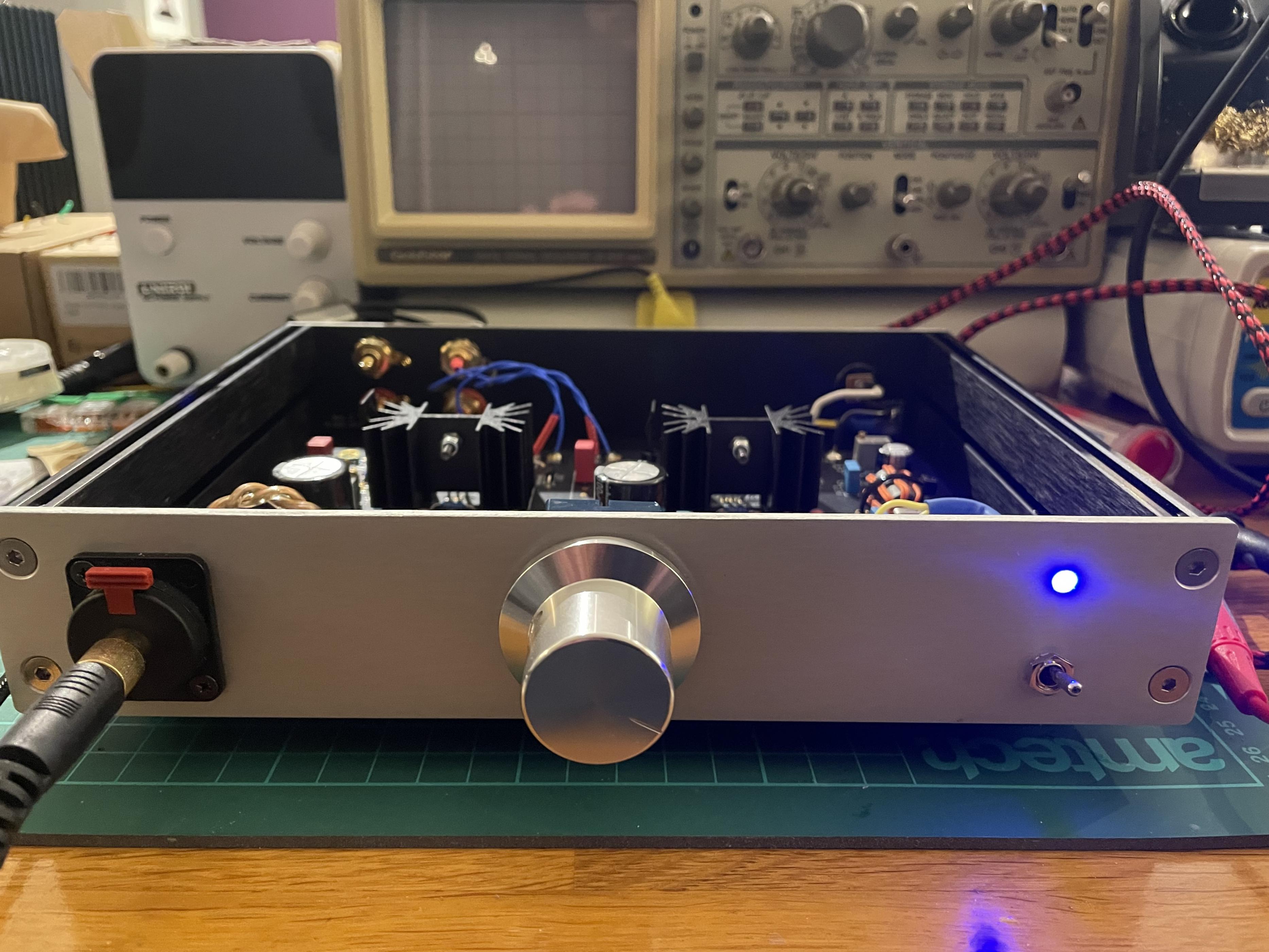

Hi Mark -
I forgot to post some pictures from another Noir! I'm really happy about the results as use it with a linear PSU 24V. Dead quiet and super - it's in my office to drive some headphones ;-)
All the best, Fred
