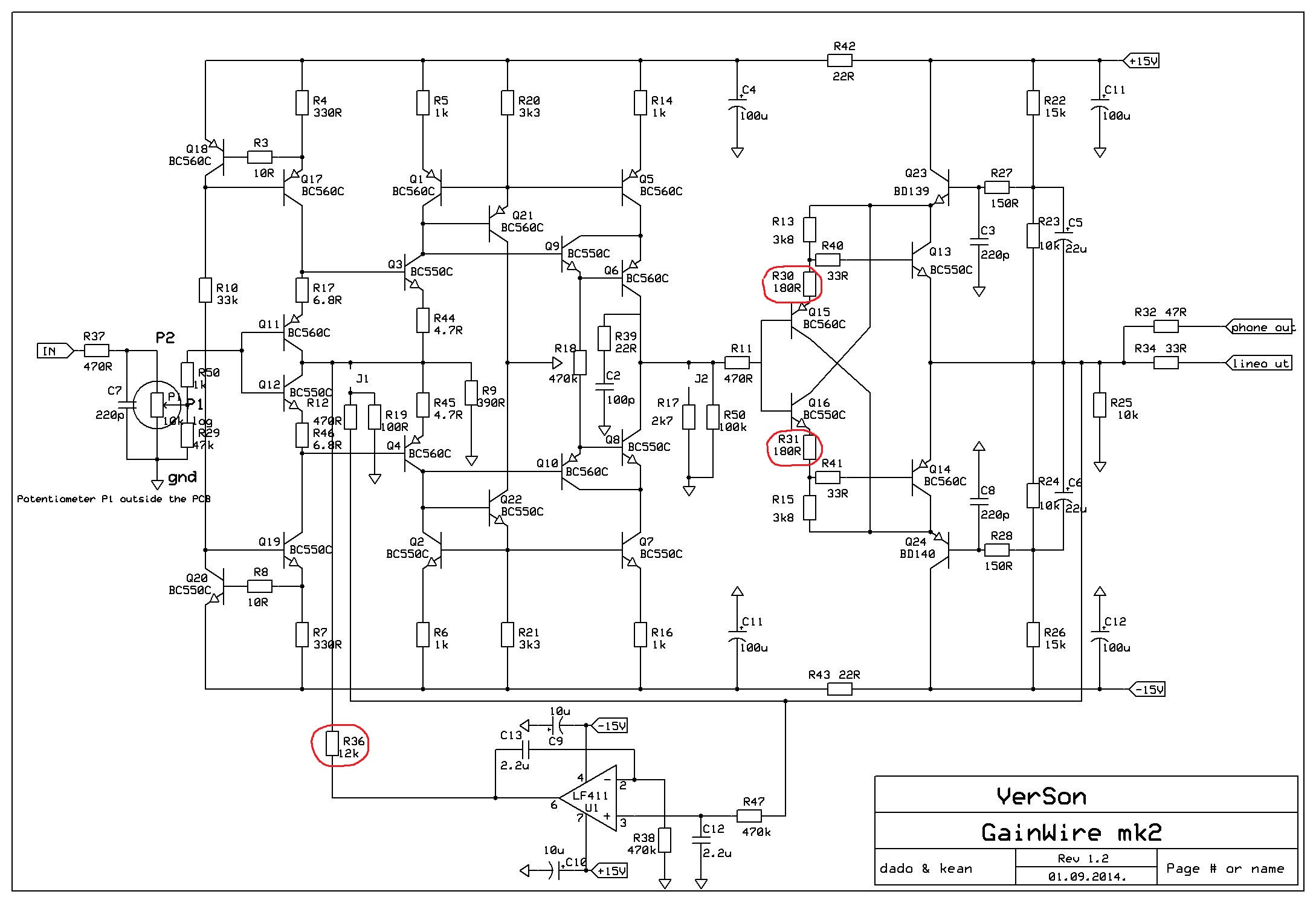

During my listening sessions and extensive testing I decided to change few resistors.
R30 and R31 from 270R to 180R, no need for 40 mA output bias, new is set to 30 mA and less heat of Q23 and Q24.
R36 from 22k to 12k, simpler work for the DC servo's OPA.
Here are two schematic, first one with gain set to 7 and second one with gain set to 3.5.
Damir

I `ve constructed similar Input stage for my power amp but with jfets input and you`re right about CFA mode I got the same listening expirience, and I think you should try to try bigger value C2 when in cfb mode.
Anyway, line stage in my opinion don`t need GNFB at all particularly with this design, you have very low distortion without GNFB...
Yes you are correct, C2 is 220 pF for the version with the gain of 3.5, I forgot to change it on the schematic.
