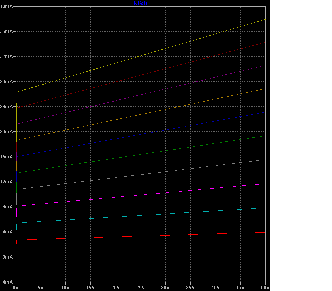

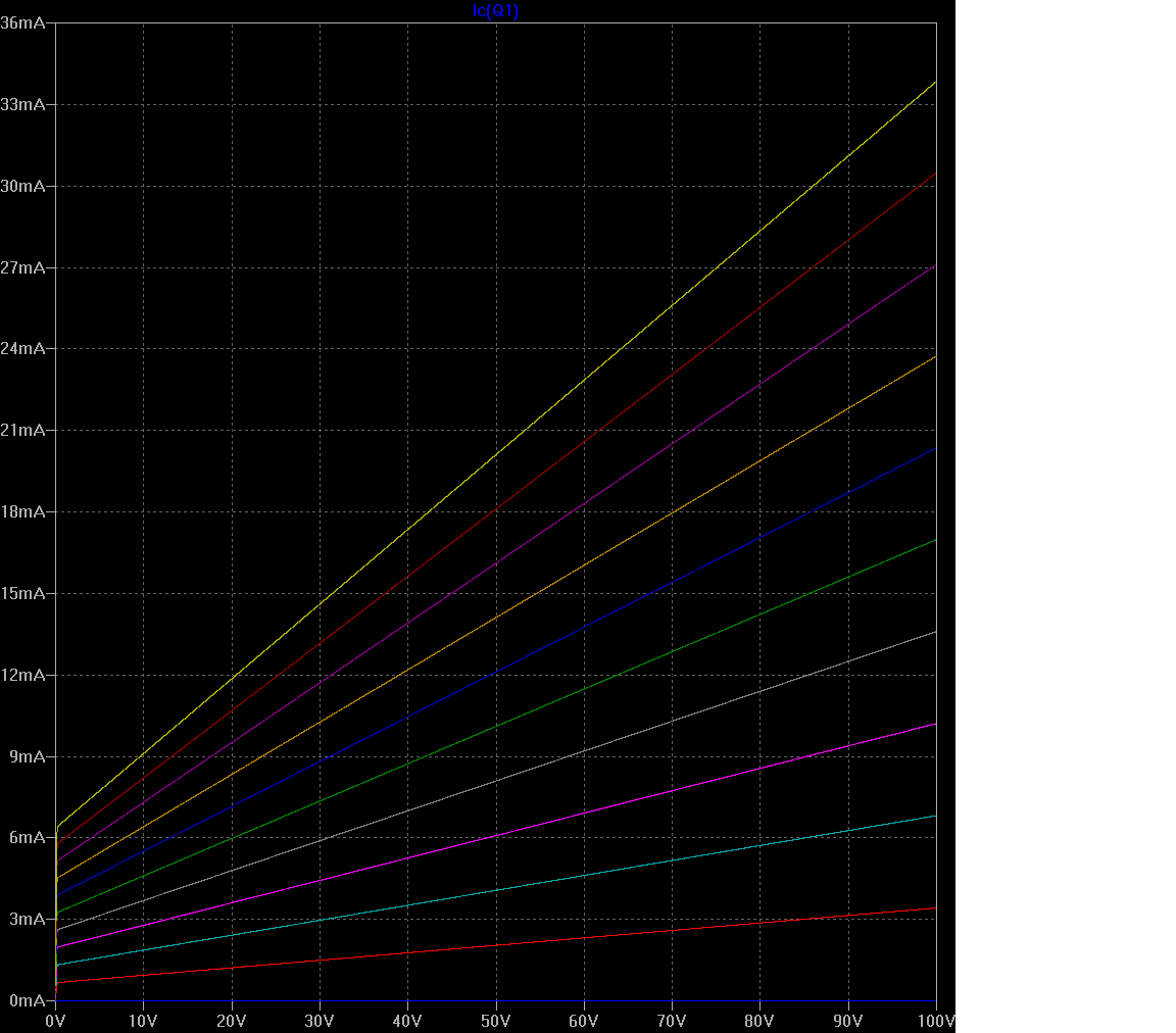

for my personal experience Cordell models normally give less distortion than others models, and in some cases the early voltage is to high like in the mje15032, in the first picture is the curve trace of the onsemi model of the mje15032, and in second the cordell model. As one can see there are huge differences, and using the cordell model give much less distortion.
Vaf in cordell model is 2000+ and in onsemi model is only 31,5.

Sergio, the mj15032 will have a very high VAF. Its rated at 250 v and 8 amps.
Someone at onsemi must be confused, VAF of 31.5. 🙁
In this case Cordell is correct.
