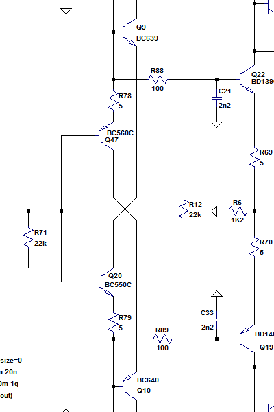

Ok, have to take a better look, but at first look it seems that adding such a high capacitor value will decrease the feedback loop of the ccs, and will decrease the output impedance of the ccs, but in this position the ccs output impedance is not very important anyway. and those caps will for sure make the ccs more stable 🙂
the depletion mosfets from infineon have a very low Vth variation, You should check those.
those caps bootstrap the CCS to the rail, but as the phase is opposite the result is flat.
this is a gerhard invention, and practise has shown better CCS performance.
But better would be a depletion supertex cascoded CCS.
I was talking about C21, C33 in .asc file presented here http://www.diyaudio.com/forums/solid-state/235695-no-nfb-line-amp-gainwire-mk2-46.html#post3922218
If you use a depletion mode mosfet for the CCS in simetrical configuration like this, problem could be a need for individual CCS current adjustment.

The capacitors simply forms the input filtering, the benefit of placing them there is that they then are independent of the series resistance of the input, then you can place a volume control in front without having to add an extra buffer. It is a simple RC filter, so if you use larger resistors then you can use smaller caps.

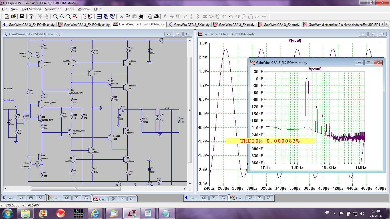

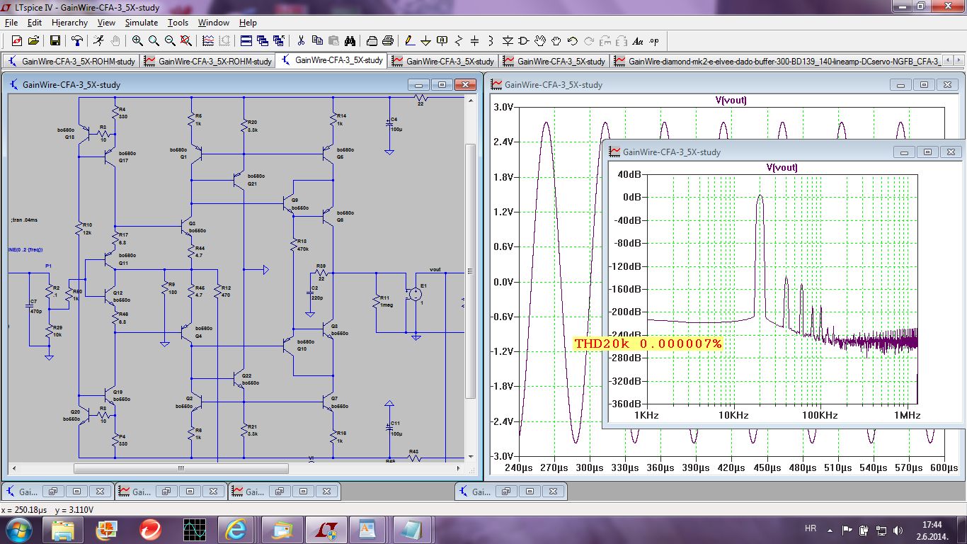

I have idea to make SMD type PCB for GainWire mk2. I choose bjts from ROHM as they have a transistors pairs in one case in different combination. I tried to simulate first by changing transistor pairs in the V/A converter part(Q11, Q12, Q3, Q4) from BC550C/BC560C to EMZ2 from ROHM. Simulation showed tenfold increase in THD, from 0.000007% to 0.000083% for the same signal level. I would like if someone can explain what model parameter/parameters are reason for that. I tried to figure it out by myself and appreciate a help here.
Simulated IPS only with ideal OPS in CFA configuration.
Attached Cordell and Rohm models(from ROHM site).
Damir
