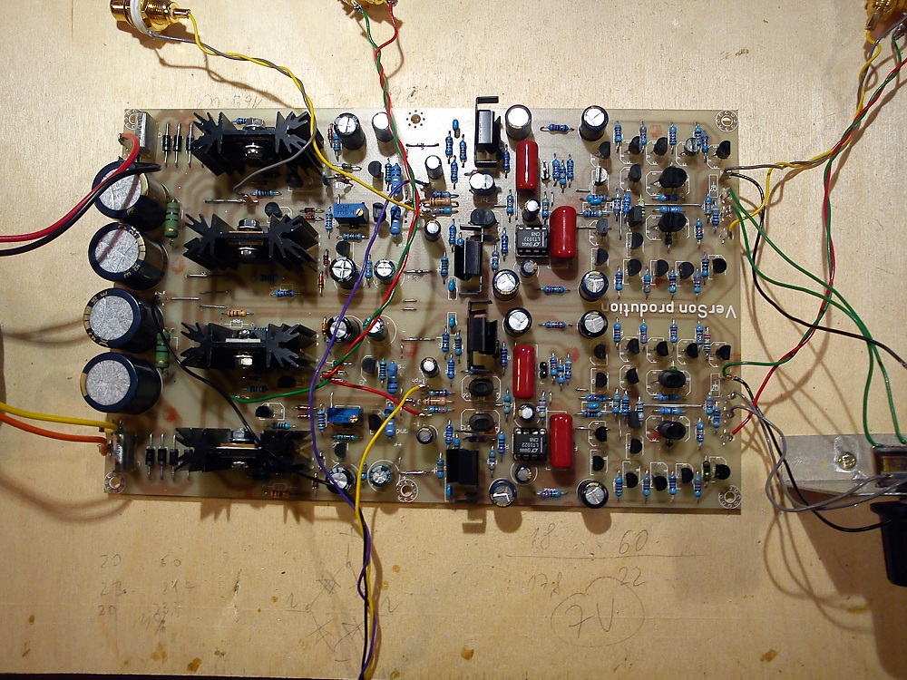

Hi Dado,
Populating the PCB is near completion. Critical matched transistors must be selected now... 😀
R37 is not in the BOM. Do you confirm 470R ?
About heatsinks: are BD139 and BD140 very hot when running ?
Nicola
Nicola, R37 is 470R.
BD139/140 could get a bit hot, I used small heath sinks, look the photo, or use small U shaped alu heath sink bolted directly on the transistors.
Damir

Hi Dadod,
Finally the preamp card is ready 😎
Now I'm using the headphones only and the music is playing on both channels 🙂

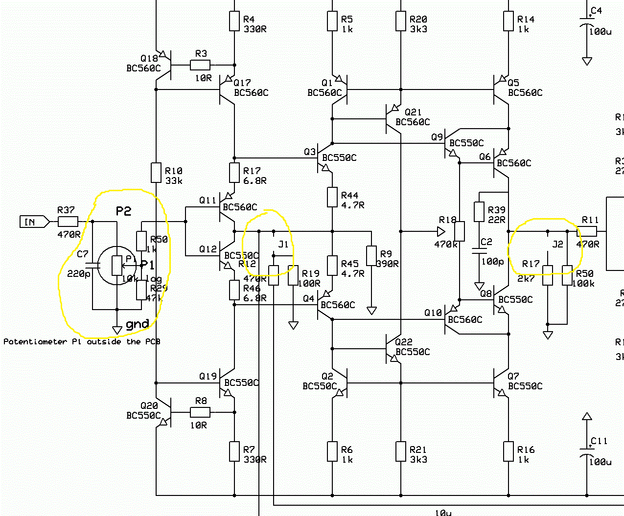

However it is too loud and I cannot set lower volume. I can change it but in very small margin. I have disconnected Gnd (pin 3) of potentiometer (both channels) because the preamp doesn't like it. I don't know why 😕. The pot is TKD 2CP-2500 50K. Pin 1 (1) is connected to P1, Pin 2 (2) to P2 and Pin 3 (C) to gnd.

Hi Nicola,
I think that I showed ones the schematic with wrong potentiometer connection. P1, P2 and gnd are PCB silkscreen markings.
Here is how it should be connected, sorry for confusion.
Damir

Never mind: now the music is playing at usual volume and I can set it normally 😉
First tests are done with the headphones (Sony MDR CD1700) in CFA mode, Teac VRDS-25 CD player and external DAC.
After three hours, I can say about this preamp: great clarity and transparency, very detailed but not overanalytical, deep bass and good depth. No harshness at all: if any, this preamp doesn't cause it.
I find some light hum, but the R-core transformer is very close (1-2cm) to the preamp and the cables are not firmly connected. When I move the transformer away, the hum goes down.
Next step: listening through loudspeakers to confirm this wonderful experience. 🙂

Nicola, very nice you succeeded. I did not have any hum in mine prototype, so it should be possible to get that with careful positioning. I used ordinary non shielded wires, but I used it in a wooden box, if you put it in the metal box and connect the preamp ground to the box, be careful, use a ground loop breaker look here Earthing (Grounding) Your Hi-Fi - Tricks and Techniques figure 4.
What mode you prefer non GNFB, or CFA?
Damir

I suppose that replacing the current pot with resistance attenuator will give a higher transparency. However the TKD pot does the job nicely
Do you think that going from 50K to 10K potentiometer is a good move ?

I am not sure about different between 50k and 10k potentiometer as I tried 10k only, probably less hum with 10k.
