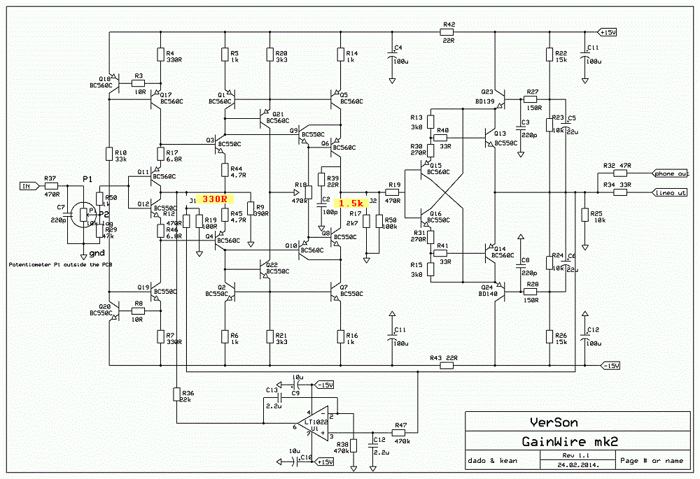

For some people the gain of the GainWire mk2 set to 6.5 times could be to much in today time of digital sources. To lower the gain to more appropriate level of 3.5 time just two resistor in each channel need to be changed.
R17 from 2.7k to 1.5k
R19 from 100R to 330R

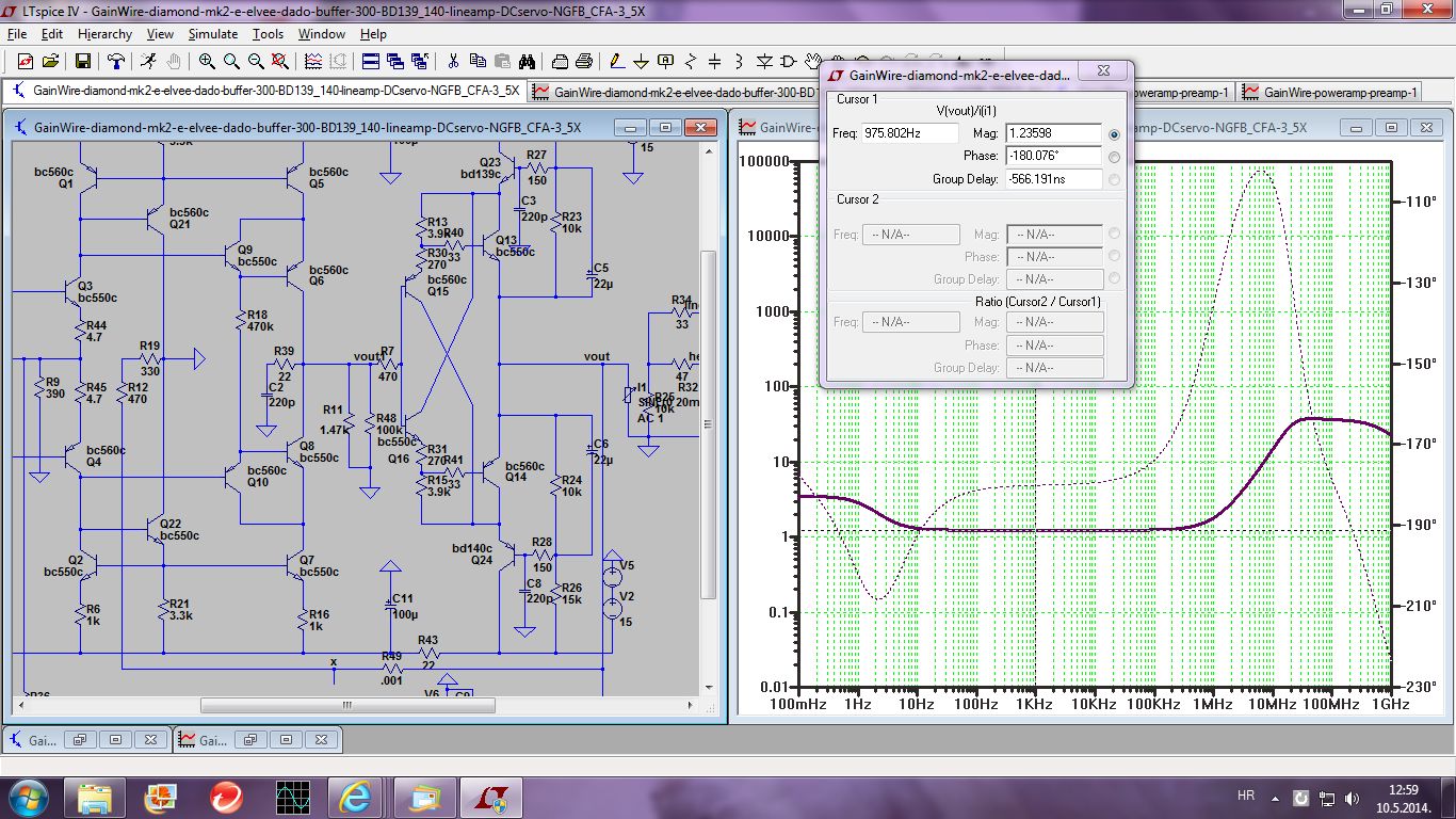

What is the output impedant of this preamp?
This is output impedance in CFA mode without output resistors. I added 33R for the lineout and 47R for the headphoneout, so those are actual output impedances as that of the preamo is quite low.
Damir

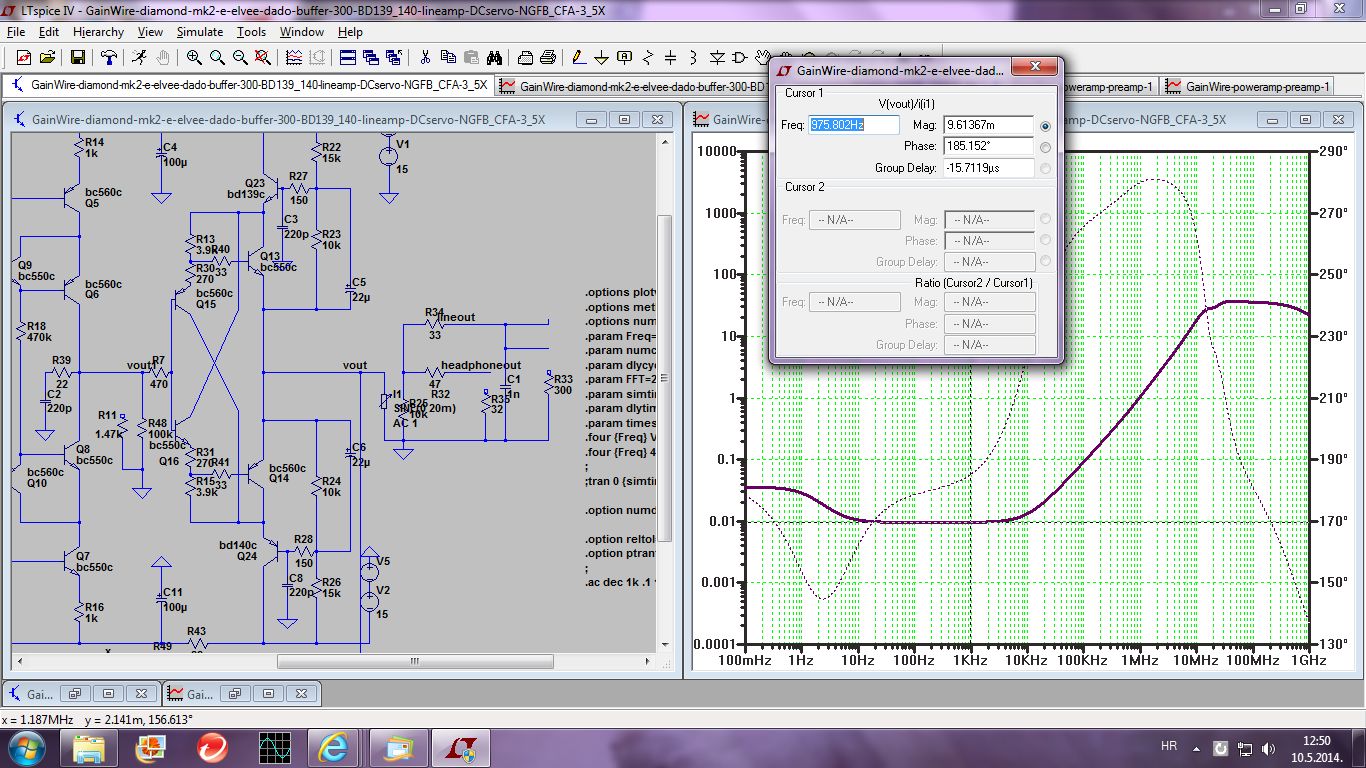

Why does the output impedance increase from <30milli-ohms to >1ohm, when the NFB loop is closed?
It is other way around, CFA - current feedback amp, NGFB - no global feedback.

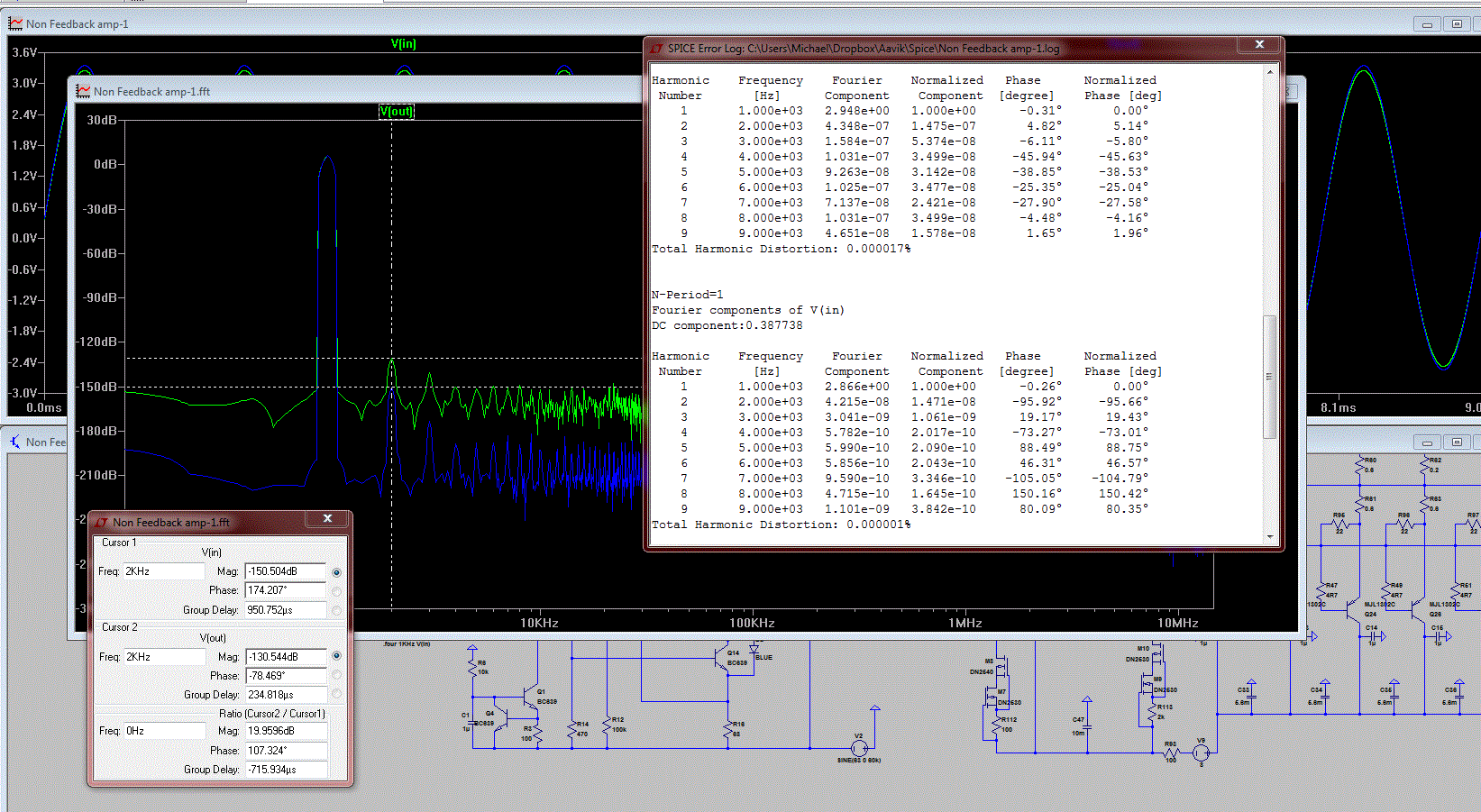

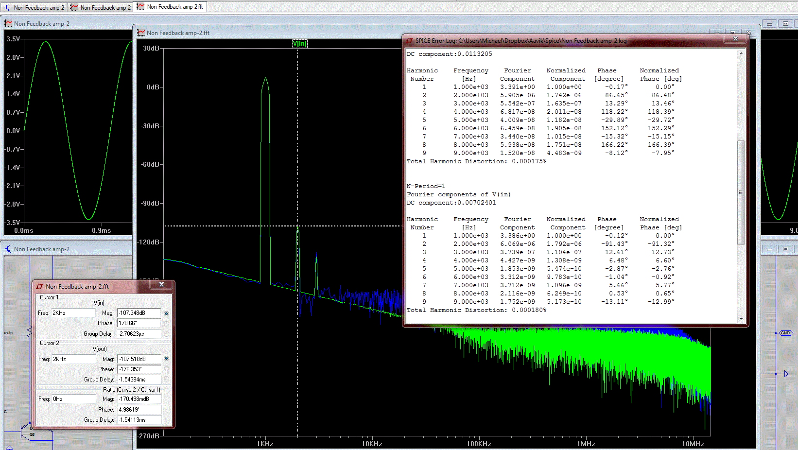

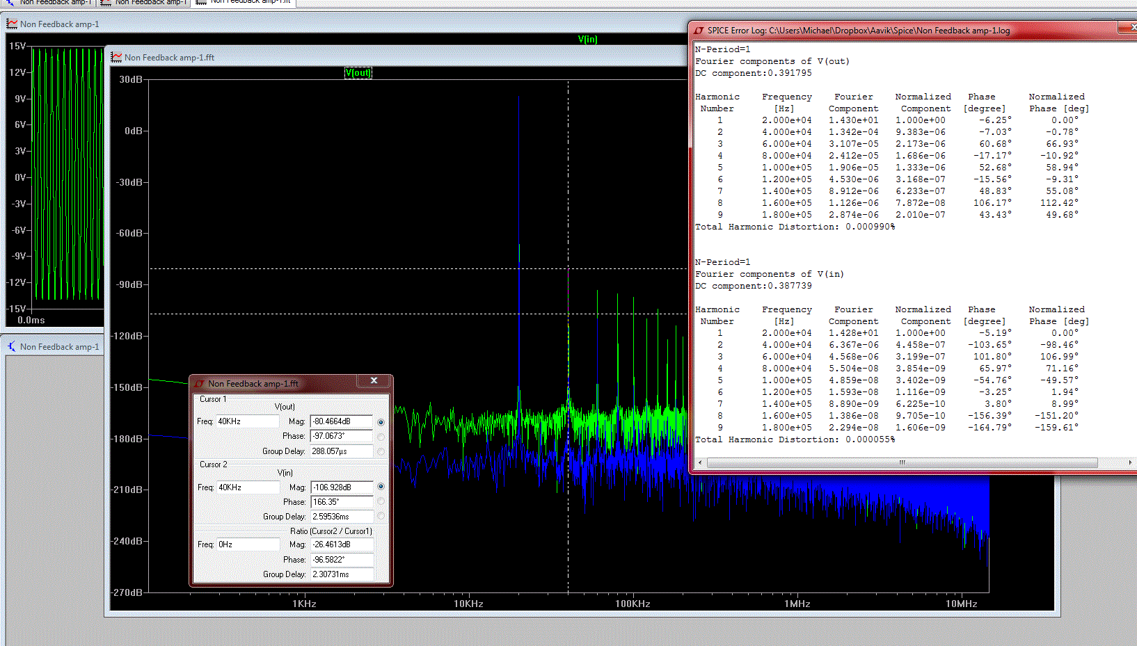

I have my OPS optimised for higher input impedance,(have fitted a Jfet input pair) Now it works perfectly with Damirs current conveyor IV-IPS
I have altered Damirs input stage a bit, as to be able to put input filtering after the level shifters.
Anyway it will be interesting to evaluate the two
circuits, and also the folded cascode developed to be a full scale global NFB amplifier
I will build and listen to all three versions over the next few months.

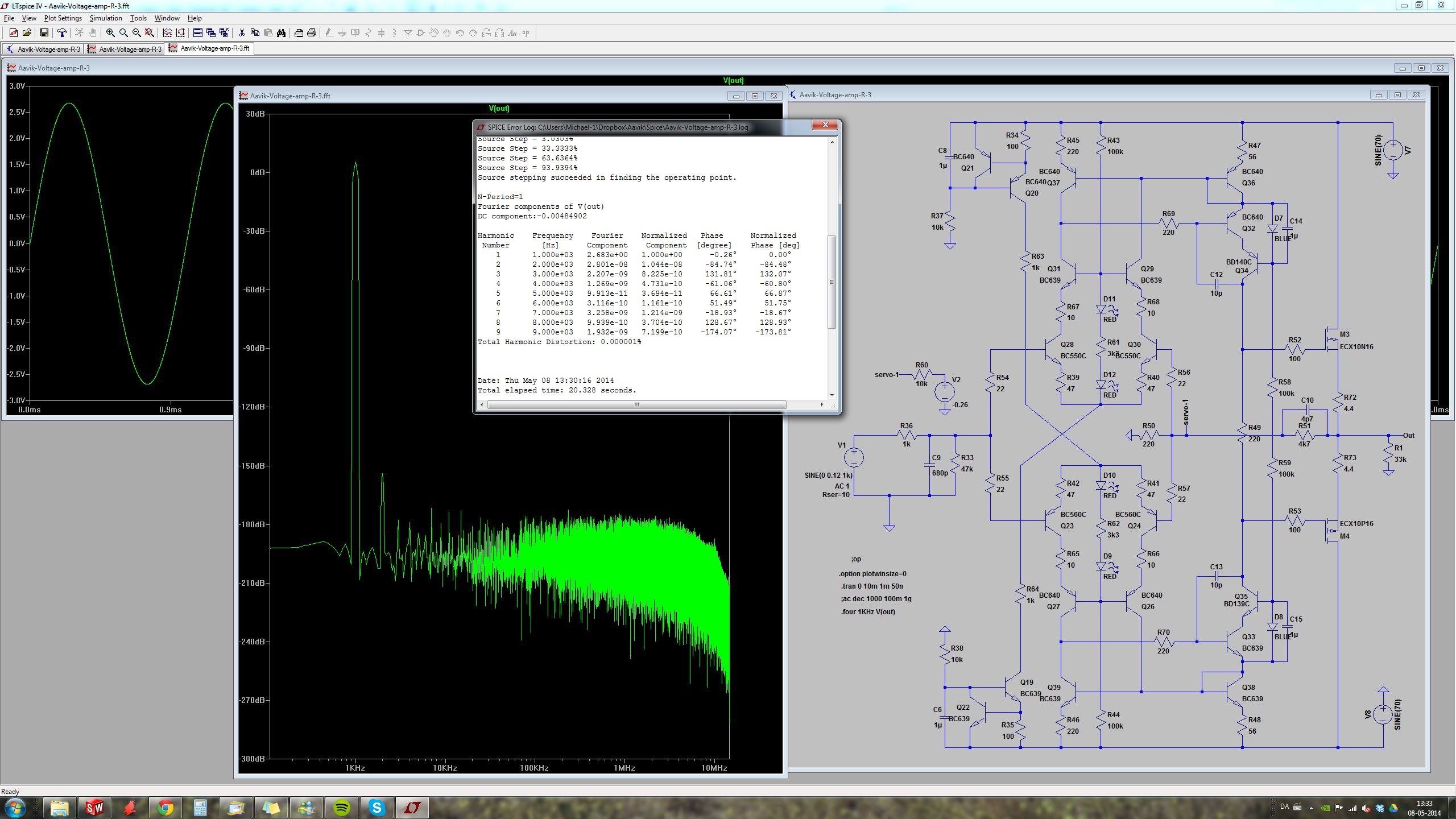

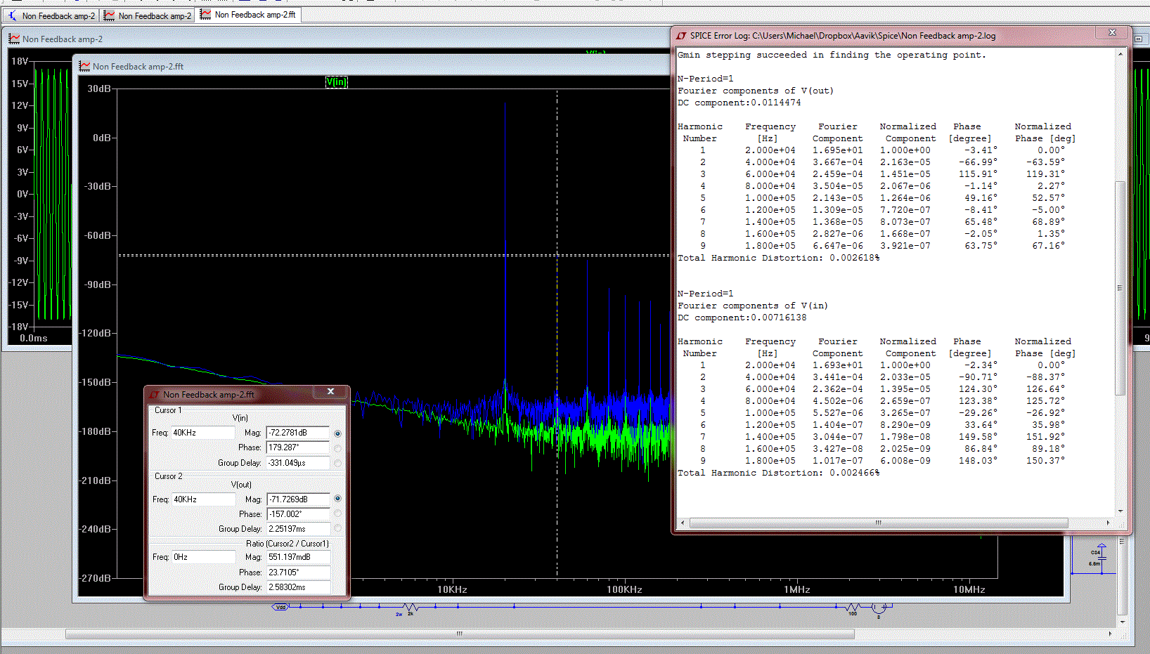

The screen shots show the two amplifiers (Damir's and the folded cascode) at 1W 1KHz and 15-16V 20 KHz, in one case the limiting factor is the Voltage amp, i the other it's the other way around, But I really like the structure and NON feedback nature of Damirs current conveyor IV-IPS.. and the performance is more than good...
Don't really know what to expect sound wise, It'll be very very interesting.

NGFB = negative feedback
No GFB = no global feedback.
Look at the Thread title for the clue.
But I now see that connecting the feedback lowers the output impedance as is normal.
Sorry my bad, I was thinking that is enough to write No Global FeedBack as we don't need positive feedback in audio amps (I know is not always so).

Hi MiiB, very interesting twist in your IPS, just two things. Did you simulate with square wave and noise? Did caps from the bases of Q19 and Q22 to the ground slow the IPS, and the low values CM resistors and high values of the I/V resistors could be a reason for high noise?
cheers
Damir
