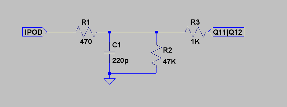

Regards the buzz problem, the buzz increase when I touched the input and goes away when I shorted the input. Is this normal?

If the buzz goes out when the input shorted that shows buzz is coming outside the preamp, probably electromagnetic interference(transformer?).
Could you be more specific, I really don't see what you trying to say, show on the schematic. I mean the connection of the source.
Sorry for not being clear about it. Here is the input diagram:

I have to say sorry. I mean what's going on when you said "I short P1-P2, make P1-G nothing. Signal come from IN"? When there is no buzz?
I mean I setuped like this schematic when I did my test. When no source connected, the are some buzz (small level) on the headphone. BUT when connect the source or short input to ground, the buzz sound gone away, totally silent. Do you think do casing then connect ground point to chassis will solve this problem?
When you put your input attenuator to the lowest level does the buzz disappear?

When the preamp input is not connected anywhere the input impedance is of 47k and if you have a transformer or some stray magnetic field in proximity than is possible to have a buzz.

I think I got my problem. I didn't have an input attenuator so input impedance will be 47k when source not connect. If I add an input attenuator, it will much lower ( < 10K // 47K) and the problem will gone (or lower). I think I will go ahead and just finish the pre-amp.
