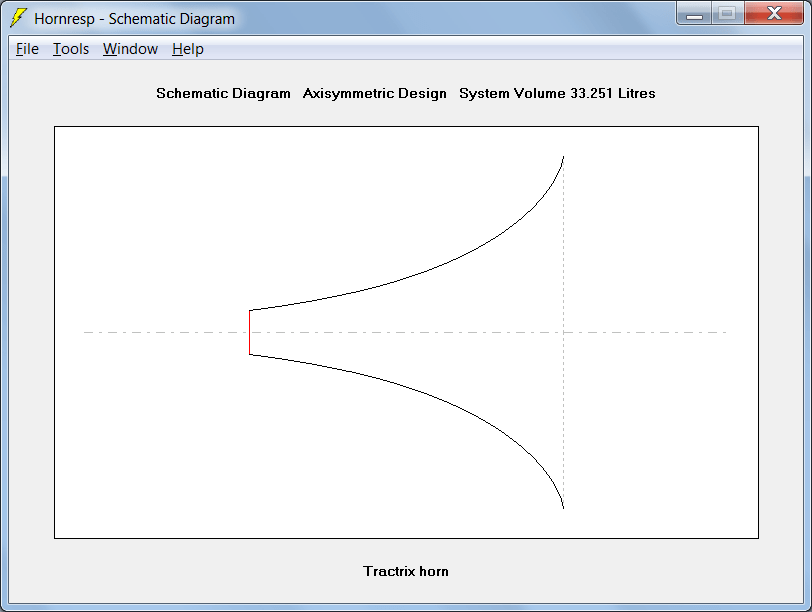

Is it so difficult to model a Tractrix-curve? Only 2D not 3D
I did many years ago calculate a tractrix-curve in excel and then export the x- y-data to auto-CAD and then i could print the curve out on a large plotter. It vase as a tool to make a big lathe. Never finished it though! But I did make some templates.
I think there is a tractrix calculater here: https://volvotreter.de/dl-section/tools/

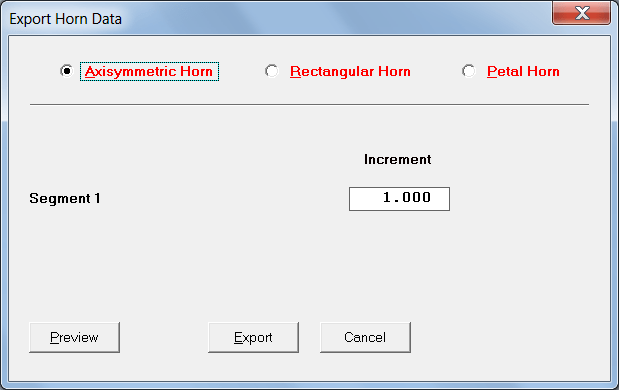

These days it can now also be done using Hornresp...

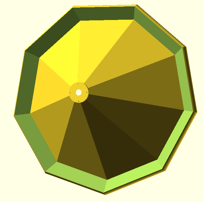

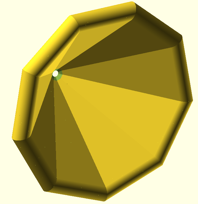

It is not difficult to model it, but to fit it to the nine sided horn. It took me yesterday an hour to figure it out with a half circle. Hornresp would be definitely the tool to generate the tractrix curve, I have used it for exponential multicell calculations.

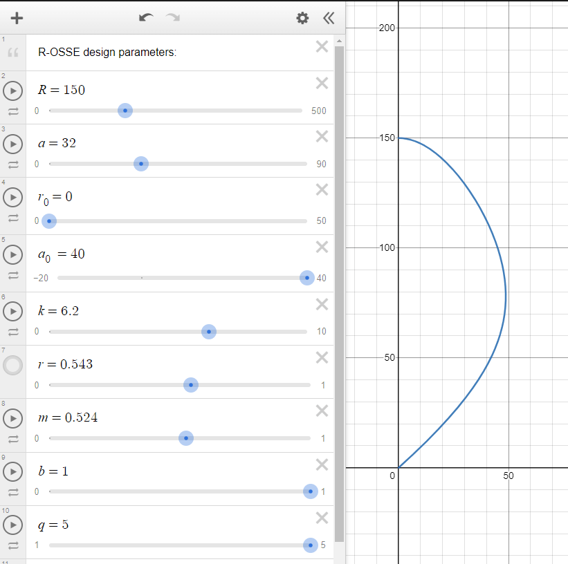

However I am not sure I want tractrix - it is one of the candidates, but I strongly consider using @mabat 's equations to generate the roundover - if I can force then to make just the roundover with exit angle of the horn.
Another curve could be a logarithmic spiral. I need to compare them which would look the best and would fit the CNV since I think any roundover will do better than a basic half circle.
This is how it woud look like with a half circle roundover. Not bad, but a "flatter" curve would allow the roundover to be larger. The machined part would be wider with the same maximal thickness.
This is just a quick example of a flatter curve allowing 150 mm width vs 100 mm width of the half circle:
I need to play a bit more with the sliders to get some meanigful shape - generating the curve for the given size constraints is so easy with this.

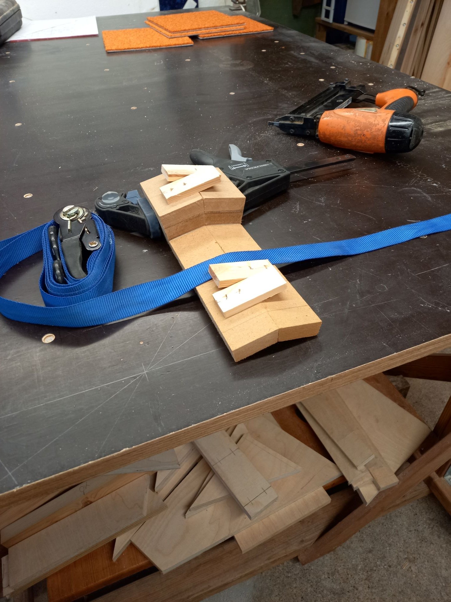

Hi again.

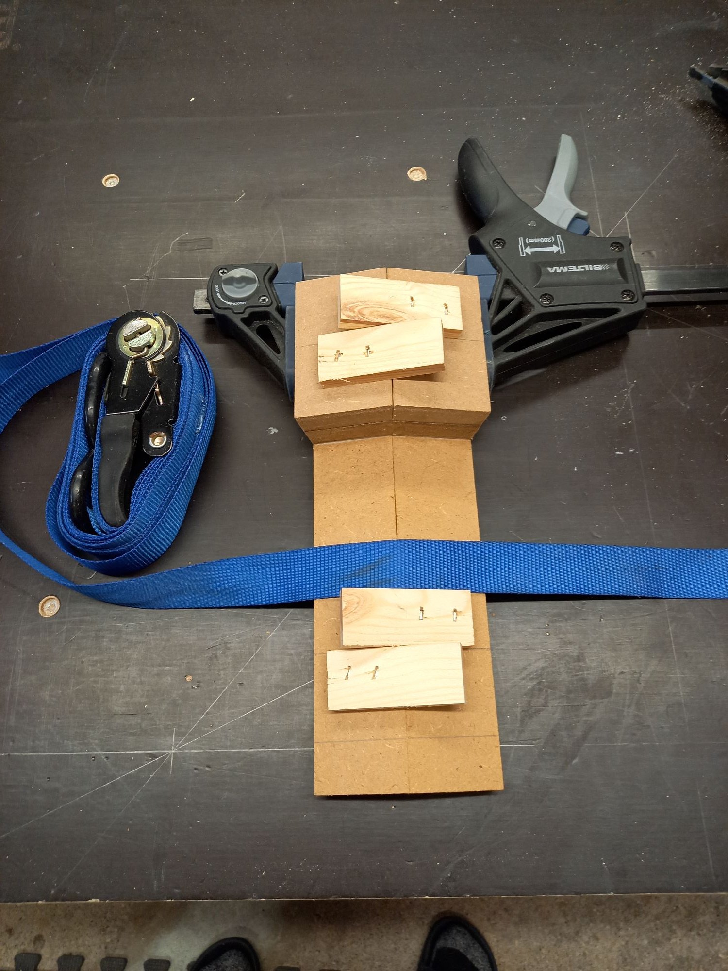

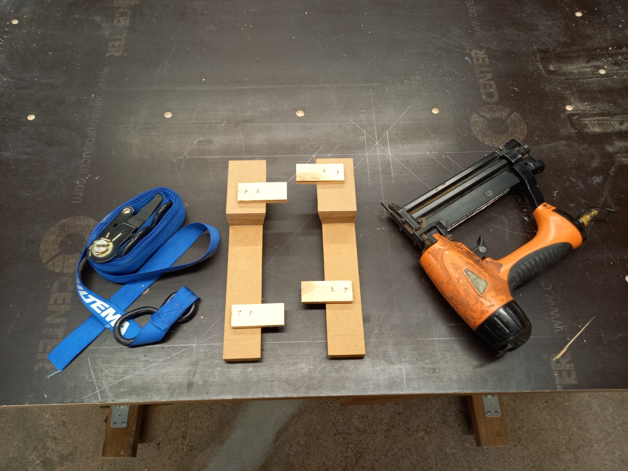

I have been down in the basement to make a little mock-up, like a joint between two petals, to show my idea to glue together the nine petals and align them at the same time. I would call it the "finger-method".
The wooden "fingers" are temporarily nailed to the backside of the petals (MDF) so that they "interlock", aligning the petals. You have to be a bit precise with positioning the fingers, meaning with the same fixed distance from the throat on all petals. Depending on the size/length of your petals you can make three or four sets of fingers or even more. After gluing the fingers will be removed again.
The qiuck-gripp-spanner is just used to hold those two pieces together while making the photo.
I have shown a blue nylon-strap on the pictures to indicate a way to strap the nine petals together when gluing the whole lot together, using the fingers to hold the strap in place.
I hope the pictures are somehow self-explainatory.
I think with this "finger-method" you dont need to drill dowels!
Steffen
Steffen

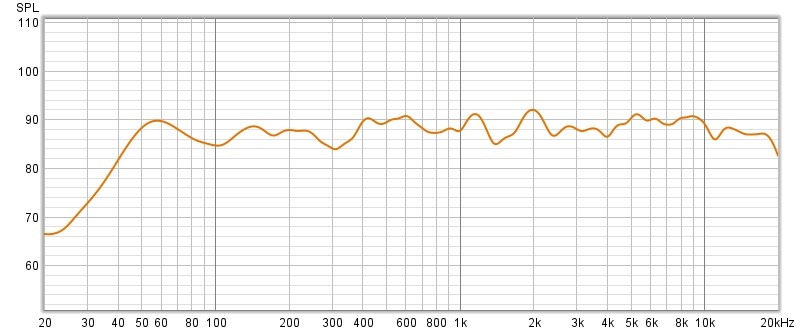

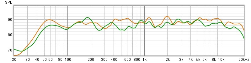

Here are some measurement from today, in room, no gating, just Psy smoothing. I used Open Sound Meter for real time response tuning with the DSP. I am pretty sure I do not have it optimal yet, but it is better than before. I also quickly tuned the green horn to match in SPL and delay and I am now enjoying the results. Loud and clear🙂
This is on axis:
This is off axis, ca 35 degrees, the microphone could still "see" the throat:
And the comparison shows the slightly problematic areas:
All in all, I am happy with it. And there is a potential to do it still better.

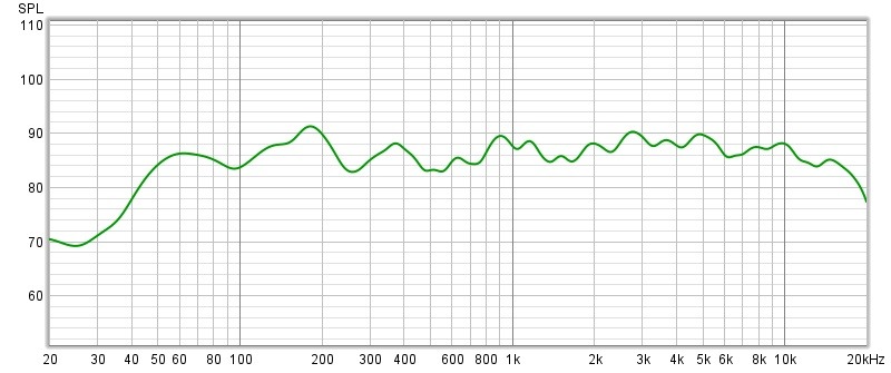

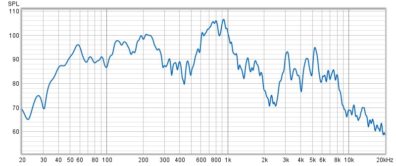

The most problematic part is the LF - here is the raw response:
That 800 Hz peak is unwanted, since the crossover frequency is now around 270 Hz between MF and LF. It toolk some effort to EQ it out.

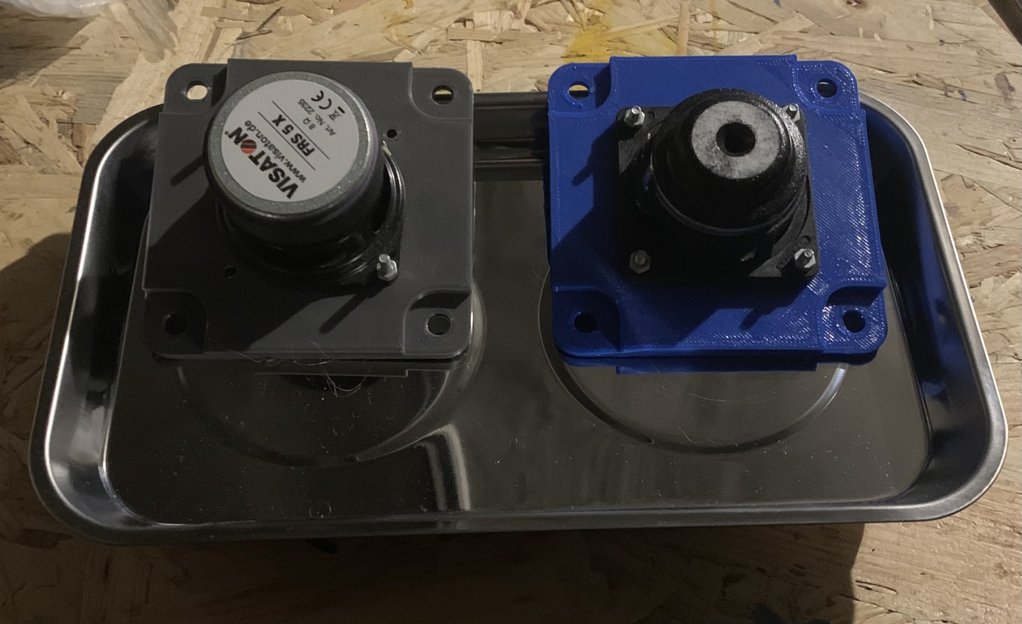

I have two small fullrangers with 1.4" throat adapter (not an ideal one, but it OK for the test). It is the Visaton FRS-5X and Sica 2H0,8SL https://sica.it/wp-content/uploads/2021/02/Z000795.pdf. I also have a custom faceplate for the R2604 ring radiator. All these will be tested on this horn to find out if they work better than the compression driver.

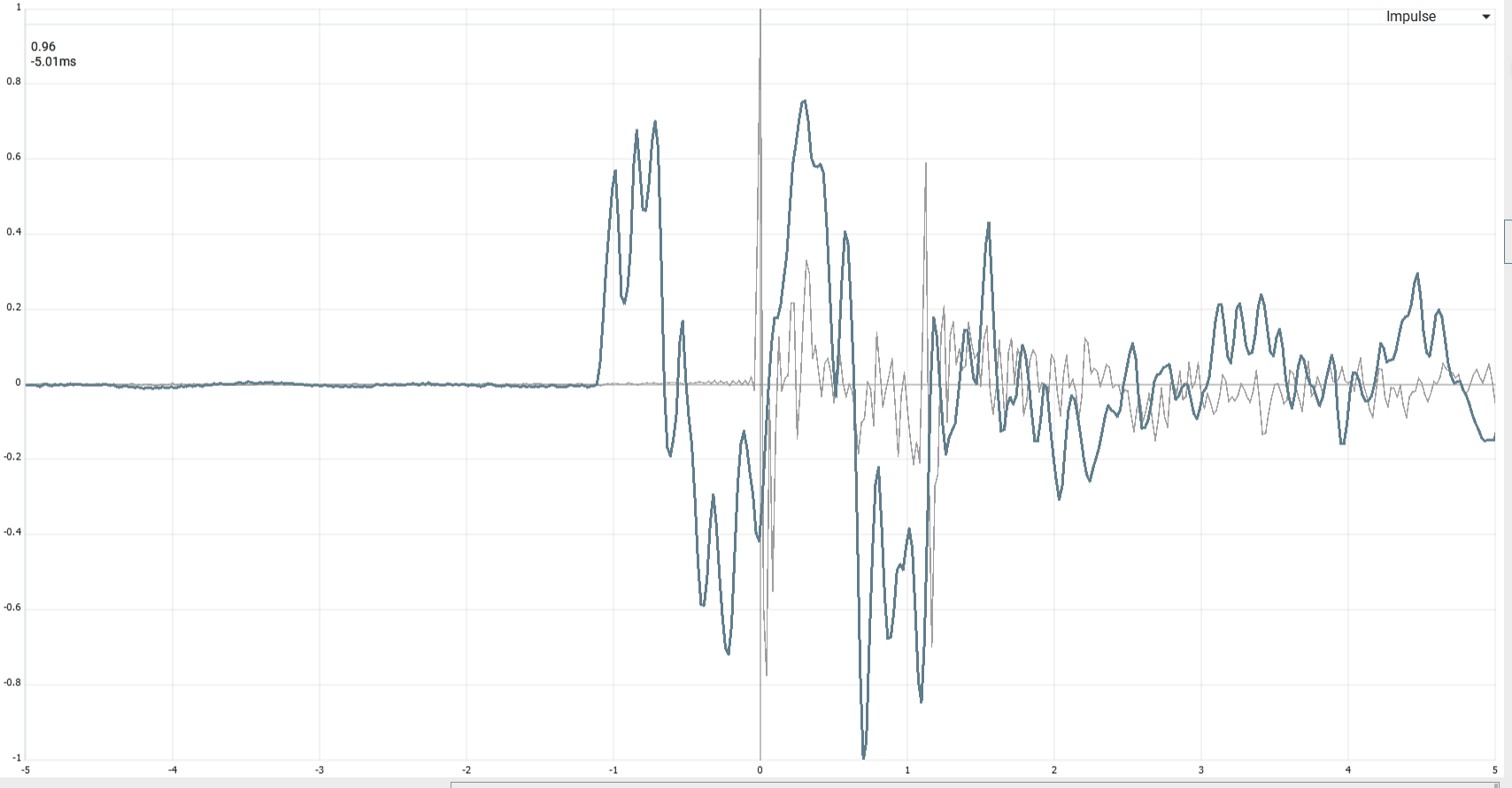

I have noticed some strange shape of the LF impulse response:
The thick line is the LF, the thin line whole speaker. I wonder if that is due to back wave reflection, some LF speakers not wired in phase (will need to doublecheck that) or anything else. Strangely enough, the resulting impulse of the whole speaker with crossover and DSP looks really reasonable - but definitely, the phase is weird (not shown). The double peak confused the Open Sound Meter delay estimation.
I will have to investigate this further.
Edit: LF polarities checked and OK with a 1.5 V AA battery.
Pelanj, as far as I am aware, most programs need a high frequency cue ( above 5 khz ) for estimating the IR start time, so measuring the LF or MR by themselves would show a strange looking impulse, whereby measuring all sections at once will not.
There is quite a lot of HF energy evenin the LF - see post #93. The IR shape is really strange, I need to find out why.

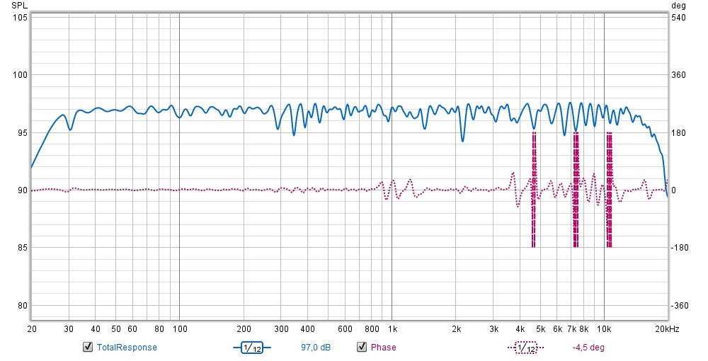

I did experiment a bit with the quick and dirty (and bad, room influenced) measurements just to see what is possible following roughly the tutorial using only REW track arithmetic and generated filters.
There are issues due to the measurements being incorrect, but this will really work!

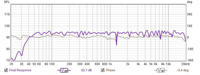

The same measurements, but this time using the TF function from VituixCAD generating 8th order linear phase LR crossovers. I am pretty sure that with proper measurement, this will be really good.
The leftover dips and phase rotations come most probably from reflections in the measurement, there might be also some misalignment in delays. The HF roll off was added intentionally.
