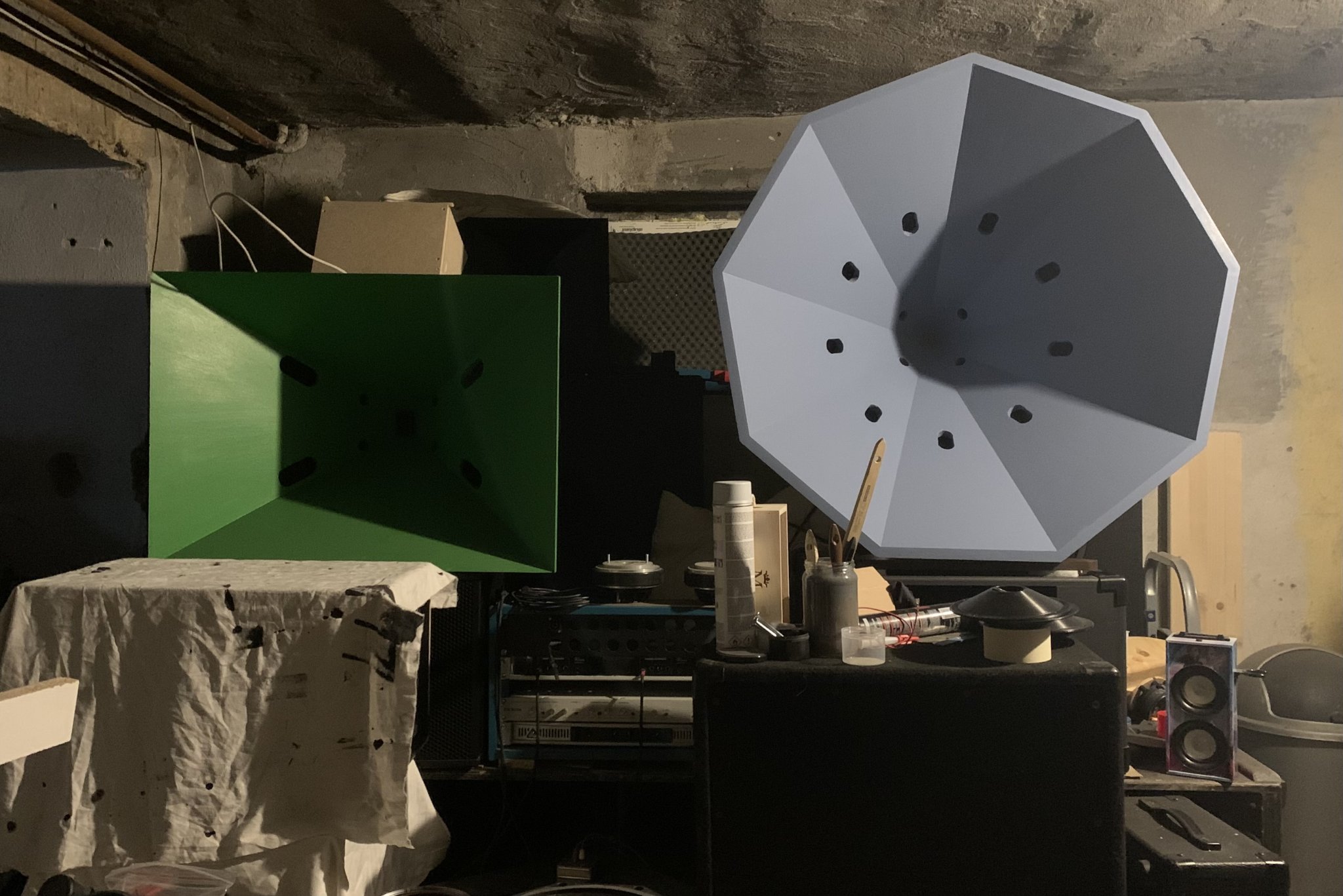

I prefere that immensely compared to the square MEH. I even think they got charm. Grey suits it.
The color is called "pigeon blue" and is a very light blue, in reality it is nicer than plain gray. It looks like grey in the picture though. The reason to go with 9 sided horn was that it allowed me to fit a lager horn on my CNC than if being square. For the yellow horn I had to make the top and bottom panels in two operations shifting the board between them. This is even larger diameter and the petals fit the bed easily - actually, an even larger horn could be made this way, but it would not fit the room anymore🙂

When looking at the picture in post #68, it should be possible to make that slight round-over on the petals at the horn-mouth on your CNC!?
You probably need a longer and stable router-bit to make the edges on the petals, when the material-thickness grows. Hmm. CNC rocks! 😀

@hornsteff The CNC could definitely do that, the challenge is to create the model of the petal in OpenSCAD. The same issue is valid for curved petals, I can do roughly up to 50 mm thick petals in one layer and multilayer is practically unlimited.

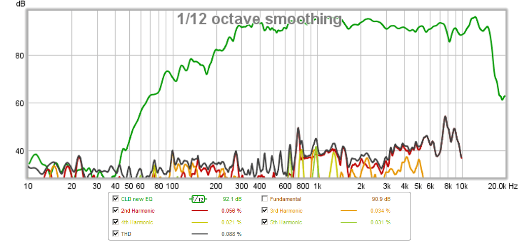

In the PRV 5MR450NDY thread I got 10dB boost on 95dB midrange. It was very loud but so clear you didn’t know it was loud. I rang my ears a few times when doing sweeps because I forgot to wear earplugs.
