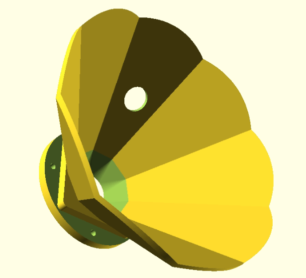

Yesterday I was thinking about how to fit larger horn parts to my CNC and then I realized that if I use more sides than just 4, I can get a larger horn with the same axial length parts. I originally thought about 6 sides, but 9 seems to look really cool. It is now just a design study - 1" or 1.4" driver, 3 x 3 - 4" mids and 3 x 8 - 12" for lows. All will stay open backed (due to weight and ease of buiding) and maybe there will be even an ambience tweeter in the back. The diameter will be around 100 cm, depth around 60 cm with a coverage angle of 75 degrees (or somewhere between 60 - 90 degrees), I could not fit a larger one in any of my rooms anyway. Even this one will be hard to move through the doors.
I would like to do it "right", following all the MEH rules and do lots of simulations. At my normal indoor listening levels, these will be able to play down to 30 Hz (with EQ) even with open backs, there is plenty of subwoofers around the house that could be used if needed:) I see these in stained birch plywood (12 - 15 mm), prototype will be built from 16 mm chipboard.
Should I really need a box, I could build one with 8 sides and fit a rectangular box around it with 4 (triangular) ports in the corners.
This design is constantly evolving. If anyone is interested in the 3D models and OpenSCAD scripts, send me a PM.

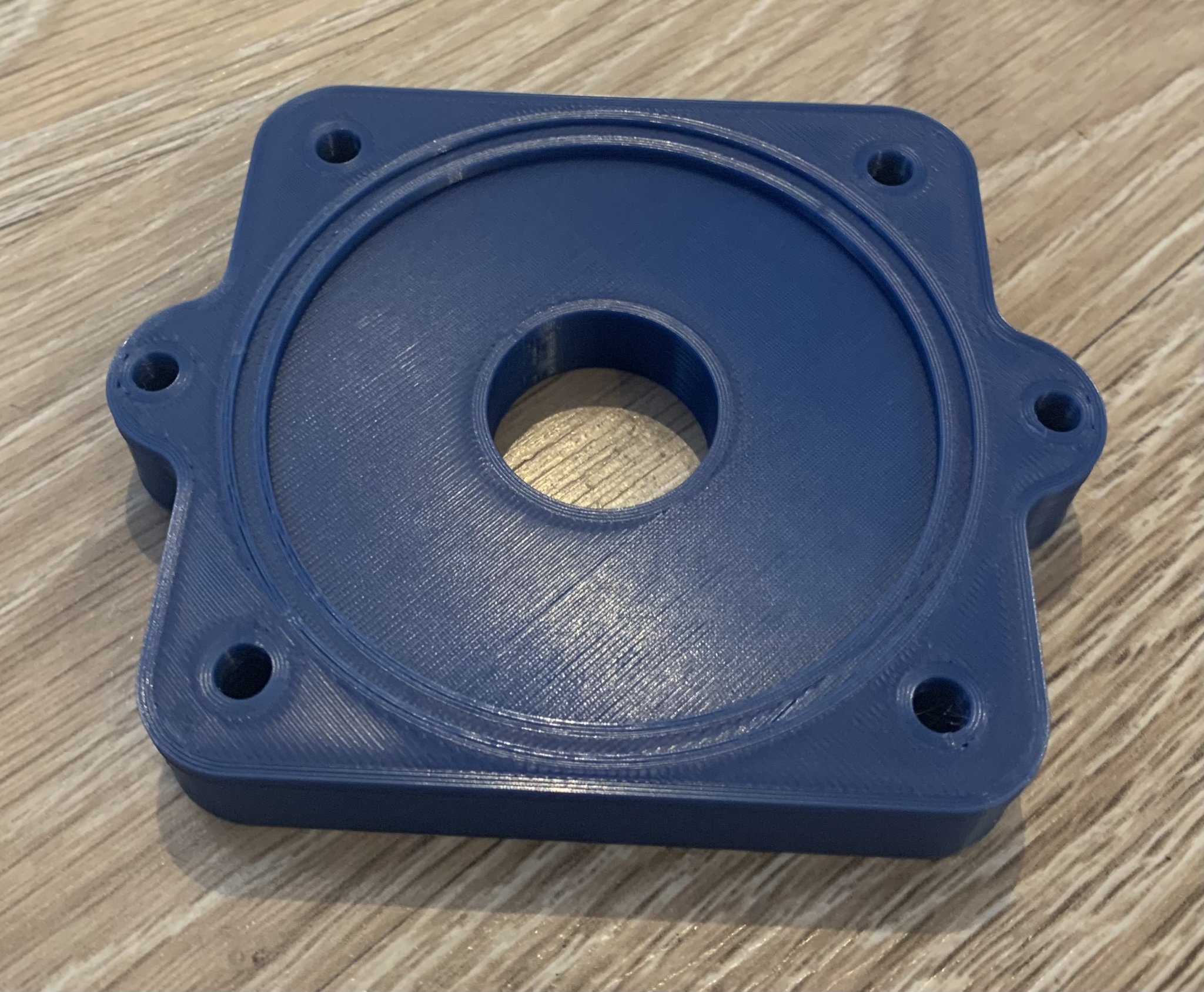

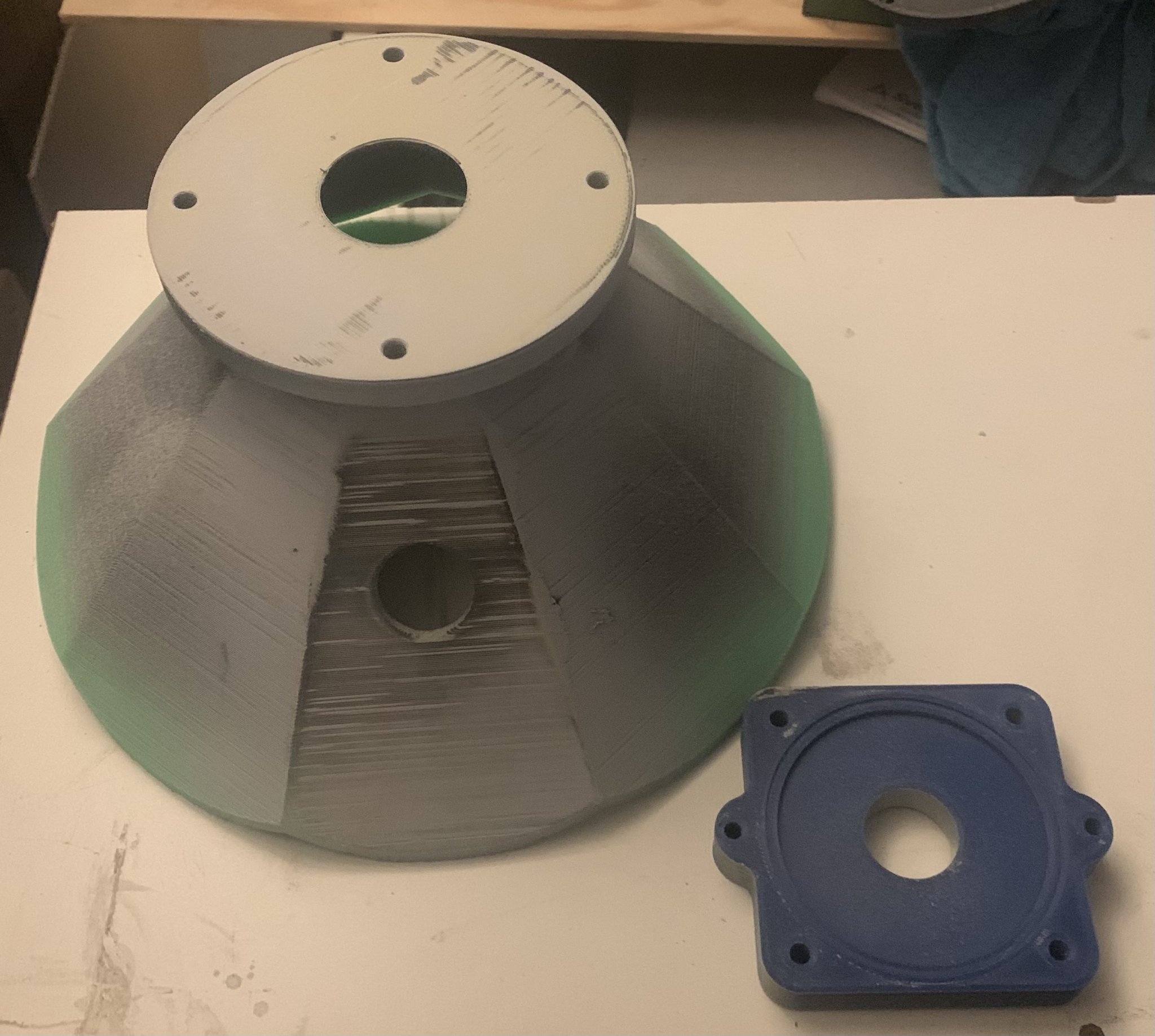

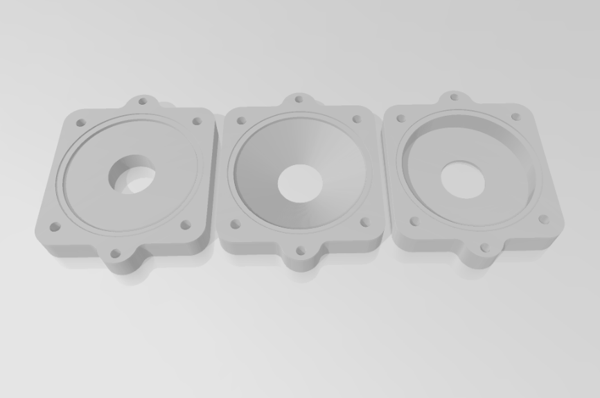

Here are the adapters to be printed to simulate the wall thickness. One with a plain hole, one frustumized and one with larger volume but a very short port (6 mm in total)

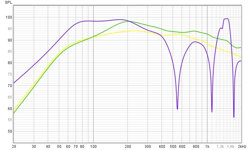

Just for fun, I tried to simulate an open baffle with the radius of the horn depth . That comes in yellow. The green line is compound offset horn to simulate open back bass on the MEH and the blue one is MEH with a very large back chamber. All with 9 3S3P connected woofers. I do not know if compound offset horn (with a very short "back" horn) is the correct way of simulating the low section of a MEH with an open back, but it seems pretty legit to me. If I get something like the green curve, I will need around 8 dB boost to match the blue curve. The woofers can take 540 W compared to 40 W for a pair of 3FE22s (AES, peak is double the values). So there is plenty of headroom.
If my simulation is correct, it would imply that running the mids with open back would not influence the respose by dipole cancellation in the pass band.

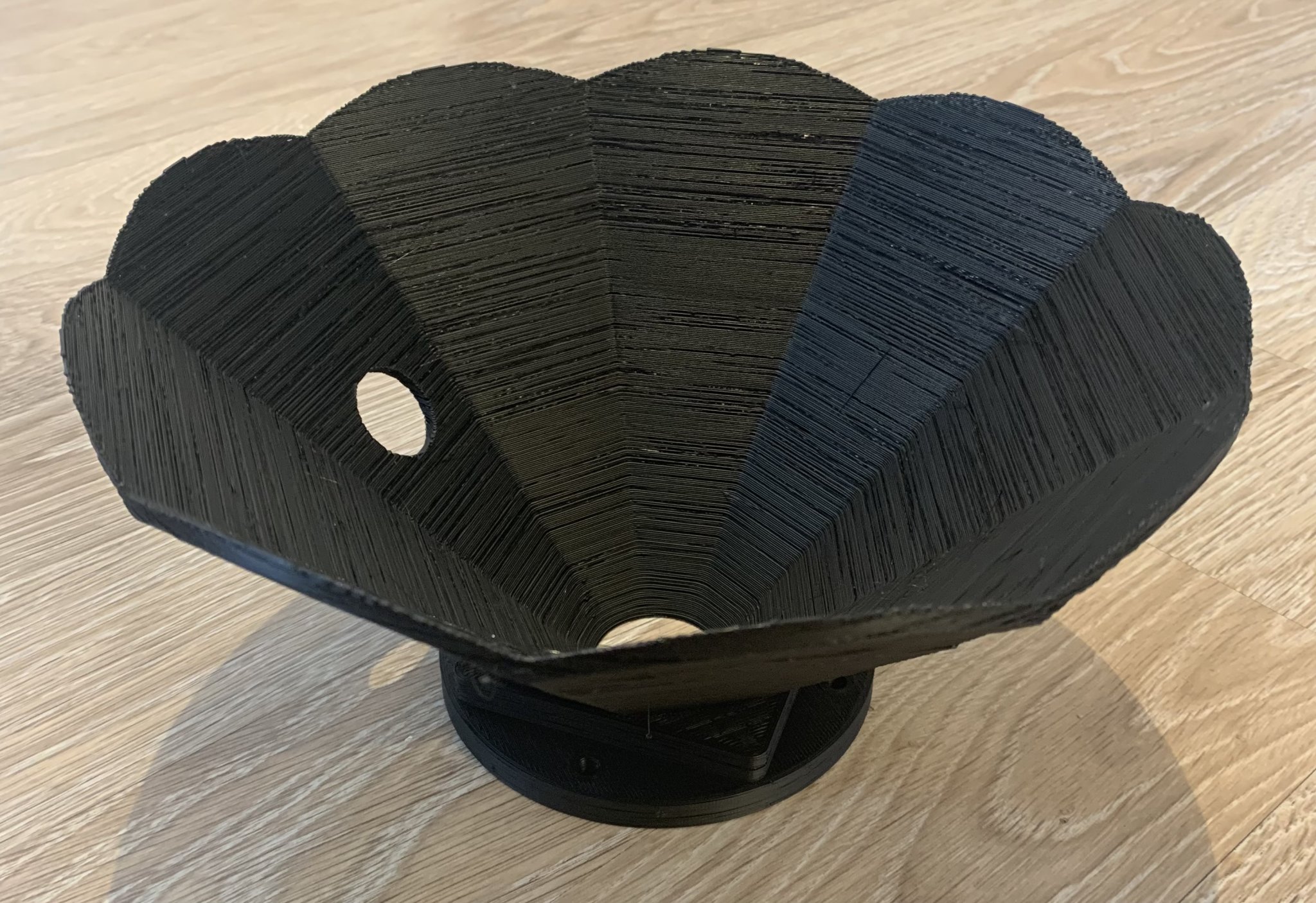

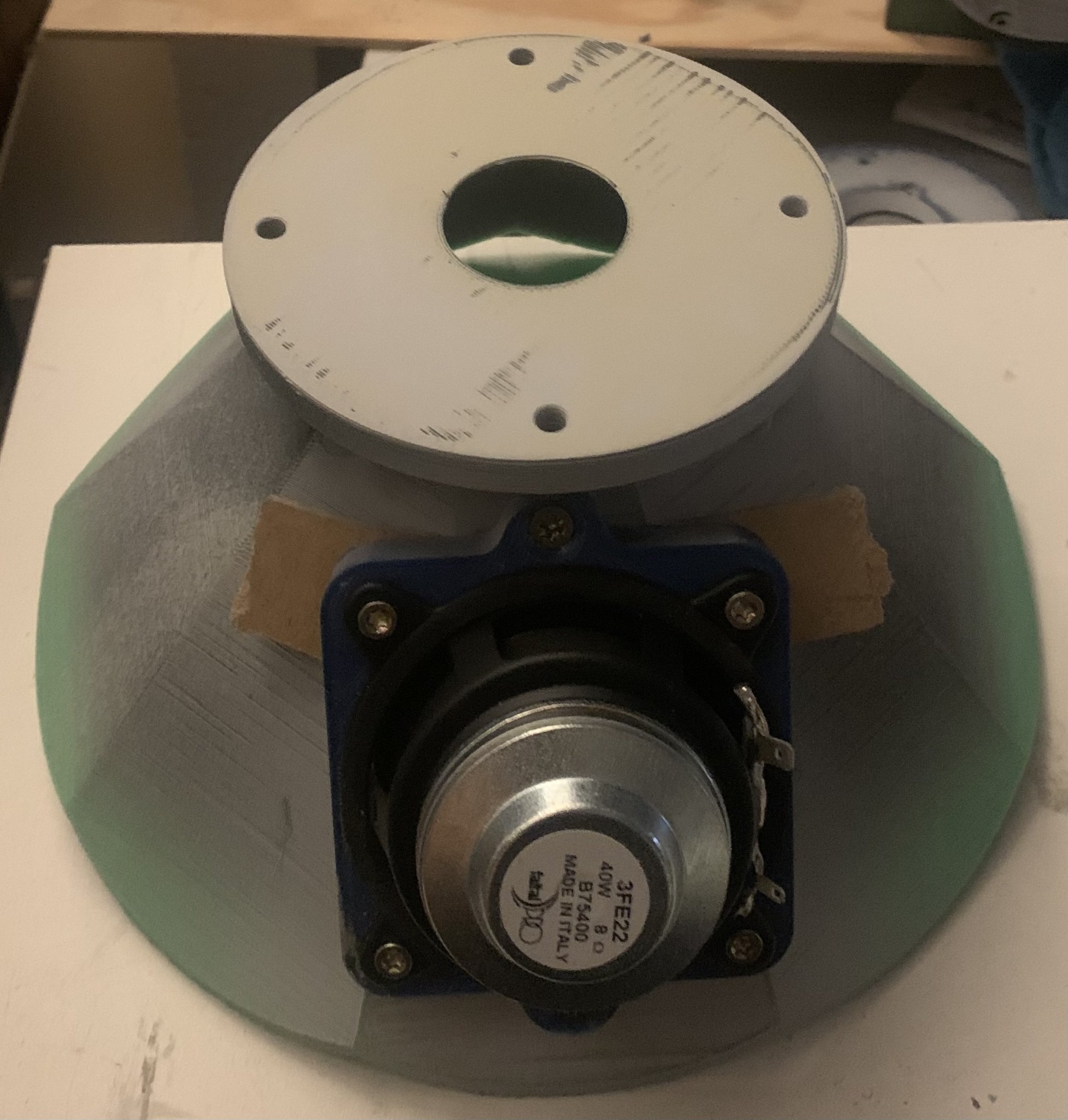

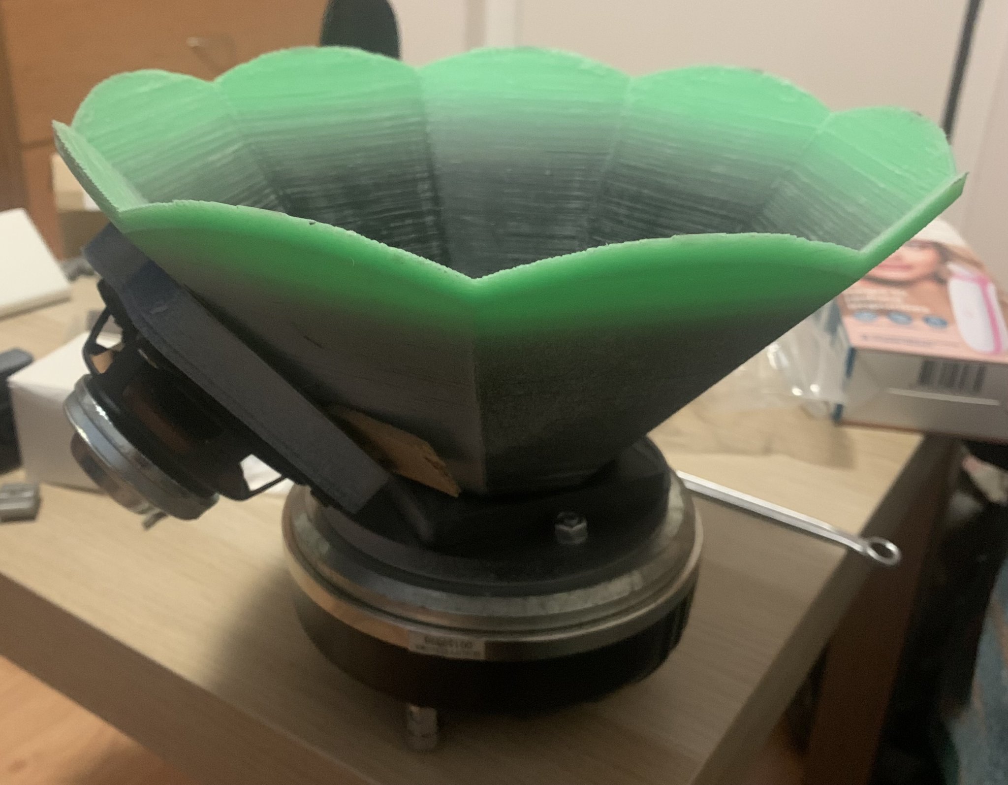

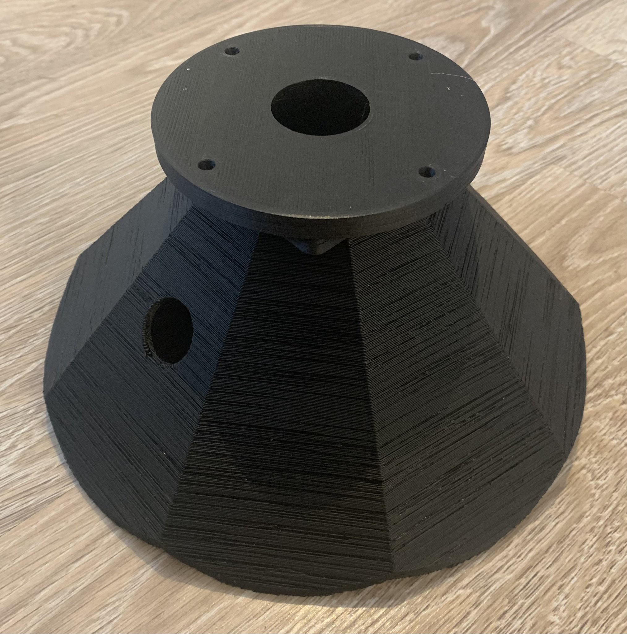

So the test horn with one mounting adaptor are printed. There was a catastrophic print failure on the horn and I have found out that the nozzle is partially clogged on my large printer:( The print is most probably unusable and I hope I have a spare nozzle...
Reactions: 4 users

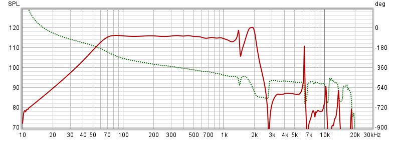

I am slightly confused. I measured the notch at 1510 Hz being an average from 4 measurements. The center of the mid hole is 65 mm above bug screen. The notch frequency corresponds to 57 mm, which is roughly the distance from the bug screen to the edge of the hole (coincidence?) Could it be that the acoustic center of the driver is at the bug screen or evem slightly above it? Will try BC DE72 later.

I have this theory, that the change in flare-rate from the inside of the CD to the much wider conical horn creates an invisible "reflection layer" at the throat of the horn, on wich the midranges (and woofer) reflect of and that this dictates the notch-frequency. It is still a theory, as I am not that far with my MEH to do any measurements to verify it.
Have you measured with a plate at the throat instead of a CD?

So it is confirmed. I need to search for the notch a bit due to the asymmetry. Without any driver, the frequency corresponds exactly to 1/4 wavelength of axial distance of the center of the hole. With the driver (shorted terminals), the frequency moves slightly up. I still may be doing something wrong in the measurements, but it is quite in agreement with the experience from my previous builds. Unfortunately, I have no good 1" driver, so I stay with the 1.4" throat for now.
