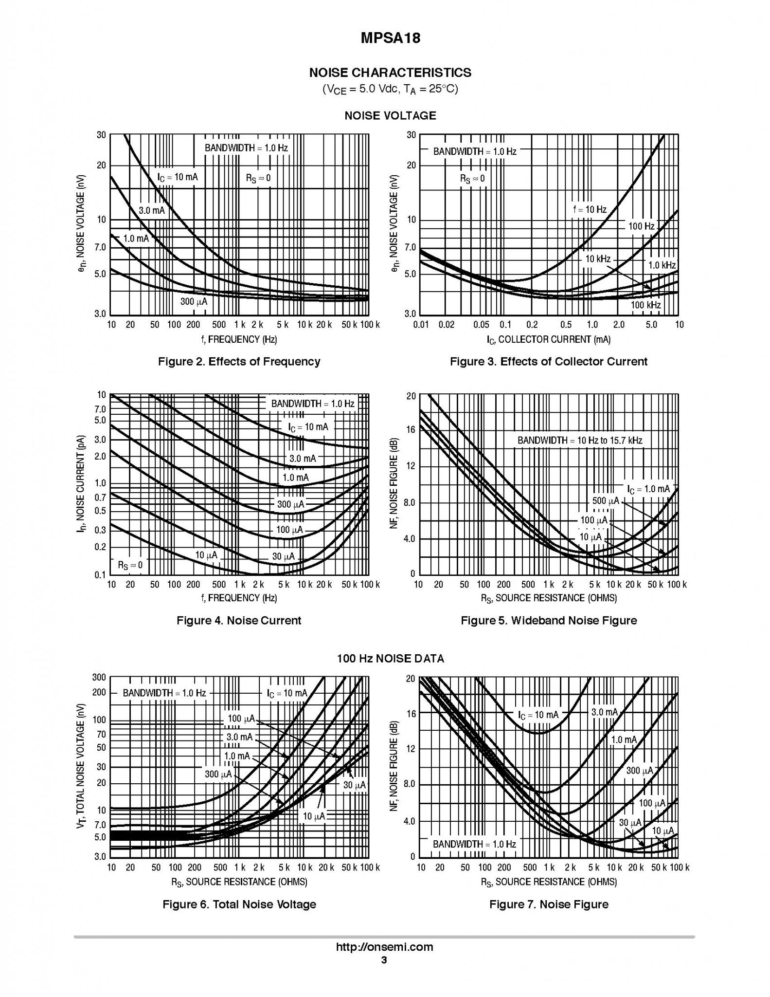

You with dreamth stubbornly refuse to admit the obvious. Even in the datasheet of the MPSA 18 you mentioned (see my attachment, pay special attention to the optimal current in fig.6 and fig.7). Your answers are beginning to convince me that you both need more self-education.Look at the data sheet for the MPSA18. At 10 uA collector current the beta is way down.

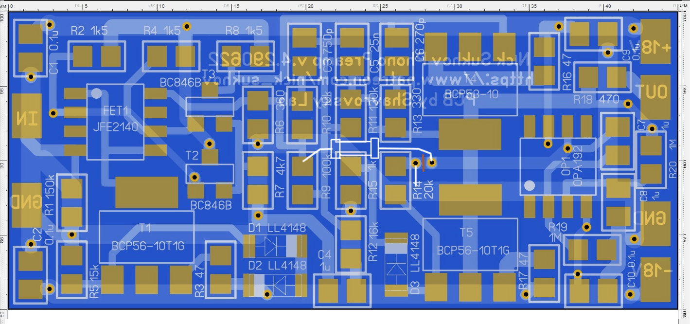

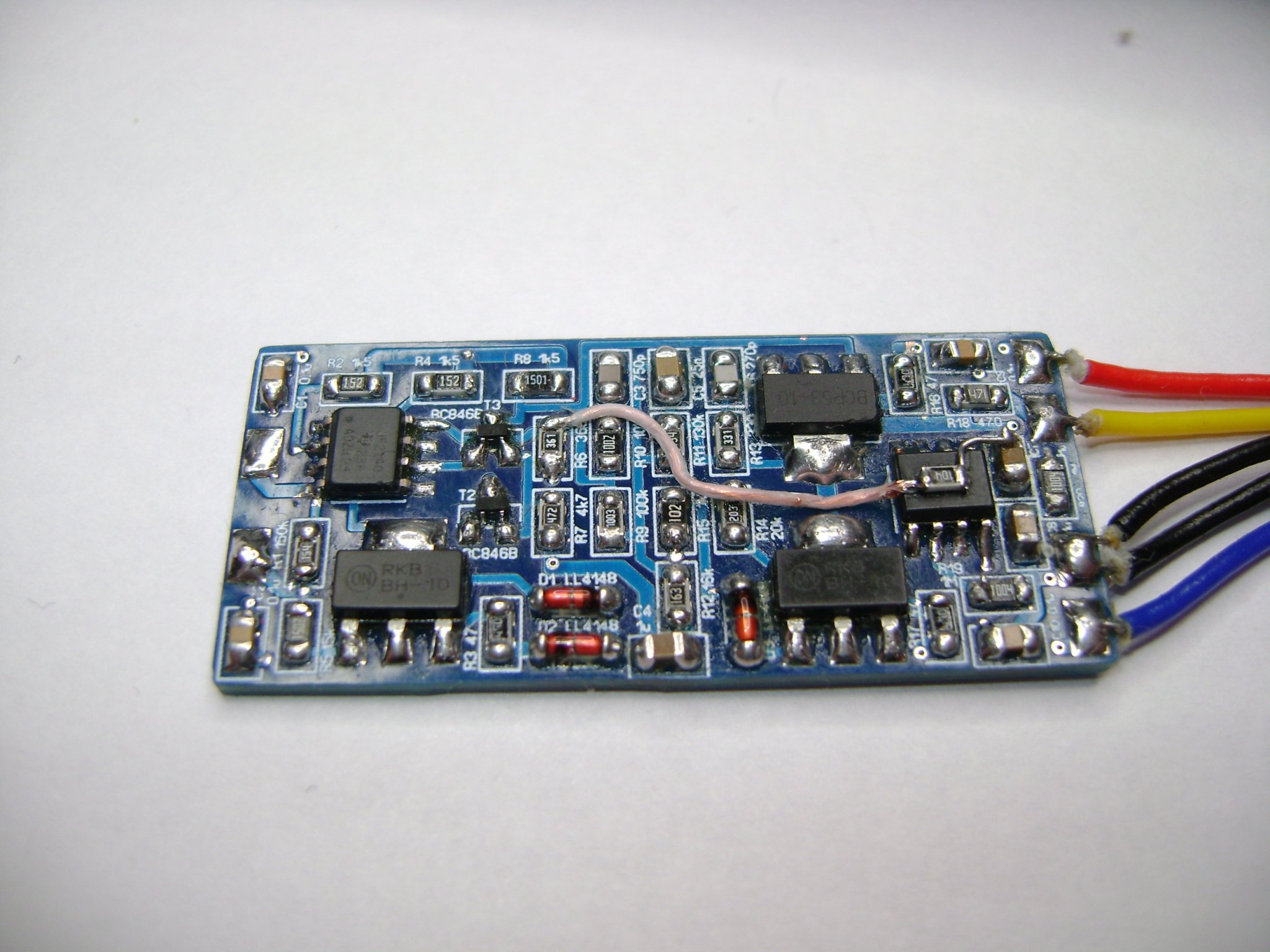

Looks good, but why is that 100k resistor piggy-backed on that chip?
It is DCservo modification for using not only newest modern JFE2140 matched JFET pair with 4 mV VGS mismatch but also LSK389 in SOIC with 20 mV mismatch or even discrete selected JFE150. Resistor can be soldered any way not only with smd but also using axial mount type [ https://www.patreon.com/posts/72574505 ] PS. You can see and buy full DIY kit here https://imrad.com.ua/ua/fonokorektor-sy-xxi-v-4-dlya-golovok-zvukoznimacha-z-ruhomim-magnitom-mm-Looks good, but why is that 100k resistor piggy-backed on that chip?

The assembly is not done neatly . Large solder surges . The flux remains have not been removed . The assembly was done unprofessionally .
