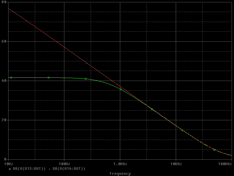

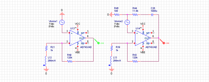

As I pointed out the inductance and resistance of the cartridge create a zero at R/L in the transfer function. The negative resistance input amplifier lowers the R to reduce the frequency of the zero and extends the low frequency response. With conventional EQ you are simply trying to amplify the falling response and you amplify the noise by the same amount.
There will be no difference in noise level (the simulation confirms this). Active emulation of negative resistance is also gain.With conventional EQ you are simply trying to amplify the falling response and you amplify the noise by the same amount.
Apply the same noise transformation on figure 16 as was used on figure 14 and you will see that the equivalent input noise is the same, except for the extra noise voltage from the resistors in the positive feedback path. As the circuits have to be equalized to get the same transfer from input to output, the same holds at the outputs.IF you are interested in low noise design, I recommend that you obtain "The Sound of Silence" by Burkhard Vogel and "Low Noise Electronic Design" by Motchenbacher. There is nothing new in low-noise design. By the way, you can do better than a TIA. With a little positive feedback you can design a negative input resistance amplifier. An inductive signal source, such as a phonograph cartridge, has a winding resistance which in combination with the inductance limits the low frequency response (puts a zero in the transfer function) even if the amplifier has zero input resistance. A negative input resistance amplifier can cancel some of the winding resistance and extend the low frequency response. You have to be careful with this method or you have an oscillator instead of an amplifier. You make an oscillator by placing a negative resistance across a resonant circuit. The method is shown in the attachment. The amplifier has combined negative and positive feedback to produce a negative input resistance.

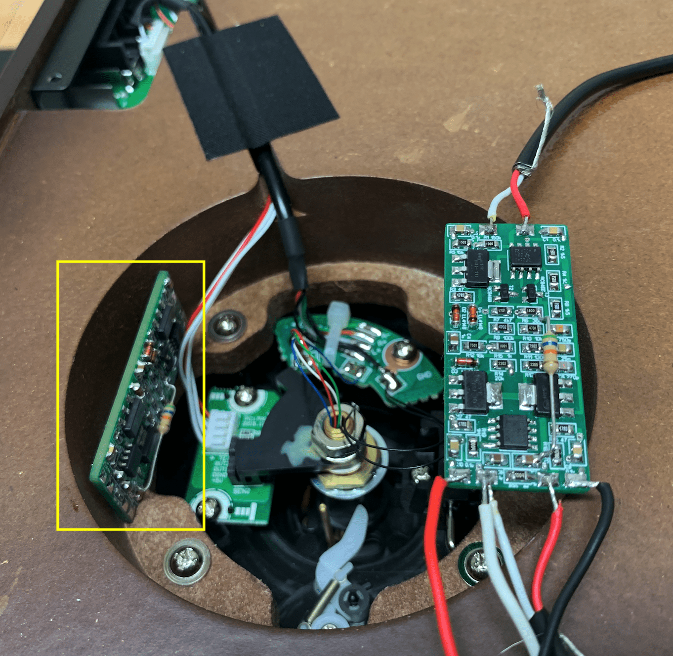

internal installation of my phono stage v.5. Details are here [ https://www.patreon.com/posts/insaidnyi-ot-vip-72574505 ]

Op-amp circuits with positive feedback are rare, so their analysis may not be obvious. When positive feedback is introduced, the noise gain increases. Thus, all sources of noise will be amplified, as well as the useful signal. The situation is no different from using conventional EQ. Netzer's article says that a circuit with a negative input resistance "performs better than a high-input impedance amplifier and equalization network". But when compared with a transimpedance amplifier and equalization network, parity is obtained.With conventional EQ you are simply trying to amplify the falling response and you amplify the noise by the same amount.

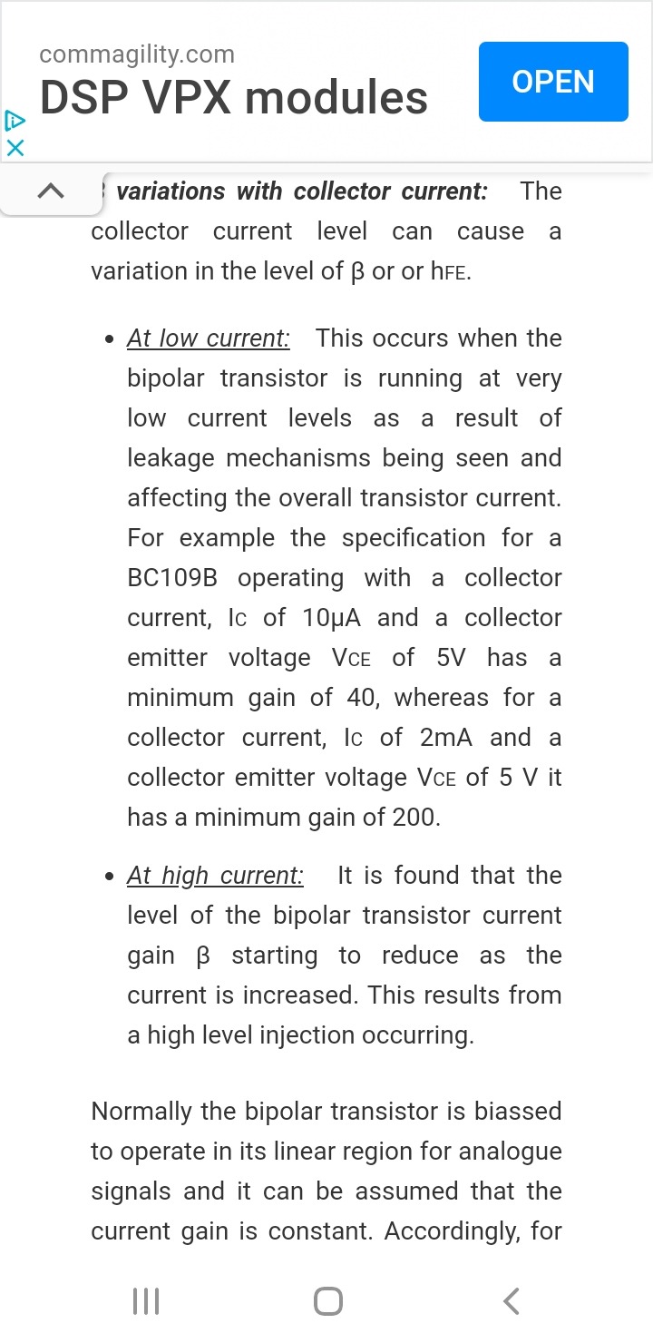

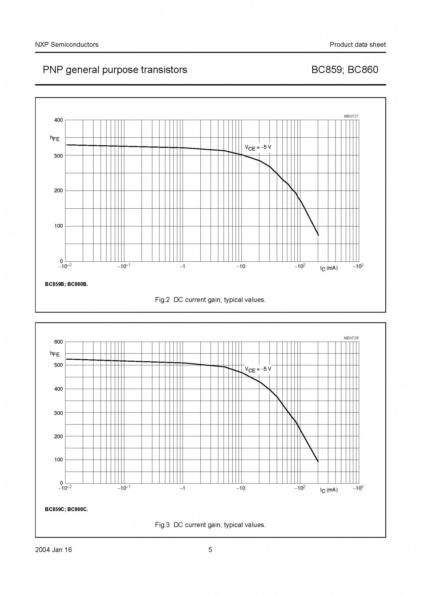

So, is every other preamp designer wrong? With that small collector current you would have severe loss of beta (Hfe). If you look at a chart of beta vs collector current you see that as the collector current decreases the beta also decreases and at zero collector current you have zero beta. With 100uA collector current the transistor beta may be down 20-30% from the value at 10 mA. but at 4.25 uA it would be way down. Marcel had some measured values of cartridge impedance and it didn't exceed 50 kOhm. In the actual preamp the cartridge is shunted by the load resistor which will reduce this value further.
You are wrong (or live in a hopelessly frightened past}. Prooflink attached.

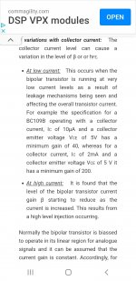

You forgot you're talking to a guy that knows everything and that he is also smarter than everybody else on the Planet Earth...Look at the data sheet for the MPSA18. At 10 uA collector current the beta is way down.
https://www.electronics-notes.com/a...mponents/transistor/current-gain-hfe-beta.php
Then use BC859/BC860 insteadLook at the data sheet for the MPSA18. At 10 uA collector current the beta is way down.
