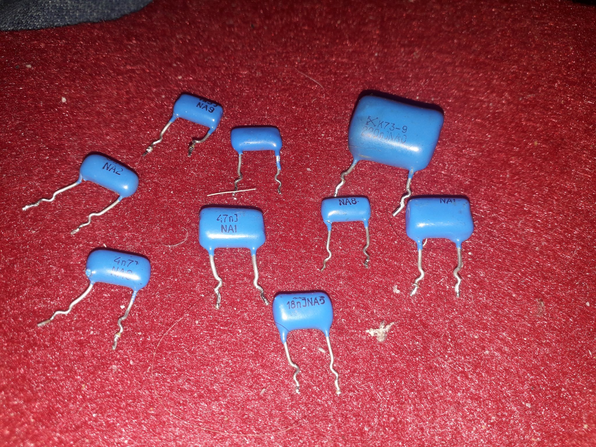

Could you, please, help me with some piece of information? I have a lot of these caps from a multichannel recording mixer Elektronika pm-03.Could you tell me what dielectric is used in them or what european type would they be similar to? I destroyed one and saw it's film and foil construction and usually that's good.I have lots of filters in cassette players and phono preamps to work on and they look very appealing to me as I have them in serious quantities.

Metallized Polyester film capacitor K73-9​

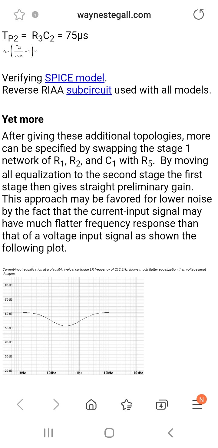

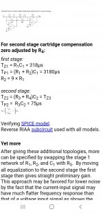

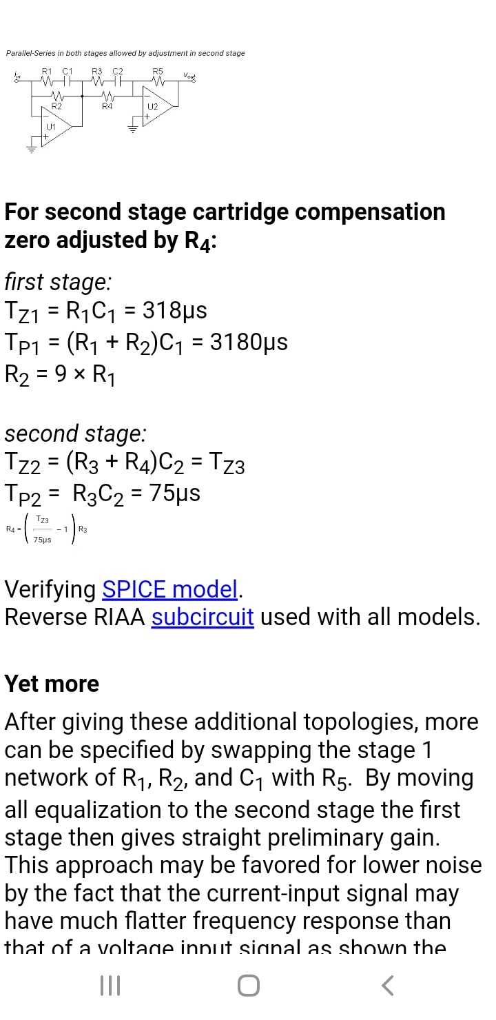

Right...so tweeting that high frequency ringing pattern ( associated to a SNR that humans can't even hear on vinyl if on any source at all) is better than the linearity and just good enough SNR you get from Leoniv's type of circuit...That was discussed by others too:
http://waynestegall.com/audio/riaa.htm#mozTocId495677
The noise you get from an inverted input is also more uniformely distributed in the frequency range making the total SNR less dependent on frequency which is a plus at a subliminal level.
Bipolar transistor input current noise has simillar effect 😉
A little note is required regarding the results shown in this video. The comparison showed not the noise difference between two different amplifier topologies, but the noise difference between AD745 and LSK389. If you use the same components, both circuits will show approximately the same noise.
