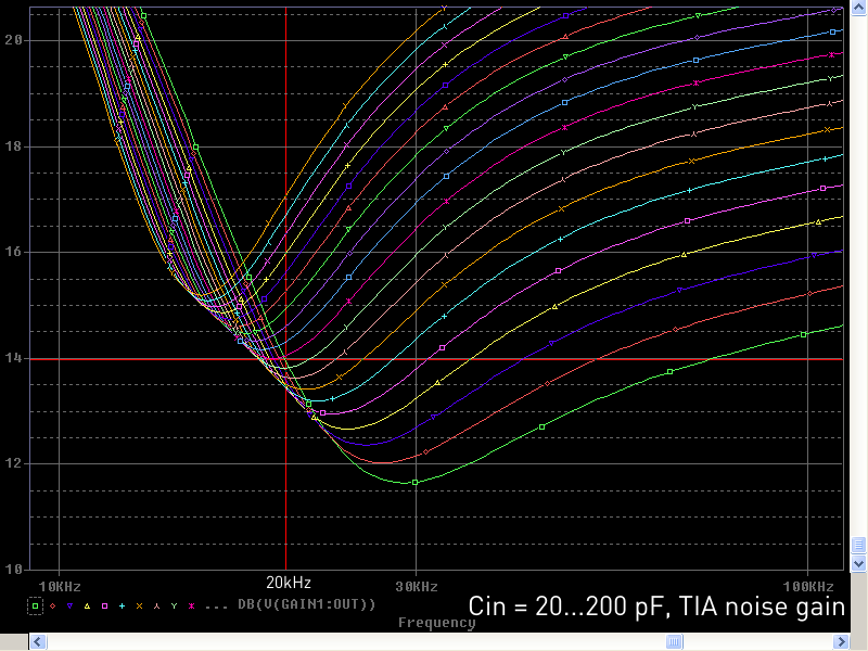

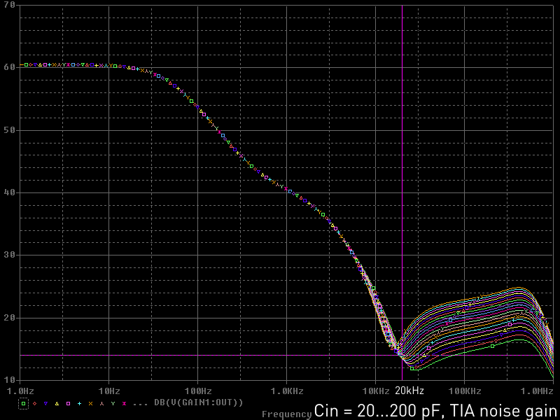

Yes, I think the possible way of partially compensate this negative fenomena is to adjust NFB capacitor of first opamp (C2 || R1 in your circuit). But it is also adjustment for specific length and type of cable.
Yes, this capacitor requires the right choice. As the simulation shows, when changing the cable capacitance from 20 to 200 pF, it is not required to change the value of C2. But when changing the value of R1 (which may be required to select the gain), it is required to change C2.
This is the reason why I made the first stage as a current-to-voltage converter without any frequency response correction. Initially, I wanted to compensate the L/R pole in the first stage (introduce the 1380 µs pole and the L/R zero). But since the L/R pole needs to be adjusted for different cartridges, the impedance of the feedback loop will change. I did not come up with a solution so that when adjusting it would be possible to manage with one value of C2.

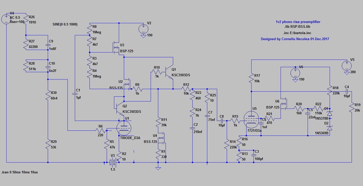

My first phono design in 2014 (unfortunately all the posted photos from 2014 were lost as they were tinypic links)
https://www.diyaudio.com/community/threads/unu-pnono-riaa-mm-preamp.255149/#post-5485527
reproduced perfect 25 khz squarewaves and visibly undistorted 480 khz sinewaves with no audible noise with D3A input tube, ultra low noise bipolar transistor mu-followers (gyrator) , it took me 1.5 years for research, design and final prototyping and while I have never heard a better sound from a phono preamp I never recommended it after 2015 to anyone to build such a thing because I found much simpler and cheaper solutions that allow for acceptably good sound.

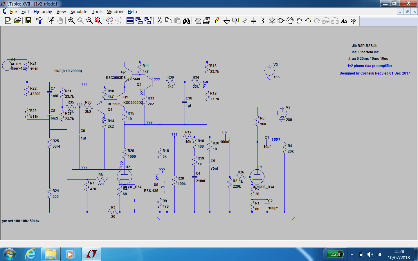

I even had a second itteration in 2018
https://www.diyaudio.com/community/threads/1v2-phono-riaa-preamplifier.315824/#post-5269451
And again...never, not a single time after 2018 recommended it to anyone even though I was the only guy to implement a variable RIAA as EMT did and I did it before knowing EMT promoted a variable RIAA standard. Once I heard about EMT JPA 66 I stopped thinking I know anything
more than others on phono preamps.I'm 45...and the golden era of turntables already reached its highest possible peak in 1980.
In case you think my choices are due to some lack of resources I can tell that I have 90 x 2sk117 , 10x 2sk170 , 10x lm394, 20x original signetics, philips and early texas instruments ne5534an, countless njm2043, 2114, opa2228, njm2068s( 9 pin ground version) and many other ultralow noise bipolars and j fet op amps.
I'm only taking seriously the simplest technology and device that give me a good sound.
Way too many people start their topics with words like "ultimate", " best"...then promoting very complicated technologies or expensive components that can't compete with my 1990 Pioneer cassette decks...
