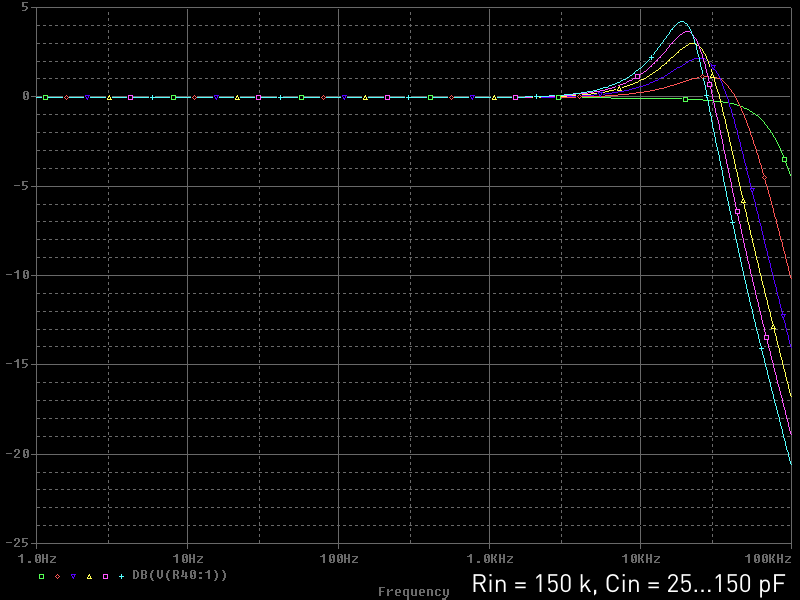

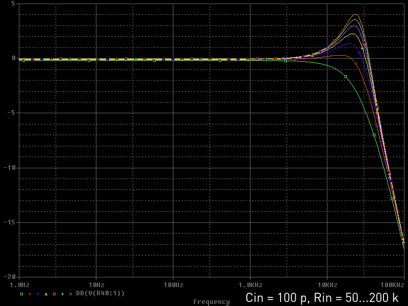

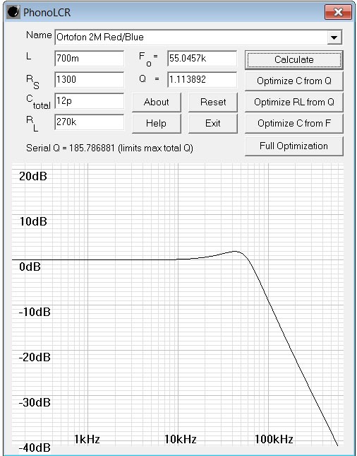

Yes, but I can increase my termination even to infinity without a problem

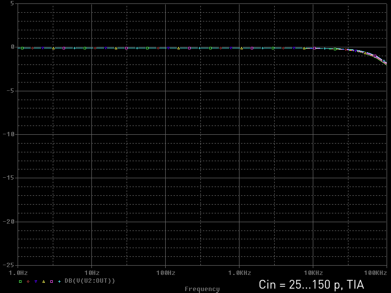

No, it's not. You can't even do 150 kOhm because you'll get a peak in the frequency response with parasitic input capacitance. The graphs below show that at Rin = 150 kOhm, even 50 pF causes a peak. Lossy cartridge model used, simple with L and R will give even more peak. To get low parasitic capacitance, the amplifier must be placed inside the turntable. But this is a serious limitation, the modern high-end means the phono stage as a separate beautiful device. With a capacitance of 100 pF (this is the actual capacitance of the cable), Rin can be a maximum of 75 kOhm. For TIA, there are no problems with cable capacitance.

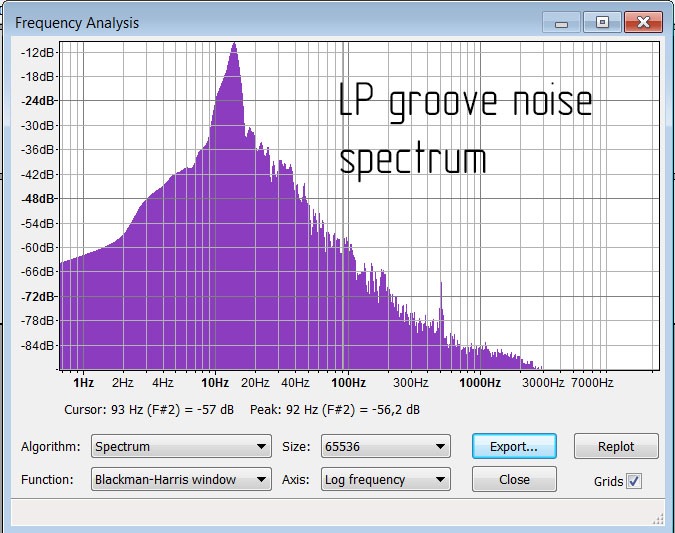

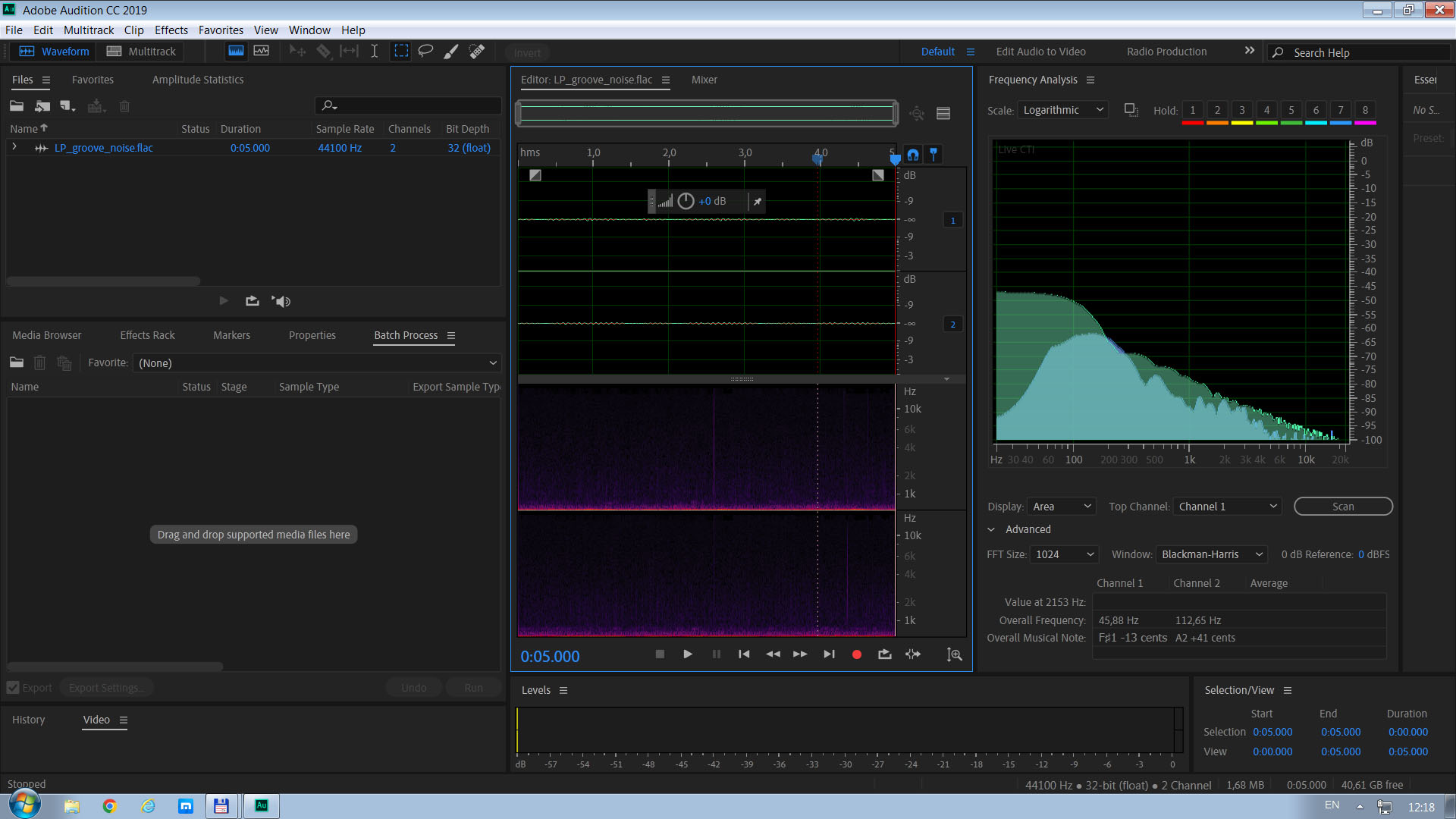

You just have some kind of mess in your head, imho. Sorry, do not insinuate my messages. Simply compare typical attached groove spectrum with noise spectrum of phono preamp.
My preamp v.4 and v.5 [ https://www.patreon.com/posts/su-xxi-v4-2-i-s-71350056 ] has 12 pF input (with jfe2140 jfets) and mounted near tonearm without any parasitics. 😏 I have no any significant peak even with 270k both in audio @20 kHz and ultrasounds. Аnd no hemorrhoids with any tau adjustments for the used cartridge...
My preamp v.4 and v.5 has 12 pF input (with jfe2140 jfets)
This is just the input capacitance of the amplifier. There is also the capacitance of the tonearm wires and the parasitic capacitance of the cartridge itself. Try to inject the sound card signal into the cartridge circuit and get the real frequency response.
I quoted your words telling "the noise density is mostly 1..2khz" .Your attached photo shows the noise mostly below 100 hz which is completely wrong again unless you have -12db rumble from the turntable and no PSRR in the phono preamp itself. That's highly unrealistic.
Please stop using insulting words for nothing!
Attached is a real groove noise of LP. Analyze its spectrum and see for yourself that I am right. You can also digitize your own groove noise for a minute and compare with mine.
My efforts are focused on creating a circuit that could work with interconnect cables.
Your idea of eliminating the negative capacitance effects of interconnects in this way is really noteworthy. But in addition to the capacitance, the long cables also add interference with pickups; however, here the virtual earth will also give a positive effect. The only bad thing is necessity of L/R tuning for each cartridge.
