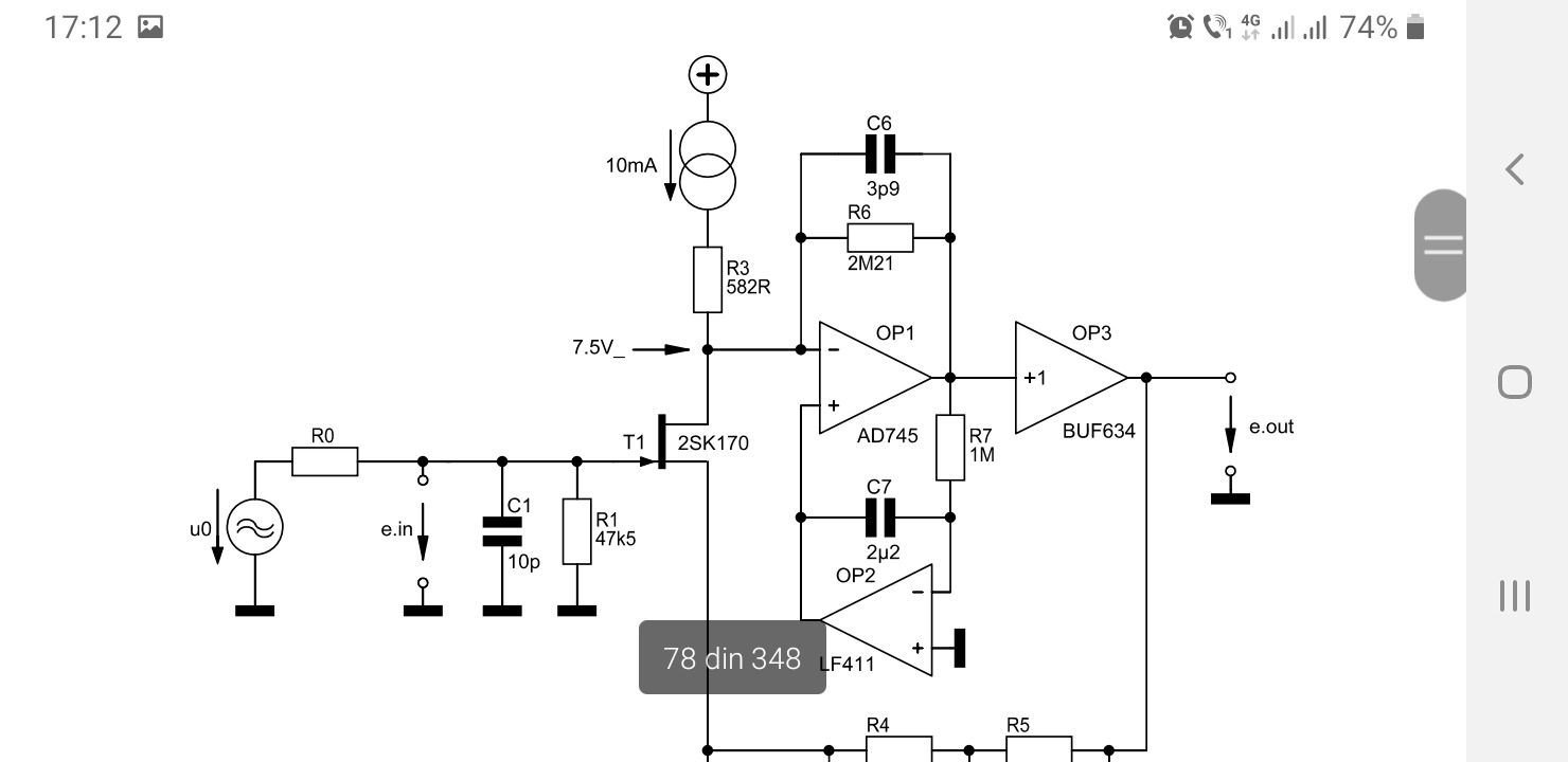

A little note is required regarding the results shown in this video. The comparison showed not the noise difference between two different amplifier topologies, but the noise difference between AD745 and LSK389. If you use the same components, both circuits will show approximately the same noise.
I thought so too when he brought in discussion ad745 noise in the datasheet, but it's hard to compare apples to apples

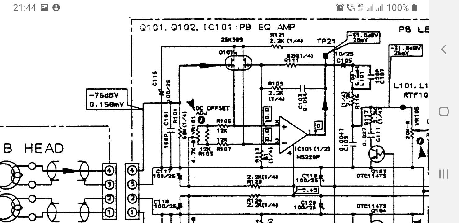

in Congo... You could revert this one to inverted topology :

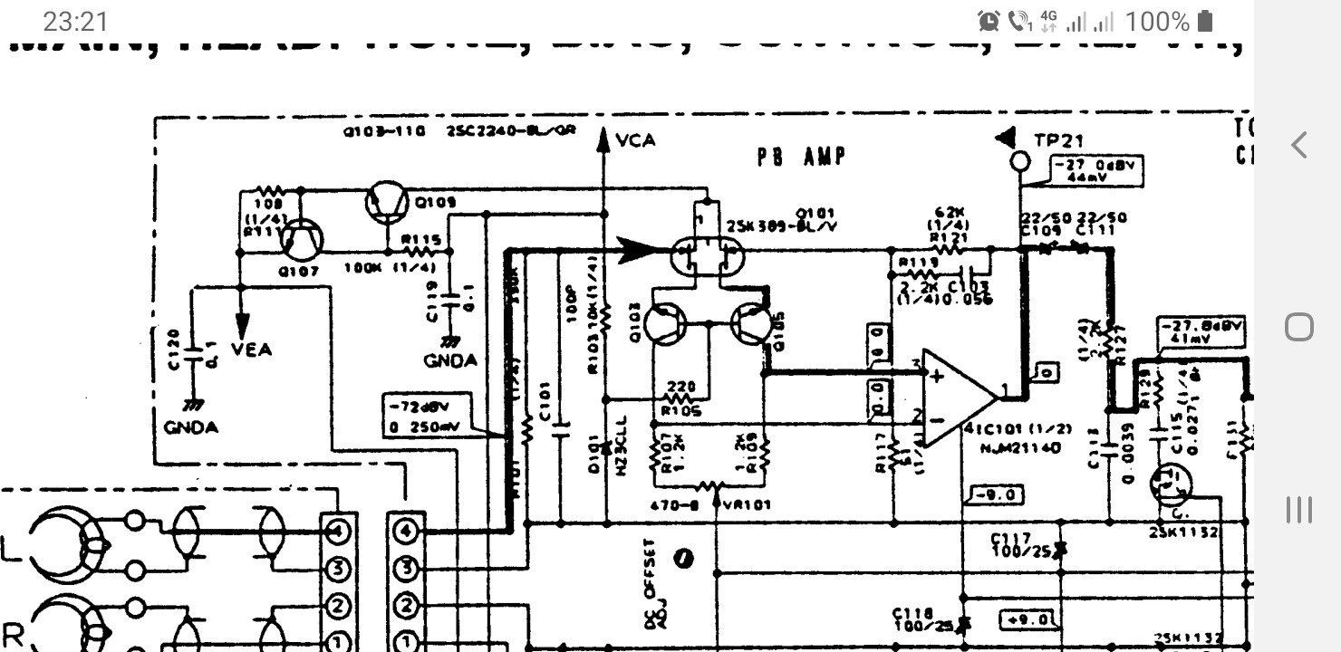

Feel free to get inspired:
Thank you! I also have a large collection of diagrams and articles on this topic. It takes some time to spend in the simulator.

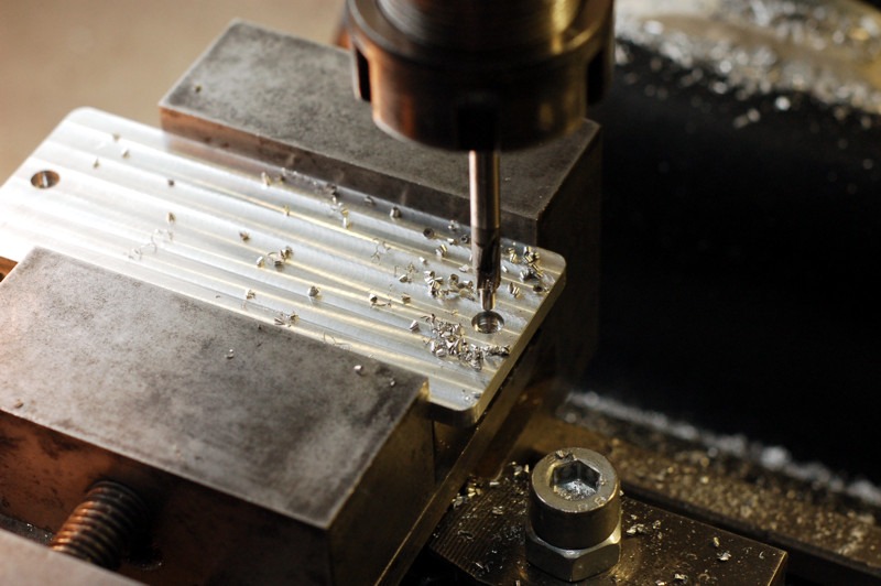

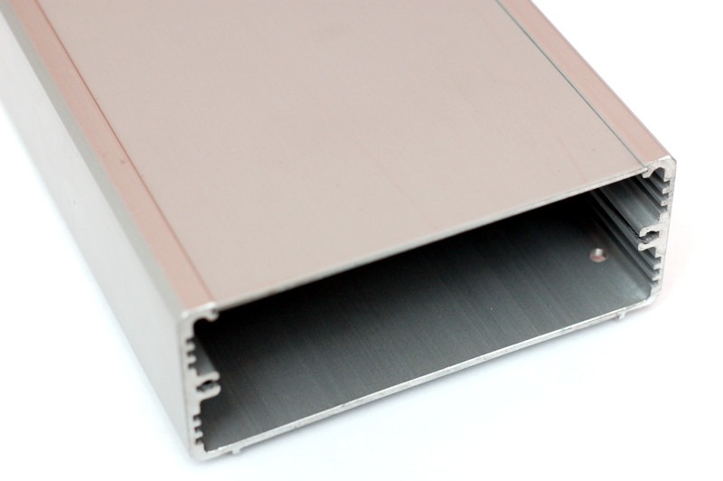

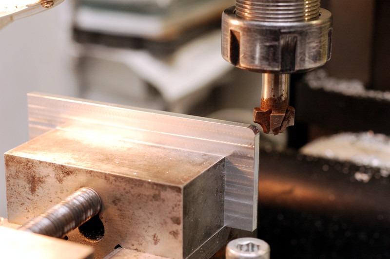

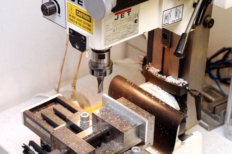

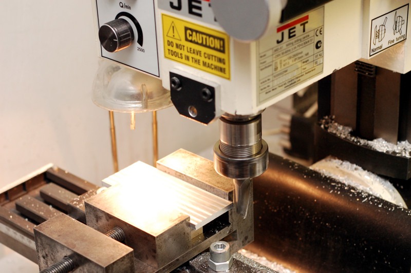

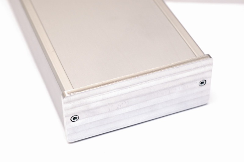

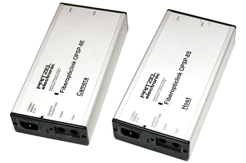

But I'm on the other side of the issue. Any device is better to start with a case, otherwise there is a risk that it will remain in the form of bare boards and wires. Found two old optical modems. Their enclosures are suitable for phonostage and headphone amplifier. Plastic panels, of course, are not suitable, according to the laws of the genre, the front panel should be thick aluminum and protrude beyond the body. But the rear panel is usually made thin and does not protrude beyond the edges. To round the corners, I bought a shaped cutter. This is still a panel blank, it is necessary to make the required holes in it, and at the end to grind the surface.

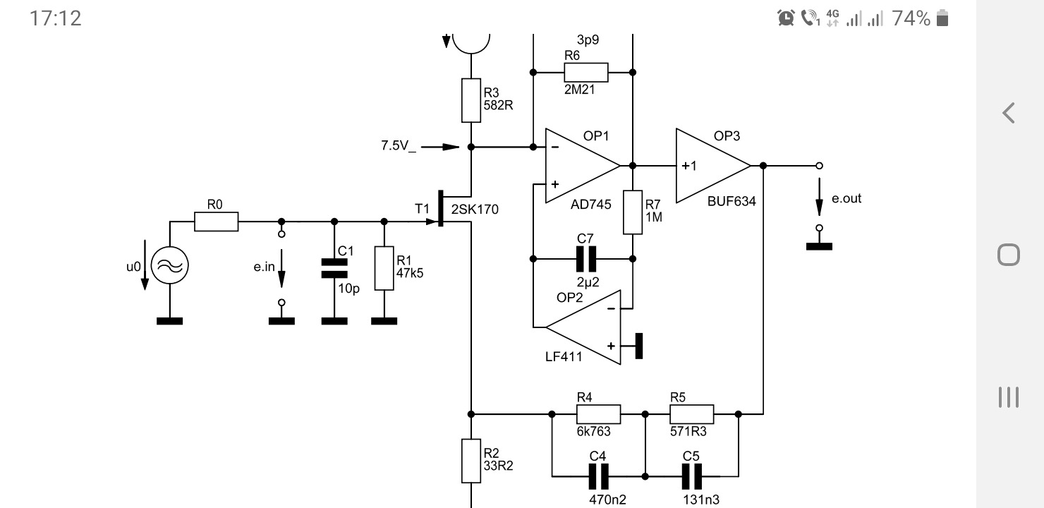

The first suggestion has an advantage over the other two: it's a j-fet unity gain stage so you don't need to deal with additional phaseshift compensation while today's op amps don't really need any external help except impedance matching.Ad745 should be exceptionally good for your circuit and there should no need for external devices .The third stage is the genious one because it allows +3db SNR with jfet thermal matching properties.
I want to use a hybrid first stage for two reasons: 1) less noise, 2) more linearity due to high loop gain. The source follower on JFET will not provide additional gain, although the issue of the battle with correction will be removed.
while today's op amps don't really need any external help except impedance matching. Ad745 should be exceptionally good for your circuit and there should no need for external devices.
That's right, op amps are capable of providing all the necessary parameters for the phono stage. This is confirmed by the video above - with an opamp you get a SNR of about 80 dB, which is quite enough. Therefore, I plan to make two versions of the amplifier - just an op-amp and with a hybrid input stage.
The use of a DC servo makes a second JFET unnecessary. And the input stage can be improved somewhat.

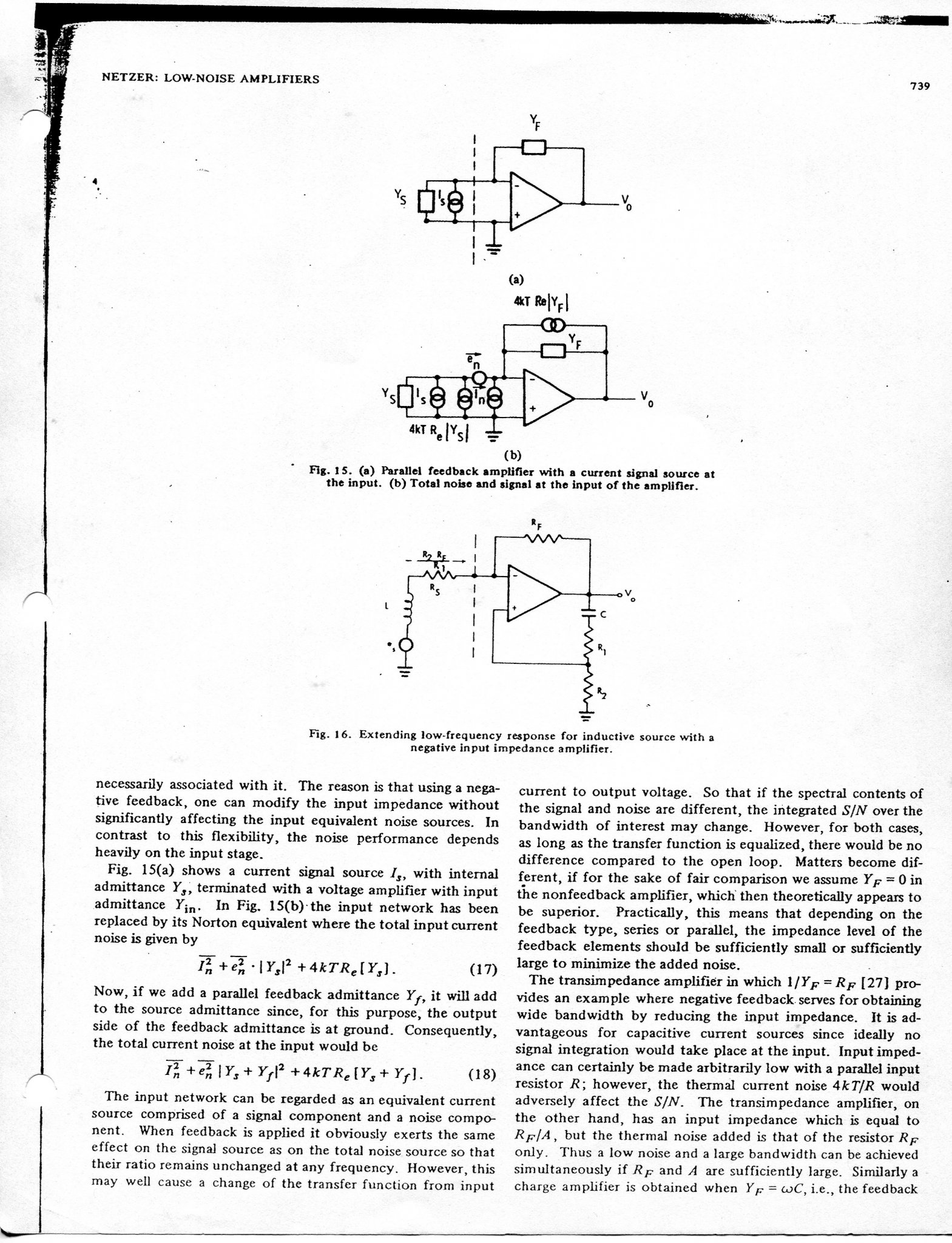

IF you are interested in low noise design, I recommend that you obtain "The Sound of Silence" by Burkhard Vogel and "Low Noise Electronic Design" by Motchenbacher. There is nothing new in low-noise design. By the way, you can do better than a TIA. With a little positive feedback you can design a negative input resistance amplifier. An inductive signal source, such as a phonograph cartridge, has a winding resistance which in combination with the inductance limits the low frequency response (puts a zero in the transfer function) even if the amplifier has zero input resistance. A negative input resistance amplifier can cancel some of the winding resistance and extend the low frequency response. You have to be careful with this method or you have an oscillator instead of an amplifier. You make an oscillator by placing a negative resistance across a resonant circuit. The method is shown in the attachment. The amplifier has combined negative and positive feedback to produce a negative input resistance.
What is the advantage of negative input resistance compared to pole compensation with zero?

Leoniv asked "What is the advantage of negative input resistance compared to pole compensation with zero?" The low frequency response is determined by the zero set by the resistance and inductance of the cartridge. The low frequency response is falling off, the SNR is decreasing and it cannot be improved by subsequent amplification. The negative input resistance amplifier extends the low frequency response and keeps the SNR high.

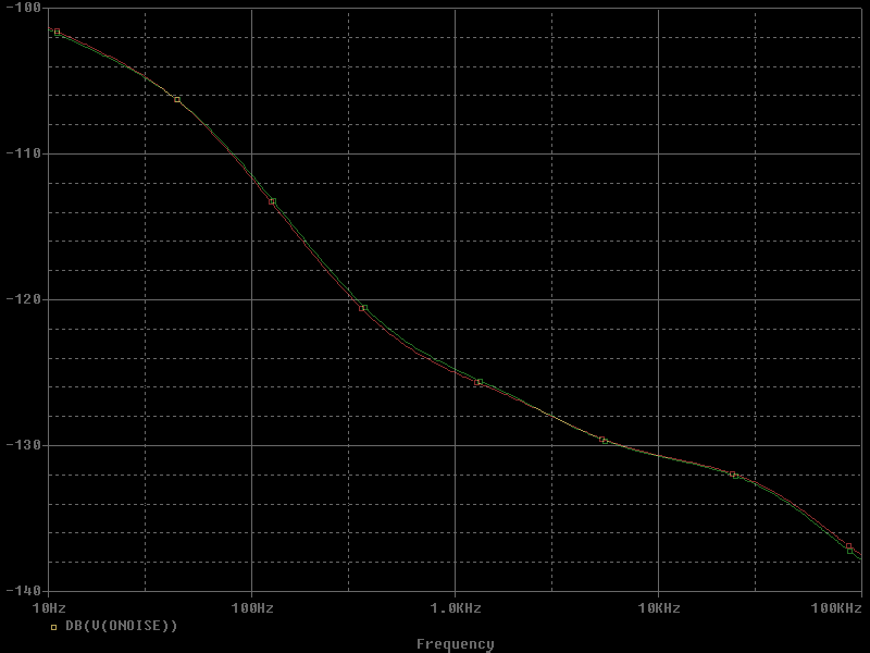

No, there will be no improvement in SNR. If a negative input resistance compensates for the internal resistance of the source, this does not mean that the thermal noise of this resistance will be canceled out.

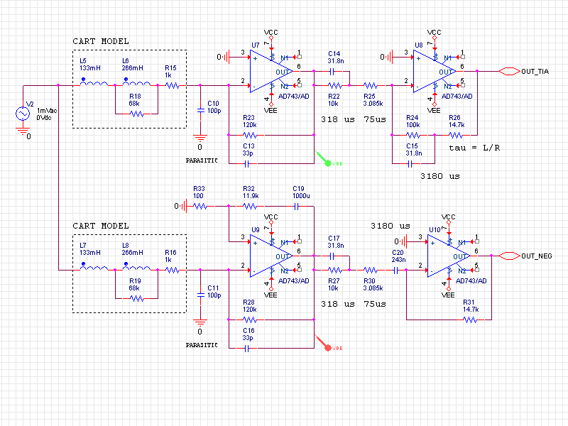

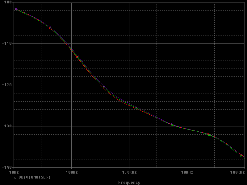

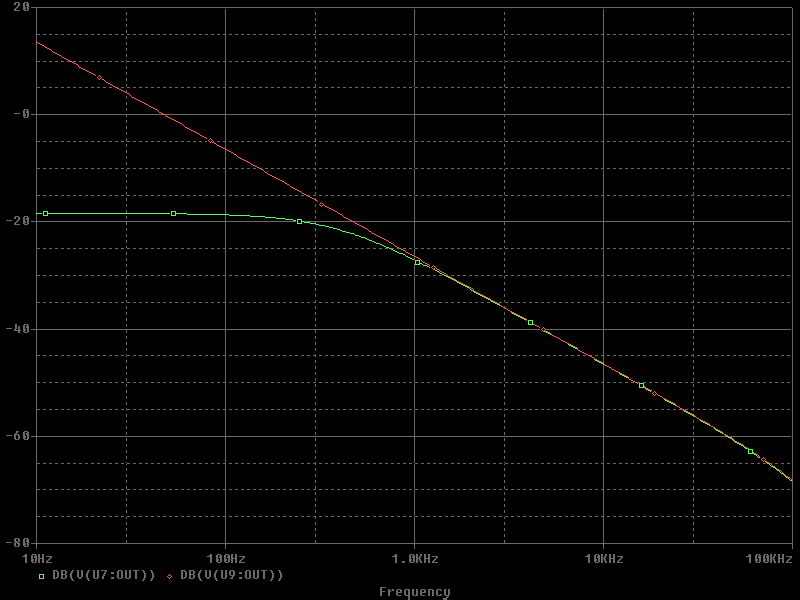

This is easy to check on the model. Above is a TIA circuit, below is a circuit with a negative input resistance. The frequency response curves at the output of the first stage show that the internal resistance of the cartridge is fully compensated - the curve has a constant slope of 6 dB / oct. The resulting frequency response is made the same. The noise spectral density curves for these two circuits are the same.

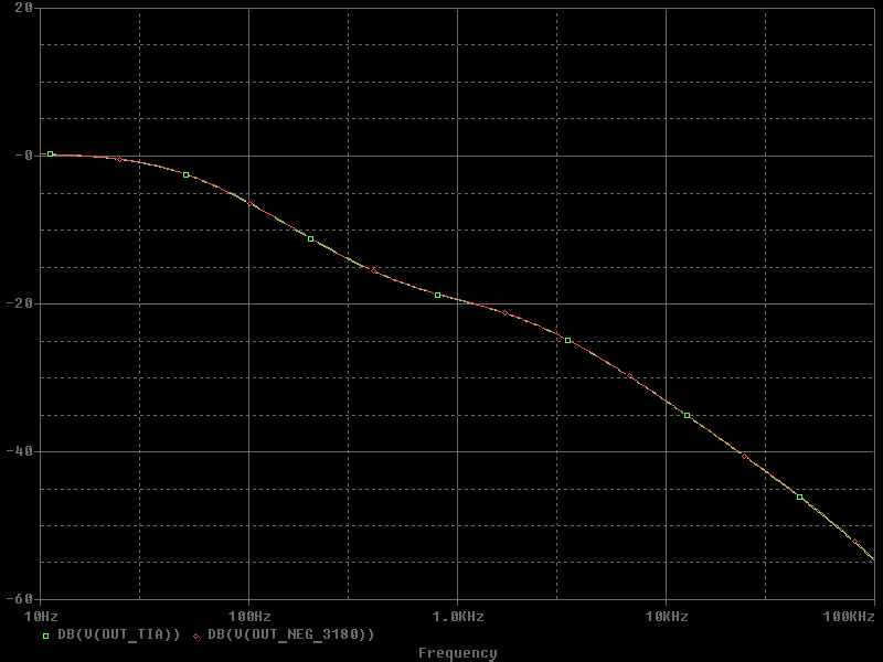

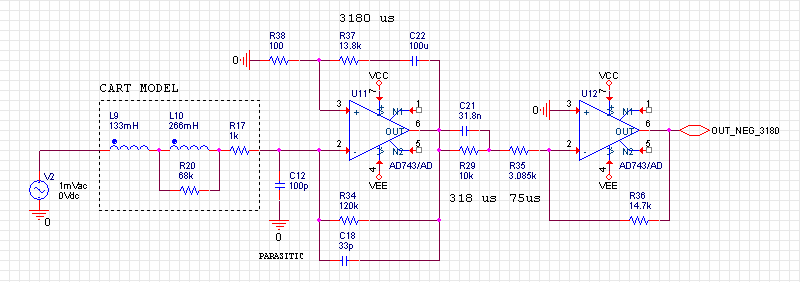

There is one more possibility - not to completely cancel the resistance of the cartridge winding, but to cancel it partially. In the AURAK amplifier, an additional resistor (positive resistance) was connected in series with the input in order to shift the pole for any cartridge to 500 μs (which is bad - noise increases). By adding negative resistance, you can shift the pole in the other direction to 3180 µs. To do this, the equality Lcart/(Rcart+Rin)=3180 μs (where Rin<0) must be observed. By adjusting the negative input resistance, this can be achieved for any cartridge. Not sure if this is a good idea - the noise stays the same.

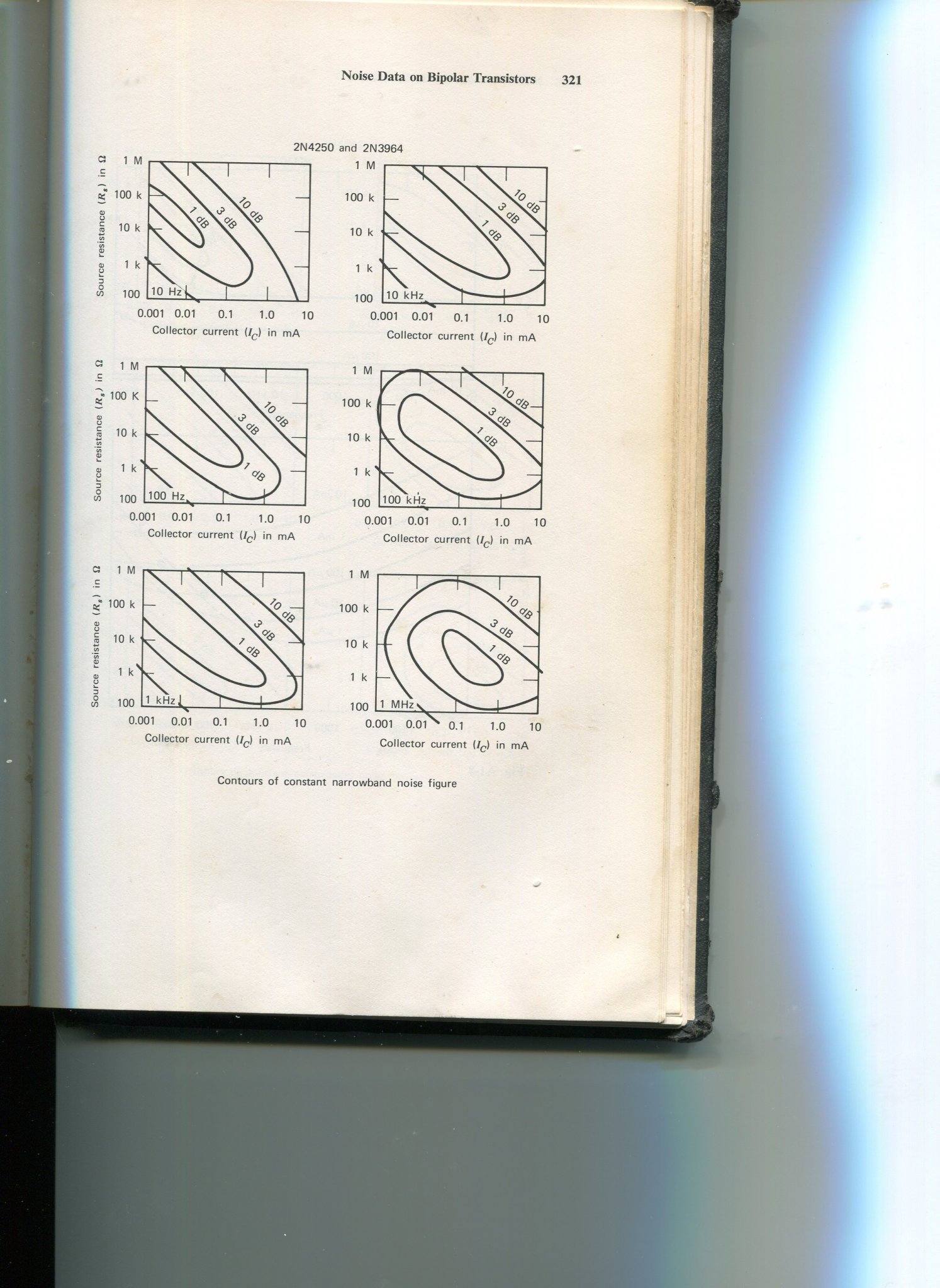

I think there is a misunderstanding. I said the negative input resistance amplifier could improve the low frequency response; I did not say it could improve the SNR. The negative input resistance does not cancel resistor noise. I am not sure what Mr. Sukhov is saying. Everybody knows that resistors generate noise and reactance's do not. You can use the noise figure plots to choose the bias current for the input device. I have attached some noise figure plots and it is obvious that the transistor should be biased at about 100 microamperes for a low noise preamp.
