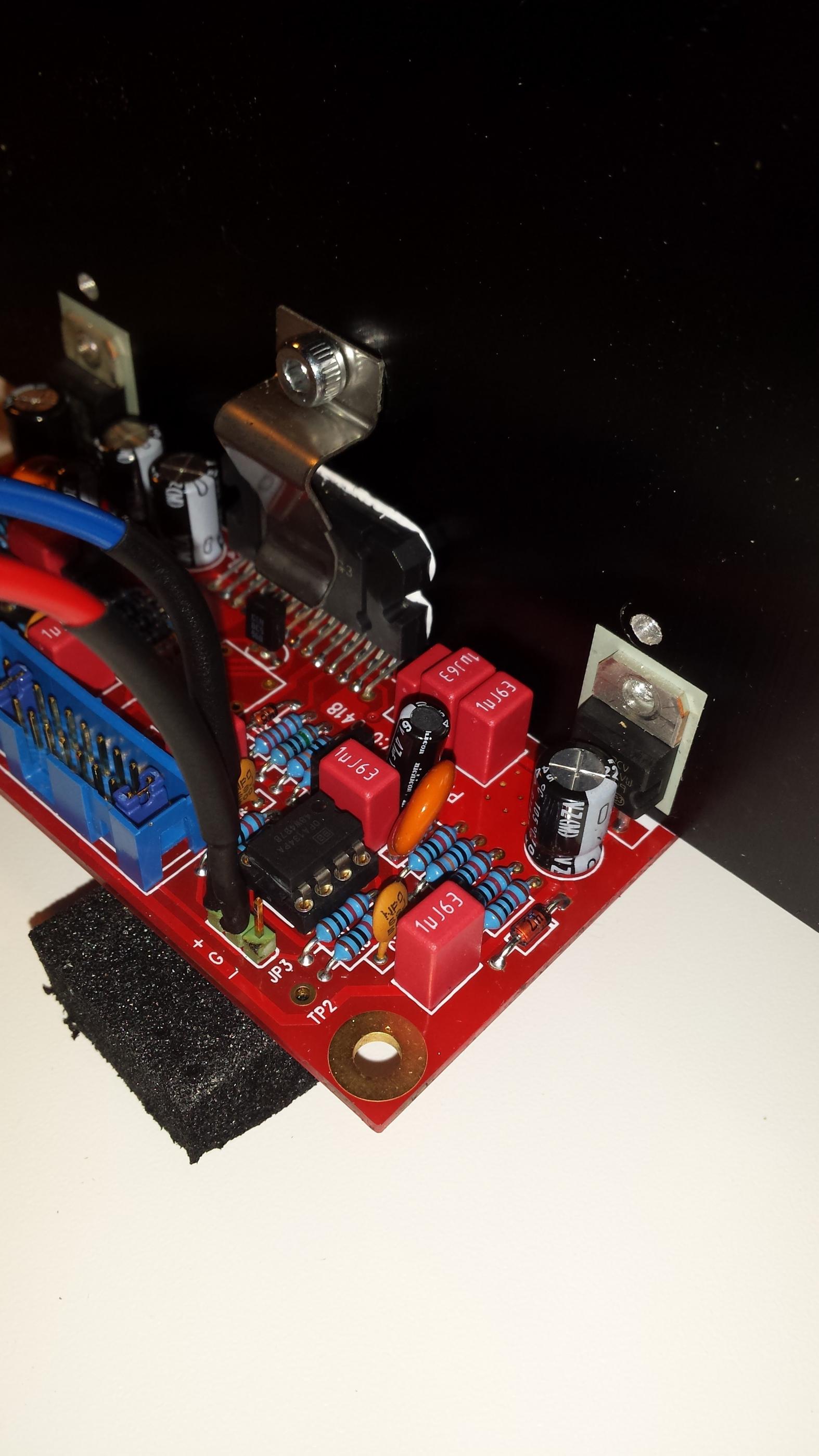

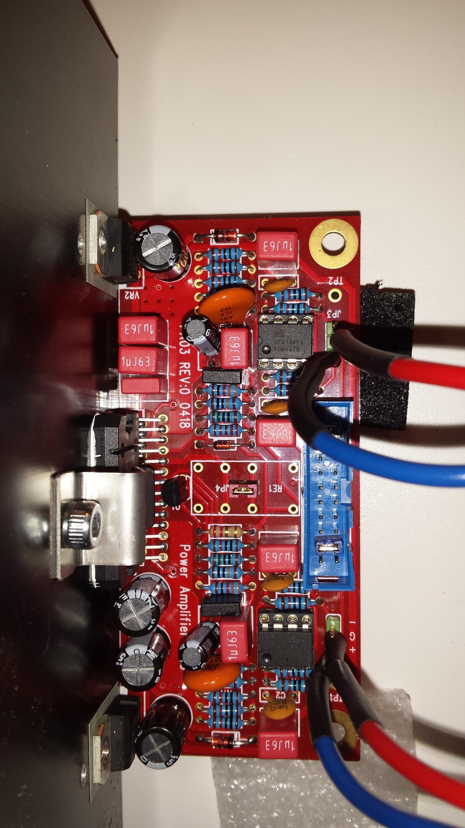

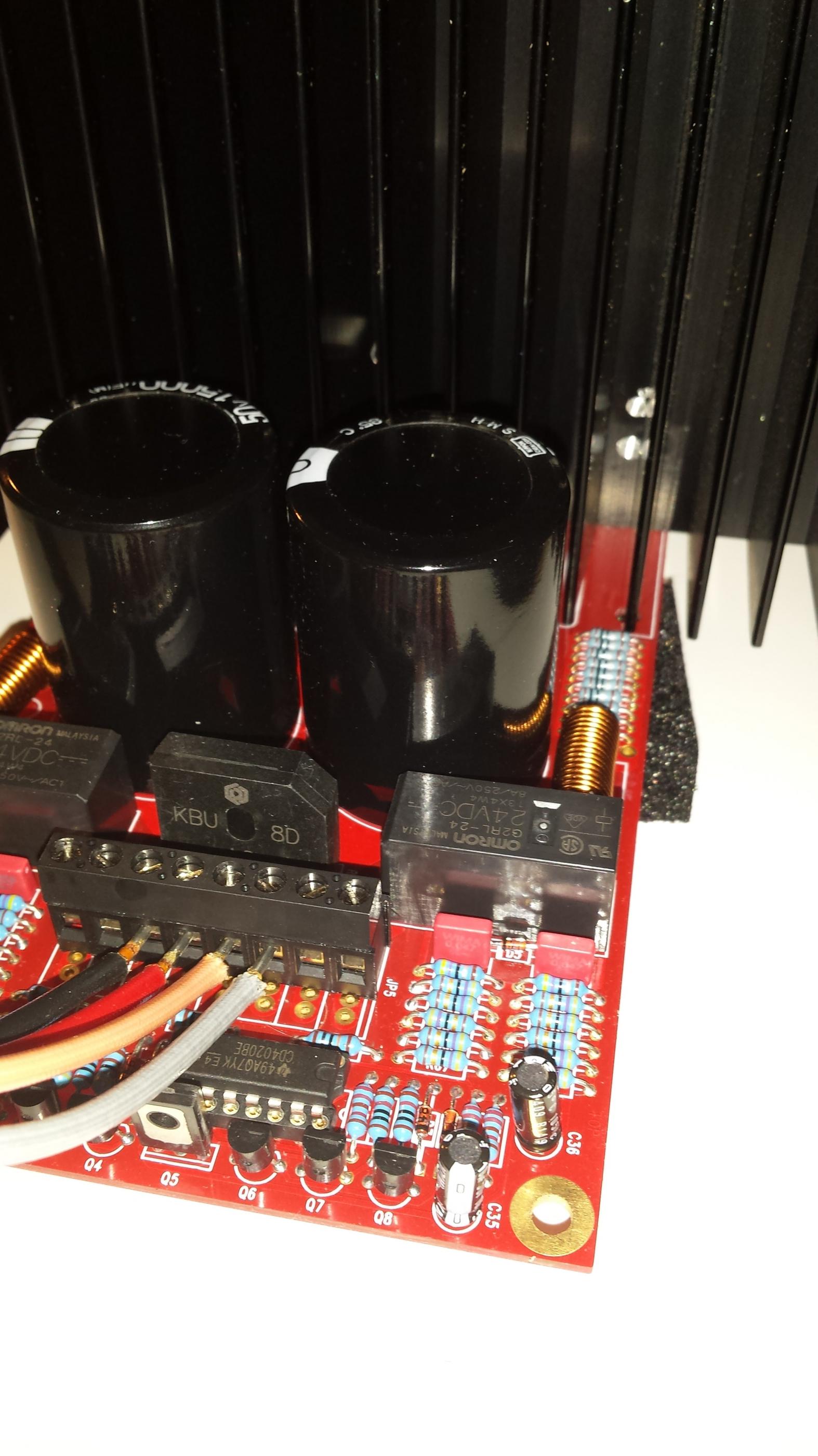

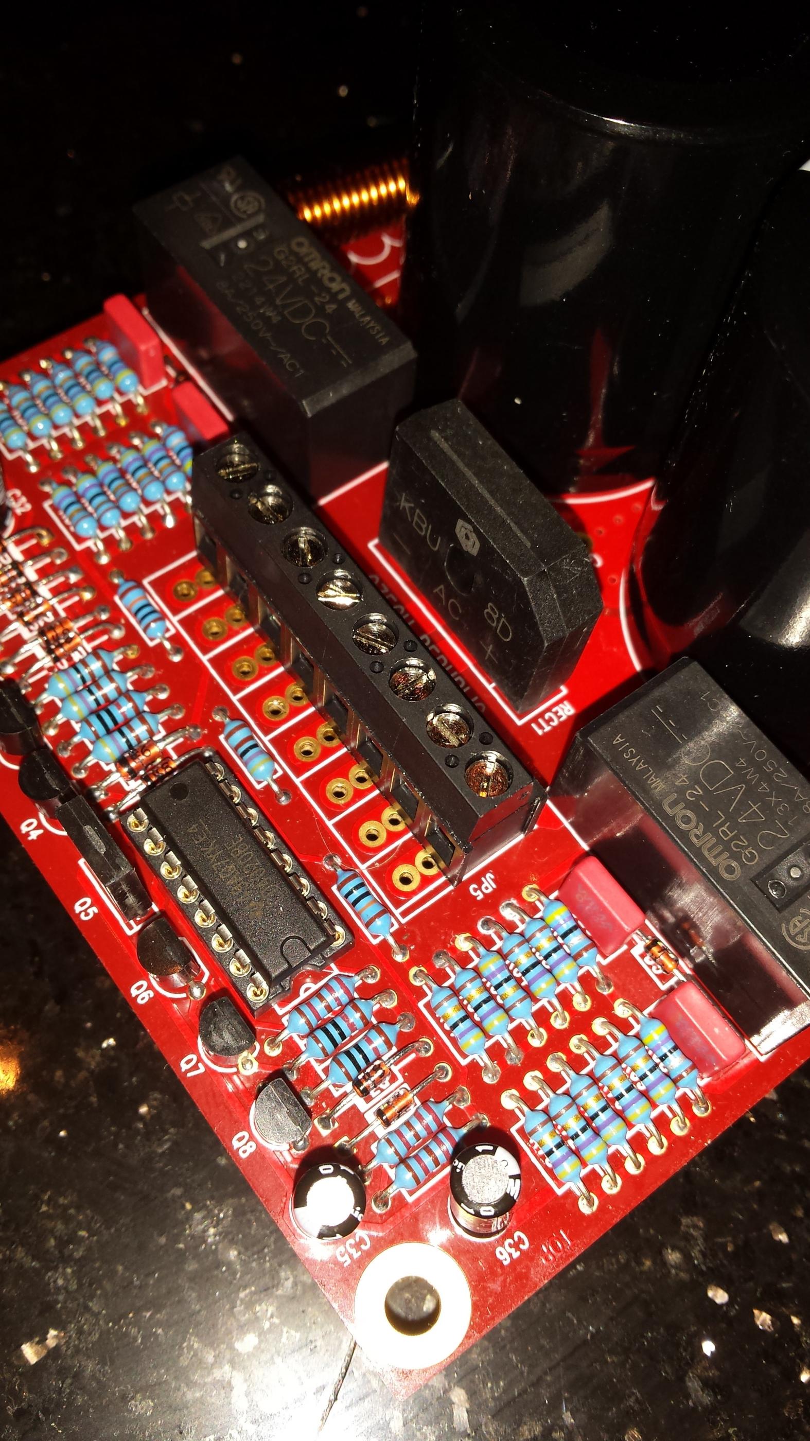

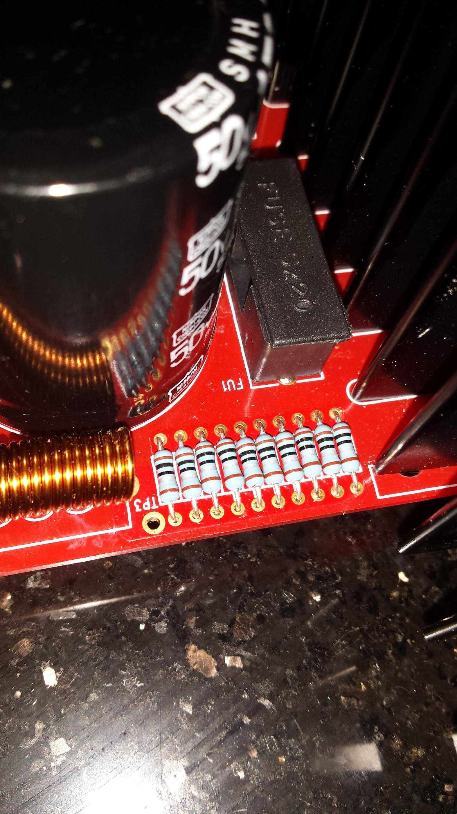

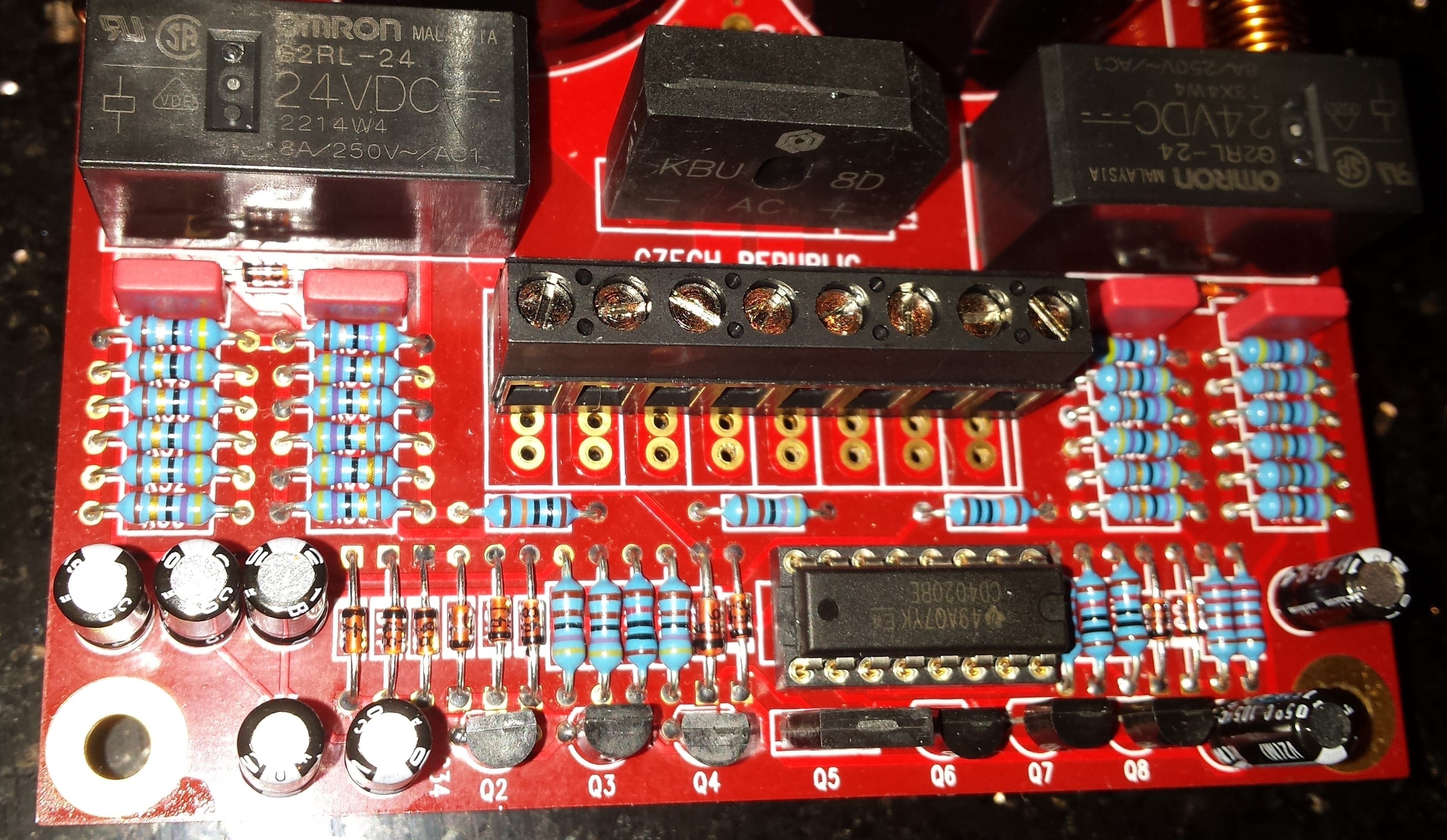

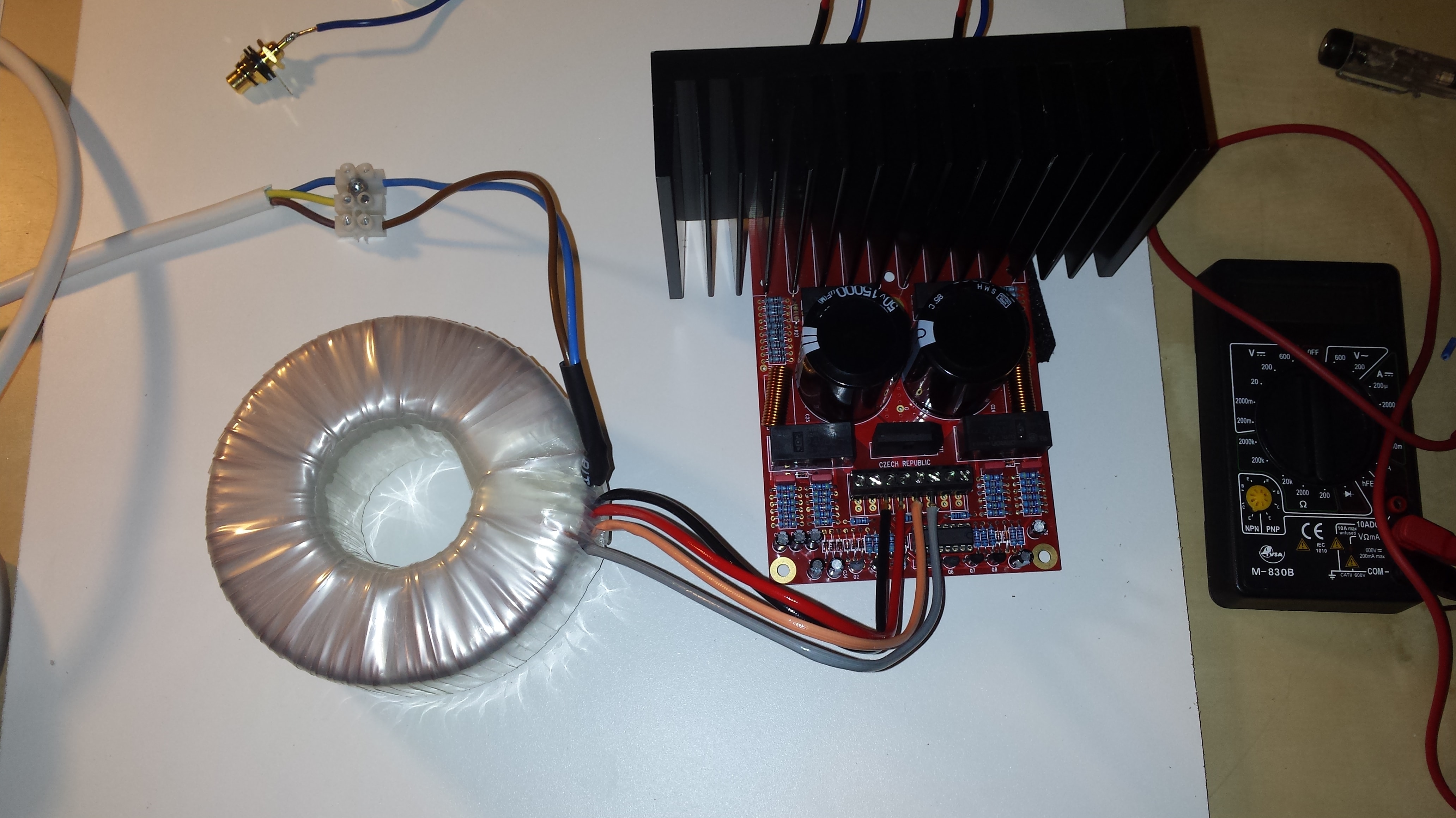

Please help!!! I finished all the soldering. Fired it up. Nice click coming from the relays and no smoke. So I connected the input and some old speakers. But the speakers only produced static noise. So than I started gently touching things, as (they say) this "static" is often a ground problem. I also removed the screws holding the vregs to the heat-sink (to eliminate possible contact there). At one moment the "amplifier" turned off and on again. But now there is no click coming from the relay anymore. I still hear some reaction on powering-down....and there is little reaction on powering-up. But no click. Fuses are okay. All suggestions are highly appreciated.
Yes, please post some pictures. Also, can you post the voltages at the test points as P-A has in his documentation:

I hope this shows something. It proofs one thing: I have a mouse in the house that can make awful holes in a heatsink

Be careful then =) This is where a dim bulb tester comes in handy. It can save your project.
yes thanks. I have it in place and it only lights up at the start up and dims nicely.

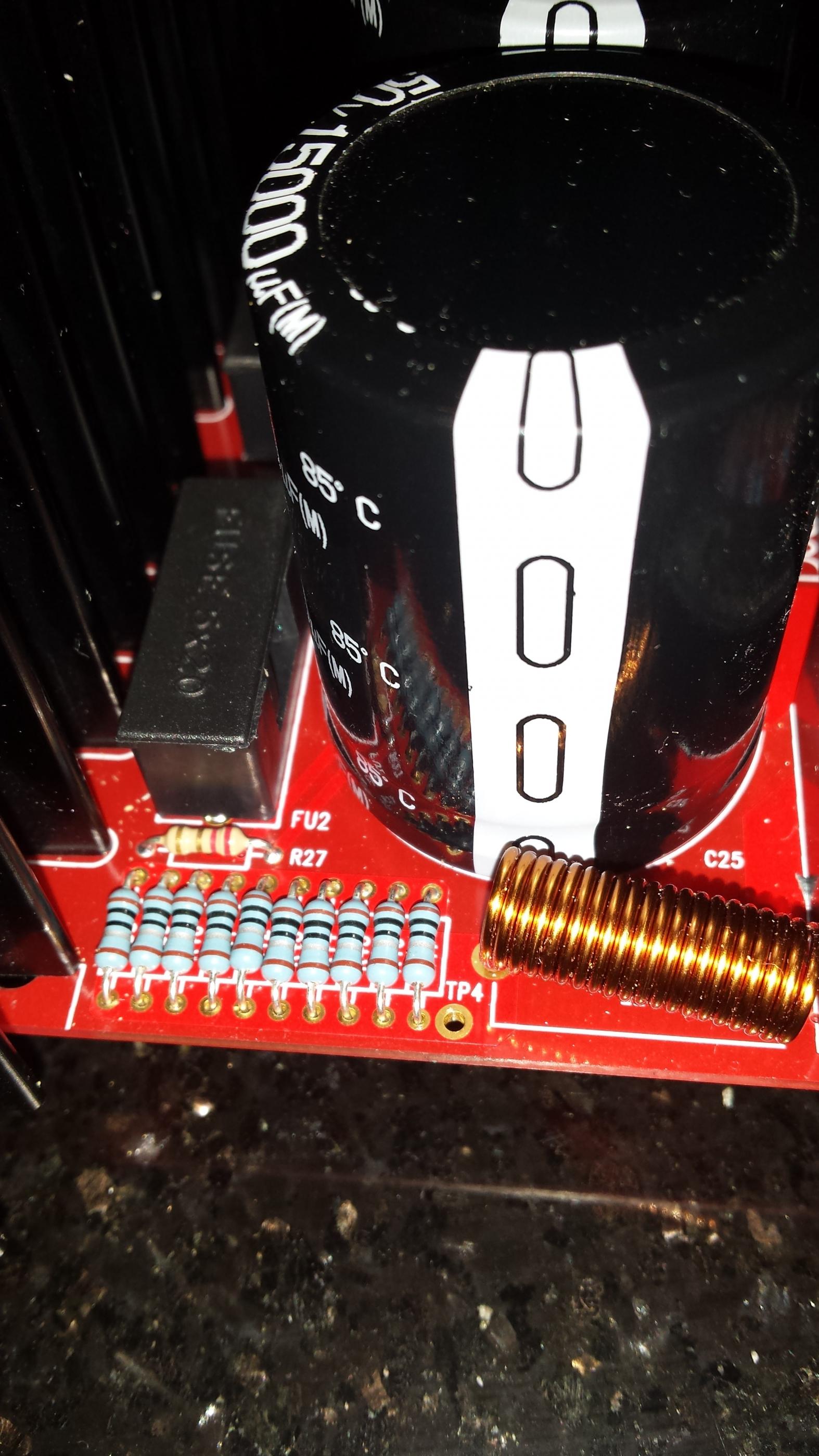

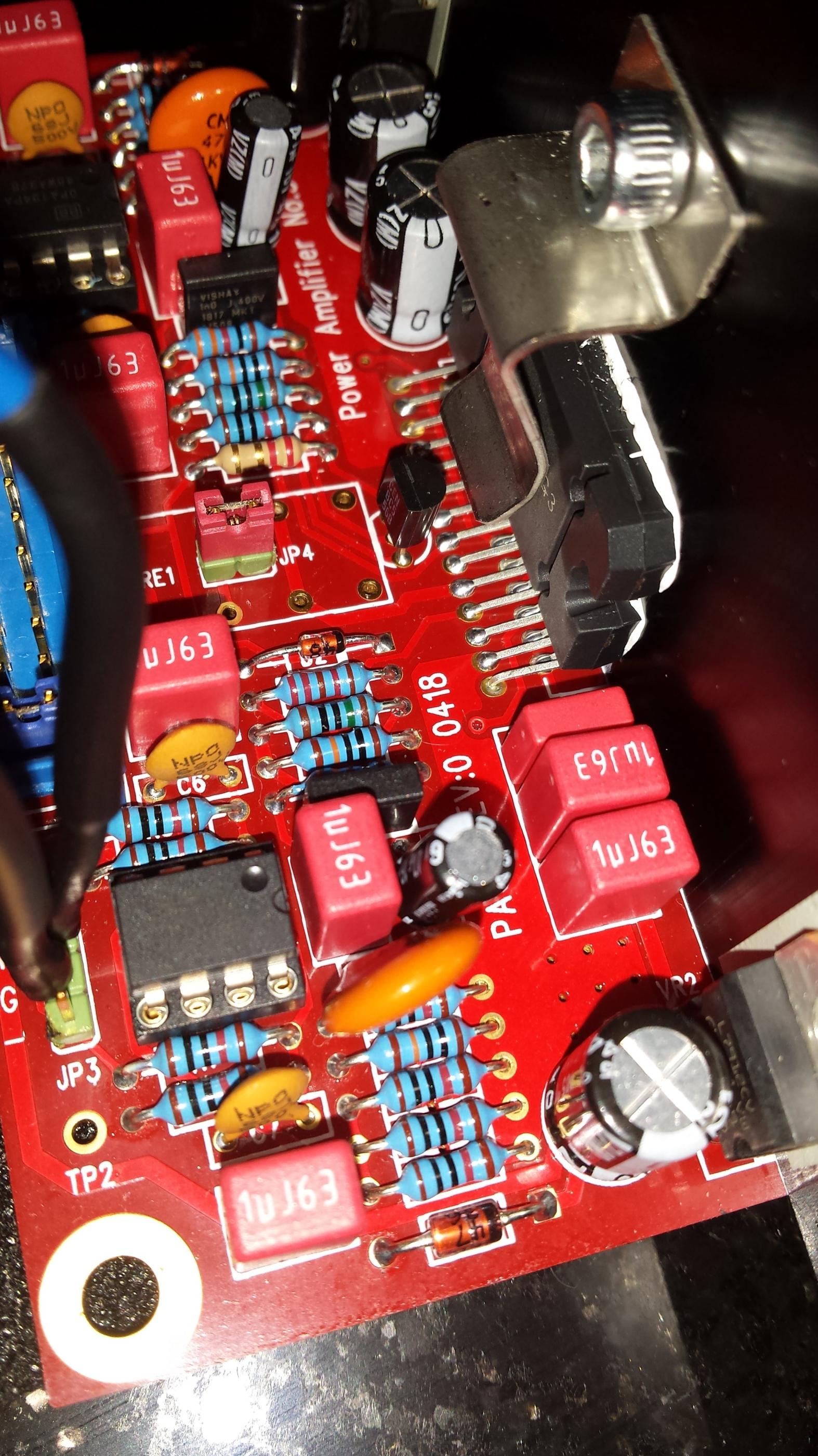

what can be the reason for this readings to bounce?

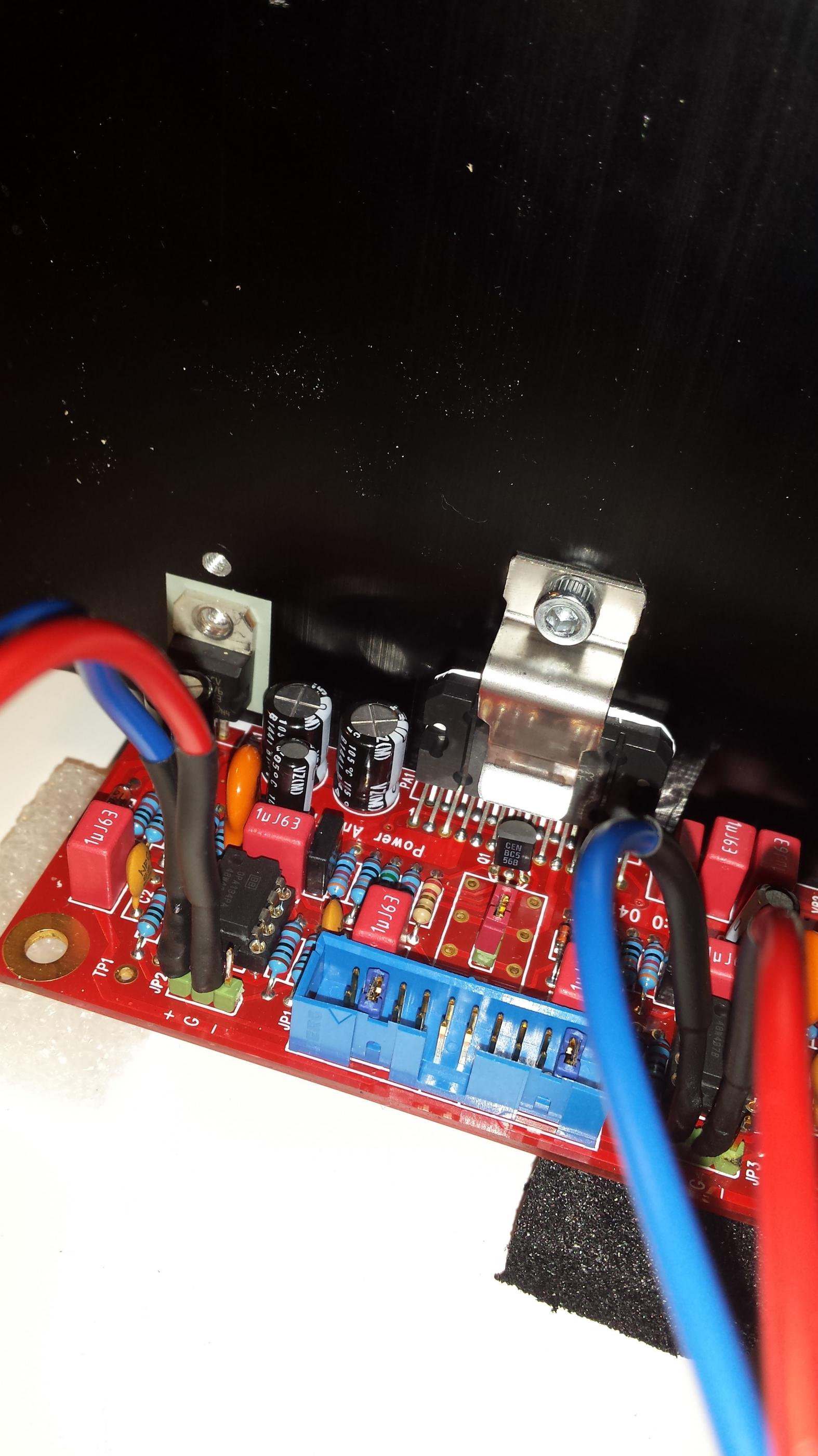

Nice build by the way! One thing! How do you insulate VR1,VR2 screws? Are you using TO-220 insulating washers that isolate the screws from the regulators and heatsink.
thanks. yes i did use the TO-220 washers. But i removed the screws. Just to be 110% sure that unwanted contact here could cause the problem

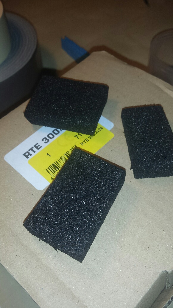

As I said earlier, I experienced bouncing readings...all the time. Sometimes the relay clicked and the next day the board was not reacting at all. Sometimes the magic bulb tester was flashing!!! I ended up having contact with Clog by telephone and he walked me through all the different steps and measuring points. We were puzzled by the irregularity of it. Out of frustration (and lack of options) I started touching and pressing items on the board, searching for...... I don't know! This resulted in all kinds of feedback; pink noise and or a even more flashing and/or an intense glowing bulb.
Yes, the board was getting awfully close to the trash can.
But then Clog called me because something struck him. Why was the board reacting this way when it was touched certain places? So he asked me about the foam I was using underneath the circuit board. YES.... STUPID ME..... All this time I was using several foam blocks MAUSER uses for shipping a IC. All the time I was using these blocks to "protect" the other side of the circuit board. To protect the soldering points I was so proud of....
The moment I removed the blocks, the room got filled with MUSIC!!! YES!
Maybe this experience can be of some help for someone else...or maybe I am the only stupid guy that has done this.
But then there is this other thought: what would have happened if CLOG did not find this cause. Then I would have trashed this board and started a second build!!!!!!! I can picture myself sitting at my desk unpacking the second MAUSER box and....... looking for a purpose for these nice foam blocks....
