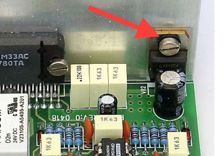

1) In the description Per-Anders website it's mentioned that the voltage regulators 7812 & 7912 must be insulated from the heatsink. I have slip pads but how do I insulate the regulator from the screw that will be attached to the heatsink?

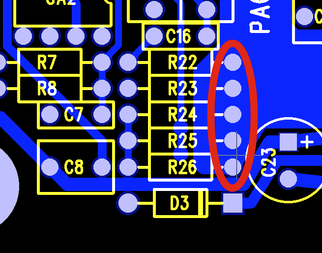

3) Since I'm totally beginner in soldering I made of course a beginner misstake. I've made a joint between the pins of R10 & R11 on the backside of the board. I tried to correct it but it was impossible for me as a beginner. However, I've studied the schematics and according to my understanding it should be OK since the R10 & R11 are connected in parallell. I'm I thinking wrong and should those pins be sperated?

siha:The metal surface of the regulator should not be in any contact with the heatsink. Normally you have a plastic bushing plus a screw when you mount the part.

1. As PA said, it needs to be insulated throughout. A TO-220 mounting kit such as Mouser PN: 532-4880SG will have everything you need.

Siha, no problem r10 and r11 are indeed connected in parallel.!!

siha: This soldering problem is nothing to worry about. Just leave it.
Edit: The picture shows the other side of the pcb but the result is the same.
